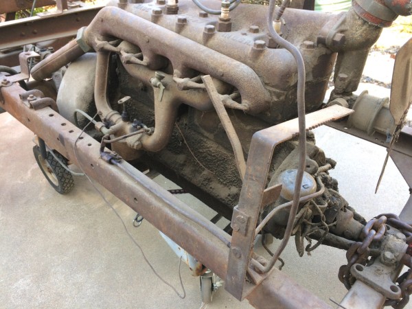

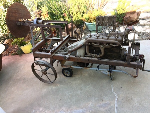

I picked this just in time for wood cutting season!
I like the throttle and timing leaver. Year of engine. So this is a brass era engine?
Matt
Matt

I am sure OSHA will give you the green light on that saw.

I would be torn between wanting to keep that as close to "as was", or to rework it with a common later engine so the motor could be used in an HCCA qualifying car.

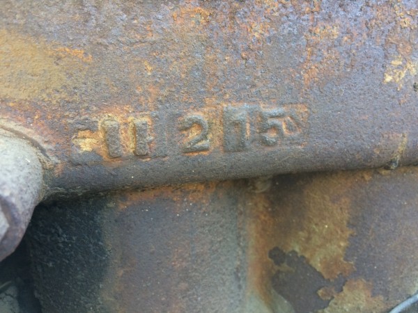

A November second casting may or may not be a pre-January build engine, but most likely is and most likely would qualify for HCCA. Since the brass Ts were manufactured well into summer of '16, it would almost definitely been a brass T originally.
Since I do so admire original stuff, I think I would keep it "as was".
Find a radiator that cools, and get it working again!
Thank you Matt for sharing this find with us.

I might be going blind but i see no table on that saw?? You should check the iron pile where you bought the saw.Bud.

I agree I see no table definently would check the scrap pile that came from. Neat unit, thanks for sharing! This is what the girls and I use every year - only a 6hp and one cylinder but it eats the wood. Think it would be a smoother process with that T engine. I hope you get to try it out at least once.
PS - the engine is a 1919 Sandwich built in Sandwich Illionis.

It looks like the transmission hogshead is aluminum. During early 1916 a few aluminum transmission covers were used alongside the newly introduced cast iron covers. These 1916 aluminum covers were more like the 1911-12 style covers in that did not have the reinforcing gussets at the bolts holes.
Rich C.
Rich C.

Bud, You are correct. This would be very difficult to use without a table. When I return I will see if the table is there, but it seems clear it was removed long ago. I happened to have the saw blade that I put on there... I bought it without know what it would drive.bud delong wrote: ↑Sat Aug 31, 2019 6:17 pmI might be going blind but i see no table on that saw?? You should check the iron pile where you bought the saw.Bud.
Randy, I love your saw! I can't imagine using these buzz saws. I noticed with this one they have it so the pulley ratio is such that the blade is about twice the speed of the engine. And as you said 22 hp would be more than powerful enough to run under full torque. What RPM do you run yours at?

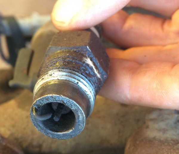

The spark plugs from the inside looked like they were off my rebuilt engine. The top side the threads were rusted off in places. Through the spark hole things looked very nice. Looking good so far!
Matt

I hope you give this thing a long look before you start it! The chain for a front motor mount might not be very good? The way the saw arbor is centered on the engine is also not very good as you will have to angle your wood to get away from the engine and you do not wan't to pinch the saw. In my hop it needs work!Bud.

All, My plan is to just use the stand for testing the engine. The saw requires a belt, so it will not accidentally start turning.

When I got this home and looked at the serial number/casting date I was a bit disappointed thinking it was not a brass era engine. Then Wayne posted his comments and I encouraged. Now I have some questions:
- A November 2, 1915 engine would go on a 1916 model T. Is that correct? When did the model year start?
- The HCCA defines a Horseless Carriage as a "vehicle built or manufactured prior to January 1, 1916." How would one find out if this engine was placed in a car prior to January 1st?
Thanks for your comments about how nice the engine looks inside. I agree it is amazing even in a dry area like here. I think it must have been in a covered area (i.e. barn) where the dust built up over the oil. But no one has commented with at least one issue that I see inside the engine.

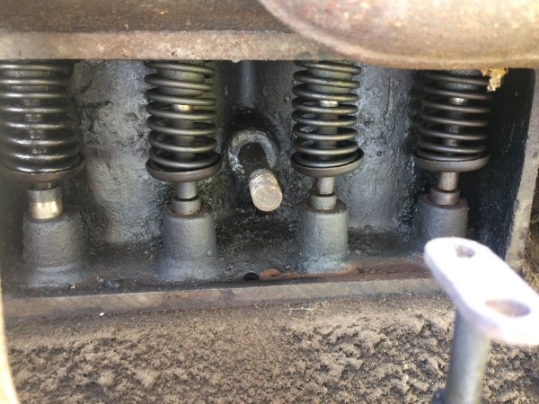

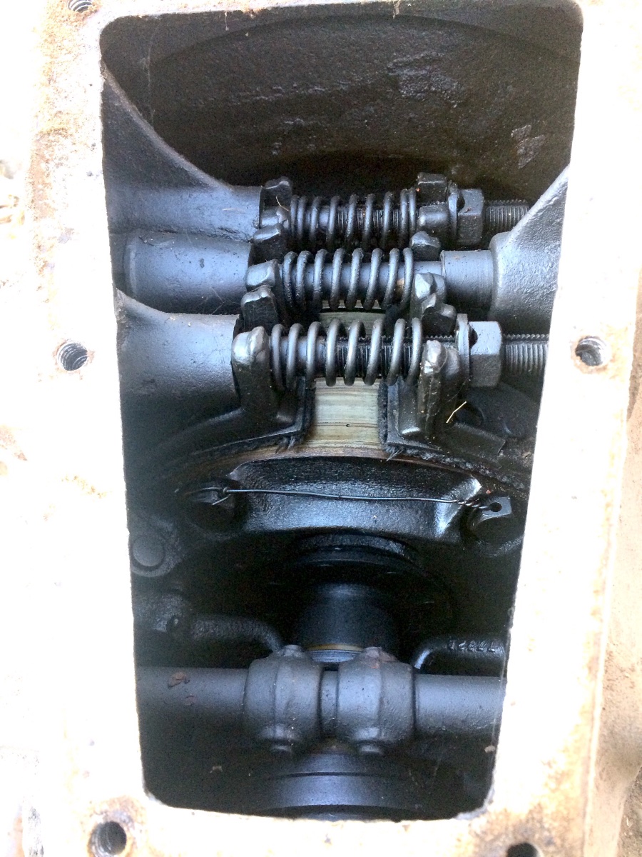

This is a better photo of the issue I was trying to see if anyone can figure out earlier.
Matt

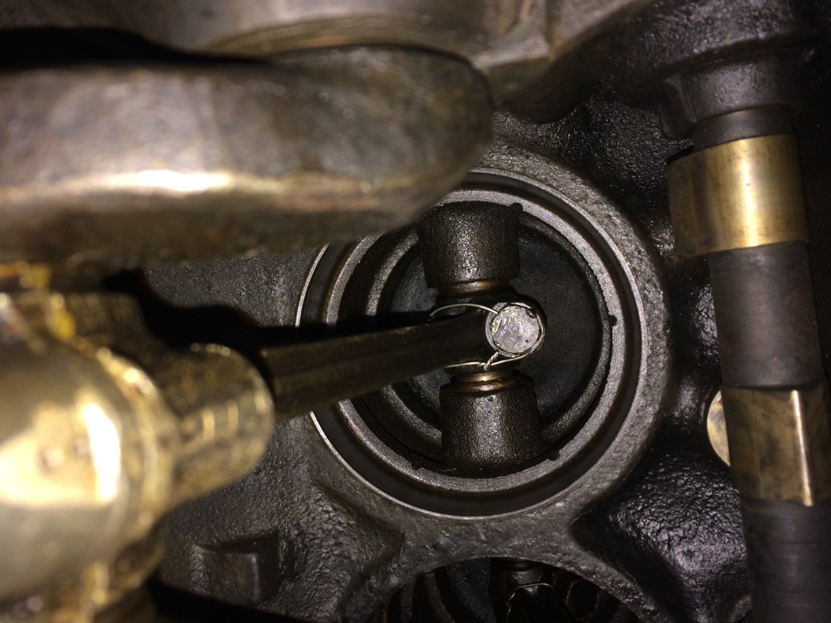

Here is my fix.
What a pain to do this from the bottom side of the engine! Fortunately it was only number two and number three cylinders. I couldn’t have done it for the number four cylinder. I’m used to the later for drip pan engines. I can see how much of an improvement is.
Matt

Re: Winter is coming, time to cut wood. Model T buzz saw

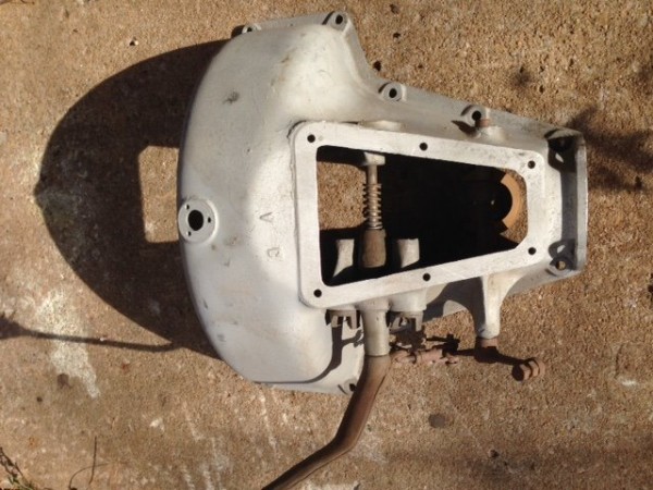

Now I have a question:
Before I put the inspection cover back on. I wanted to verify that the oil line is working. I put some oil actually 2 quarts in the reservoir of the oil pan. I hand cranked it and didn’t see any oil come out the oil line.
Do you have any advice?
Matt
Matt

If you can access one end of the line try injecting air thru the line with your compressor. I had a line that was plugged solid with old cotton lint and dirt and tried air but ended up taking it out and running a stiff wire thru it.

Perry,
I know that the line can be plugged. It sounds like you had to really tear down the engine!
Before I do that I was wondering if there is a easy way to verify that it is plugged?
Matt

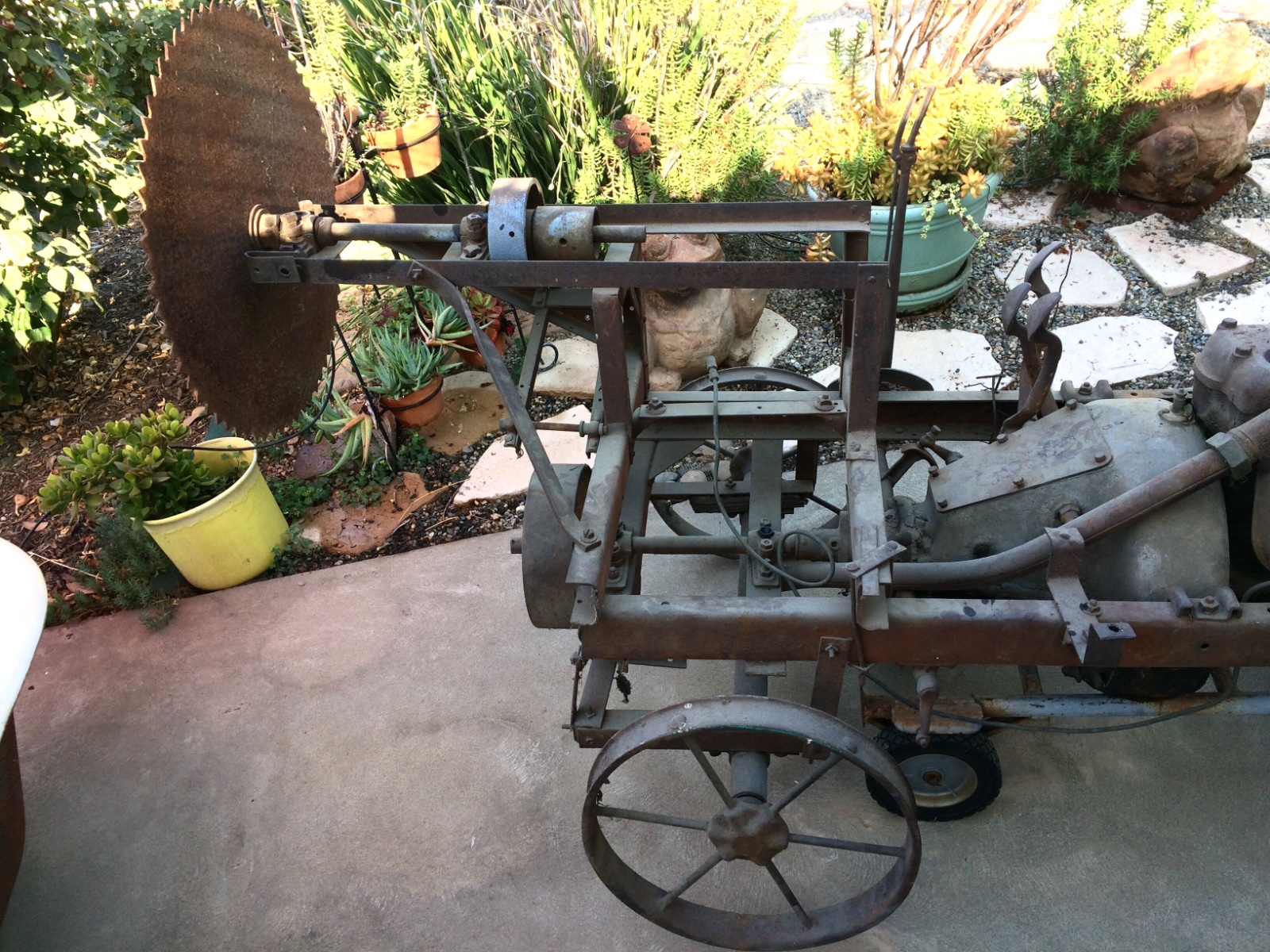

A member contacted me regarding a Buzz saw that they are building. He was looking for some info, so I thought I would post it hear and get others input.
First here is some other examples of Model T Buzz saws:
http://www.mtfca.com/discus/messages/50 ... 1435189210
Info on Model T Governors:
http://www.mtfca.com/discus/messages/17 ... 1300190691
I know I have seen some that are powered by the fan, but couldn't find them. Perhaps someone else can.

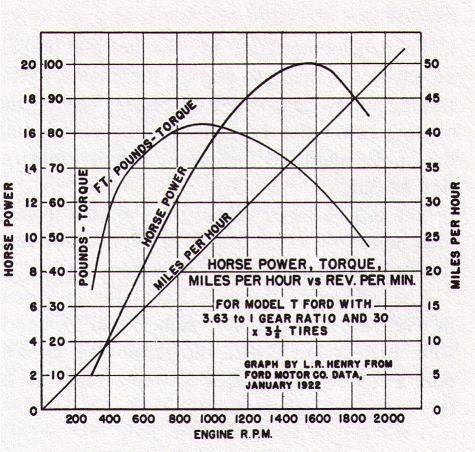

From what I can tell it seems like 2:1 or even 3:1 pulley ratios were popular. That would mean that the saw was running at 2 to 3 times the speed and 1/2 to 1/3 the torque. Assuming 2:1 ratio and using the following chart would yield the following results:
I would imagine that they would run the engine on the lower RPM and yield around 5-10 HP. With the large diameter blade you need some higher HP, but when you compare this with a chain saw or table saw that certainly seems ample. No mater how you look at it in 1930 a old Model t chassis would make a cheap power plant with plenty more power than needed. I wonder how important a governor would be needed. As long as the engine didn't bog down it seems like the governor may be more work than it is worth. On the other hand if the engine had to be forced to a higher speed that may be dangerous to run the saw at a speed higher than it should safely operate.
I have never designed a system like this, so I would love to hear others insight.
Matt
- 400 engine RPM the saw would move at 800 RPM with 4 HP
- 800 engine RPM the saw would move at 1600 RPM with 12 HP
- 1200 engine RPM the saw would move at 2400 RPM with 18 HP
Matt

The way [that] buzz rig is built you can control it easily with the throttle because you will not cut anything large on [that] buzz rig.I would hit the blade with a small hammer to see if it rings like a bell. If it rings look it over real good and make sure it is sharp. No ring or a dull thud,it is cracked and do NOT use it!!! The size of the blade will tell you the speed the saw is run at. Make sure that rig is solid before using,a tight belt,sharp saw,and start with small 2-3" wood to learn with.BE CAREFUL!!!!!!!!!!!!!!!!!!!!!!!!!!!!!!!!!!!!!!!!! Bud.

that thing looks dangerous as hell just sitting there.

We've seen the casting date, but not the serial number. That would tell the date of engine assembly. That won't exactly tell you when the engine was put into a car, but it would have been within a few days.
I believe you can run a wire through the oil tube with the hogshead off.

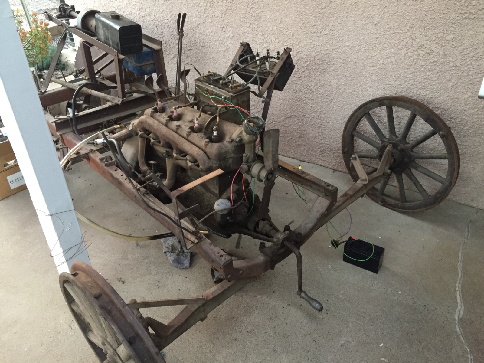

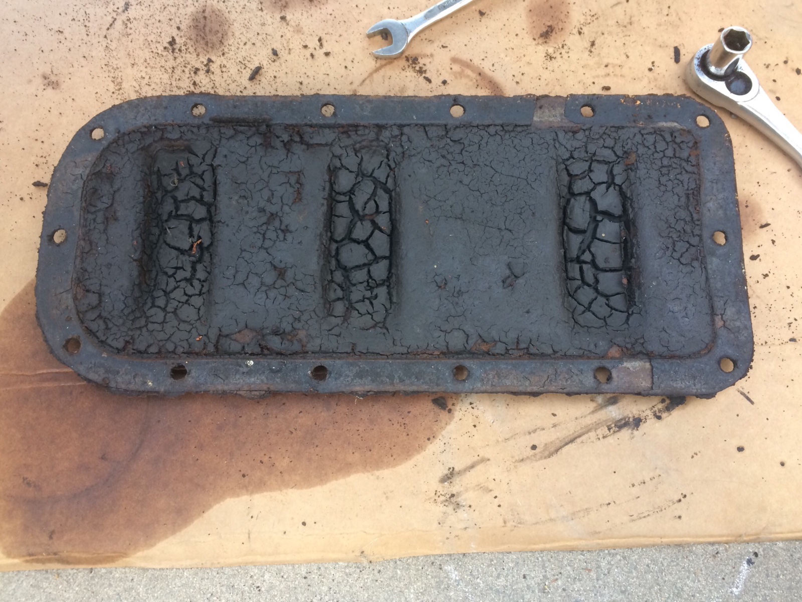

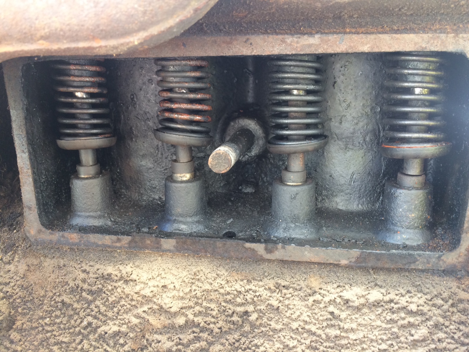

Today I got the engine started. I believe it was likely the first time in 40 years. The engine was not hard to start. It wasn’t any more difficult than starting my car! I primed it and cranked a couple times then it started. It took a bit to understand the levers, but as soon as I did it worked perfectly.
The fun part is I have a young man in high school helping me. Part of the reason that I have taken the time I have is I try to only work on this project with him. He thinks he wants to get into auto mechanics. But never had a chance to turn a wrench until now!
From memory here is what we did:
1. Mechanical:
The interesting thing is that this test stand did not come with a front axle. I added one without the spring because with the spring it would be much higher than the back. But without tires the front end now is lower than the back. In any case I used a clear tube and could see that there was oil in the front of the engine due to the forward tilt. But also interesting was that with this forward tilt I wasn't getting flow through the Ford Faithful. Perhaps a shorter thinner line would be better.
Maybe I am a year late, but still could be ready for winter:)
Matt
1. Mechanical:
- Opened transmission inspection plate. Added: Magnet, Ford Faithful with clear external oil line. I am not sure if internal one is working.
- Dropped oil inspection plate. Verified everything looked good. Cleaned pan. Removed the horse shoes that accept the plate mounting bolts cleaned out dirt, grease and metal filings. Added tie wire to wrist pins.
- Removed/Cleaned carburetor. Replaced float with a brass one.
- Gas line was connected, added gas tank, valve. But tank had some rust in it and likely blocked copper line. So I added my trust gas tank that has rubber hose, filter, modern ball valve shutoff and shutoff valve at carb. This is a very handy set up I have used in getting engines started for others. It is a pain to fill a tank and deal with all the gas issues to figure out the status of an engine that is in the moth balls.
- Coil box on engine is really neat. It is likely the original 1915 put on top of engine, but I believe the wood was too far gone and the switch may have issues. I opted to add a modern 1926 style coil box that I have.
- Timer was just lightly serviced. Emery cloth (more than lightly) was used to clean contacts. All connectors were removed, nuts were wire wheeled.
- Wires were shot. This and the damage to the coil box make me think this car sat out for a very long time. I along with my helper used original connectors from the timer to the coil box. Original spark wires from the 1926/27 box were used, but they are very brittle so caution was used to avoid shorting.
- Spark plugs were a mixed lot. They could have been used, but the clip on tops, plus one with a broken screw influenced my decision to just get some extras that I had.
- Battery. My mom has some medical equipment that flashed time to change the 24VDC battery. I took apart the batter to find that it was constructed of two 12 VDC batteries. They are very nice and portable for something like this.
- Switch was just a simple toggle switch between Mag and battery. Yes, I found that the Mag does work!
- I just ran it for a couple of ~30 second runs with 30 + minutes between. But this is on my short too do list.
Matt

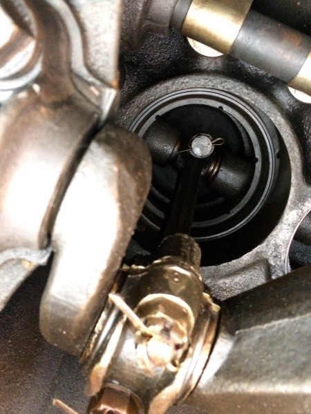

Matt, I suggest that while you have the inspection plate off, you take out the horse shoes that accept the plate mounting bolts. There will be heaps of crud lodged between the horse shoes and the sides of the pan. Now is the time to clean it out.
- Posts: 5601

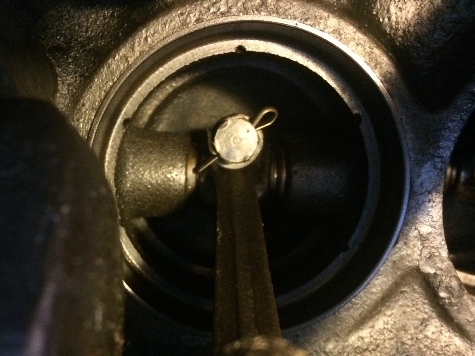

I would re-install the cotter pins into the wrist pin clamps just like they were - I've witnessed "wire" fail in that position.

Steve, Your comment about reinstalling the cotter pins was my laugh for the day. The cotter pins do really well sitting there in the head of the bolt.
Gorden, I havn't been real clear. I don't intend to use the saw. I don't plan to hook up a belt and the shaft is actually rusted in place at the moment. I do like the engine stand especially the throttle and timing lever. I have used other engine stands, but you needed a steering wheel installed. It is nice that this is right there in the front.
Allan, I agree and did remove the horse shoes that accept the plate mounting bolts. There was lots of grease, dirt and metal parts to be removed. I will edit the post I made earlier to include that. Part of the reason that I posted is that it is my philosophy that the things that I did mechanically should be inspected on any engine like this prior to starting. I feel too many people would just start the engine for the thrill of it and risk having unnecessary issues.
Matt
Matt

I reviewed the piston photo - one leg of the pin SHOULD be pointed down along the rod !
- Posts: 5601
If you're in doubt Matt, look in the Ford "Bible" for installing a cotter pin in the wrist pin bolt.

Steve, my apologies, I thought you were joking. I appreciate you sharing your experience and wisdom. I have seen where the cotter pins wiggle so much they wear most of the way through the head. It doesn’t seem like the best practice. But here is the quote chapter and verse!

No worries, Matt - early on in my "learning" years, I used safety wire on my own engine work and found wire pieces during an oil change & trans. screen cleaning - Yep, want to guess where it came from ?
