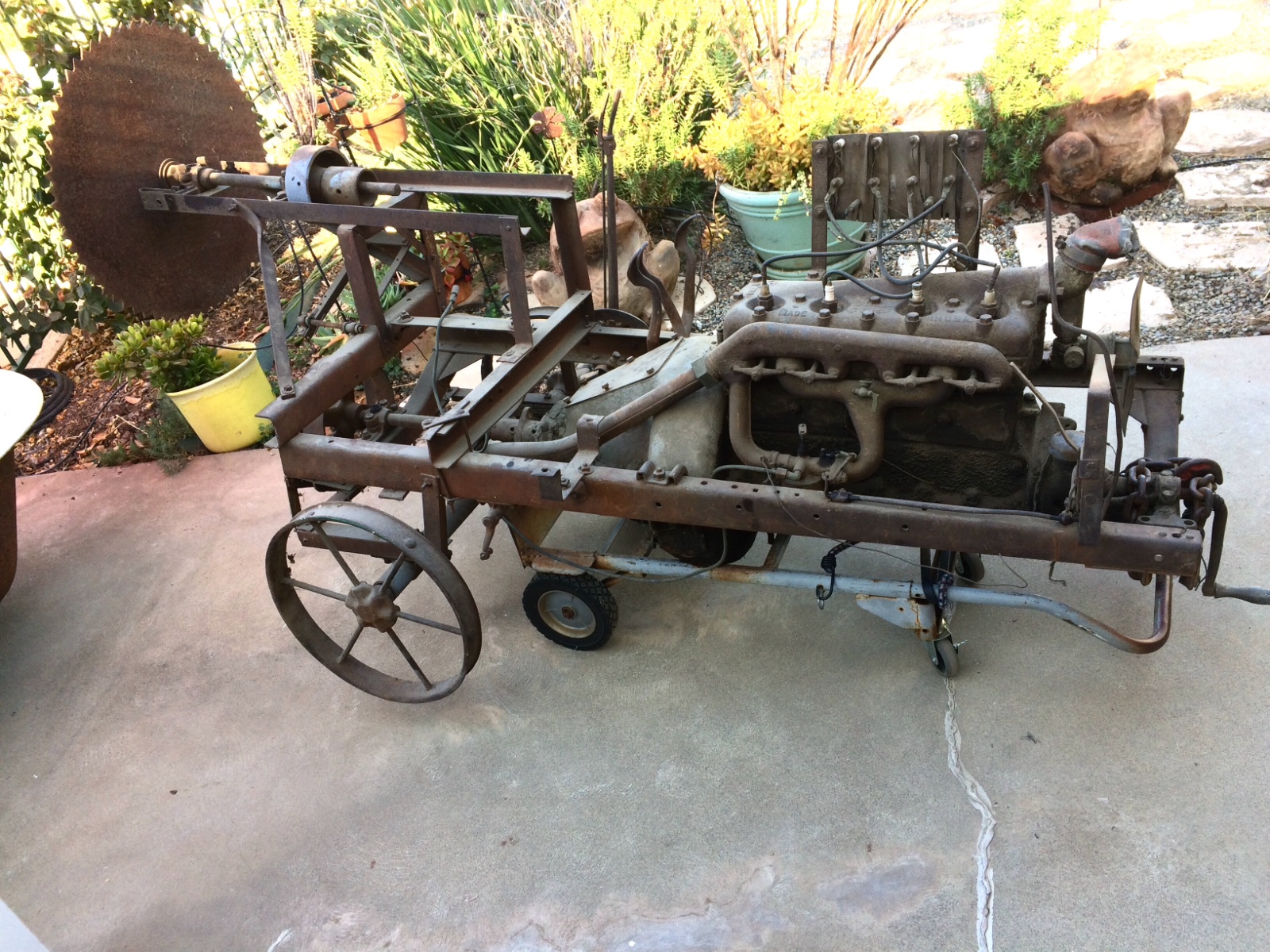

Winter is coming, time to cut wood. Model T buzz saw
Post by Matt in California » Sat Aug 31, 2019 1:23 pm
I picked this just in time for wood cutting season!
I like the throttle and timing leaver.
Year of engine.
So this is a brass era engine?

NEAT SAW !
I would be torn between wanting to keep that as close to "as was", or to rework it with a common later engine so the motor could be used in an HCCA qualifying car.
A November second casting may or may not be a pre-January build engine, but most likely is and most likely would qualify for HCCA. Since the brass Ts were manufactured well into summer of '16, it would almost definitely been a brass T originally.
Since I do so admire original stuff, I think I would keep it "as was".
Find a radiator that cools, and get it working again!

I might be going blind but i see no table on that saw?? You should check the iron pile where you bought the saw.Bud.

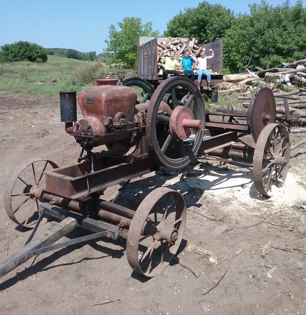

Post by Shemp » Sat Aug 31, 2019 7:05 pm
I agree I see no table definently would check the scrap pile that came from. Neat unit, thanks for sharing! This is what the girls and I use every year - only a 6hp and one cylinder but it eats the wood. Think it would be a smoother process with that T engine. I hope you get to try it out at least once.
PS - the engine is a 1919 Sandwich built in Sandwich Illionis.

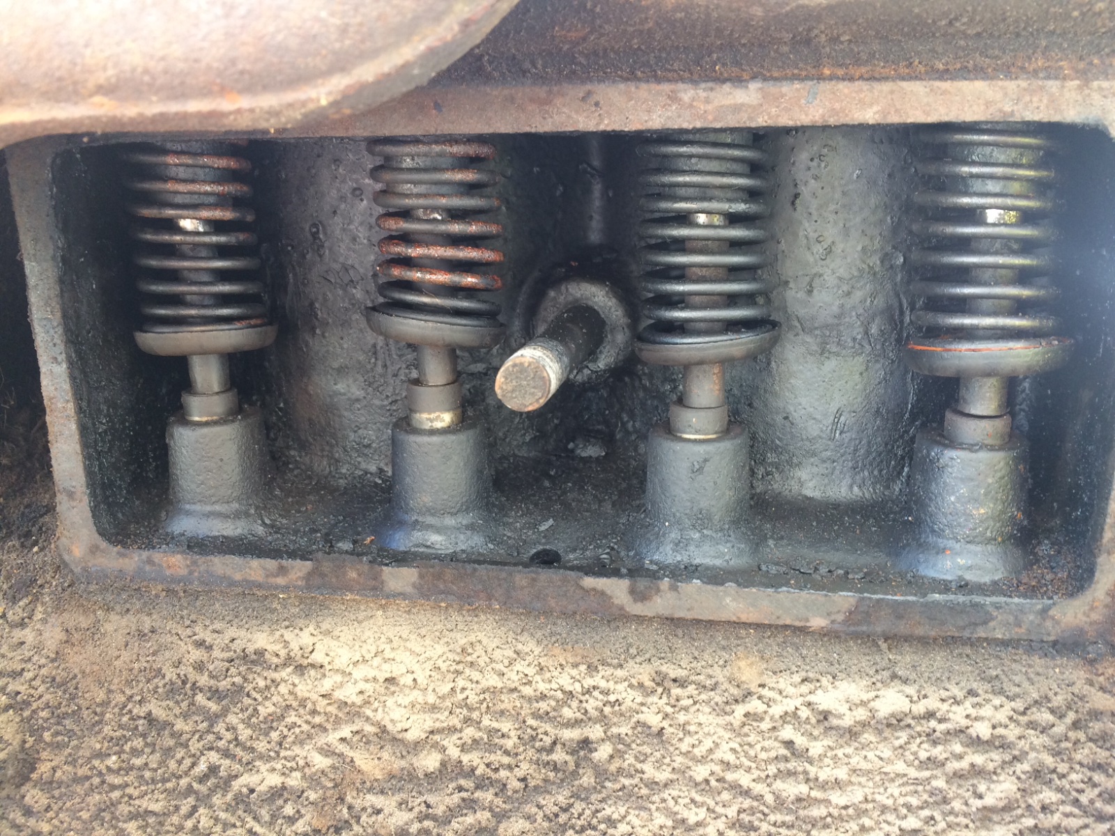

I opened the inspection covers in the valves look very nice:
I’m guessing that this is probably set for 40+ years.

Post by Matt in California » Sun Sep 29, 2019 12:37 pm
This is a better photo of the issue I was trying to see if anyone can figure out earlier.
Matt

Post by Matt in California » Tue Jul 21, 2020 2:56 am
Today I got the engine started. I believe it was likely the first time in 40 years. The engine was not hard to start. It wasn’t any more difficult than starting my car! I primed it and cranked a couple times then it started. It took a bit to understand the levers, but as soon as I did it worked perfectly.
The fun part is I have a young man in high school helping me. Part of the reason that I have taken the time I have is I try to only work on this project with him. He thinks he wants to get into auto mechanics. But never had a chance to turn a wrench until now!
From memory here is what we did:
1. Mechanical:
  • Opened transmission inspection plate. Added: Magnet, Ford Faithful with clear external oil line. I am not sure if internal one is working.
  • Dropped oil inspection plate. Verified everything looked good. Cleaned pan. Removed the horse shoes that accept the plate mounting bolts cleaned out dirt, grease and metal filings. Added tie wire to wrist pins.
2. Gas:
  • Removed/Cleaned carburetor. Replaced float with a brass one.
  • Gas line was connected, added gas tank, valve. But tank had some rust in it and likely blocked copper line. So I added my trust gas tank that has rubber hose, filter, modern ball valve shutoff and shutoff valve at carb. This is a very handy set up I have used in getting engines started for others. It is a pain to fill a tank and deal with all the gas issues to figure out the status of an engine that is in the moth balls.
3. Electrical
  • Coil box on engine is really neat. It is likely the original 1915 put on top of engine, but I believe the wood was too far gone and the switch may have issues. I opted to add a modern 1926 style coil box that I have.
  • Timer was just lightly serviced. Emery cloth (more than lightly) was used to clean contacts. All connectors were removed, nuts were wire wheeled.
  • Wires were shot. This and the damage to the coil box make me think this car sat out for a very long time. I along with my helper used original connectors from the timer to the coil box. Original spark wires from the 1926/27 box were used, but they are very brittle so caution was used to avoid shorting.
  • Spark plugs were a mixed lot. They could have been used, but the clip on tops, plus one with a broken screw influenced my decision to just get some extras that I had.
  • Battery. My mom has some medical equipment that flashed time to change the 24VDC battery. I took apart the batter to find that it was constructed of two 12 VDC batteries. They are very nice and portable for something like this.
  • Switch was just a simple toggle switch between Mag and battery. Yes, I found that the Mag does work!
5. Coolant
  • I just ran it for a couple of ~30 second runs with 30 + minutes between. But this is on my short too do list.
Or in short, I added a coil box, wires, spark plugs, battery, gas tank and some elbow grease and this thing had no problem getting started.
The interesting thing is that this test stand did not come with a front axle. I added one without the spring because with the spring it would be much higher than the back. But without tires the front end now is lower than the back. In any case I used a clear tube and could see that there was oil in the front of the engine due to the forward tilt. But also interesting was that with this forward tilt I wasn't getting flow through the Ford Faithful. Perhaps a shorter thinner line would be better.
Maybe I am a year late, but still could be ready for winter:)
Matt
Last edited by Matt in California on Tue Jul 21, 2020 2:08 pm, edited 1 time in total.
