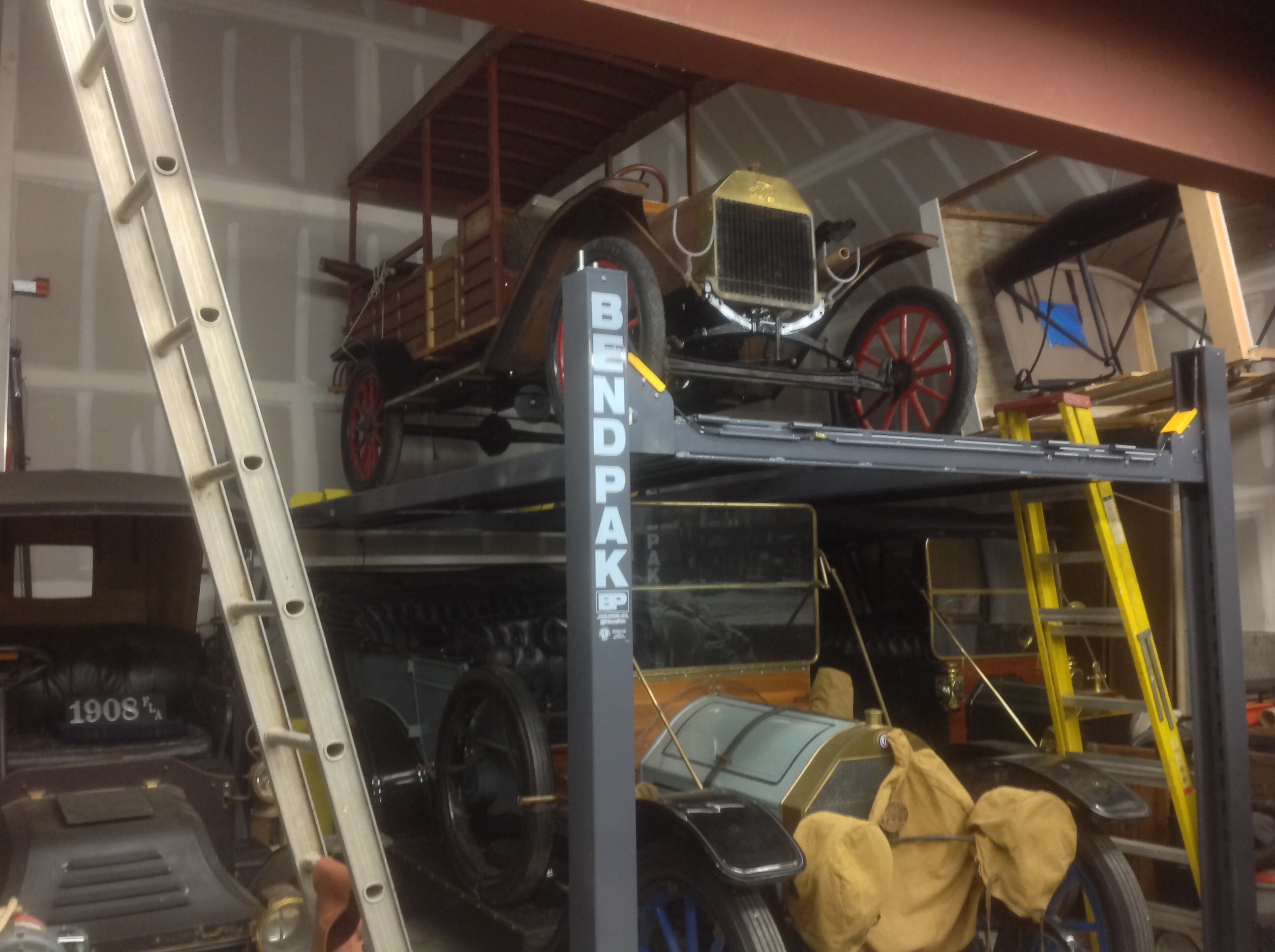

Don, as I researched both 2-post and 4-post, the answer really isn't clear cut.
Certainly it's a personal choice for one.
But you also have to probably adapt it somewhat to fit under that tiny little frame.
Then my concern was for all that 3-point suspension just "hanging there".
Then there's the concern for stability of ONLY two posts. You HAVE to have it securely mounted to the floor. Mine, just "sits" there.
Frankly, I am so so glad I got the 4-poster. The ramps really do not pose that much of a problem.
And, I can put my F150 on it as well as other cars, I even adapted the flanges to hold my CubCadet SubCompact Tractor!
I love it!

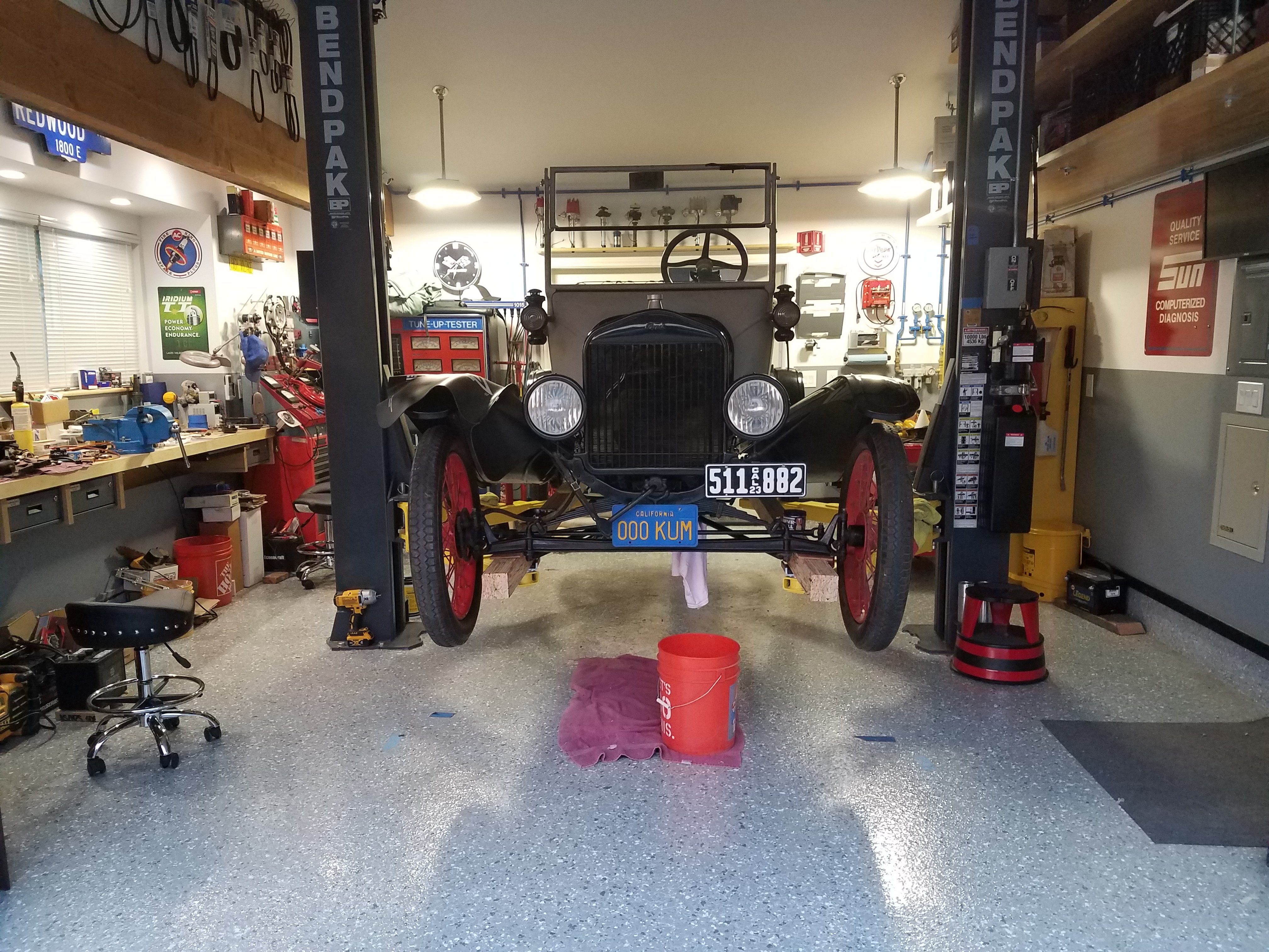

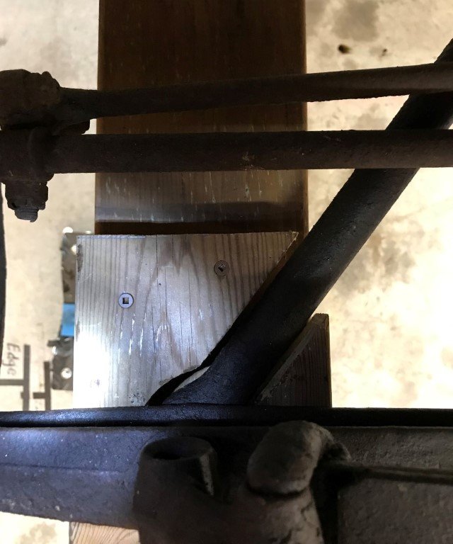

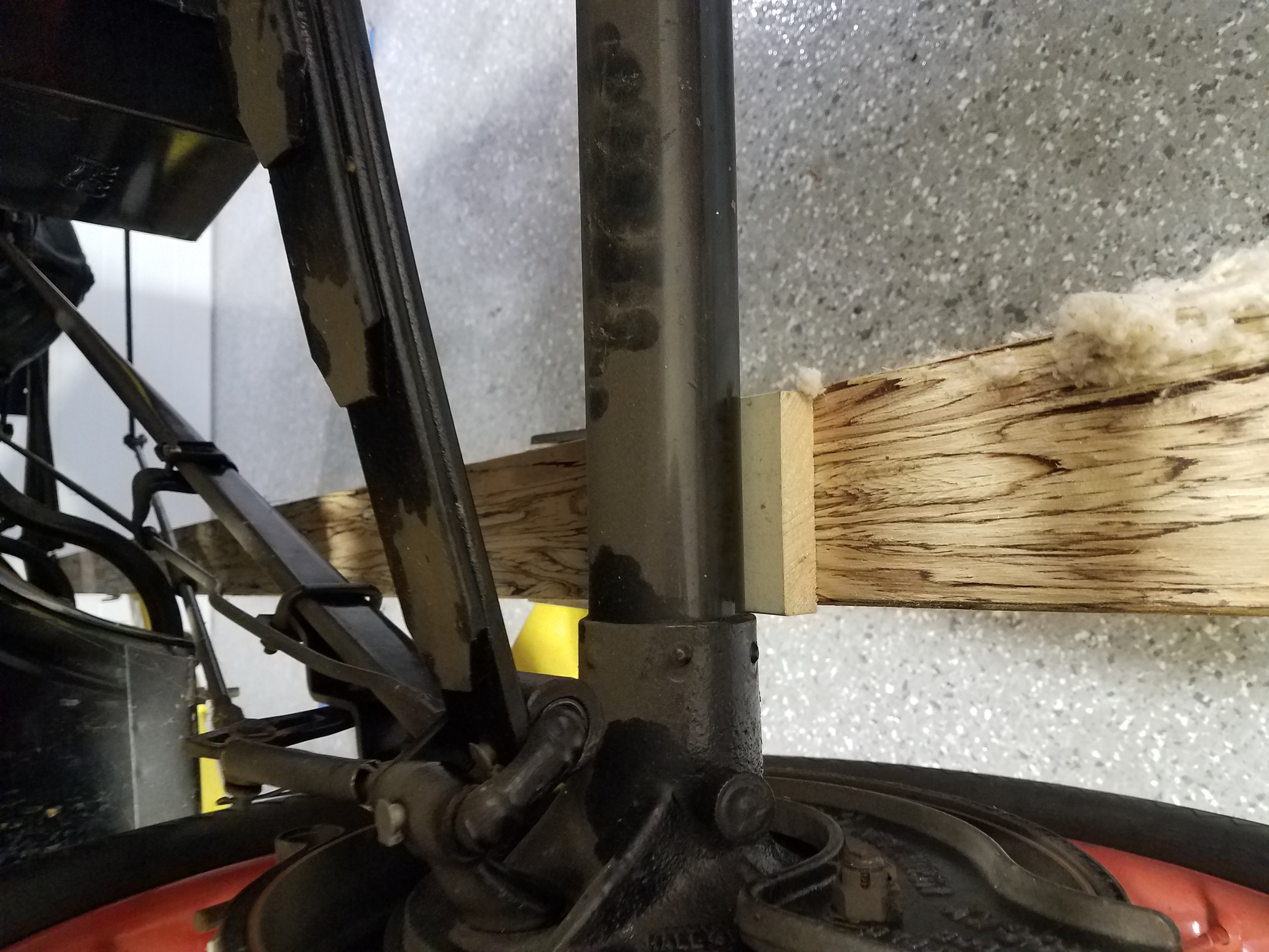

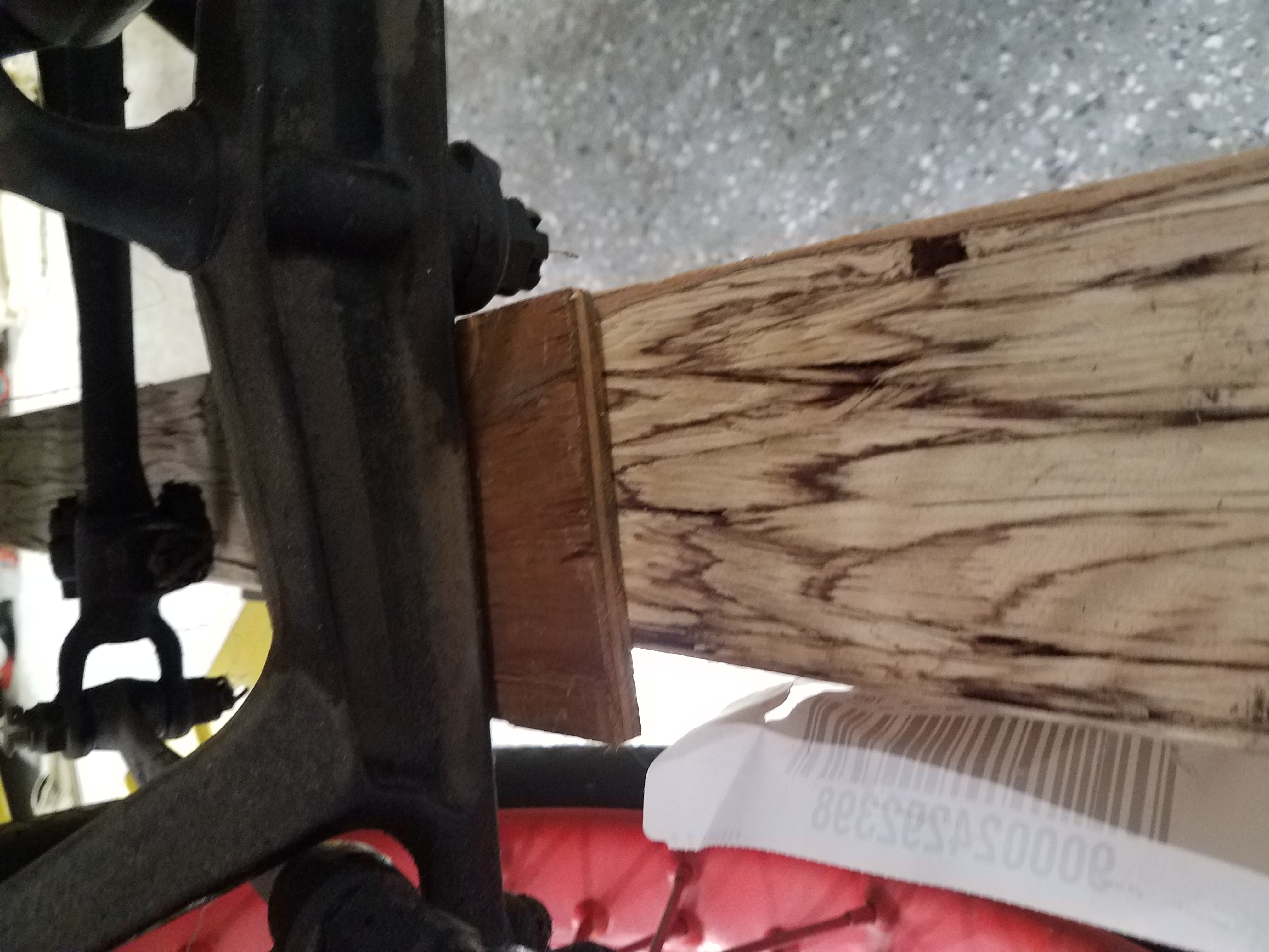

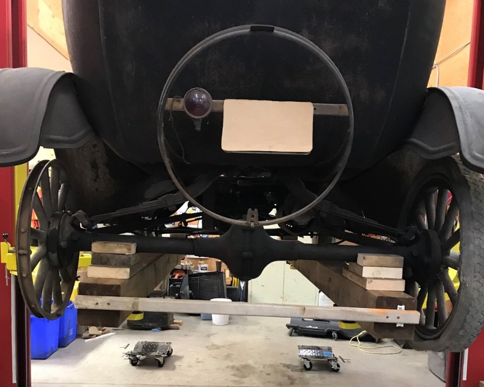

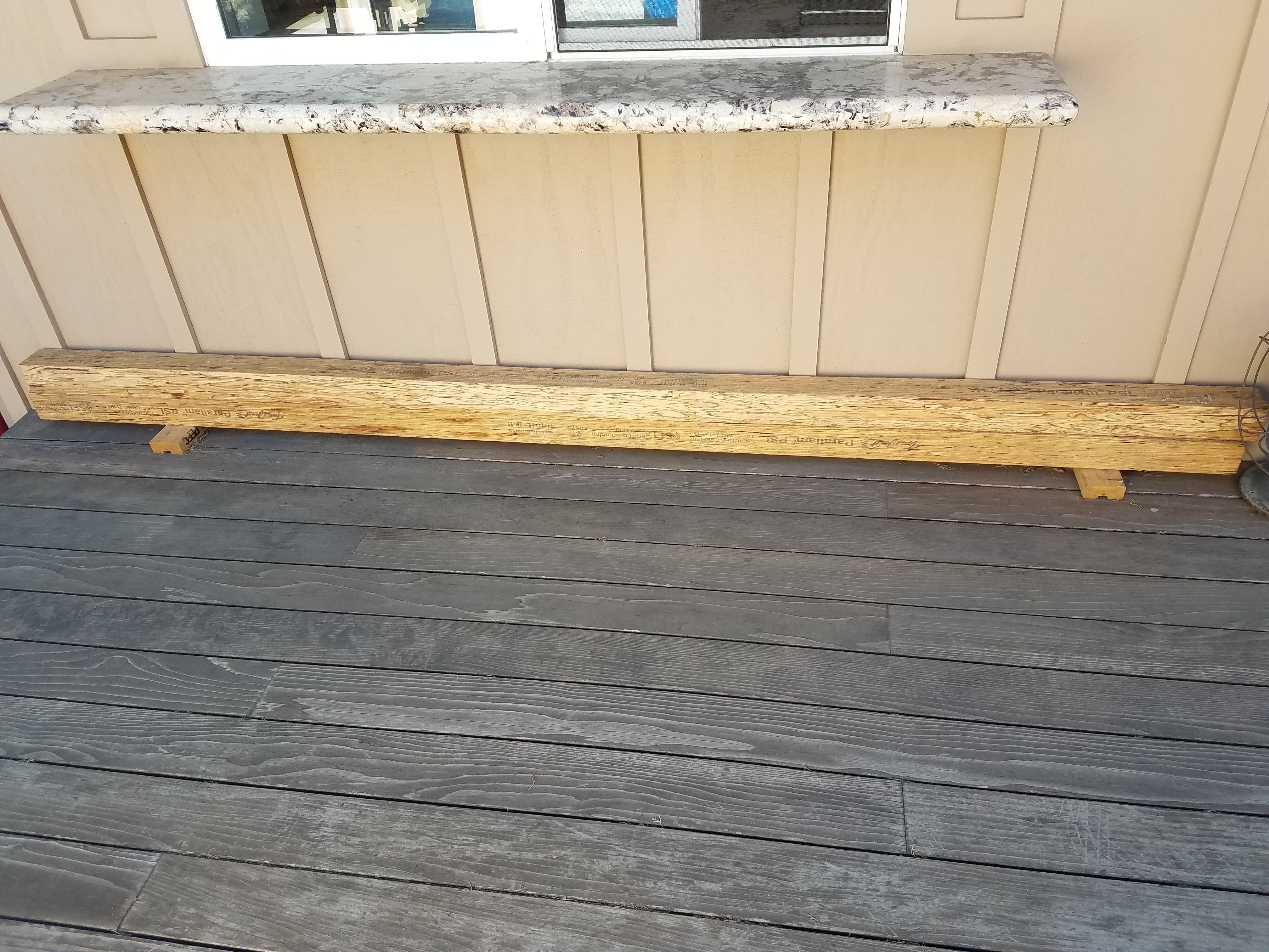

Jeffrey...I see you use 4x4s as a method to support the suspension. Excellent idea. That looks like one hefty, expensive lift!!
big2bird
Posts: 722
First Name: Jeffrey
Last Name: Hausey
Location: Anaheim, Ca.
Re: Model T on a 2-post lift
Post by big2bird » Wed Nov 11, 2020 10:32 am
TWrenn wrote:
Wed Nov 11, 2020 10:14 am

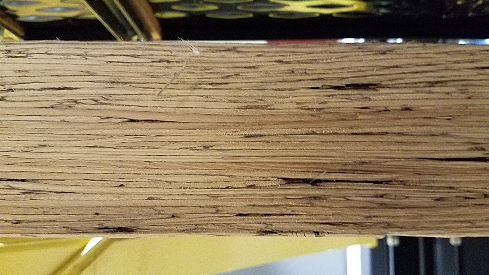

They are 4x4 PSL posts. My best friend is a structural engineer.
Regular 4x4 No.1 didn't cut the math.
big2bird
Posts: 722
First Name: Jeffrey
Last Name: Hausey
Post by big2bird » Wed Nov 11, 2020 10:44 am
The posts are within 16" of each axle, on frame saddles.
Calculated for 1650 lbs, safety factor of 2, 1/4" deflection.
It has to be done correctly, but it can be done.

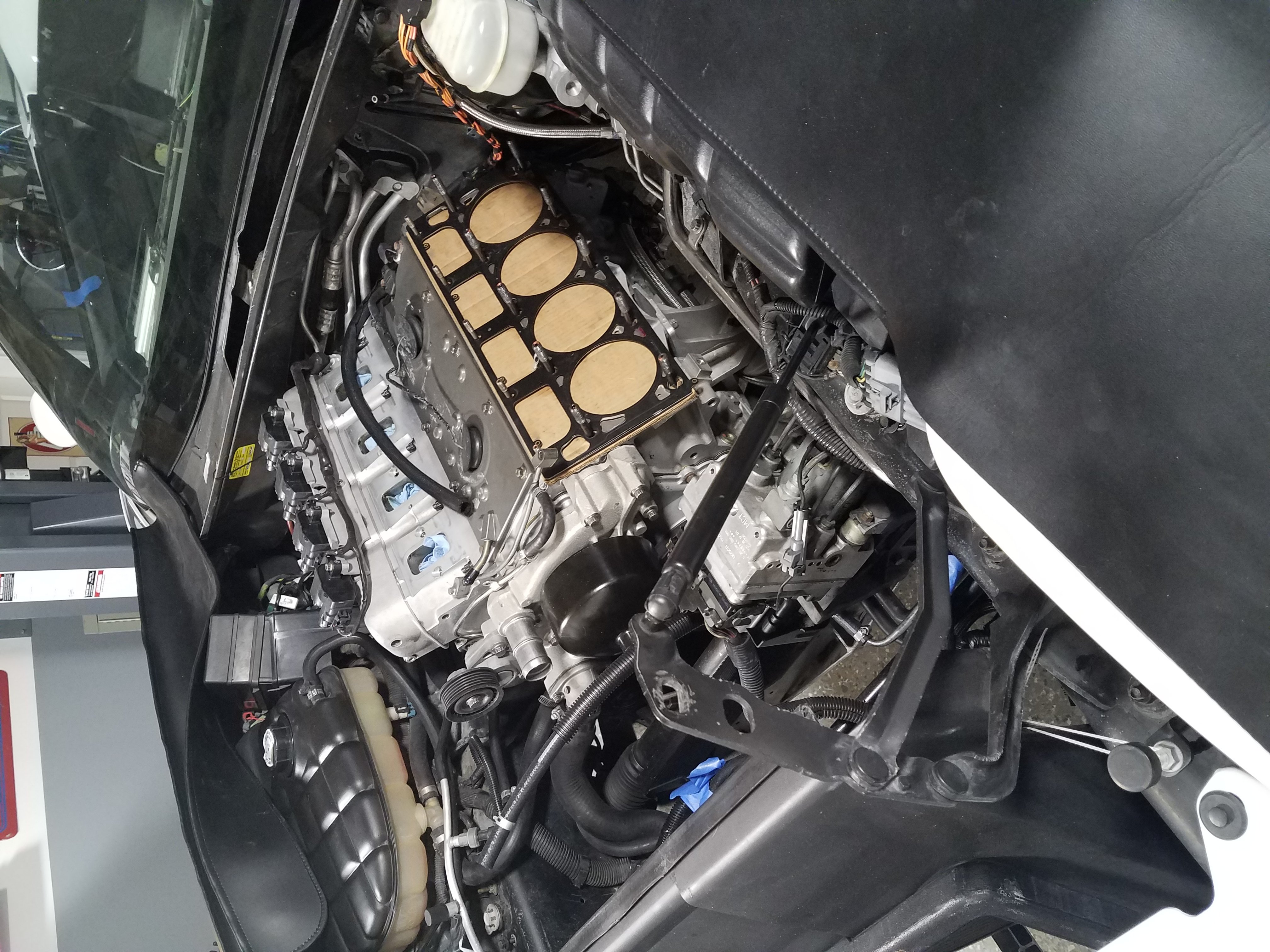

I work on Corvettes on the side.
This is a 99 C5R factory race engine here right now.
The lift can hold the T all the way up, and I can park my C3 corvette underneath.
On a two post, checking wheels, brakes, alignment, etc. on the T is easy.
The T is on a friends 4 post right now till I get this restoration finished.

10' is what I bought. The load was calculated for a touring. You could use 4x6, and it would clear fine, for a heavier car.
I bought the frame saddles for my truck, and they hold a 4x nice, but not tight.
You will find you need a small spacer under the rear to lift level. 3/4" works fine.
Just make sure the lift points are within 16" of the axles, and your golden. The math changes dramatically further away from load.

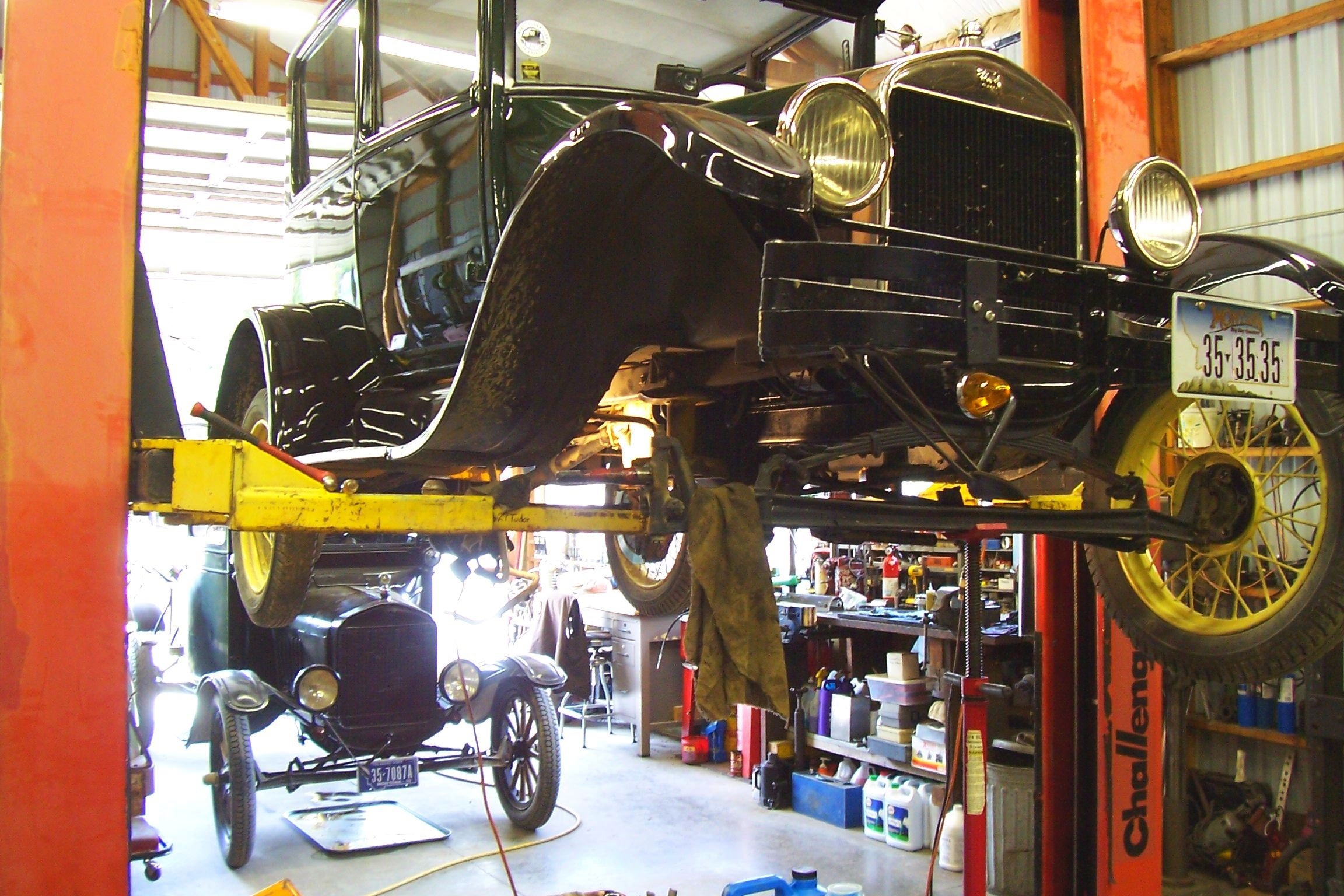

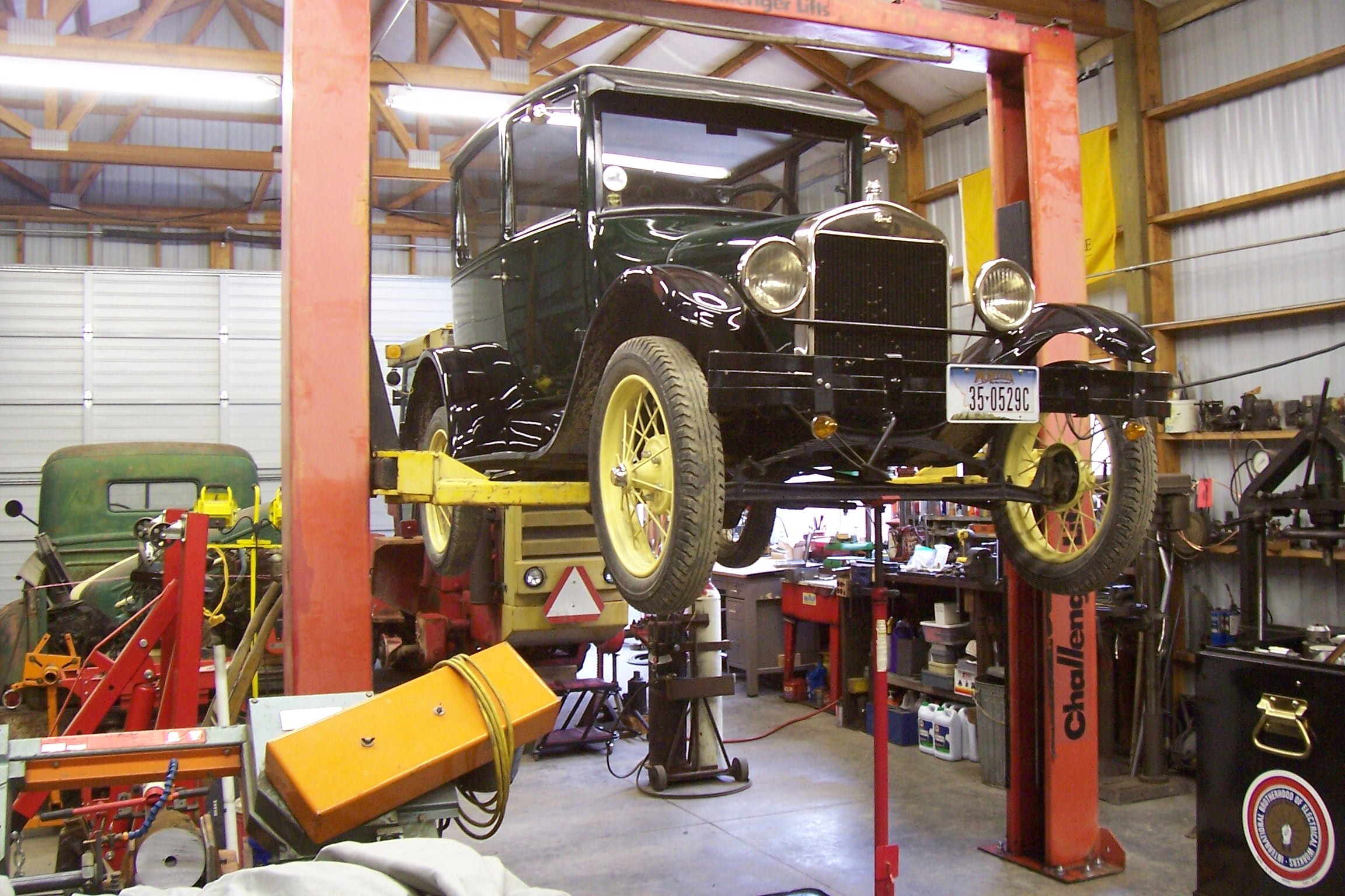

My Challenger lift has factory risers that work great on my T's. Very stable.

I decided on the four post lift because it can be moved around the shop if needed since,it,does not need to be anchored to the floor and I too was concerned about using a two post lift with my larger cars..

I'm with ya there too Russ. Easy to move around if need be. The ramps aren't that much in the way to work on T's let alone moderns. I have my F150 and T bird on it all the time doing stuff, never a problem. Just feels safer, sturdier. Plus in the winter I "stack 'em", and I'd be real reluctant to do that on only a 2-poster. My opinion is all. What works for one, may not work for the other, that's okay. Makes the world go round.

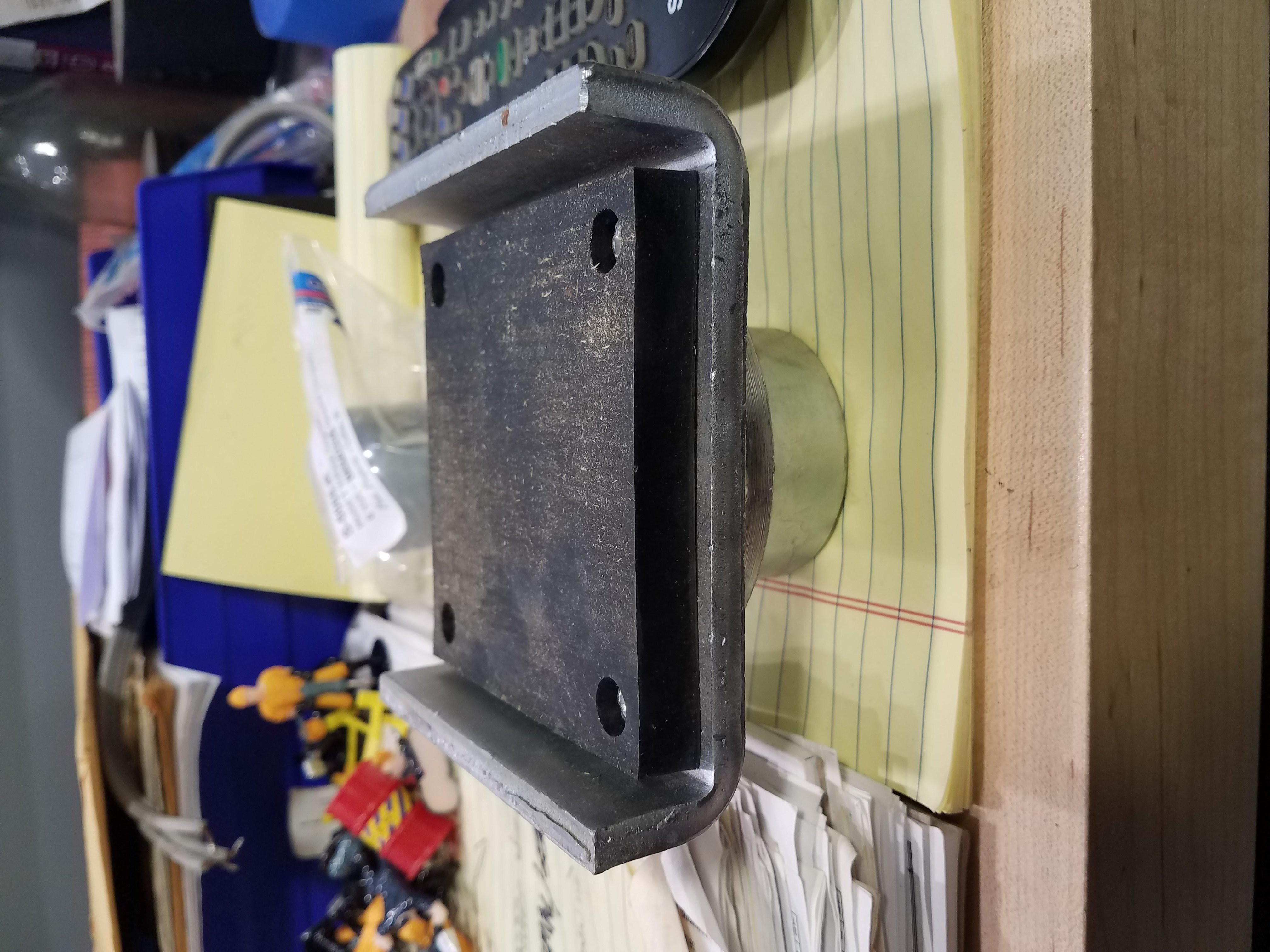

When I bought my Bendpac two post lift I ordered the extenders to use when lifting cars with high frame to ground clearance. No wood necessary. https://store.bendpak.com/tall-adapters/
Why did I decide on a two post lift? Many reasons. Removing wheels, axles, springs, ETC. that you can't do with your wheels raising your car on a four post lift. https://store.bendpak.com/car-lifts/?ca ... t_limit=24

TWrenn wrote:
Fri Jul 02, 2021 6:46 pm
Chris, it is not that hard to pull wheels, and in the case of two different cars, I've had the complete front axle and steering gear off them while on my 4 poster. In fact, with the ramps there to use for jacking and support, I would say the 4 poster made it easier than fighting with the cars axle and wheels hanging in the air.
You are welcome to do things the hard way. When I want to remove a front or rear axle it is far easier to do it on a two post rather than a four post. If you need to use a jack on your four post you might as well not have a lift.
Chris Haynes
Posts: 400
Joined: Tue Jun 25, 2019 8:00 pm
First Name: Chris
Last Name: Haynes
* REQUIRED* Type and Year of Model Ts owned: 1921 Runabout
Location: Camarillo. CA
Post by Chris Haynes » Fri Jul 02, 2021 7:09 pm
If you are concerned about scratching paint on the frame and don't want to put a few rags on it you can use these. https://store.bendpak.com/frame-cradle-pads/
big2bird
Posts: 722
First Name: Jeffrey
Last Name: Hausey
Post by big2bird » Sun Jul 04, 2021 10:02 pm
How tall are those?
Chris Haynes
Posts: 400
First Name: Chris
Last Name: Haynes
Post by Chris Haynes » Mon Jul 05, 2021 1:47 am
How tall are those?
When installed an inch or so.
