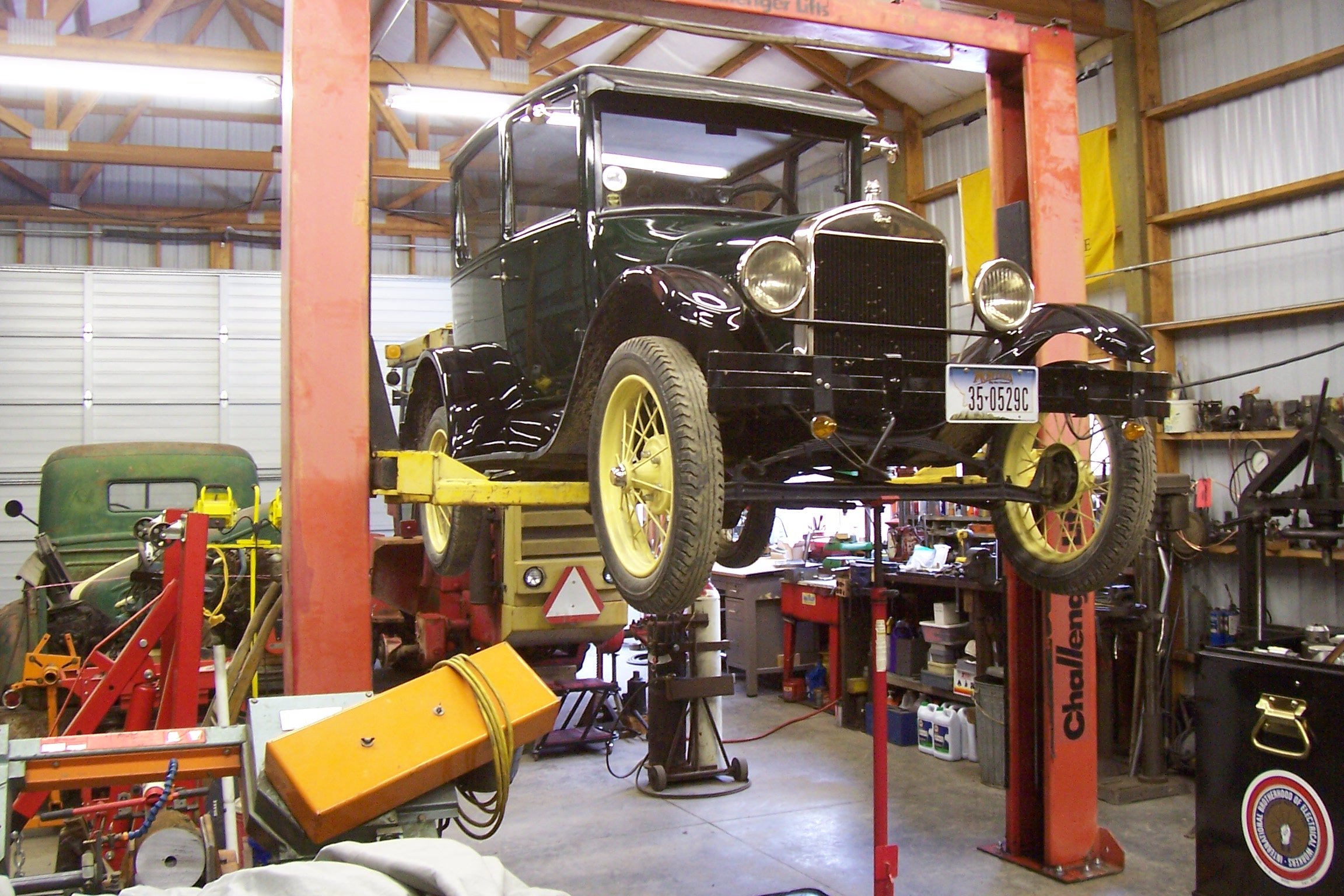

Yes.RustyFords wrote: ↑Wed Nov 11, 2020 8:12 amIs it practical, advisable or even possible to place a Model T on a 2-post lift?
- Posts: 3743
- Last Name: Wrenn
Re: Model T on a 2-post lift
Jeffrey...I see you use 4x4s as a method to support the suspension. Excellent idea. That looks like one hefty, expensive lift!!
- Posts: 631
- First Name: Jeffrey
- Last Name: Hausey
- Location: Anaheim, Ca.
Calculated for 1650 lbs, safety factor of 2, 1/4" deflection.
It has to be done correctly, but it can be done.

10' is what I bought. The load was calculated for a touring. You could use 4x6, and it would clear fine, for a heavier car.Les Schubert wrote: ↑Wed Nov 11, 2020 2:02 pmJeffery
Thank you for the information. I have a two post hoist which I use often. Right now it has my 67 Mercury M100 project on it(only in Canada)!!
I will pick up a pair of your suggested posts (10 ft should do nicely).
At 71 I REALLY hate crawling around on the floor!
I bought the frame saddles for my truck, and they hold a 4x nice, but not tight.
You will find you need a small spacer under the rear to lift level. 3/4" works fine.
Just make sure the lift points are within 16" of the axles, and your golden. The math changes dramatically further away from load.

My Challenger lift has factory risers that work great on my T's. Very stable.
I've had a 4 post WORTH chain lift for over 20 years. My new one is extra length with extra width ramps. I can raise my dually or a model T without moving the ramps. With a little ingenuity, I can also raise a golf cart or gator. I have 4 tall jack stands made for lift work. Raise the vehicle, place the stands, lower the lift some, and easily do wheel or brake work. I only needed a new lift because I sold my place with the old one and built a new shop. Cable lifts recommend changing cables every few years. Once installed, chain life never needed anything!
- Posts: 631
- Last Name: Hausey
Huh?Chris Haynes wrote: ↑Mon Jul 05, 2021 1:47 amWhen installed an inch or so.big2bird wrote: ↑Sun Jul 04, 2021 10:02 pmHow tall are those?Chris Haynes wrote: ↑Fri Jul 02, 2021 7:09 pmIf you are concerned about scratching paint on the frame and don't want to put a few rags on it you can use these. https://store.bendpak.com/frame-cradle-pads/
