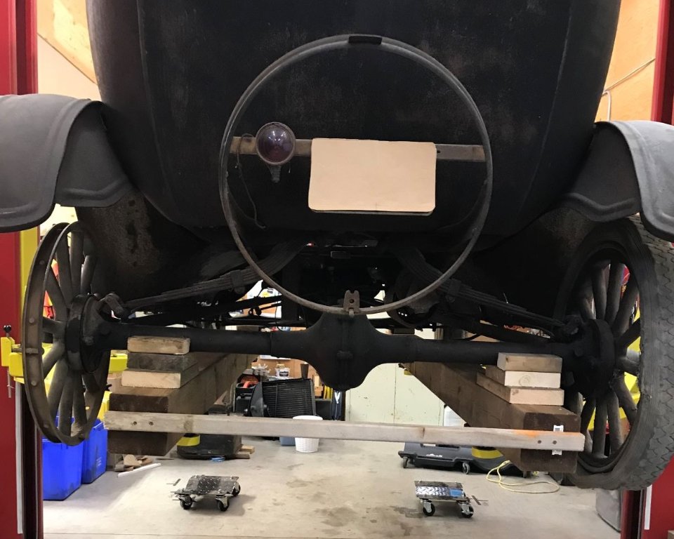

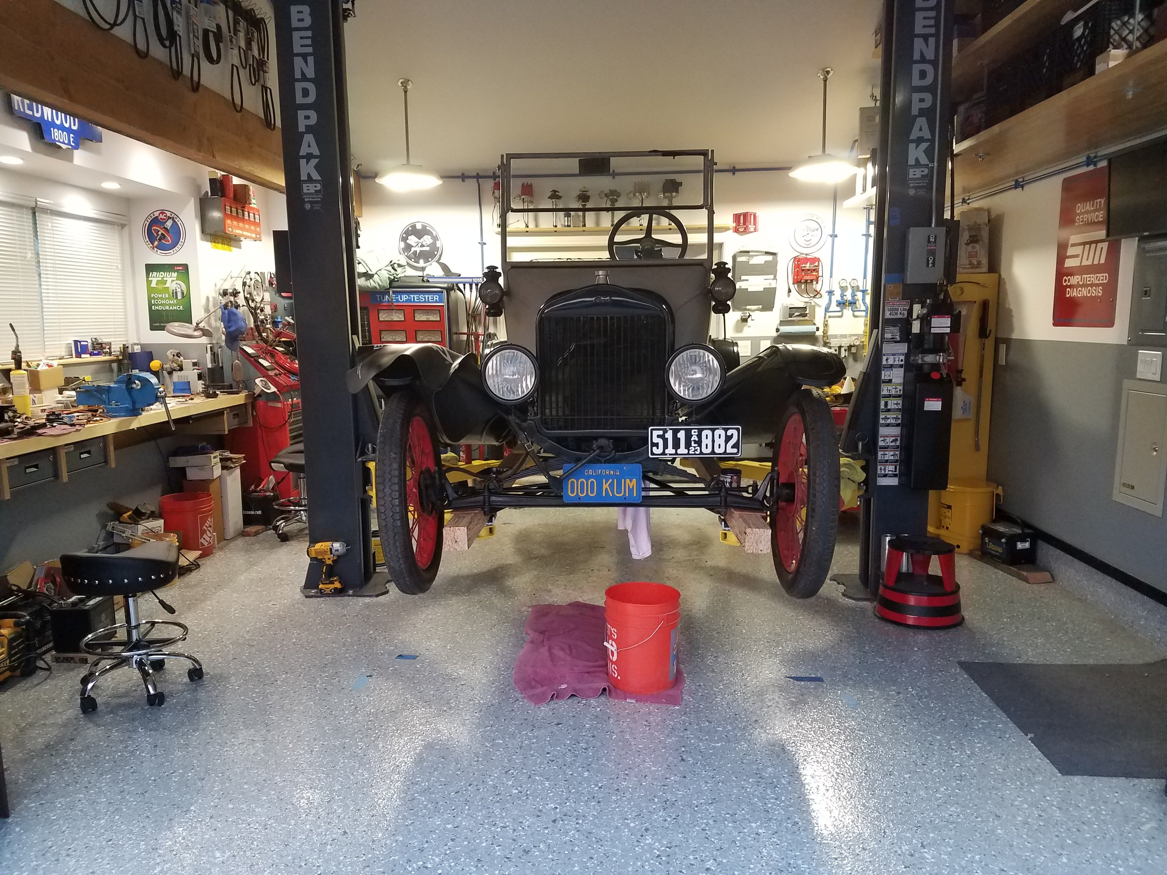

Re: Model T on a 2-post lift
Post by big2bird » Wed Nov 11, 2020 9:56 am
RustyFords wrote:
Wed Nov 11, 2020 8:12 am
Is it practical, advisable or even possible to place a Model T on a 2-post lift?
Yes.
Post by TWrenn » Wed Nov 11, 2020 10:14 am
Jeffrey...I see you use 4x4s as a method to support the suspension. Excellent idea. That looks like one hefty, expensive lift!!
big2bird
Posts: 650
First Name: Jeffrey
Last Name: Hausey
Location: Anaheim, Ca.

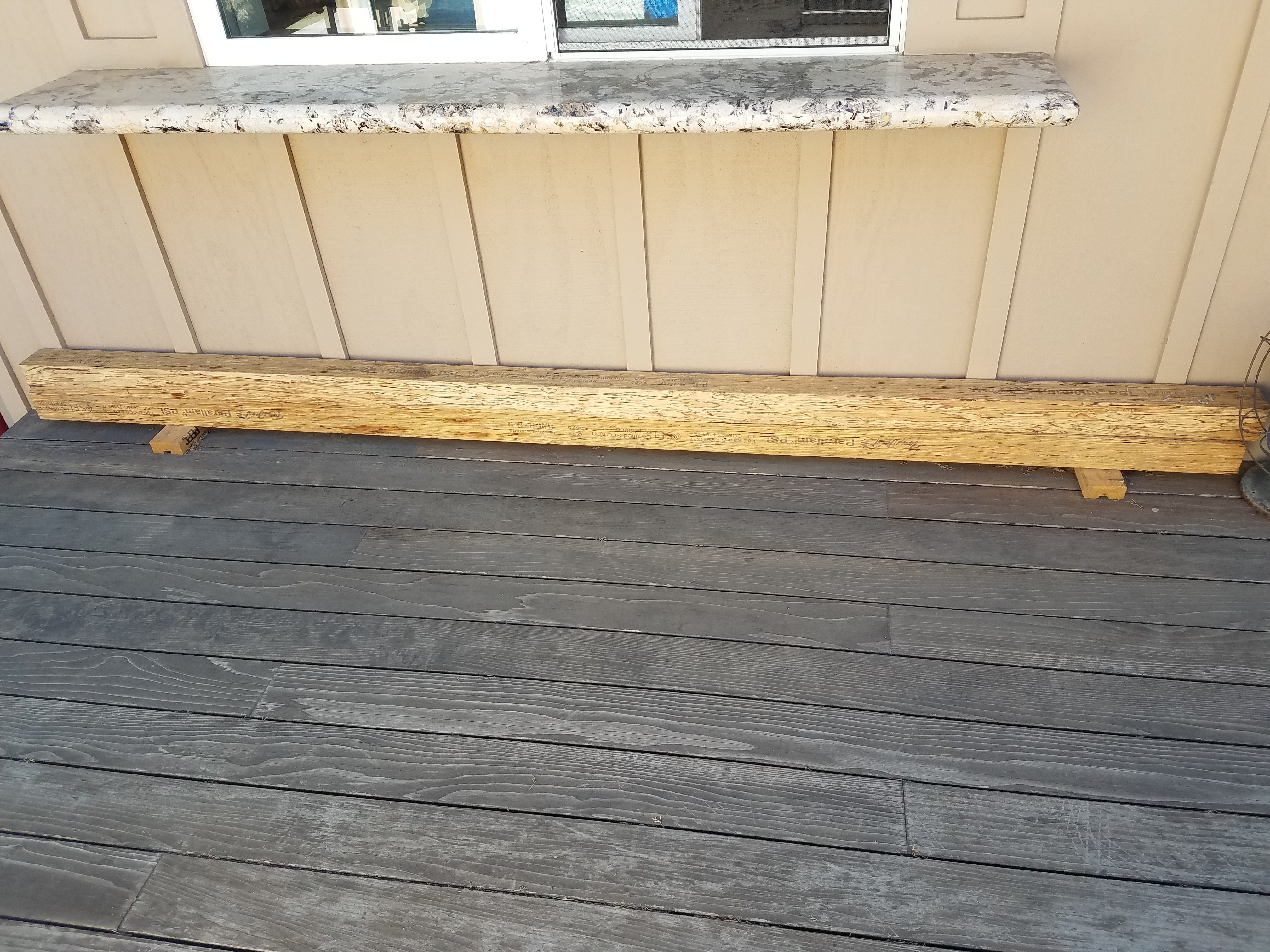

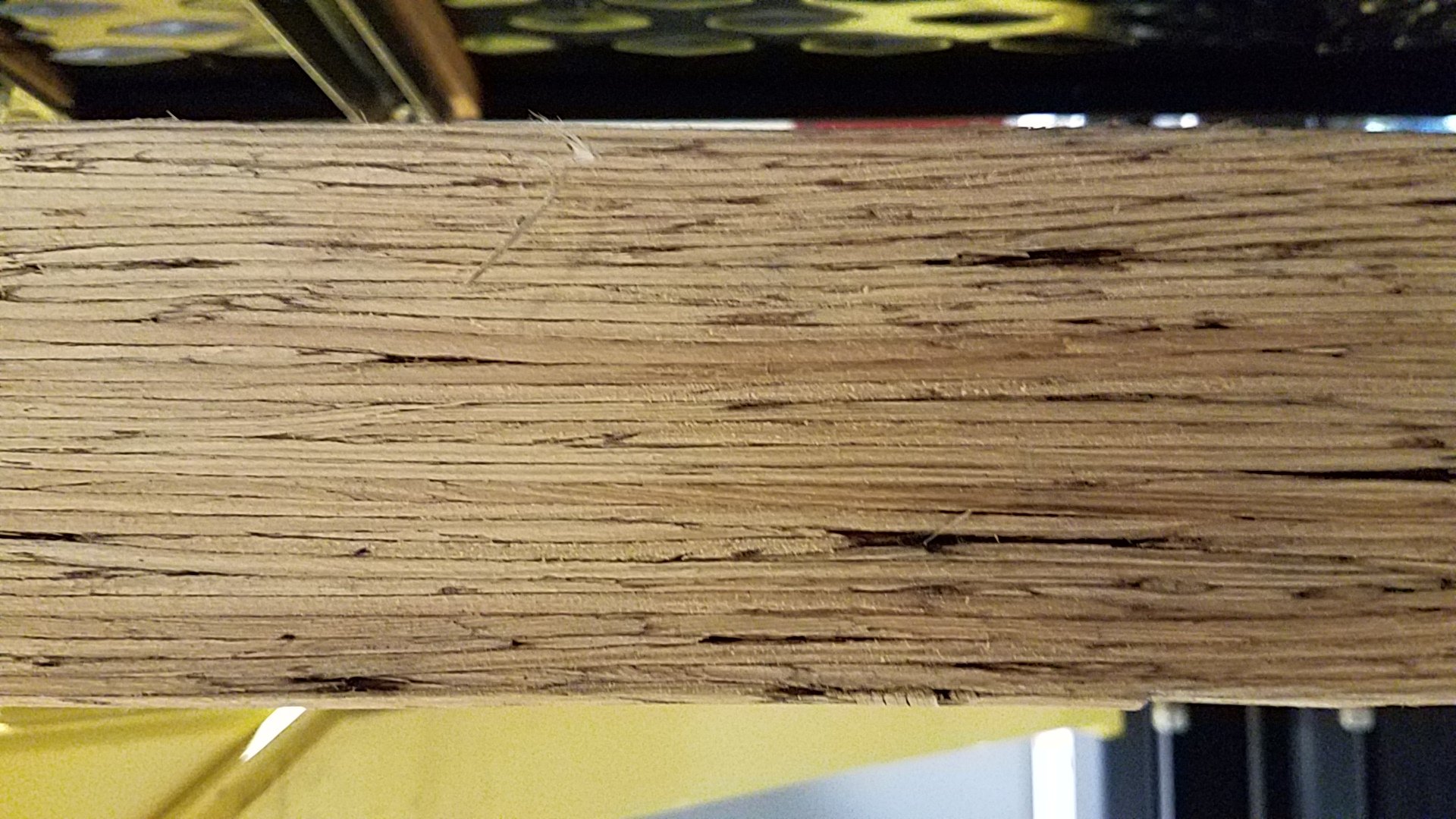

Post by big2bird » Wed Nov 11, 2020 10:32 am
They are 4x4 PSL posts. My best friend is a structural engineer.
Regular 4x4 No.1 didn't cut the math.
big2bird
Posts: 650
First Name: Jeffrey
Last Name: Hausey
Post by big2bird » Wed Nov 11, 2020 10:44 am
The posts are within 16" of each axle, on frame saddles.
Calculated for 1650 lbs, safety factor of 2, 1/4" deflection.
It has to be done correctly, but it can be done.
Post by big2bird » Wed Nov 11, 2020 11:02 am
I work on Corvettes on the side.
This is a 99 C5R factory race engine here right now.
The lift can hold the T all the way up, and I can park my C3 corvette underneath.
On a two post, checking wheels, brakes, alignment, etc. on the T is easy.
The T is on a friends 4 post right now till I get this restoration finished.

If you are concerned about scratching paint on the frame and don't want to put a few rags on it you can use these. https://store.bendpak.com/frame-cradle-pads/
How tall are those?

How tall are those?
When installed an inch or so.

I've had a 4 post WORTH chain lift for over 20 years. My new one is extra length with extra width ramps. I can raise my dually or a model T without moving the ramps. With a little ingenuity, I can also raise a golf cart or gator. I have 4 tall jack stands made for lift work. Raise the vehicle, place the stands, lower the lift some, and easily do wheel or brake work. I only needed a new lift because I sold my place with the old one and built a new shop. Cable lifts recommend changing cables every few years. Once installed, chain life never needed anything!
