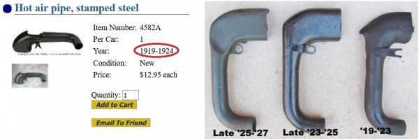

I have not had good results with the reproduction hot air pipes. The originals aren't that hard to find, check on Ebay or post a wanted ad on the Classifieds. Your '26 should have the one-piece pipe as shown here:

The late '25s use the swivel adjustment too, but don't require the relief in the hot air pipe, but I have one on my car anyway. I agree, stay away from the repro hot air pipes, there are too many originals around.

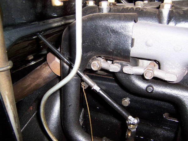

The early new one will work.
It is just a case of cut to specification, pound to fit, and paint to match.
The top area has to be pounded in about 1/4 to 3/8th inch in line with the choke/ mixture rod (as Mark's photo shows), and the hole for the exhaust clamp has to be cut out more on the bottom or top, I forget which way, but then it will work OK, and last a long time.
