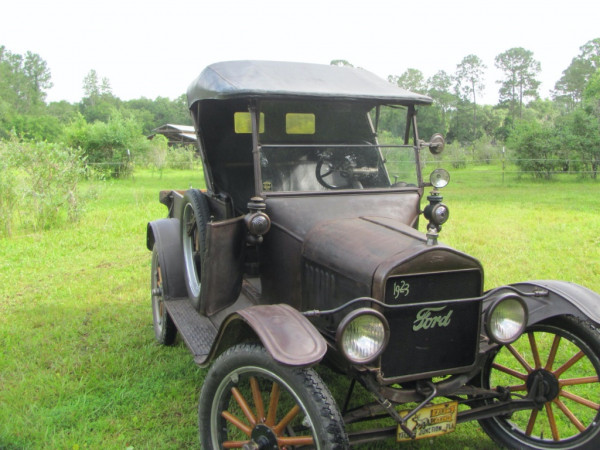

I got the one for the '23 cut off barn T from Dan Hatch, who lives in Birmingham, perhaps he could round up another.

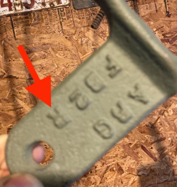

Have a buddy in GA who has this Right hand brace, but needs a Left hand one too.....that rear brace will have the same markings but a "L" in the casting letters on the mounting leg.
ARG Rear
Looking for this style But with an "L" in the casting, not the R in this photo.
