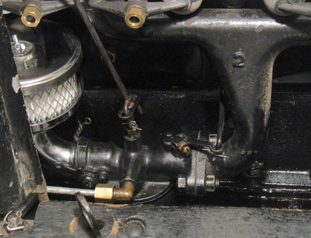

I've always used rattle can Rustoleum satin black. I dislike glossy paint on chassis parts. The Rustoleum doesn't need a primer.
Since this pictire was taken I've painted the filter. Same paint.
