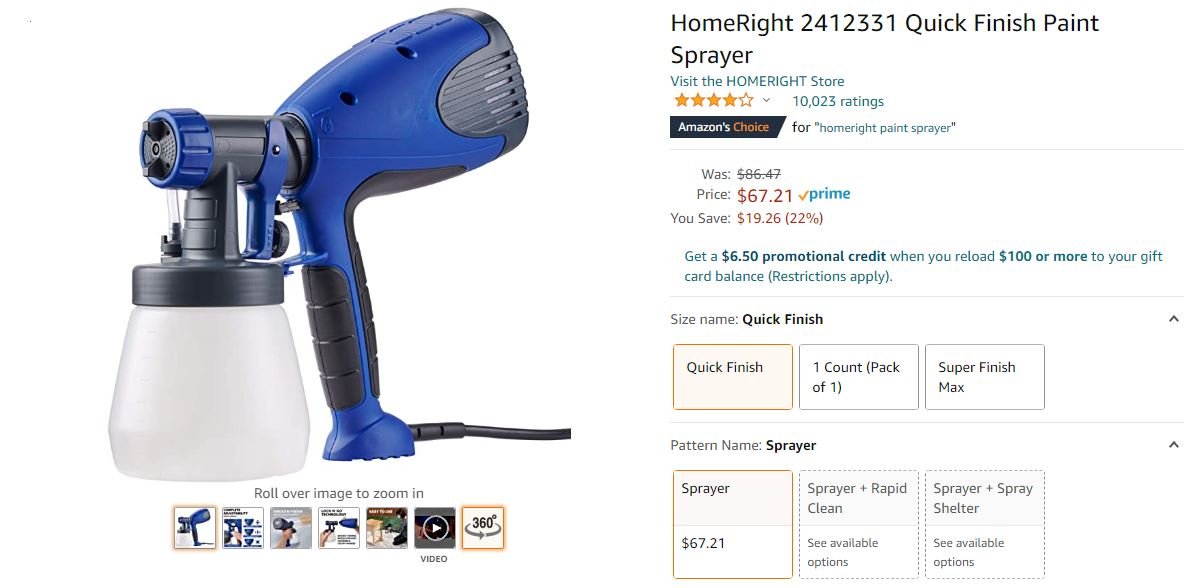

Hi, I used personnaly an electric Paint Sprayer which is cheap and work really well. I used for  Engine Enamel paint or personal use at home.
The one I used cost me only $67 in Canadian dollars on Amazon. It may cost ONLY $46 US$ and you can choose the paint you like.
