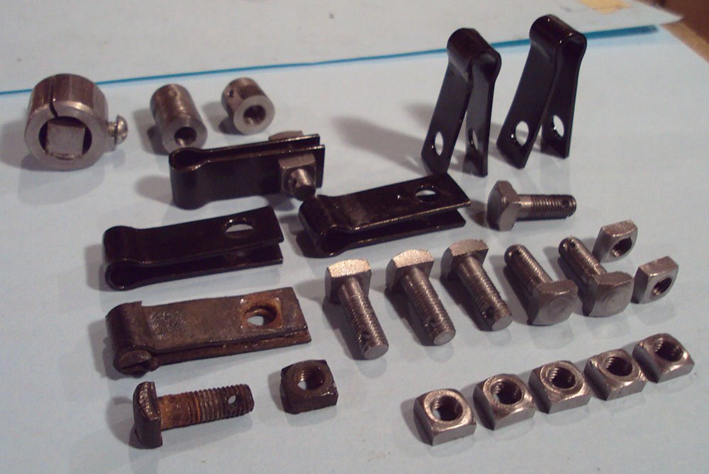

P/N 3088 is engine pan bolt 09-12 uses 7 of them. 1/4" x 9/16" I believe they were 28 tpi and have square heads bolts drilled for cotter pins.
Yet used square nuts. (!)
P/N 3088B is engine pan and hood board bolt and nut '09-'15 1/4" x 3-1/4" (short) (2 req)
P/N 3088C is engine pan and hood board bolt and nut '09-'15 1/4" x 3-5/8" (size) (? req)
I wish I could be more help. Maybe someone has some pics of original "engine dust shields," bolts, and nuts.

Keith, what are the clamps in your picture for? Tim

The clamps are for acetylene headlamp gas lines.

Keith do you make them or have any for sale? I need one for a 1914. Thanks Tim

No, I don't but they are not too difficult to make.
I don't remember the exact dimensions, but for my 1911 they are about 1/2" wide, and 1-3/4" long with a 1/4" loop in the end.
One link below has Rich Eagle's specifications. I recently learned that the photo I posted is his.

I'm resurrecting this post because I have a question as to the length of the earlier style engine pan hardware with the square heads. I'm making my own bolts and ned to know the actual length from under the head to the end of the bolt. I saw two dimensions posted 9/16 and 25/32. Can anyone with the hardware give a dimension from under the head to the end of the bolt?

I too made my own square head bolts, and built to the lengths shown here. I put the cotter pin holes as close to the ends of the screws as I could get.. Parts are a tight fit, but they do fit. I can imagine that repro gas line clamps of incorrect heavier gauge, could be a watch out here.
