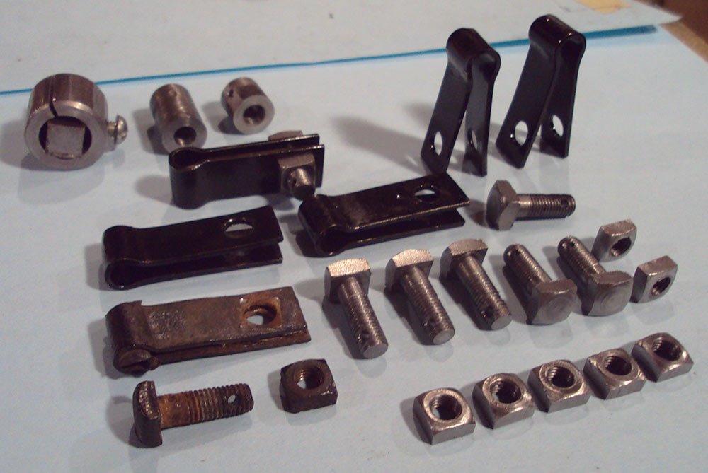

P/N 3088 is engine pan bolt 09-12 uses 7 of them. 1/4" x 9/16" I believe they were 28 tpi and have square heads bolts drilled for cotter pins.
Yet used square nuts. (!)
P/N 3088B is engine pan and hood board bolt and nut '09-'15 1/4" x 3-1/4" (short) (2 req)
P/N 3088C is engine pan and hood board bolt and nut '09-'15 1/4" x 3-5/8" (size) (? req)
I wish I could be more help. Maybe someone has some pics of original "engine dust shields," bolts, and nuts.

Keith, what are the clamps in your picture for? Tim

The clamps are for acetylene headlamp gas lines.

Keith do you make them or have any for sale? I need one for a 1914. Thanks Tim
- Posts: 1521
- First Name: Keith
- Last Name: Townsend
- Location: Gresham, Orygun
Re: Engine pan hardware?
No, I don't but they are not too difficult to make.
I don't remember the exact dimensions, but for my 1911 they are about 1/2" wide, and 1-3/4" long with a 1/4" loop in the end.
One link below has Rich Eagle's specifications. I recently learned that the photo I posted is his.
There is some more information here:
http://www.mtfca.com/discus/messages/506218/540853.html
http://www.mtfca.com/discus/messages/33 ... 1371823897
http://www.mtfca.com/discus/messages/50 ... 1436287370

I too made my own square head bolts, and built to the lengths shown here. I put the cotter pin holes as close to the ends of the screws as I could get.. Parts are a tight fit, but they do fit. I can imagine that repro gas line clamps of incorrect heavier gauge, could be a watch out here.
