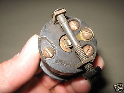

Here you go:
horn-headlight combo switch Ford.jpg (17.11 KiB) Viewed 3251 times
The head of the screw and the nut are very, very thin.

The photo above is not correct! The part in question is a screw, and is smaller than what is pictured. I detest people posting information like this! The originals were 6-32 X 1 1/2", raven finished. The nut is hex. I have several of these. I pick them up when at Hershey and other places.

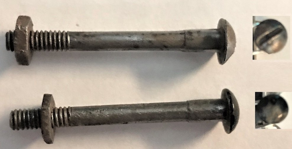

Larry, are either of these correct? Similar style screws but one is slotted and the other is slightly smaller head diameter and no slot. Also different thickness hex nuts. Both were in dirty horn buttons Thanks

Thanks for posting the examples. Pictures are so helpful.

Your original response prompted me to see if I had a correct screw nut combination to match your description (The originals were 6-32 X 1 1/2", raven finished.) So are any of these parts not or screw correct.?

The first picture I posted was harvested off the interweb. I wish I could give the image owner credit.
I have seen both thin and thick nuts like in the image Frank posted. Mine has the thin nut (and its really hard to put it together!)
100% original.
Keep in mind that Ford sourced parts and fasteners from more than one supplier.

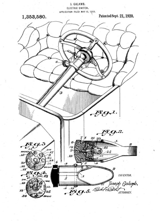

Post by KWTownsend » Tue Apr 05, 2022 1:23 pm

Thanks for all the input fellas, hey....it's early April so I'm the fool who lost the hardware but the posts are priceless and informative.
That sketch of the assembly is great KW.
