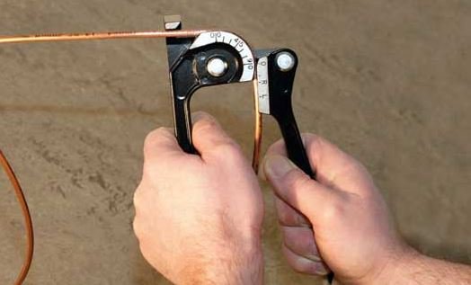

Pretty easy to bend steel line. Many auto parts stores sell a relatively inexpensive hand held bending tool for brake line. The tool helps to prevent kinks.

These simple tubing benders will work and are inexpensive. Available at most home improvement stores.

Back in January, I went to Auto Zone and purchased tube bending pliers for $10.99. They worked great for my project.

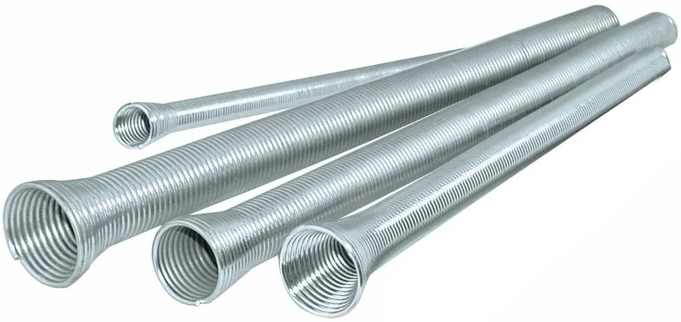

If using copper, it is recommended to bend a full loop in the line (about 6 to 8 inches diameter is fine- usually placed just under the fuel tank on the T), this helps control vibration / lessen work hardening effect over time.
This is a topic with very strong views, please respect that some of us have been using copper for decades with no issues. Choice of steel is fine with its own merits.

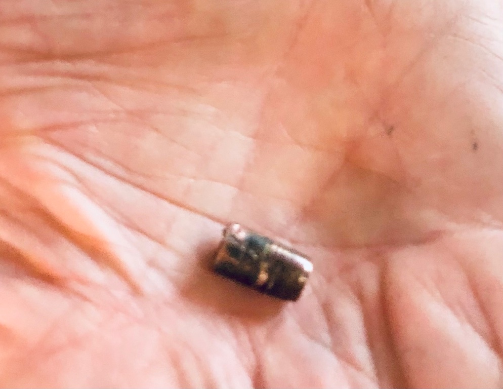

Copper tubing & compression rings dont mix. I have seen 2 potentially catastrophic failures ON THE SAME T.

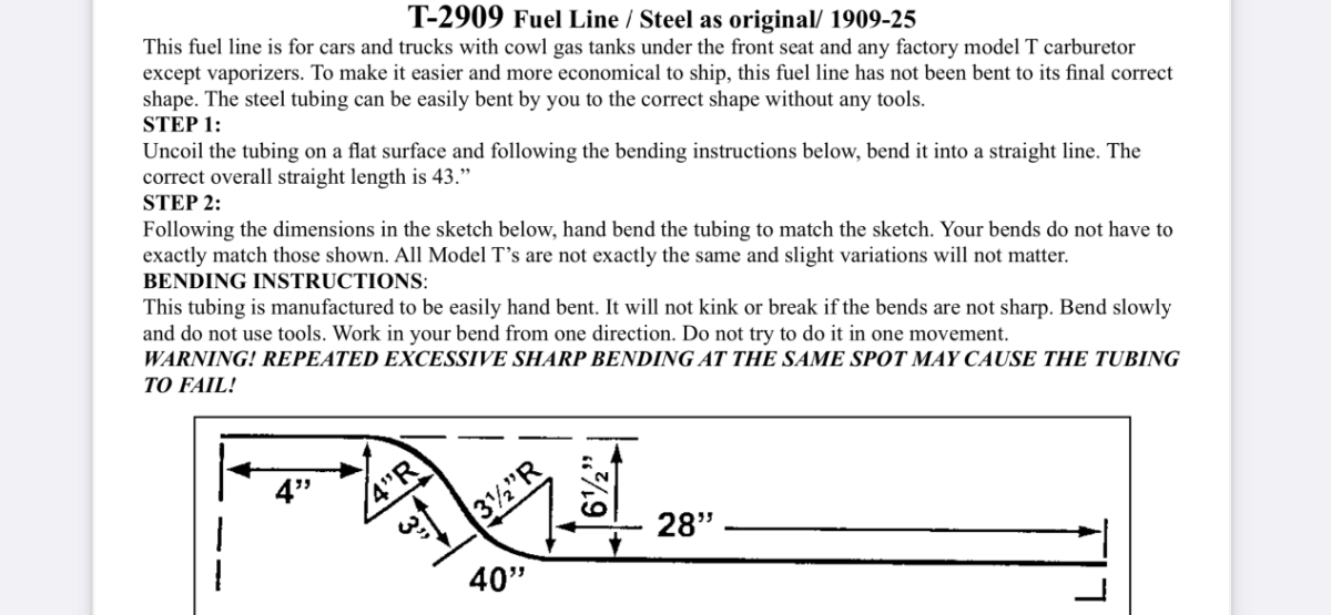

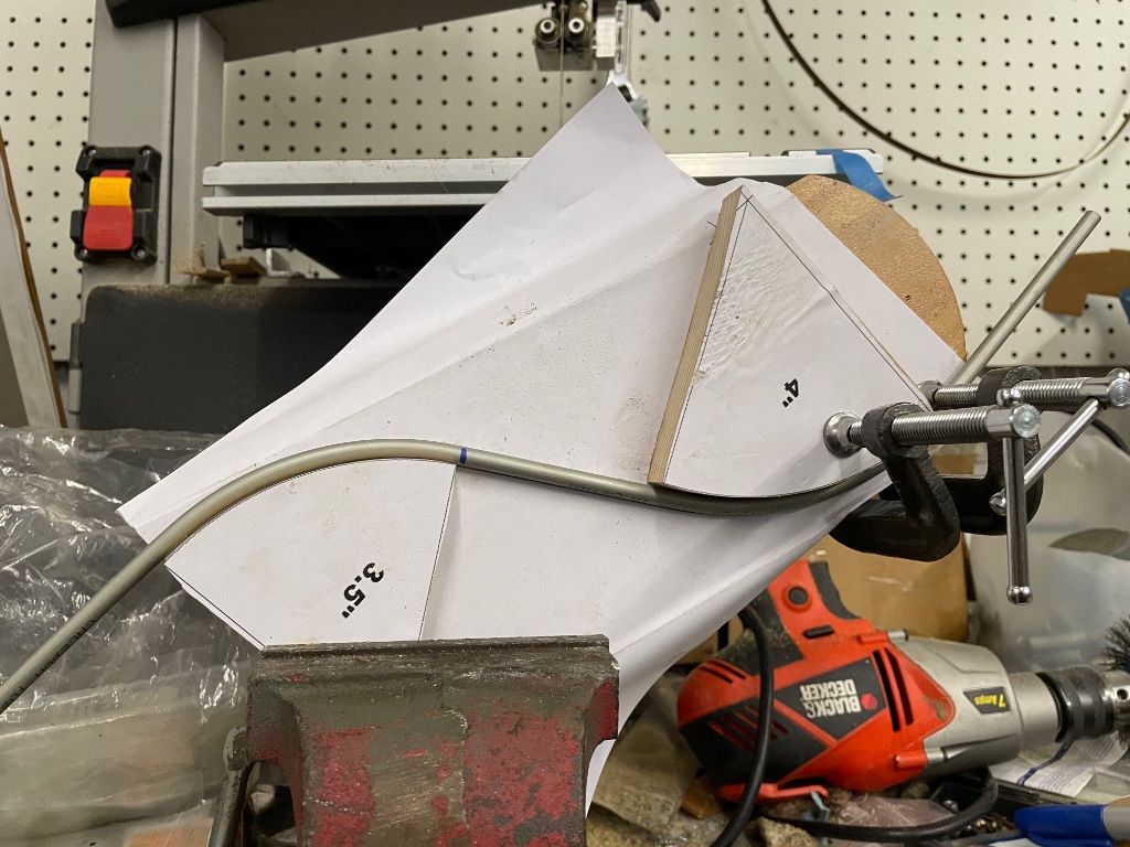

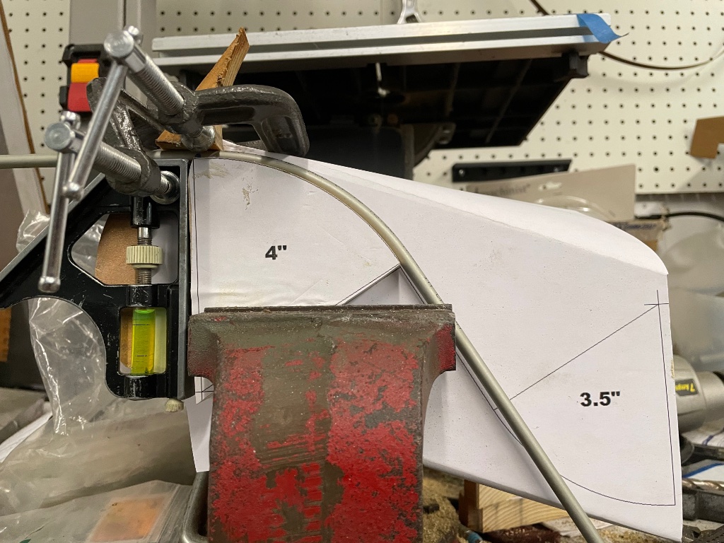

I bought a steel fuel line from Snyder’s, and it came with a sketch showing 3.5 and 4 inch radius bends at specific positions. I made up a couple of wood bending dies at those radii, clamped them and the fuel line to another board and made the bends by hand. Looking at the finished line you can’t tell they weren’t made on a machine. I used the Windows Paint program to lay out the patterns for the dies, but a protractor and drafting compass would work fine. The attached photos show the sequence of making the bends (the first bend needs to be made with only one die in place because you have to overbend to account for springback). Even though my resulting line matches the sketch, it will need a little tweaking to fit exactly, but it’s a good start.
Miles

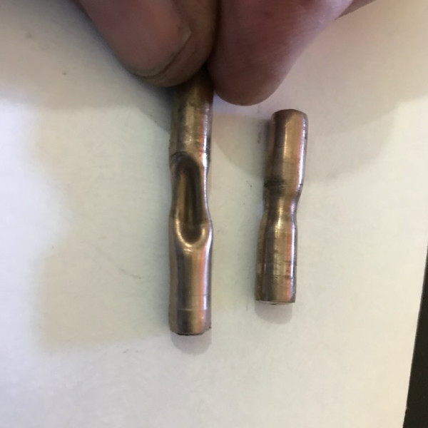

I started out with nickel-copper tubing for a fuel line....big mistake. I started to get a little leakage at the carb fuel valve. Upon examination, found that the end in the compression fitting was distorted (right pix.) Checking the sediment bowl it was even worse (left pix.) Replaced it with steel brake line which bent easily by hand with no kinks. If you're concerned, lay it across a curved surface like a tin can or the like when bending it.

I intend to use steel brake line, but am confused about the size. On Royce's website they say quarter inch O. D. is good. That would probably be about 3/16" I. D." which seems small to me. Somewhere on here I saw 5/16" would be best. Is brake line available in both sizes?
Which is best? On the bending diagrams shown in these replies which end goes toward the sediment bowl? Some people have said it goes above the exhaust and some have said put it under the exhaust ?

I appreciate the drawing for the bends in the fuel line. However, it would have been nice if the drawing would have included the angle of the bends. After some ciphering, I determined that each angle should be bent at 61 degrees.
This assumes that the dimensions are at the center line of the tubing. The solution to this involves a statically indeterminate equation.

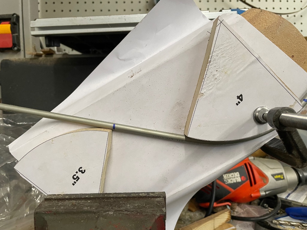

I noticed the same thing and did the same math. I laid them out using 60 degrees. I figure there are small differences car to car and it would need a little tweaking on installation.Art M wrote: ↑Sun Apr 10, 2022 3:40 pmI appreciate the drawing for the bends in the fuel line. However, it would have been nice if the drawing would have included the angle of the bends. After some ciphering, I determined that each angle should be bent at 61 degrees.

I believe the 4” straight end comes out of the sediment bowl and the 28” straight end goes toward the carburetor (assuming the drawing is right side up).bill goodheart wrote: ↑Sun Apr 10, 2022 3:18 pm… On the bending diagrams shown in these replies which end goes toward the sediment bowl?…

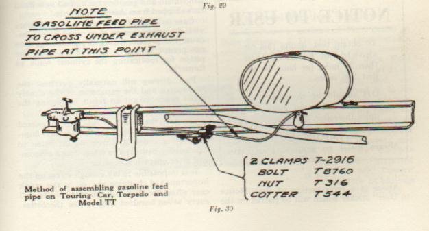

This might help a bit. From a 1922 Ford Service Bulletin.

Thanks Miles that is what I need to know, Thanks to Tim for the drawing from the service bulletin that is also very helpful.

I have something similar for bending aircraft fuel lines but wanted to follow the instructions from Snyder’s, which call for larger radii than my tool can form; that’s why I came up with the wood dies.

Tim, your photo is an excellent example of why copper tubing should not be used.
By the time the nut attaching the coper line to the carburetor is tight enough to prevent a slight fuel drip, the tubing is squeezed almost shut and restricts the gas flow too where th car cannot fill up fast enough to accelerate your speed.
The bending photo does not sow which end goes to the fuel tank and may leave a person wondering.
The bend is closest to the fuel tank when properly installed and 3 inches usually have to be cut off the long straight section.
The line has to be installed first to verify the cut off part.
It also goes between the transmission cover and exhaust pipe.

Time line is different base on personnal reality. When I said to wife I'm gonna take 5 minutes for a job she already know it will take me several hours...
But related to this topic, it took me 2 hours because I bent and measure the fuel line couple time under the car and didn’t fit on the first try. I'm may slow person but Also I'm not very flexible person too...
