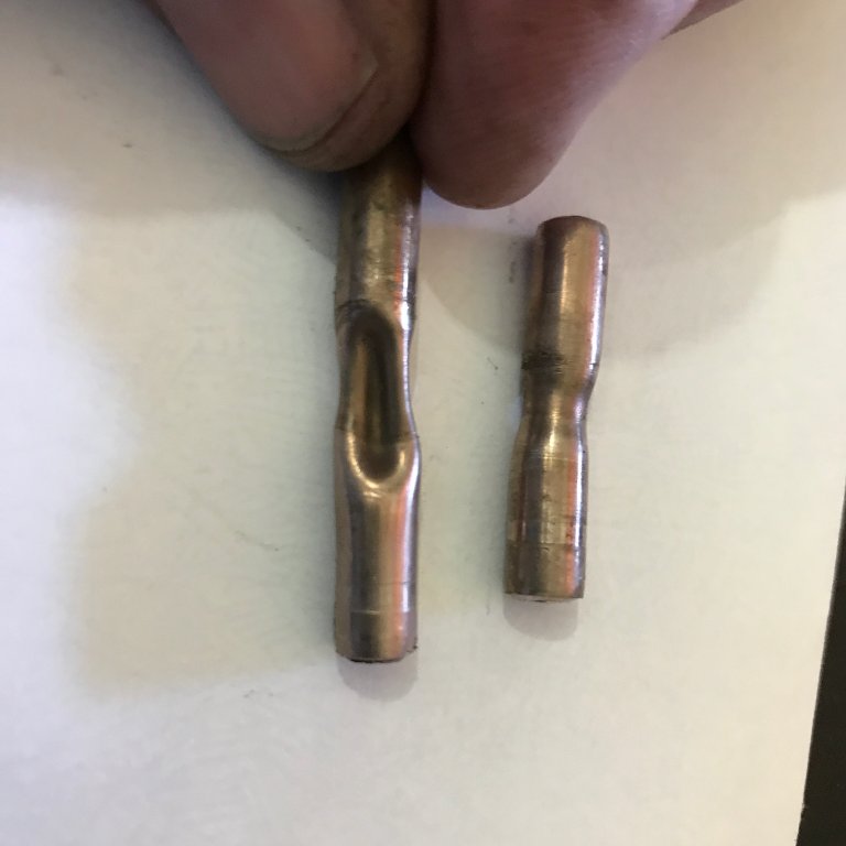

Copper tubing & compression rings dont mix. I have seen 2 potentially catastrophic failures ON THE SAME T.
Some guys dont listen or learn.

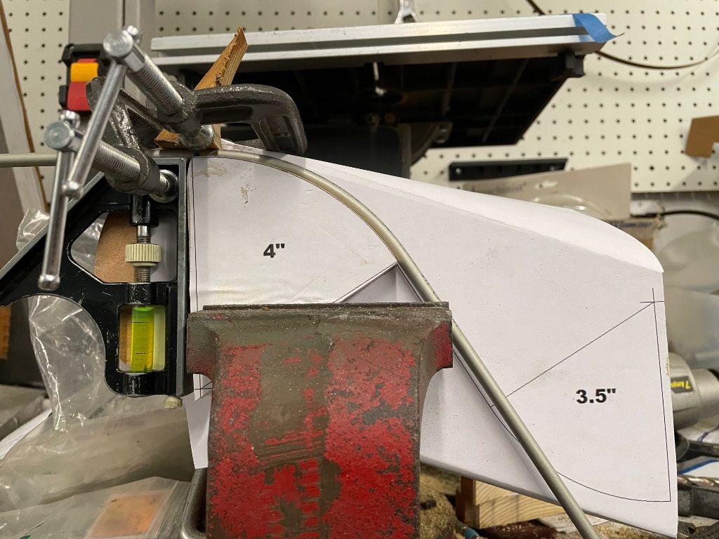

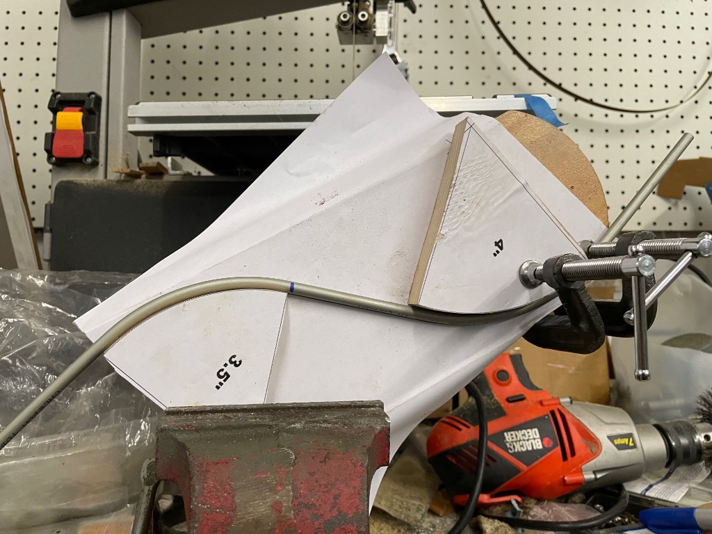

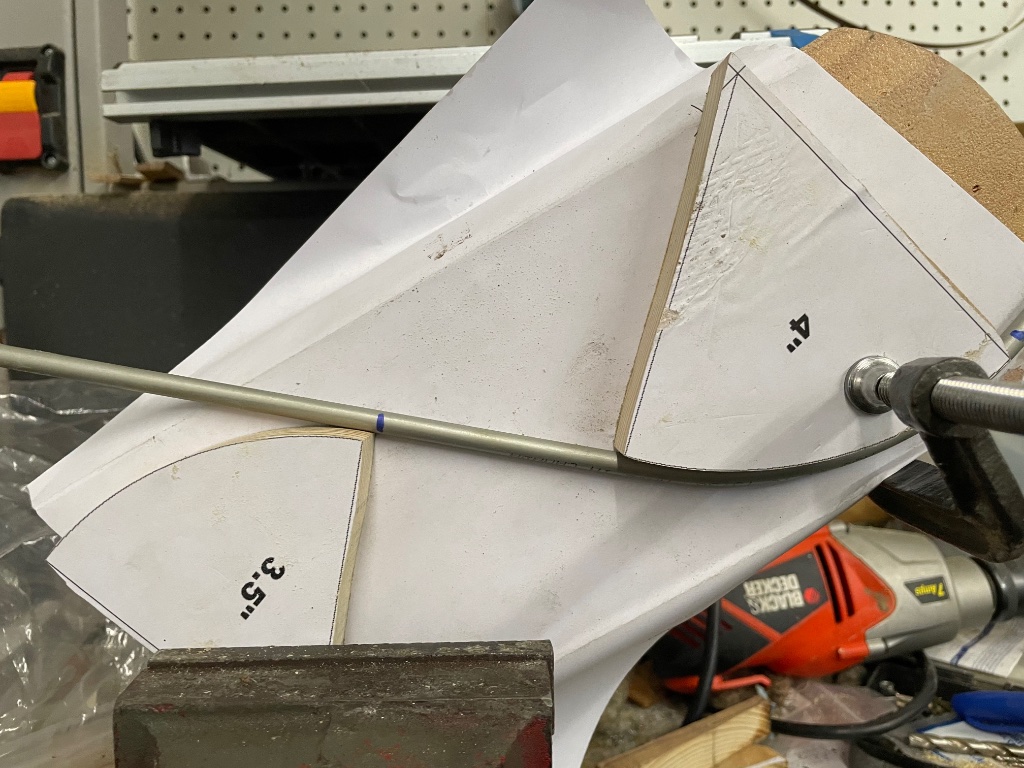

I bought a steel fuel line from Snyder’s, and it came with a sketch showing 3.5 and 4 inch radius bends at specific positions. I made up a couple of wood bending dies at those radii, clamped them and the fuel line to another board and made the bends by hand. Looking at the finished line you can’t tell they weren’t made on a machine. I used the Windows Paint program to lay out the patterns for the dies, but a protractor and drafting compass would work fine. The attached photos show the sequence of making the bends (the first bend needs to be made with only one die in place because you have to overbend to account for springback). Even though my resulting line matches the sketch, it will need a little tweaking to fit exactly, but it’s a good start.
Miles

I started out with nickel-copper tubing for a fuel line....big mistake. I started to get a little leakage at the carb fuel valve. Upon examination, found that the end in the compression fitting was distorted (right pix.) Checking the sediment bowl it was even worse (left pix.) Replaced it with steel brake line which bent easily by hand with no kinks. If you're concerned, lay it across a curved surface like a tin can or the like when bending it.

For those who use compression collar on copper line, snugged in the nut… here is another fracture causing carb leak. Failure after quite a few years, the crimp to the copper line by that compression collar ‘done it in’ ;) Lots of vibration on the Ford.

Post by mbowen » Sun Apr 10, 2022 7:02 pm
Art M wrote:
Sun Apr 10, 2022 3:40 pm
I appreciate the drawing for the bends in the fuel line. However, it would have been nice if the drawing would have included the angle of the bends. After some ciphering, I determined that each angle should be bent at 61 degrees.
This assumes that the dimensions are at the center line of the tubing. The solution to this involves a statically indeterminate equation.
Art Mirtes
I noticed the same thing and did the same math. I laid them out using 60 degrees. I figure there are small differences car to car and it would need a little tweaking on installation.
Miles
1924 Touring “Bonnie”
1925 Express Wagon “Clyde”

Post by mbowen » Sun Apr 10, 2022 7:15 pm
bill goodheart wrote:
Sun Apr 10, 2022 3:18 pm
… On the bending diagrams shown in these replies which end goes toward the sediment bowl?…
I believe the 4” straight end comes out of the sediment bowl and the 28” straight end goes toward the carburetor (assuming the drawing is right side up).
Miles

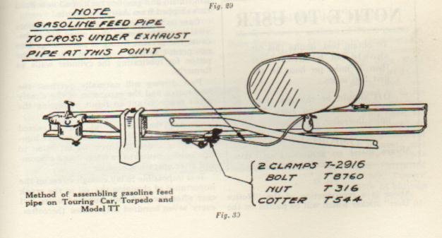

Post by Oldav8tor » Sun Apr 10, 2022 7:53 pm
This might help a bit. From a 1922 Ford Service Bulletin.

Post by bill goodheart » Sun Apr 10, 2022 8:04 pm
Thanks Miles that is what I need to know, Thanks to Tim for the drawing from the service bulletin that is also very helpful.

MichaelPawelek wrote:
Wed Apr 13, 2022 1:05 pm
im
Sometimes I think we make things to complicated. Just bend the line similar to the pictures posted. Install and semi tighten at the carburetor. Then get under the T and carefully bend the line with your hands in a smooth curve making sure it is as far away from the tail pipe as necessary and then to the potato. This is really only a 5 minute job. :)
Guilty as charged. If a 5- minute job takes me less than an hour I go back and see what I missed. :lol: In my defense however, when I bent my fuel line my car was up on jackstands for a front axle overhaul and I wasn’t comfortable being under it. I strongly suspected that a fuel line bent exactly to the sketch wouldn’t fit on the first try; I just wanted to get a head start on it.

Tim, your photo is an excellent example of why copper tubing should not be used.
By the time the nut attaching the coper line to the carburetor is tight enough to prevent a slight fuel drip, the tubing is squeezed almost shut and restricts the gas flow too where th car cannot fill up fast enough to accelerate your speed.
The bending photo does not sow which end goes to the fuel tank and may leave a person wondering.
The bend is closest to the fuel tank when properly installed and 3 inches usually have to be cut off the long straight section.
The line has to be installed first to verify the cut off part.
It also goes between the transmission cover and exhaust pipe.

James
I have copper fuel lines. Never a problem and no crimping. Neoprene or felt, whatever I have handy. Just make sure the line is a bit long so it pushes into the fitting and cannot fall out.
