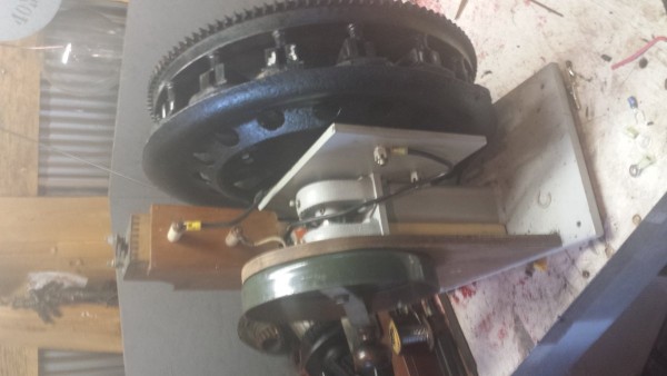

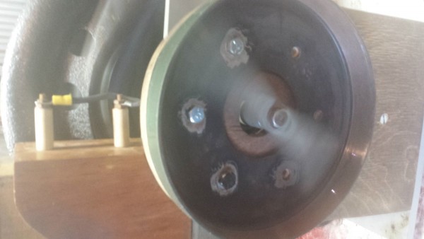

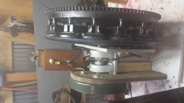

Here are some pics of my hcct. It was given to
Me in pieces by a fellow club member who
Scored a factory made one. I redid some of the
Frame and re wound 3 of the coils using masking
Tape. It is made by the plans that are on the
Board. It works great now I need a meter.

Re: hand crank coil tester
Click the pics and they go right side up?

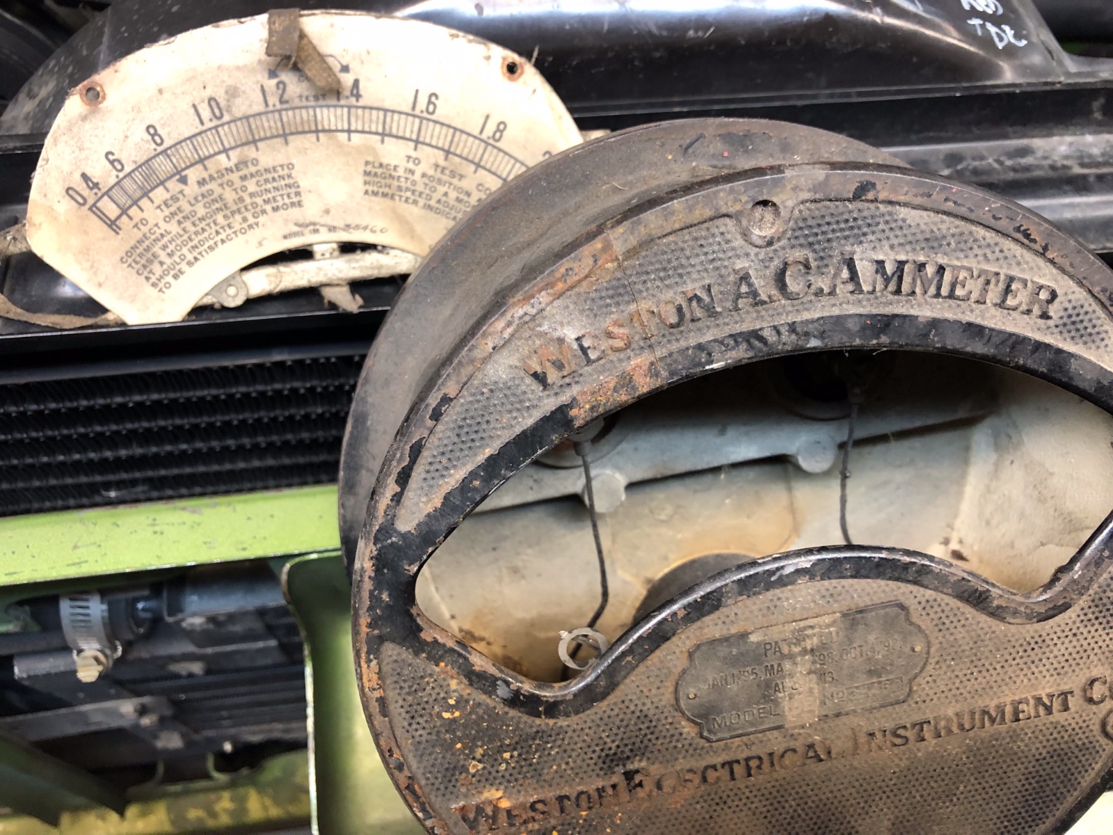

Philp, I have an original Weston form a Ford HCCT that I know nothing about. The scale plate is out of it but the movement is free. I understand there is a member that restores and calibrates them. you can PM me if you like.
