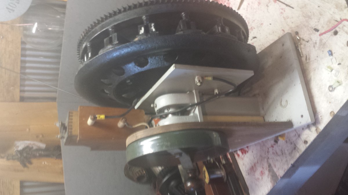

Here are some pics of my hcct. It was given to
Me in pieces by a fellow club member who
Scored a factory made one. I redid some of the
Frame and re wound 3 of the coils using masking
Tape. It is made by the plans that are on the
Board. It works great now I need a meter.

Click the pics and they go right side up?
