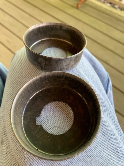

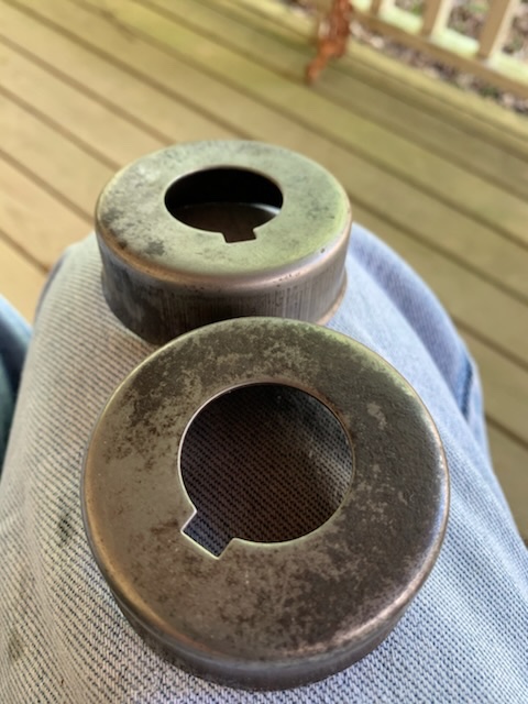

Post by Dan Hatch » Sun Apr 09, 2023 11:44 am
Is this what you looking for?
Email me Larry. Dan

Post by speedytinc » Sun Apr 09, 2023 1:12 pm
Email me Larry. Dan
I believe the flared flanges indicate the later caps.

Post by Dan Hatch » Sun Apr 09, 2023 6:12 pm
I don’t know anything about flanges, but these start on a housing for a 15 WT and will not even try to start on a 26 housing.
Came out of a Ford dealer in the 50s. Dan

Post by Original Smith » Tue Apr 11, 2023 11:07 am
John Von Karvaly nailed it. I believe the photos Dan posted are the later design. I don't understand what toilet paper has to do with this post!

Post by speedytinc » Tue Apr 11, 2023 1:15 pm
They are a tight hammer on fit. If they will slip on an early (15) housing, without a hammer, they are the later size. Seeming to not start on a later housing would be a normal situation. They fit that tight.
The early cups typically dont have the curved flange on the edge.

Post by slang250 » Thu Apr 27, 2023 11:33 am
Be careful when checking original unused caps if they are the early version or later version.
Ford did make some of the earlier smaller diameter caps with with the flange on them.
The ID of the caps should be 2.382-2.384" on the earlier smaller caps if NOS and 2.429-2.431" on the later NOS larger caps.
We have a few pairs of NOS smaller diameter caps available.
