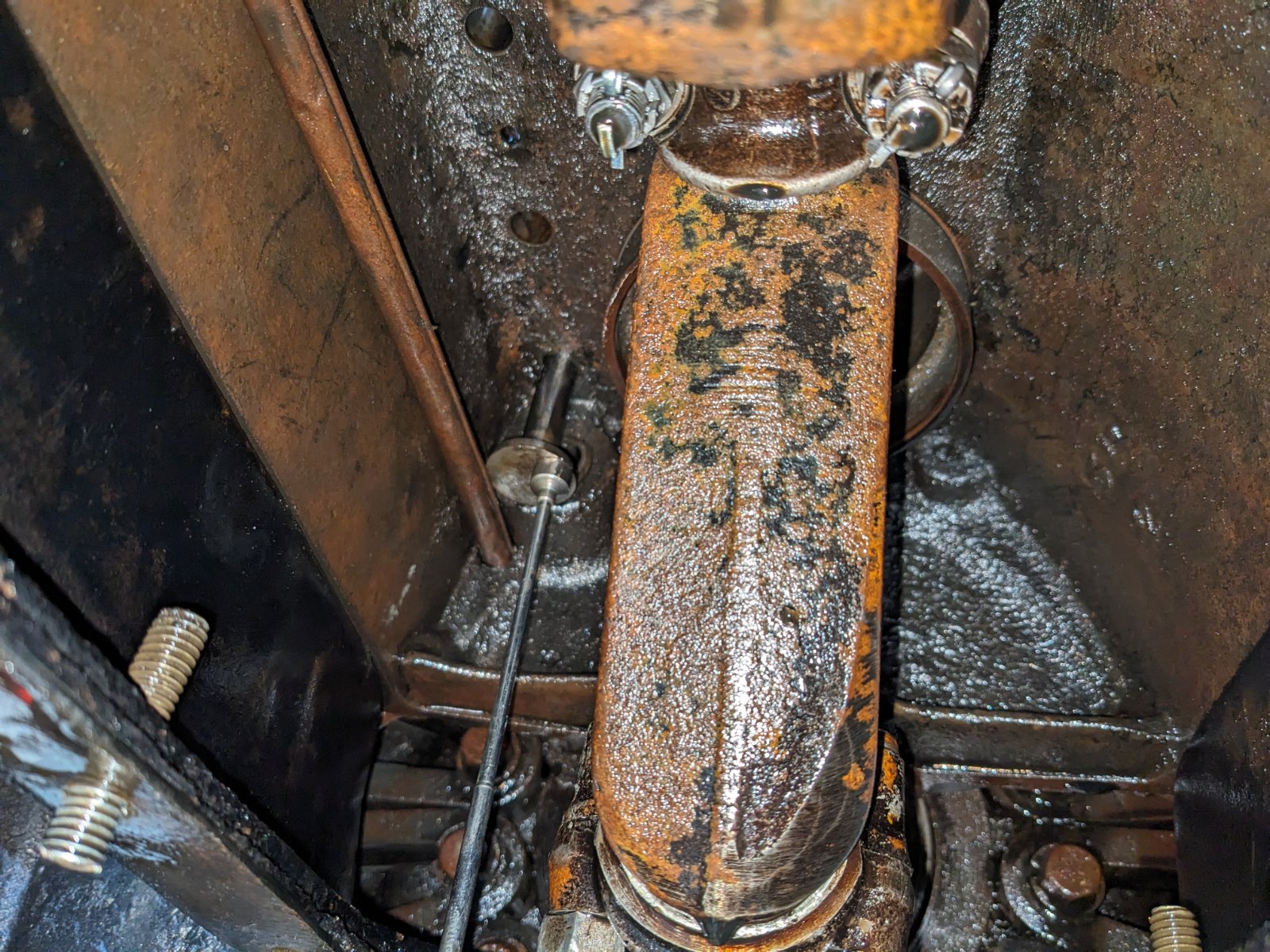

How do I remove the rear lifter with the oil line in the way?

How do I remove the rearmost lifter?
I am replacing the cam, valves and lifters with the engine in my car. The oil tube is blocking the rear lifter head. I don't want to remove and disassemble my engine for a simple job. What have you done to get the lifter out?

Re: How do I remove the rear lifter with the oil line in the way?
I don't think there is a way to remove the oil line without removing the flywheel. That would involve pulling the engine and transmission and removing the crankcase and flywheel. Might as well overhaul the entire power unit , magneto, and transmission if you go to that extent. It is possible to file the top of the lifter smooth if it is pitted, and then grind the valve stem to the proper clearance. That's the way it was originally done by Ford. Adjustable lifters are great for getting the optimum performance and quietness, but difficult to place without pulling the engine.
I got the lifter out. There was a little flex in the tube. I got the lifter head started against the tube. I cut down a spare pushrod from my Thunderbird and gently tapped the lifter down from above. The pushrod is the same diameter as the valve stem.
- Posts: 4694
Good. I hope the solder joint held inside the Hogs Head. Where the line is connected to the funnel.
- Posts: 5510
Think the hole it passes through is tight enough there shouldn't be much flex at the solder joint.
