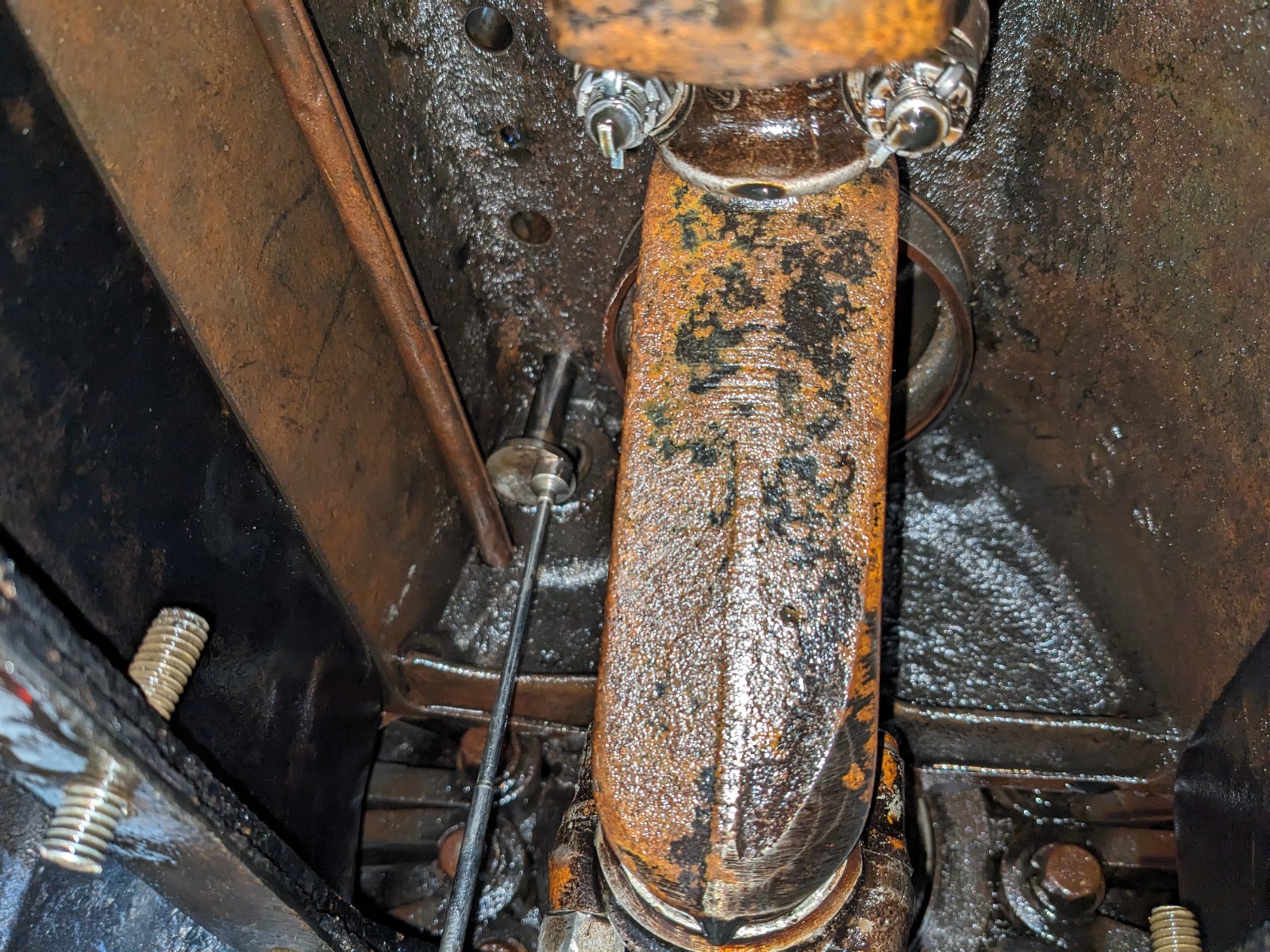

How do I remove the rearmost lifter?
I am replacing the cam, valves and lifters with the engine in my car. The oil tube is blocking the rear lifter head. I don't want to remove and disassemble my engine for a simple job. What have you done to get the lifter out?

Re: How do I remove the rear lifter with the oil line in the way?
I got the lifter out. There was a little flex in the tube. I got the lifter head started against the tube. I cut down a spare pushrod from my Thunderbird and gently tapped the lifter down from above. The pushrod is the same diameter as the valve stem.
- Posts: 4684
Good. I hope the solder joint held inside the Hogs Head. Where the line is connected to the funnel.
- Posts: 5435
Think the hole it passes through is tight enough there shouldn't be much flex at the solder joint.
