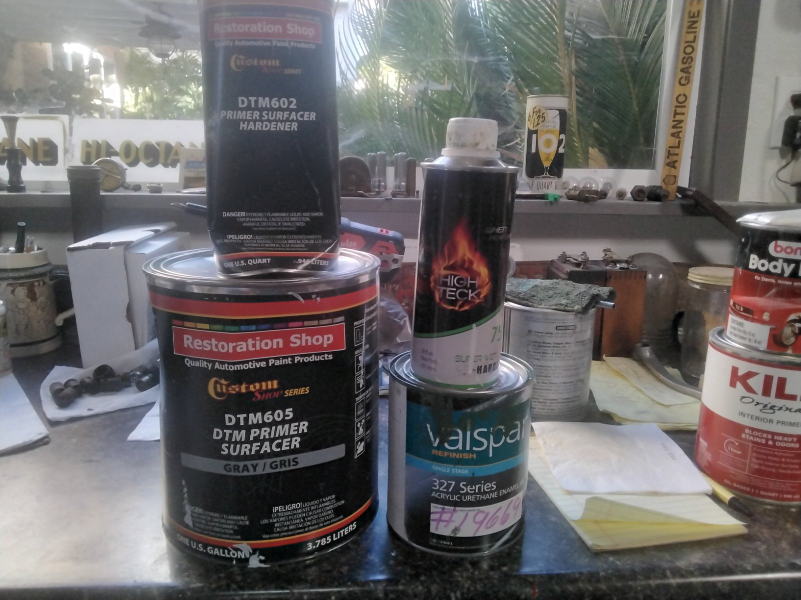

I recently painted set of wire wheels. Not a fan of power coating. I had the wheels media blasted and used DTM primer. Two coats of primer, wet and dry 400 or 600 between coats.
Used acrylic enamel, 8 to 1, paint to hardener ratio. Very durable and easily touched up if needed.

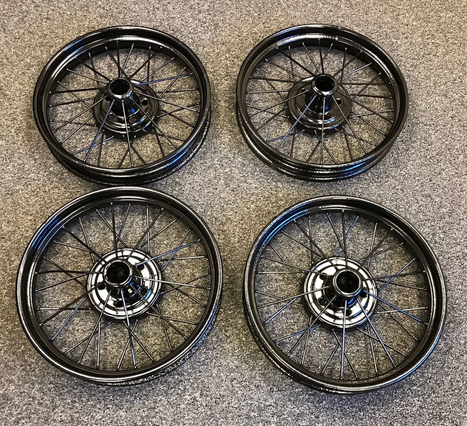

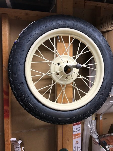

Painting wire wheels can be difficult. I have painted several sets and here is how I do it for good complete coverage and keeping them suspended so nothing touches wet paint:
When the wheel is all ready to paint I brush the inside center and inside where the tube lays then set them aside for a day or more to dry. Next I have a short section of front axle cut off with a spindle attached so it won't flop around. I put a front hub on that and mount the wheel. The axle stub is slid into my engine stand and that keeps everything at a comfortable height. You could put the axle in a vice or build a stand and anchor the axle with u-bolts. Now you can paint from all angles to get the spokes and spin the wheel by touching the tube contact area that is already painted and dry.
Now you either wait a day to remove the freshly painted wheel or take some clothes line and rope around the tube contact area that was previously painted and remove wheel to hang and move on to the next wheel.
This has worked well for me to get the spokes painted completely. You can spray from the outside and inside but can also spray at angles from the hub out and the rim in towards the center if that makes sense.
Nothing worse than finishing a wire wheel and later finding a spoke that didn't get paint in one section and it is surprisingly easy to do that.
Tim Moore

Tim, I use a stub axle and hub to take the wheels too. I do mine on the horizontal rather than in their normal plane, and I do the whole wheel all at the same time. i start at the valve hole and count spokes, spraying all from one angle, then repeat the same operation spraying on the other angle. Then i turn the wheel over and repeat the same process, so the spokes are sprayed from 4 directions.
There will already be paint on the hubs and felloes from this, so spraying them is easy because the fiddly bits around the spoke ends are already done. This also prevents runs, as there is no extra loading around the spokes.
I hang the wheels to dry. To lift them off the hub and to hang them from a beam in my garage, I make a lifting hook for each wheel.
This consists of a 1/2" flat washer with a wire twitched to it and a loop formed in the other end of the wire. The loop passes through the valve stem hole. then the whole wheel can be lifted from the hub with a hook already through the wire loop, and the wheel suspended to dry. The washer on the wire makes as little contact as possible with the wheel. Because I always use spraying enamel for the best gloss and best flow of paint, it is easy to touch up. I can even brush out runs, if they develop, and I catch them in time.

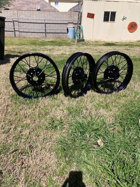

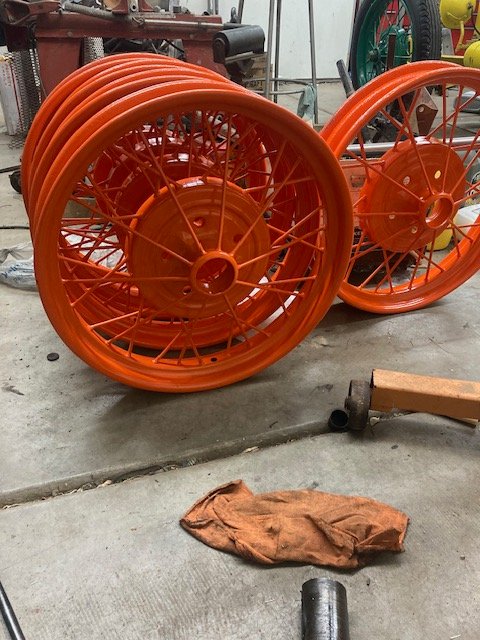

I’ve done both ways and have to say that from here on out, powder coating will definitely be my only choice. In fact, I want to change the color on one my cars wheels and will have them powder coated this winter. The main difference is that the powder coated ones do not chip NEARLY as easily as the painted ones. Also, mounting tires is also easier due to how slippery the plastic is. I drop them off, he blasts them with walnut shells and coats them for about $125 each. Chips in black paint won’t show nearly as much in as they do in the lighter colors, but it’s still annoying.
