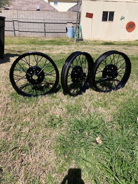

I recently painted set of wire wheels. Not a fan of power coating. I had the wheels media blasted and used DTM primer. Two coats of primer, wet and dry 400 or 600 between coats.
Used acrylic enamel, 8 to 1, paint to hardener ratio. Very durable and easily touched up if needed.

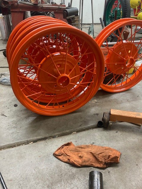

I’ve done both ways and have to say that from here on out, powder coating will definitely be my only choice. In fact, I want to change the color on one my cars wheels and will have them powder coated this winter. The main difference is that the powder coated ones do not chip NEARLY as easily as the painted ones. Also, mounting tires is also easier due to how slippery the plastic is. I drop them off, he blasts them with walnut shells and coats them for about $125 each. Chips in black paint won’t show nearly as much in as they do in the lighter colors, but it’s still annoying.
