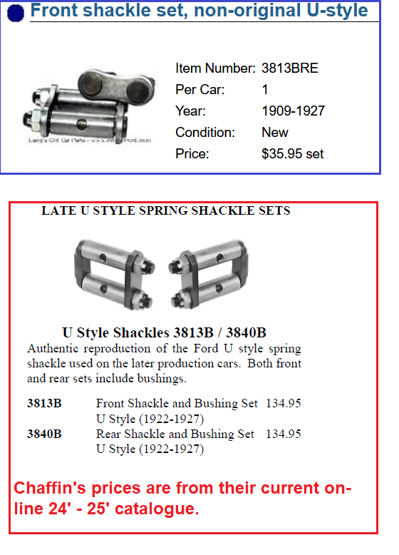

My front shackles are a little worn but not horrible, I would like to get rid of the slop. Langs and Snyders has their original style on backorder, the new versions arent a solid U but an assembly of plates and hardware. Would they hold up? I havent removed mine yet, if the U bolts arent worn I could replace the bushings... do the bushings usually wear out before the U bolt?

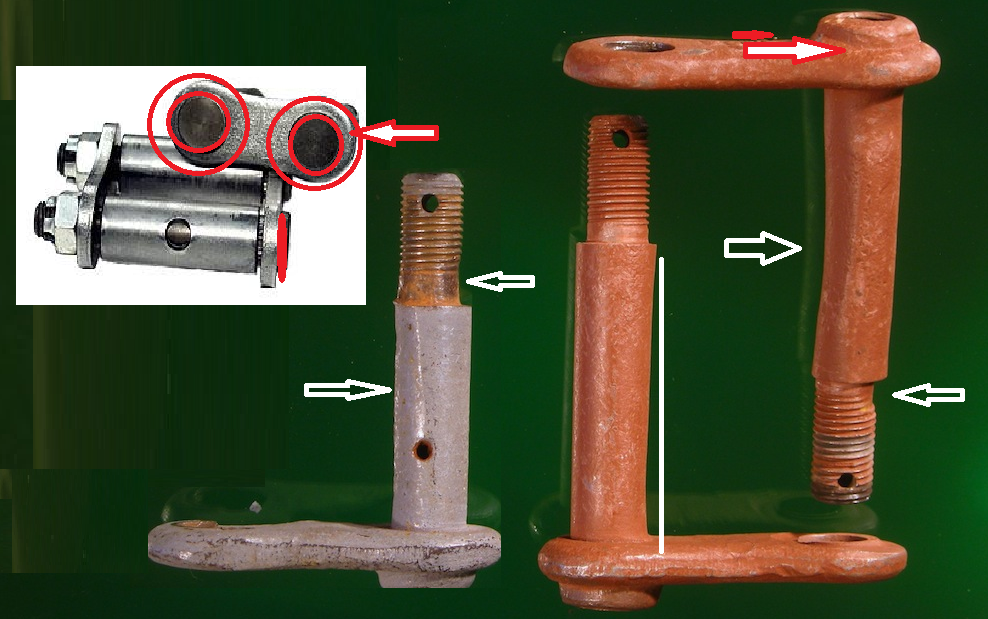

Shackles wear on the inside of the studs as a result of the weight placed upon them. But does uneven wear on the shackle stud indicate another issue besides a worn bushing?
The picture of these shackles is an typical example of wear for any year. As you know they are not 26' 27'

We make the 26/27 shackles. They are in the final stage of production. Should be available soon.

...does uneven wear on the shackle stud indicate another issue besides a worn bushing?
Yes. The other issue is a worn shackle.
The shackles in Frank's picture are not 26-27. I would wait and get the correct ones from Chaffin's.

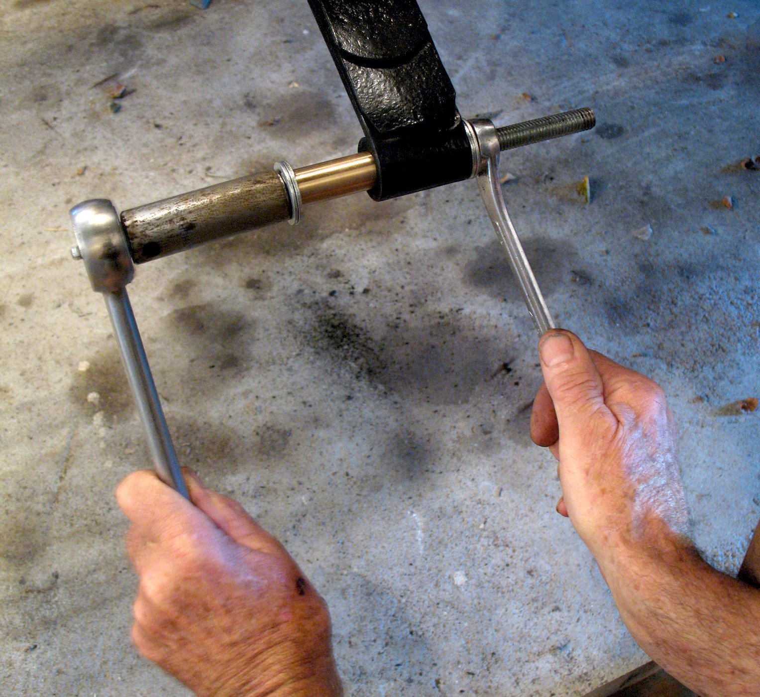

I agree that steel bushings were not Ford's best idea. I would rather replace bushings than shackles, so I bought bronze bushings by size.

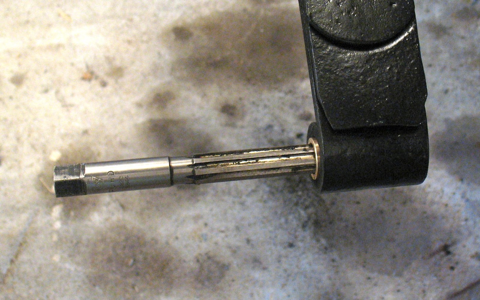

Posts: 7411
Re: 26 T Front Spring Shackles
Post by Steve Jelf » Sat Oct 19, 2024 10:21 am
What size bronze bushings should we ask for at the hardware store?
Well, this is nice. Not only did I keep the info, I was just able to find it.
Front perch bushings(#3820) are ⁹⁄₁₆" ID and ¹¹⁄₁₆" OD, 1½" long.
Rear perch bushings (#3844) are ⁹⁄₁₆" ID and ¾" OD, 2" long.
Hand crank bushings (#3909) are OD 1", ID ¾", 2⅝" long,
Spindle arm bushings (#2714) are OD ¹¹⁄₁₆", and ID ⁹⁄₁₆", 1" long.
Parking brake cam bushings(#2559*) are 1⅛" long, OD ¹¹⁄₁₆", and ID ½".
*1909-1925.
You may need to do some reaming.

Chaffins look pretty good and alot cheaper.
