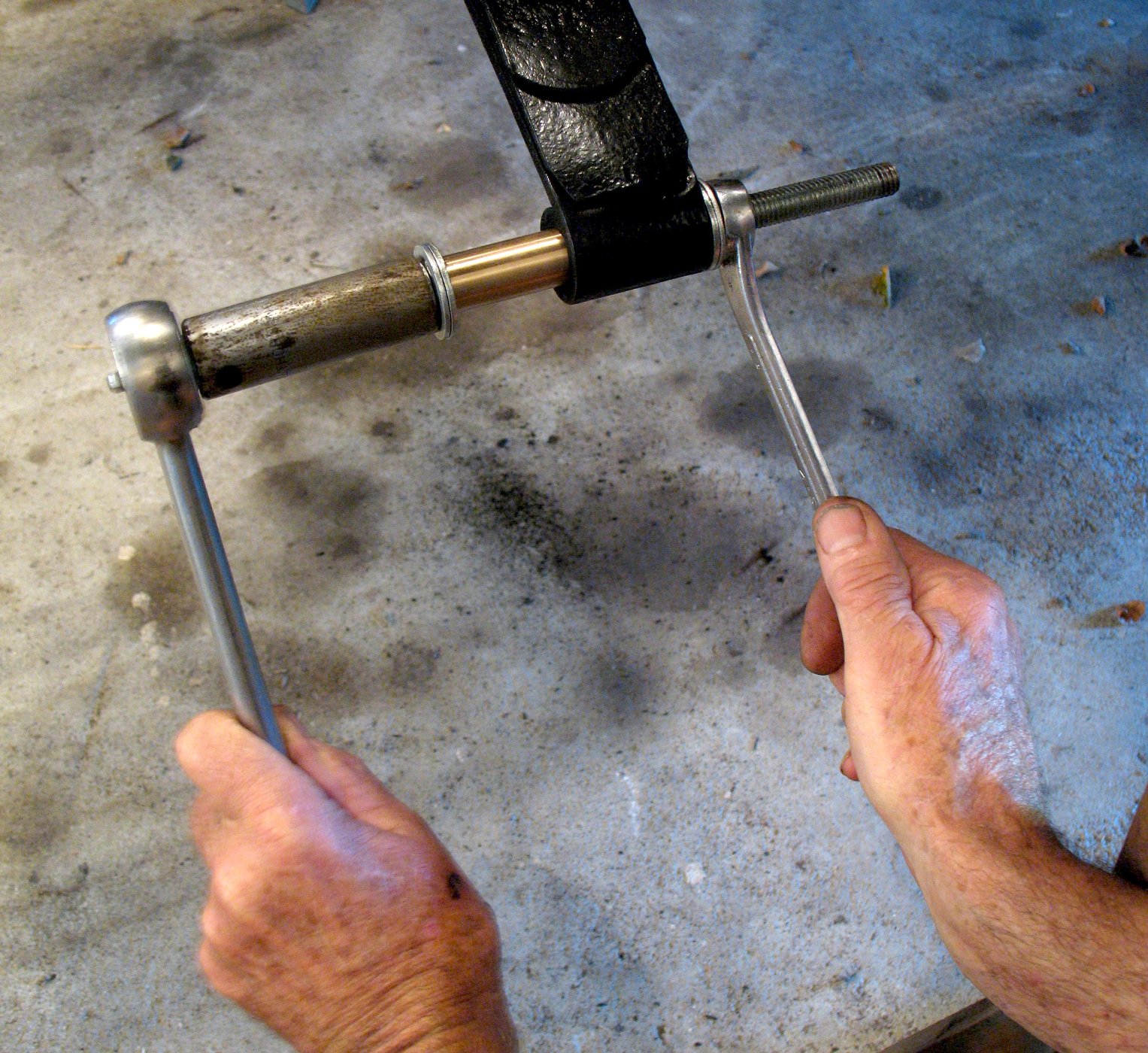

The pressed steel shackles aren't much different than the original two piece. Would a bit of weld to the tie bar secure them?
Shackles wear on the inside of the studs as a result of the weight placed upon them. But does uneven wear on the shackle stud indicate another issue besides a worn bushing?
The picture of these shackles is an typical example of wear for any year. As you know they are not 26' 27'

...does uneven wear on the shackle stud indicate another issue besides a worn bushing?
Yes. The other issue is a worn shackle.
The shackles in Frank's picture are not 26-27. I would wait and get the correct ones from Chaffin's.
I agree that steel bushings were not Ford's best idea. I would rather replace bushings than shackles, so I bought bronze bushings by size.
