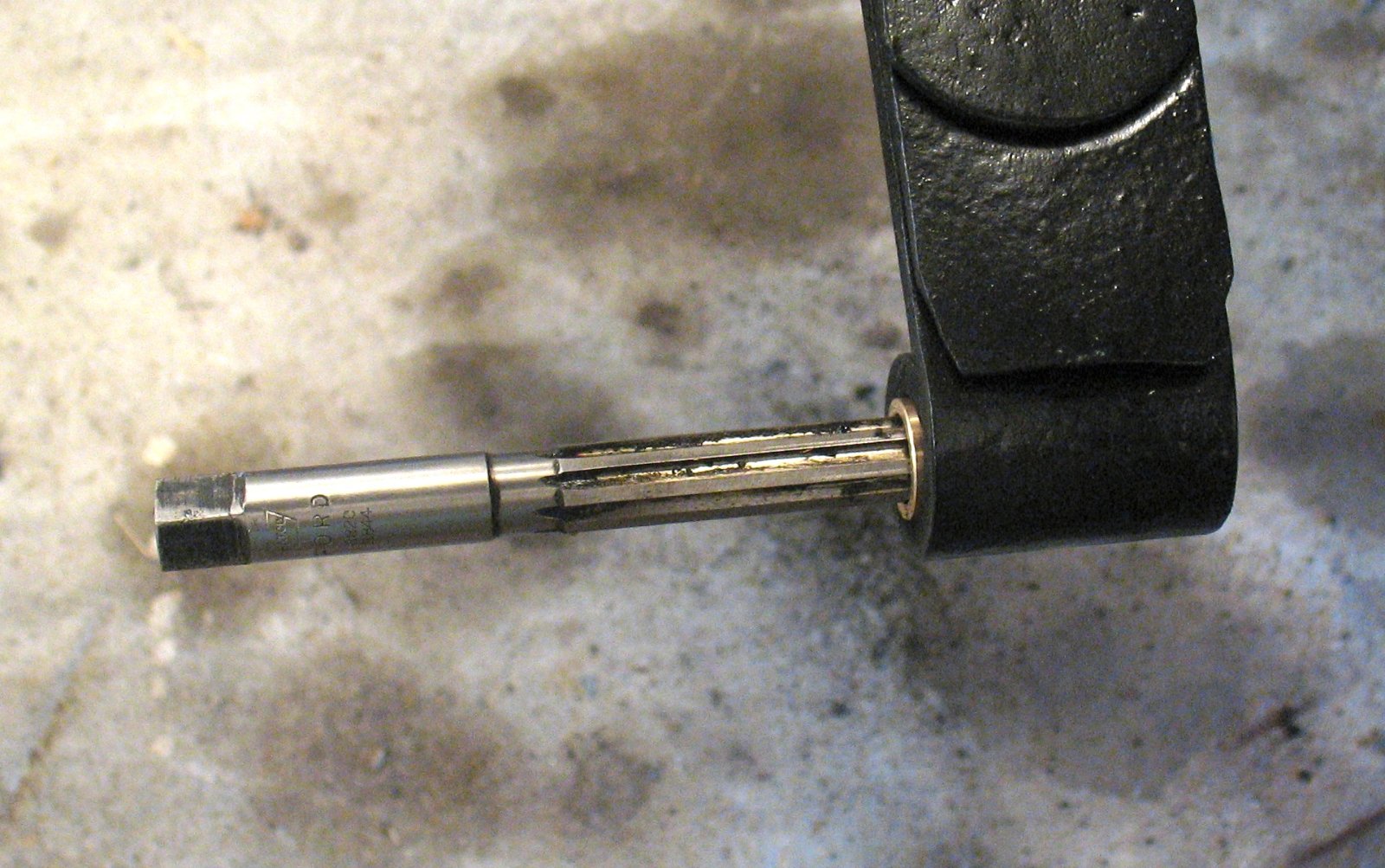

- Posts: 7359
Re: 26 T Front Spring Shackles
What size bronze bushings should we ask for at the hardware store?
Well, this is nice. Not only did I keep the info, I was just able to find it.
Front perch bushings(#3820) are ⁹⁄₁₆" ID and ¹¹⁄₁₆" OD, 1½" long.
Rear perch bushings (#3844) are ⁹⁄₁₆" ID and ¾" OD, 2" long.
Hand crank bushings (#3909) are OD 1", ID ¾", 2⅝" long,
Spindle arm bushings (#2714) are OD ¹¹⁄₁₆", and ID ⁹⁄₁₆", 1" long.
Parking brake cam bushings(#2559*) are 1⅛" long, OD ¹¹⁄₁₆", and ID ½".
*1909-1925.
You may need to do some reaming.
