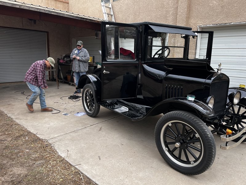

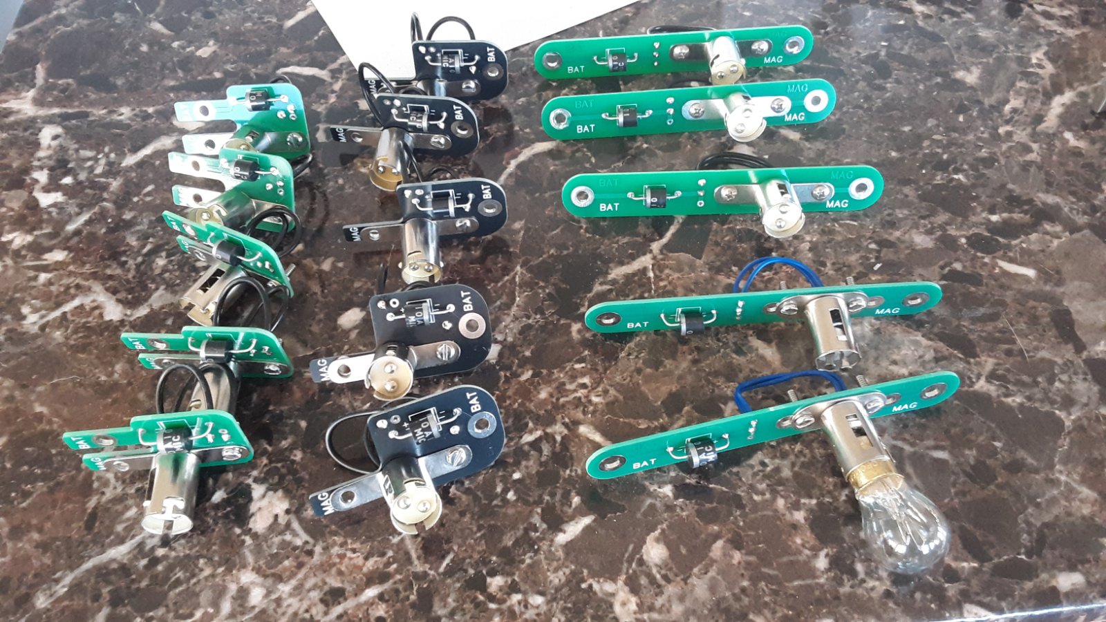

My model t club had a work day at the (former) president’s howse…
My son and I got to work on installing a ruckstell in one of the members coupe’s and we got to bounce between that and checking a mess of crankshafts-AND- some millwork on a couple of early blocks.
I had just gotten shipping notification on my Langs order and when I got home my turn signals were here, along with my LED headlight bulbs….
So I have parts for the car I don’t have yet…

I bought some LED bulbs for my new turn signal/stop lights, testing with a 7volt battery the incadescent were a lot brighter.
These were the press in type bulbs, I'll post a full report when I get my car...
I'm also going to buy the logo headlight bulbs from Langs....

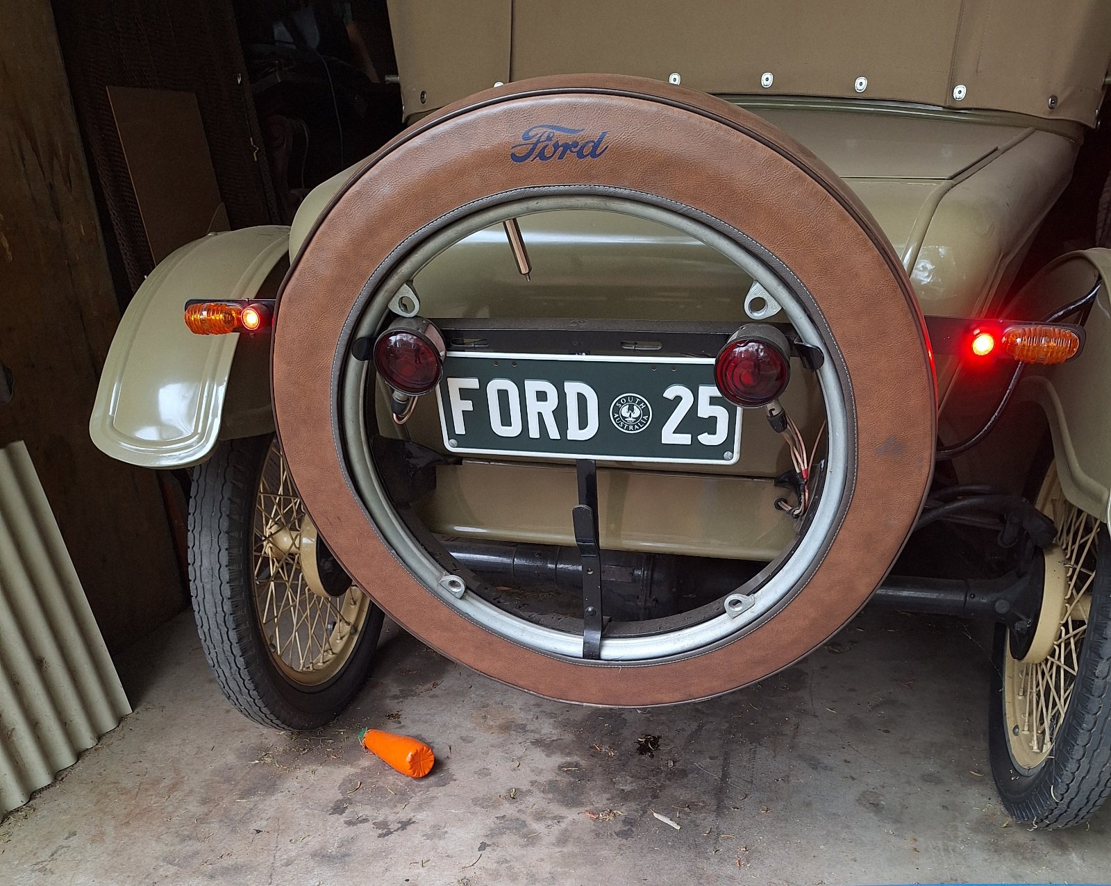

You can use a pair of standard model T tail lights for brake lights as well. Just fit dual pin headlight sockets in the tail lights instead of the single pin ones that come in the tail lights.
There are arguments for making indicators, brake lights etc as unobtrusive as possible. I go a different route. They go on obvious additional brackets in obvious positions. That way they are recognised as safety add-ons and they are obvious when operating.

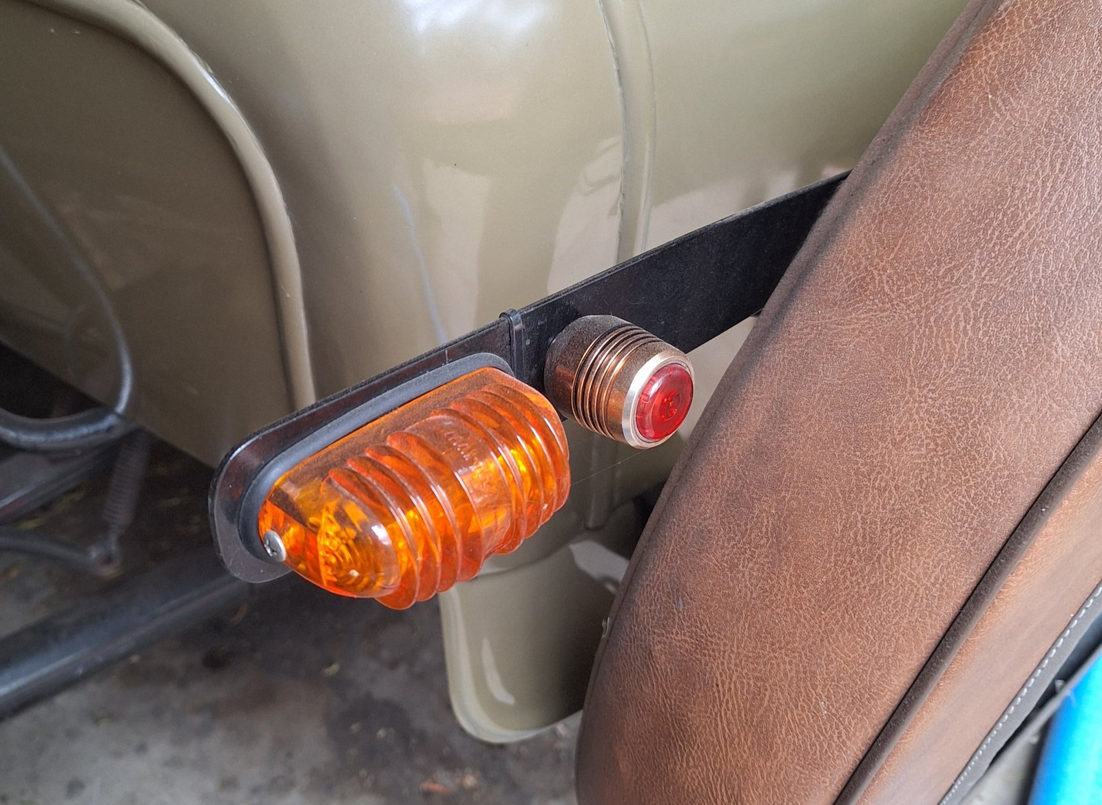

These are the lights on the back of my wide body roadster. The lights in the spare tyre are standard T issue, but fitted with double contact sockets so they serve as brake and tail lights
The small anodised lights next to the indicator lights are rechargeable leds. They screw off and plug in via a USB cord. By pressing the red lens they switch to red. Press again and the y flash red. They are quite noticeable by day and brilliant at night. They were made to fasten to a bicycle seat stem with a rubber band but I fixed them permanently
Allan from downunder.

That looks nice, I was considering getting a bike flasher and mounting it at the back of the cab under the rear window.
I was even thinking of making dismountable bars front and rear that could be stowed in the trunk for car shows... seems like too much work... but we shall see...
keeping period correct is fine and dandy, but I'd prefer to be seen as peeples are looking up from texting while driving...

Got the paperwerkz today and worked on installing the turn signals and familiarizing myself with my first t today…
More details later..

Post by WillyR » Mon Apr 07, 2025 6:59 pm
I have the turn signals wired up.
The brake light through the new lights are wired to the supplemental “stop” lense.
Hazards work great too.
I have the LED bulbs for the new system and I may see how those work after dark.
The LED headlight bulbs I previously bought thru the amazons, require some changes to the wiring harness so I may just wait for the plug in lights (logolites) to get back in stock from Langs.
I had the front windshield down and the door side windows rolled down and my bud vase flowere blew all over and I lost a stem or two out the window…
Maybe it’s a sign to pick some new ones. Maybe a few rose buds?

I tried one led, in the rear and it wasn't very bright, must need resistors... I'll look up what they need and maybe use them for future spares.
When I compared them off the car, to the incandescent using a 9v battery, the incandescent were brighter, but the LED were even dimmer on the car....
that experiment is essentially over....
