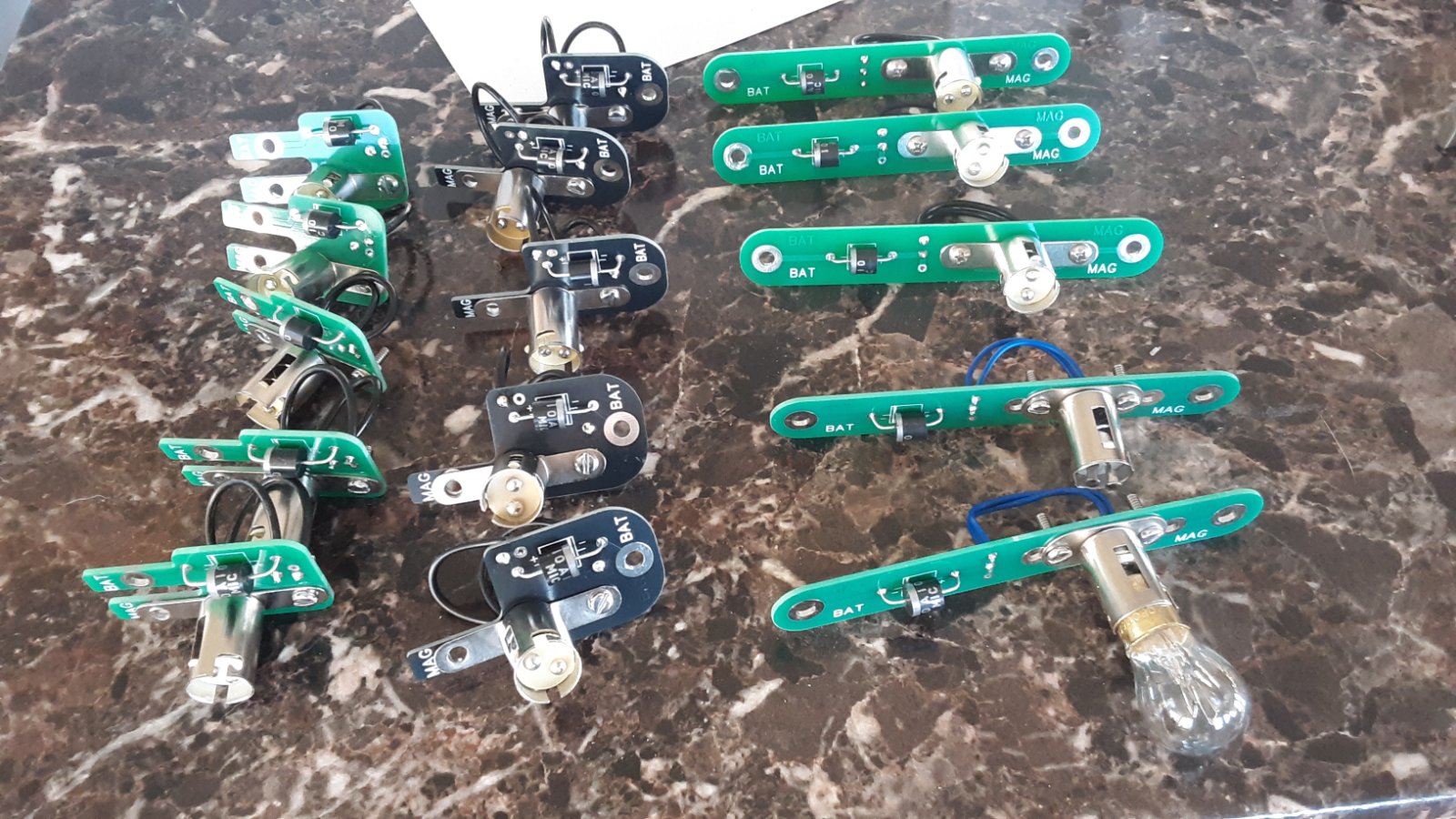

I bought some LED bulbs for my new turn signal/stop lights, testing with a 7volt battery the incadescent were a lot brighter.
These were the press in type bulbs, I'll post a full report when I get my car...

I have the turn signals wired up.
The brake light through the new lights are wired to the supplemental “stop” lense.
Hazards work great too.
I have the LED bulbs for the new system and I may see how those work after dark.

I tried one led, in the rear and it wasn't very bright, must need resistors... I'll look up what they need and maybe use them for future spares.
When I compared them off the car, to the incandescent using a 9v battery, the incandescent were brighter, but the LED were even dimmer on the car....
that experiment is essentially over....
