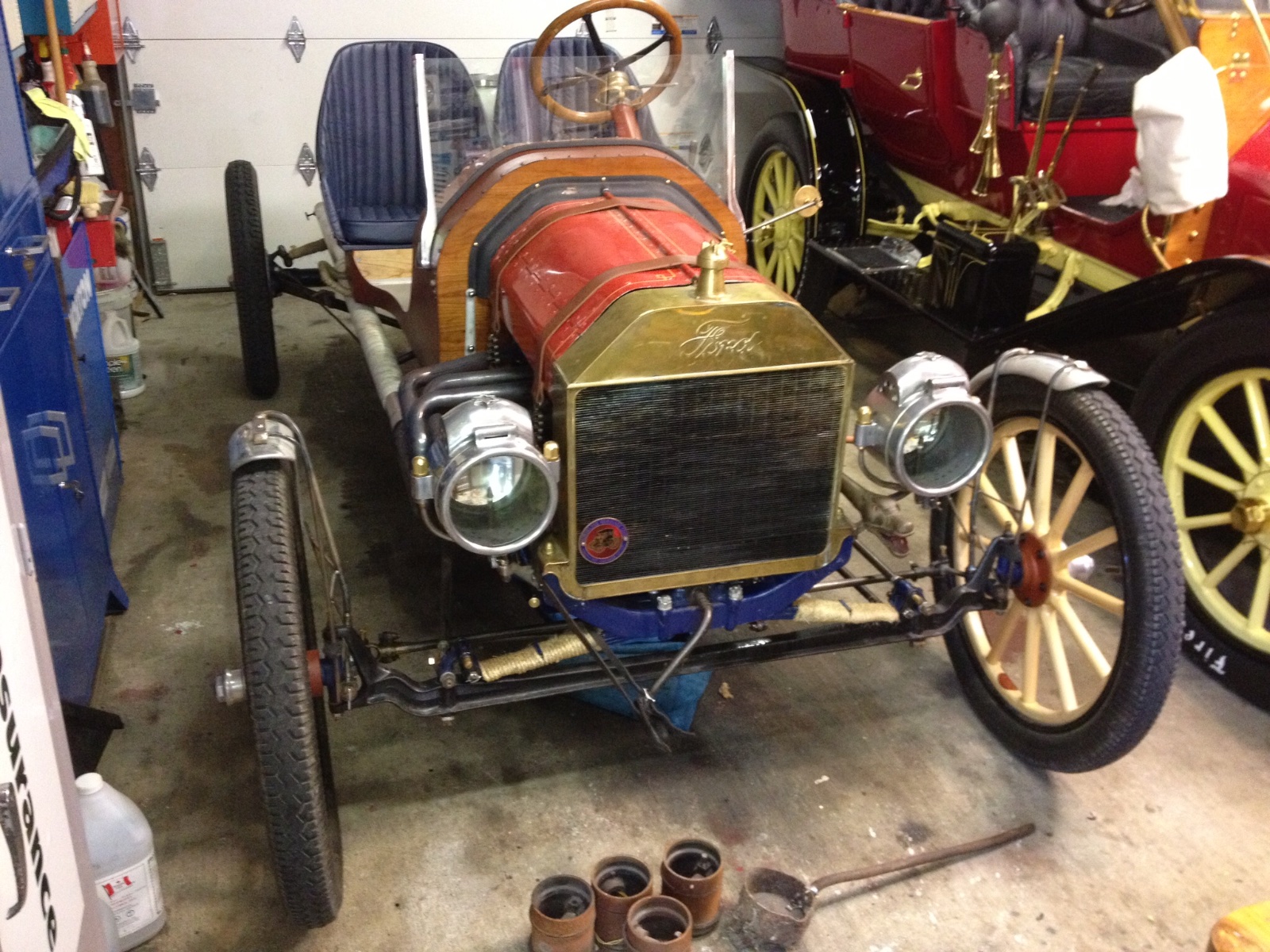

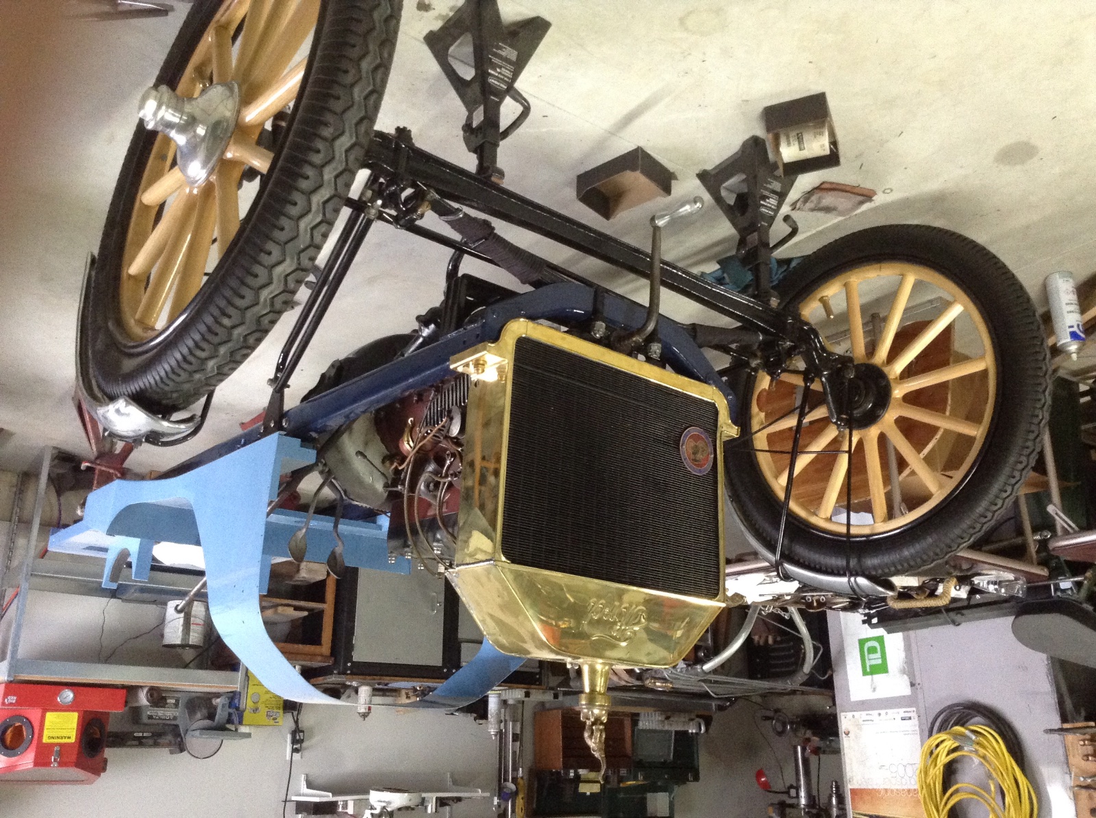

Post by Playswithbrass » Thu Oct 24, 2019 6:37 pm
I had our speedster pretty well together a few years ago but then something else needed its space in the garage. Had to dismantle it and store it where I could - body in the family room, painted steering parts in the basement, even kept the wheels and engine in the garage! But we moved house and with more room it’s going back together. My winter project looks like being done before the snow flies

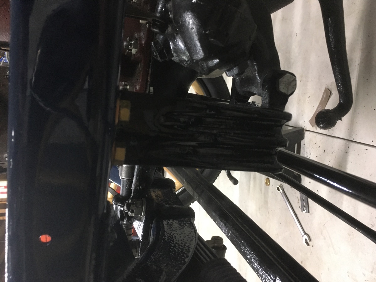

Post by TRDxB2 » Thu Oct 24, 2019 7:05 pm

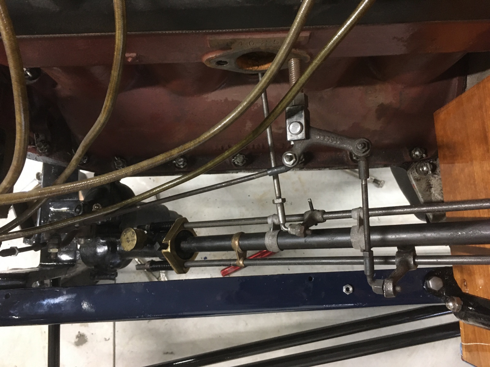

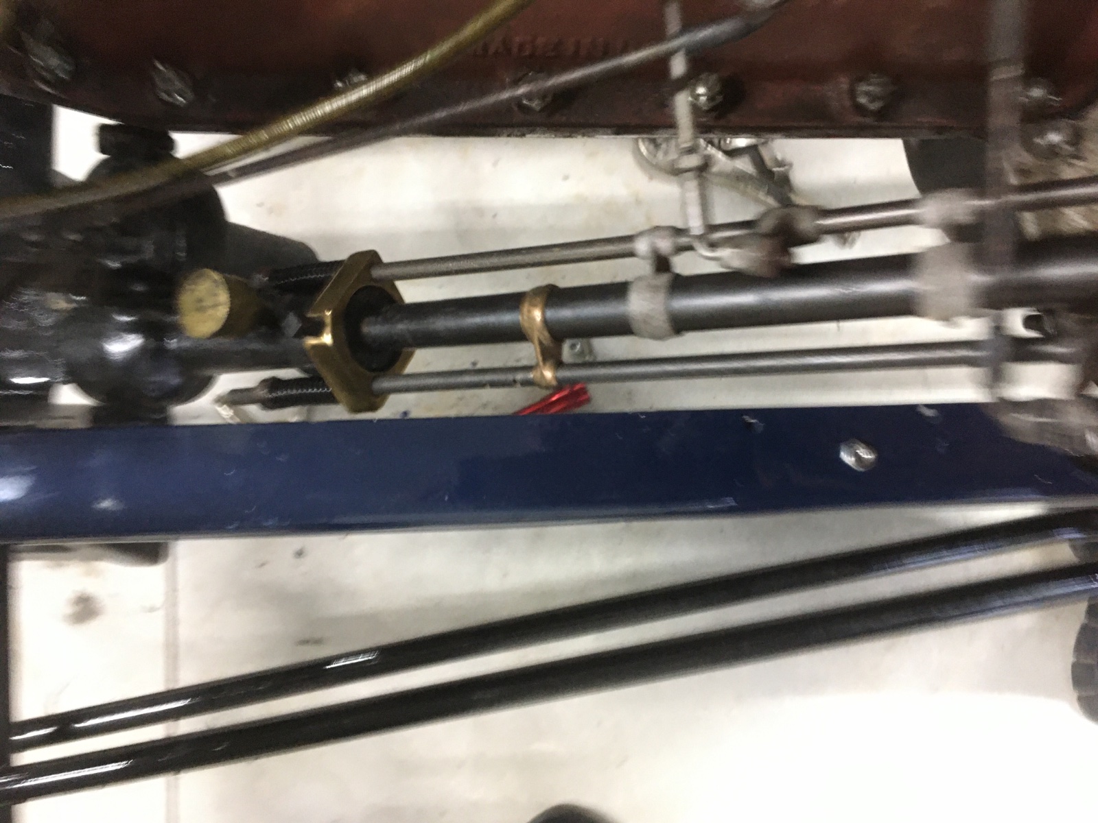

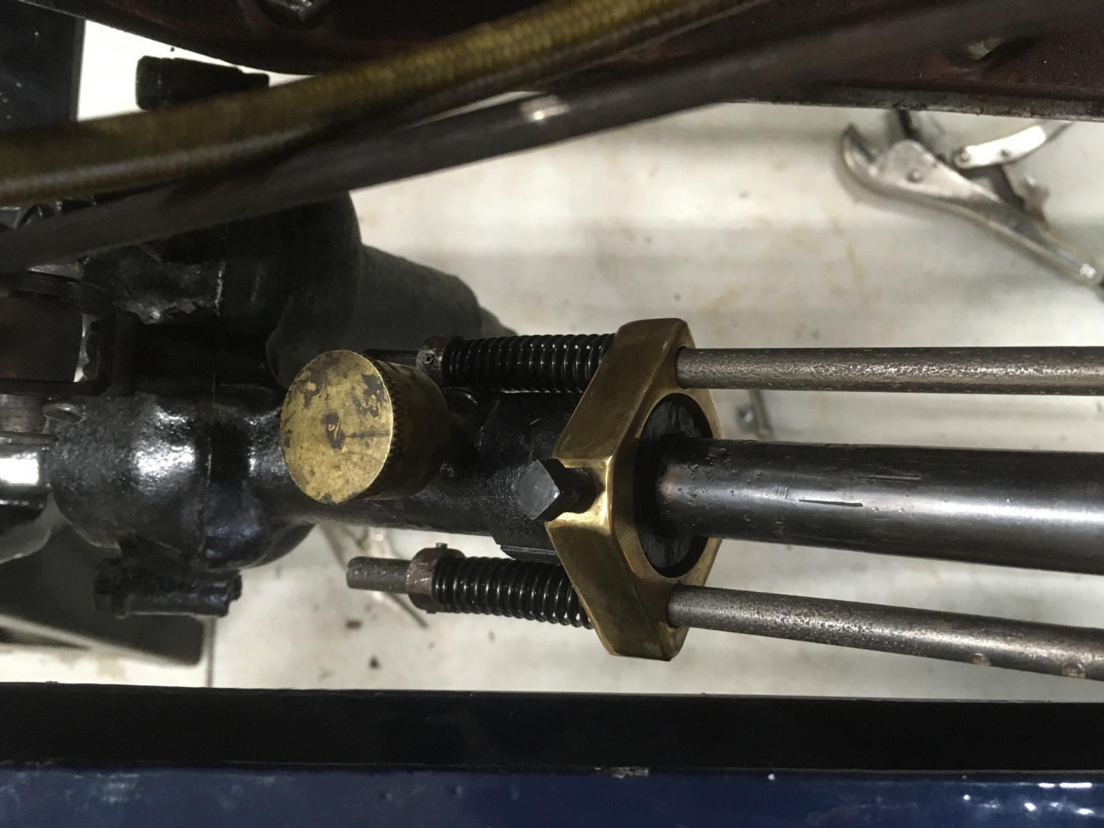

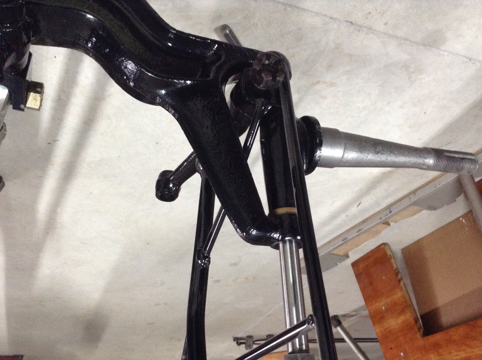

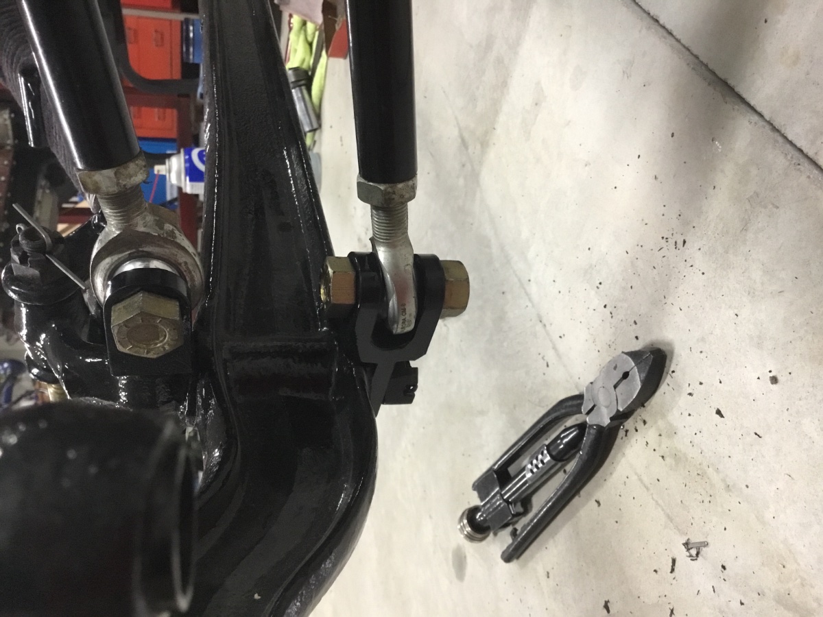

Could you add a few photos of the hairpins and brackets on the axle. Great design - I've been looking to do something like that. Thanks Frank

Post by Playswithbrass » Thu Oct 24, 2019 7:28 pm
Hope these help.

Post by TRDxB2 » Fri Oct 25, 2019 1:40 am
Peter, Thank you for adding those photos - just what I was looking for! 👍 Frank

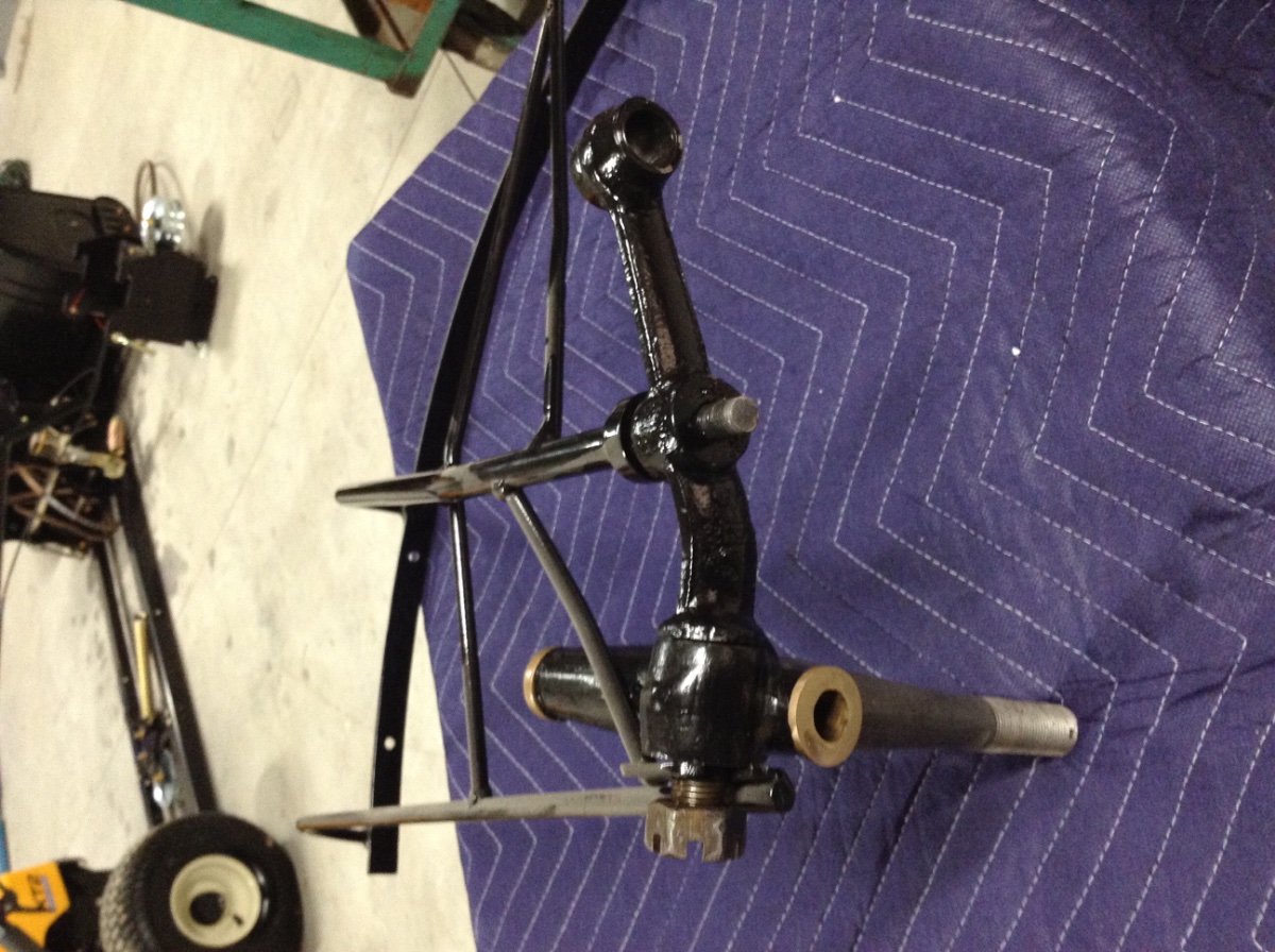

Post by Don D » Sat Oct 26, 2019 8:26 am
Peter,

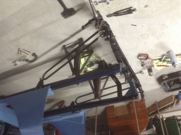

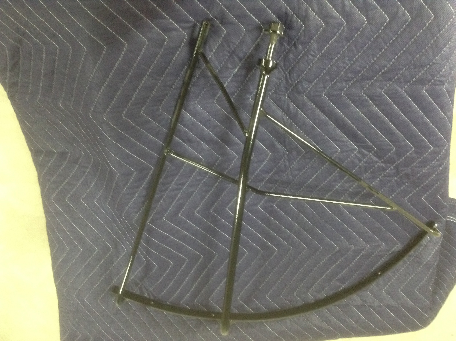

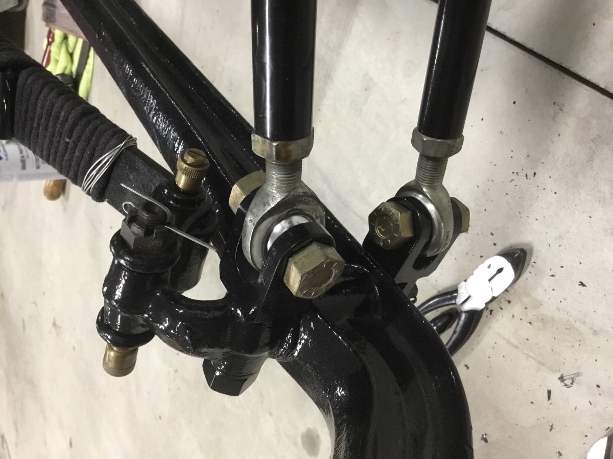

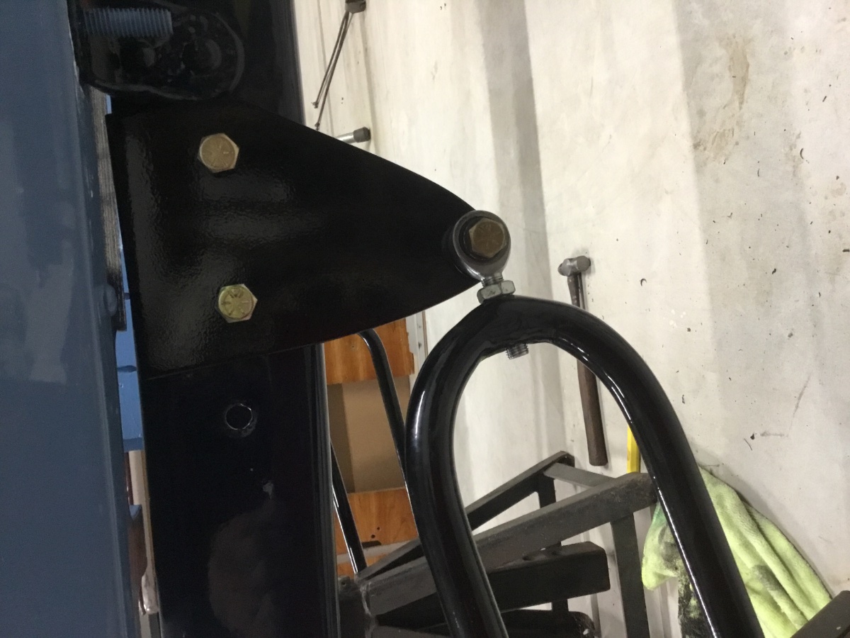

Very nice job with the car and the photos. Could you please post photos of the fender mounts and describe the source of parts?

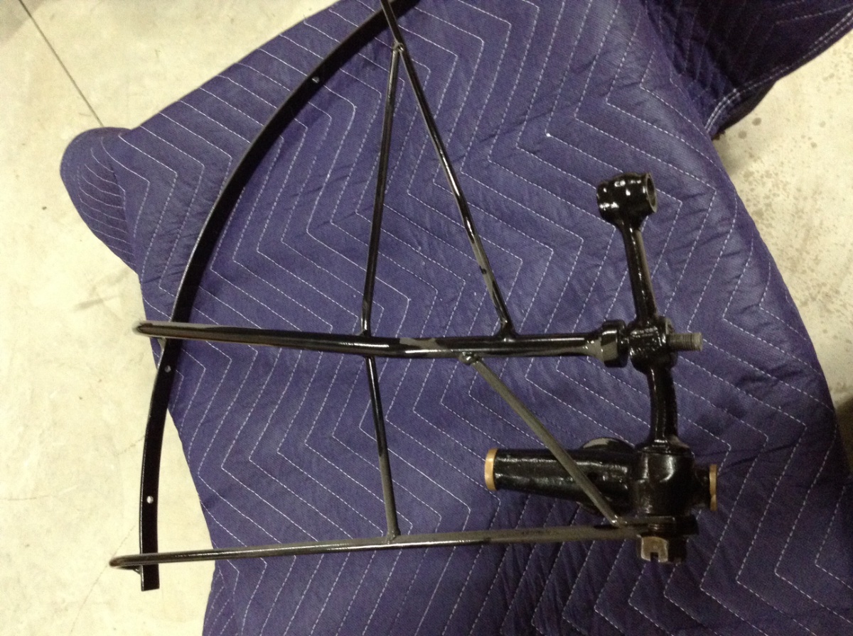

Post by Playswithbrass » Sat Oct 26, 2019 9:45 am
Don pic's as requested.I have used the speedo mount hole in the steering arm,for the left side I turned a right side upside down and bent to fit and used the nut at the front of the arm as well.To come up with the design of the fender bracket we started off simple took the car for a drive,it vibrated badly ,came back to the shop added another cross bracket,took for a drive and so on until the fender did not vibrate.

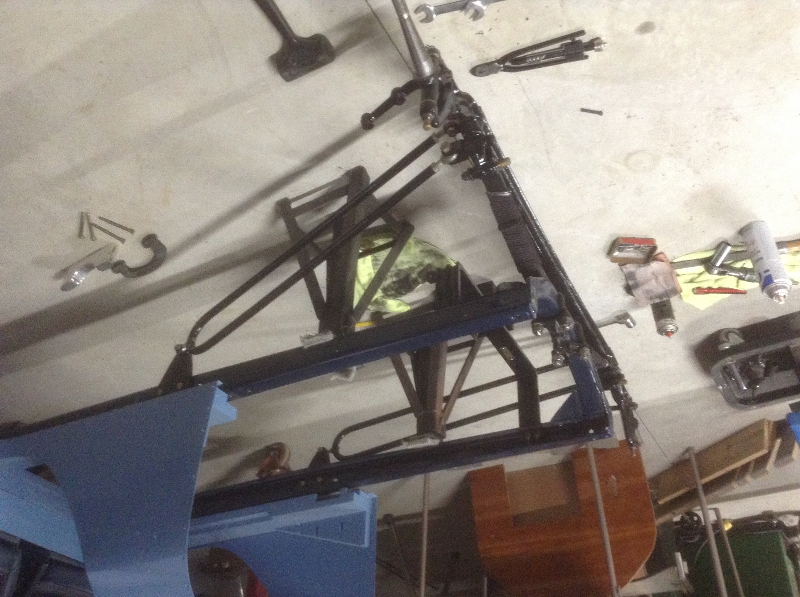

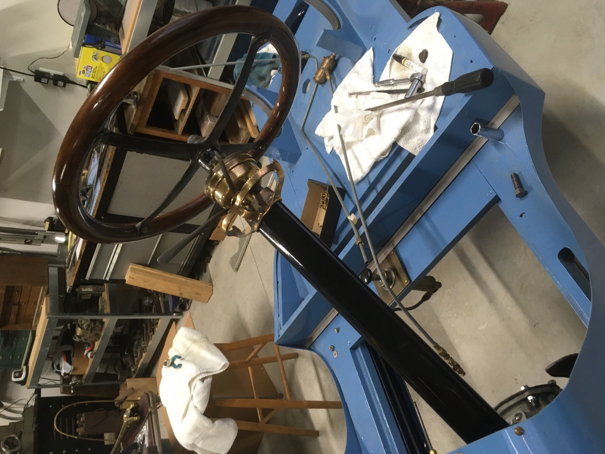

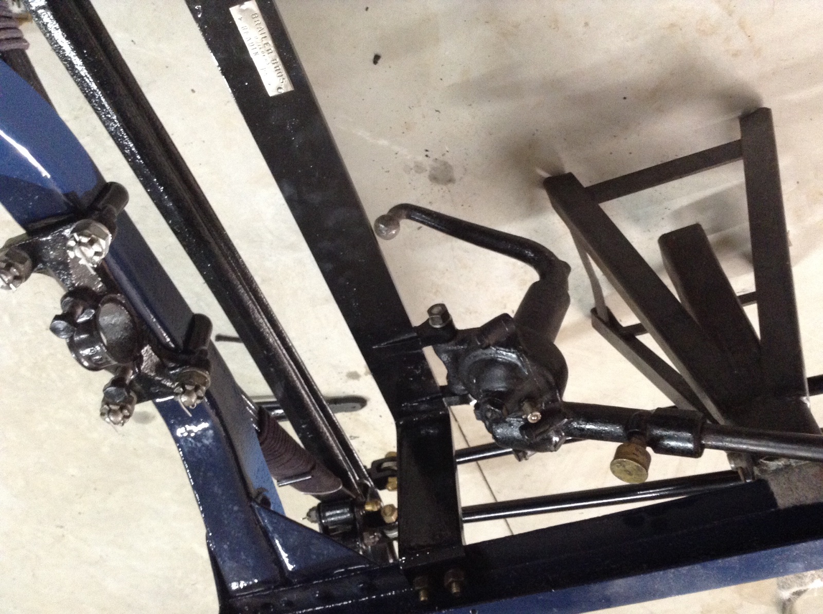

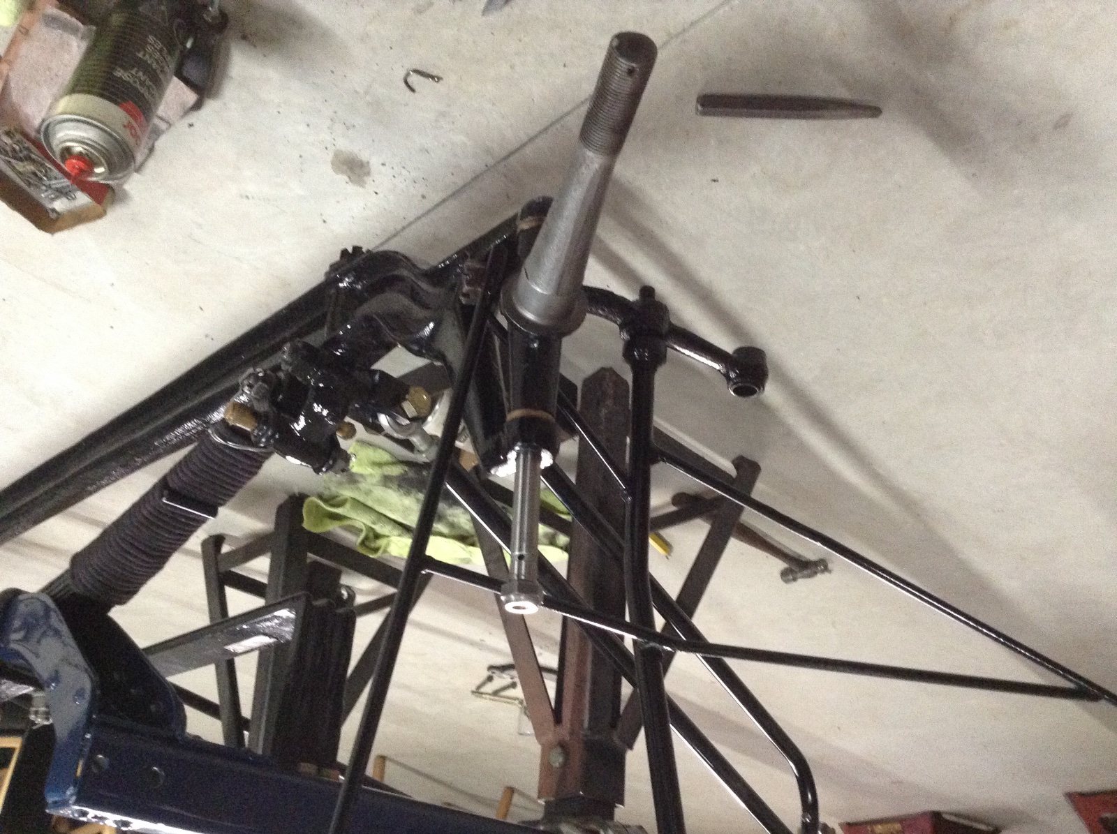

Post by Playswithbrass » Sat Oct 26, 2019 10:07 am

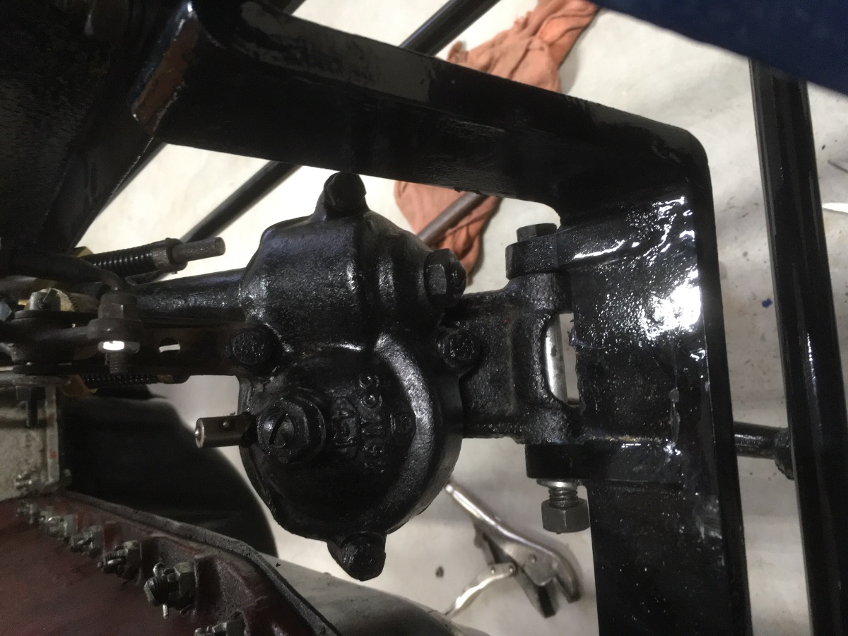

Picture of super rare steering set up. LOL. Cheers pete ps pic's go proper way up when clicked on ,don't understand this

What kind of steering box is that?

Don't know brand of steering box but there is part of one on Ebay;

The photos really show how much work you put into those fender mounts. Great job and thanks for sharing. I will have to just copy them and wait for the time I can tackle a set myself.

Post by Playswithbrass » Sun Oct 27, 2019 7:51 am
Shane ,steering box is from an early 490 chev. Fits right inside the T column.

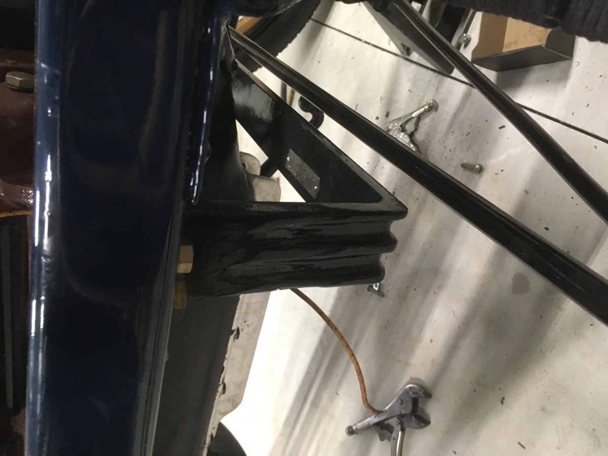

Post by Mark Gregush » Sun Oct 27, 2019 5:05 pm

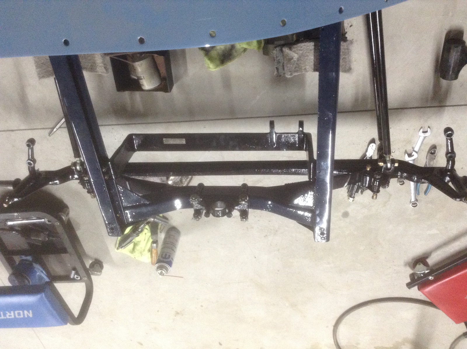

Like the idea of the cross bar to mount the steering box on. I was thinking to add a mount that ran between the pan rail and frame, but I like that better.

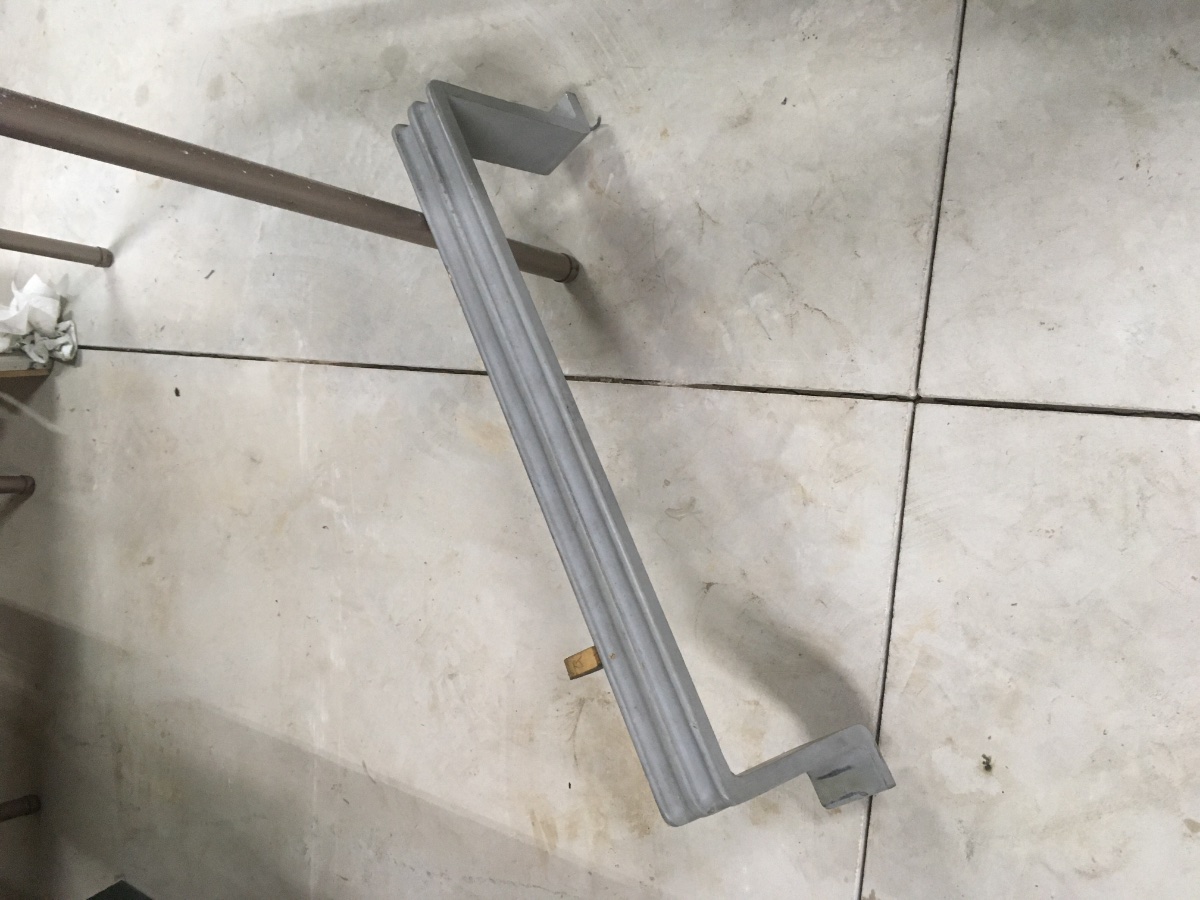

Post by Playswithbrass » Sun Oct 27, 2019 8:08 pm
Mark,I made a pattern from wood and had the local foundry cast it in ductile iron.Made it so it had a period correct look. Pete

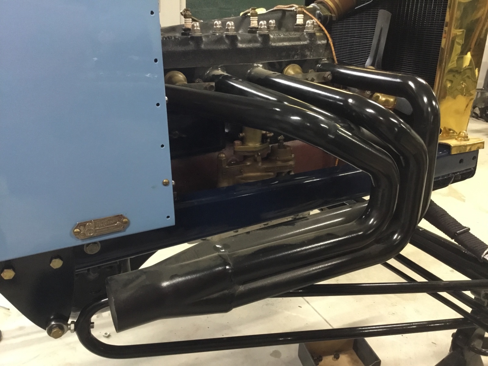

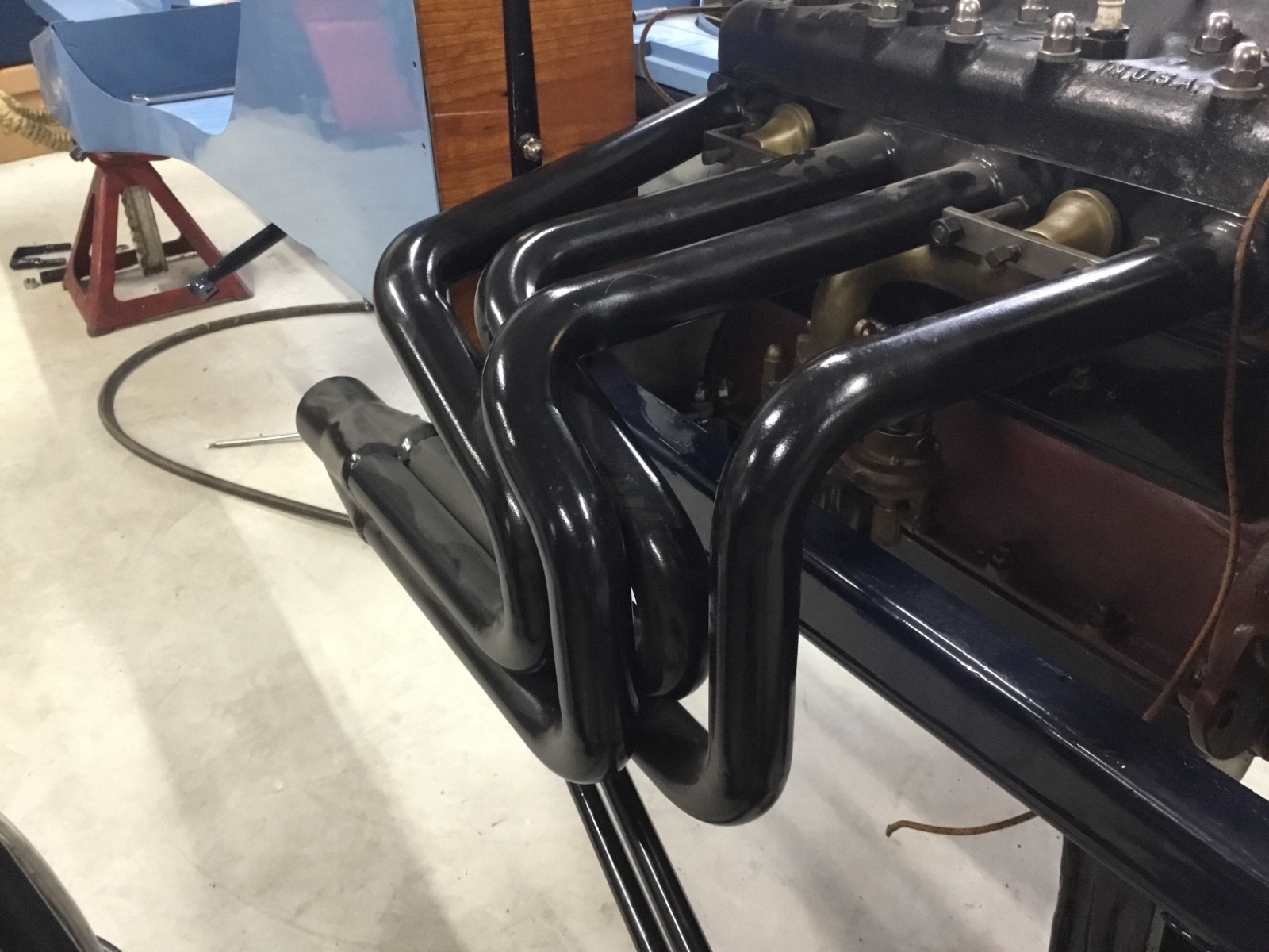

Post by Playswithbrass » Wed Oct 30, 2019 2:51 pm
Last few days progress. Intake,header and carb setup

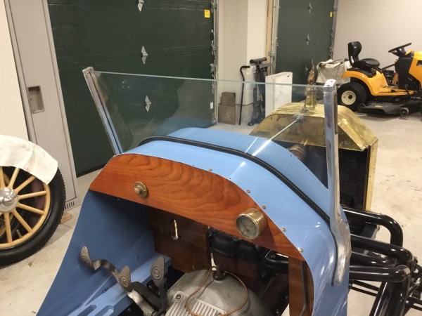

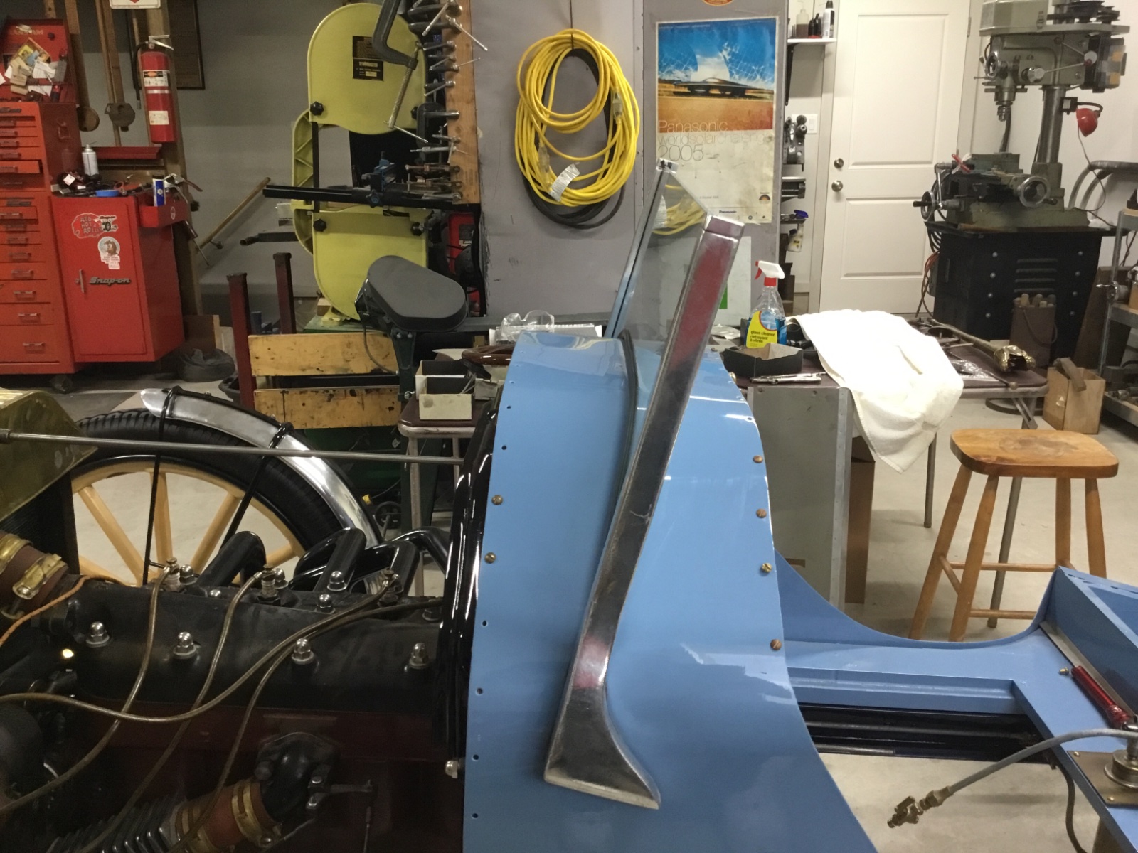

Been kinda slow,but did get the windshield installed. We made a wood pattern then had the Amish who had a aluminum foundry cast the stanchion’s. However lots of sanding and buffing required. Cheers pete

Post by GEmering » Sun Nov 03, 2019 8:56 am
Peter,
Great project!
You are very talented.

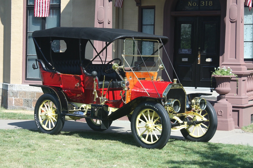

What's the equally beautiful brass car next to the speedster?
Can you post a picture of that vehicle too?
Best regards and good luck!
Gene
Gene Emering
Newton, New Jersey

Post by Playswithbrass » Sun Nov 03, 2019 3:46 pm

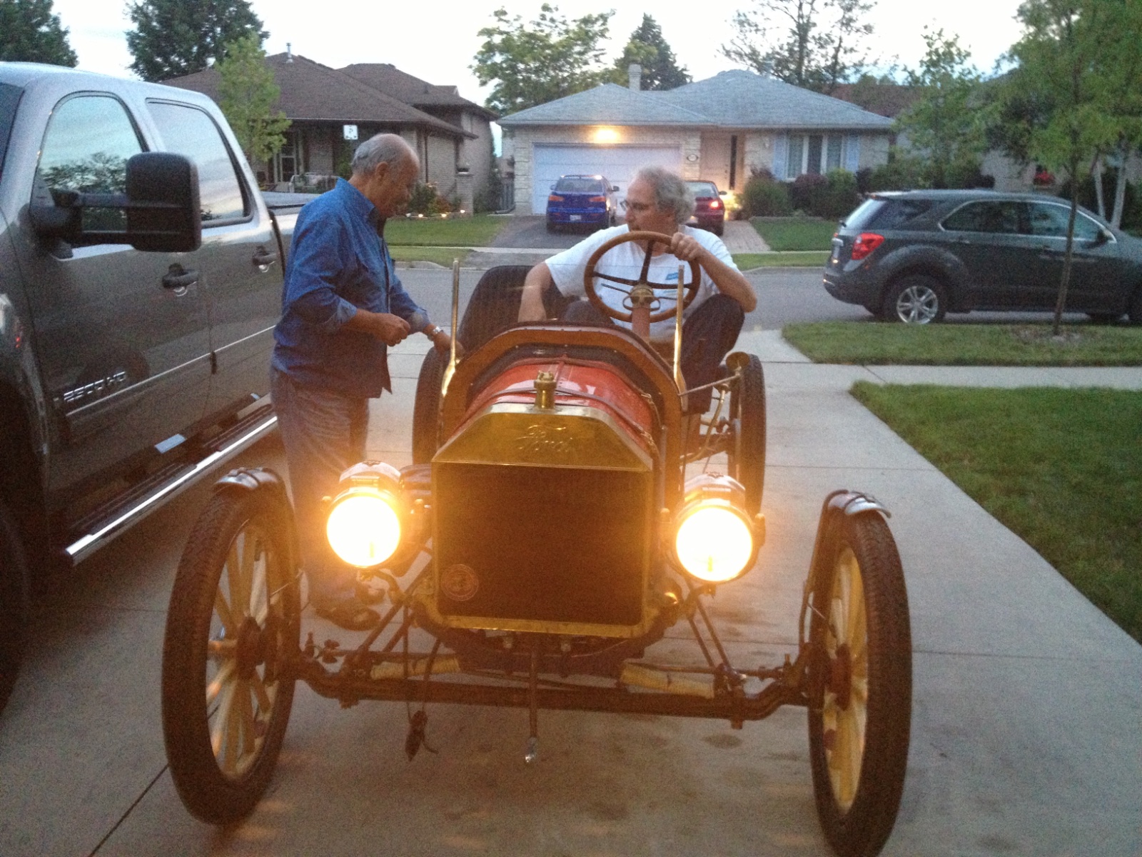

Gene picture as requested 1909 EMF an ex Pollard car. About the talent just basically like most guys here self taught by reading old books and being doggedly persistent to do the best I am capable of. Which translate into I do a lot a of stuff 3 and 4 times or more. Cheers pete

That's the second time in a month or two I have seen spindle arms with the speedo mount hole re-purposed for a different application. Previously they were used as one of the mountings for motorcycle disc brake calipers used on the front axle of Fronty powered T roadster. Very neatly done, and easily reversed. I really liked the brake set-up, as it was far less obvious that the rear axle set used today, even though it was on the front axle.
Clever work.

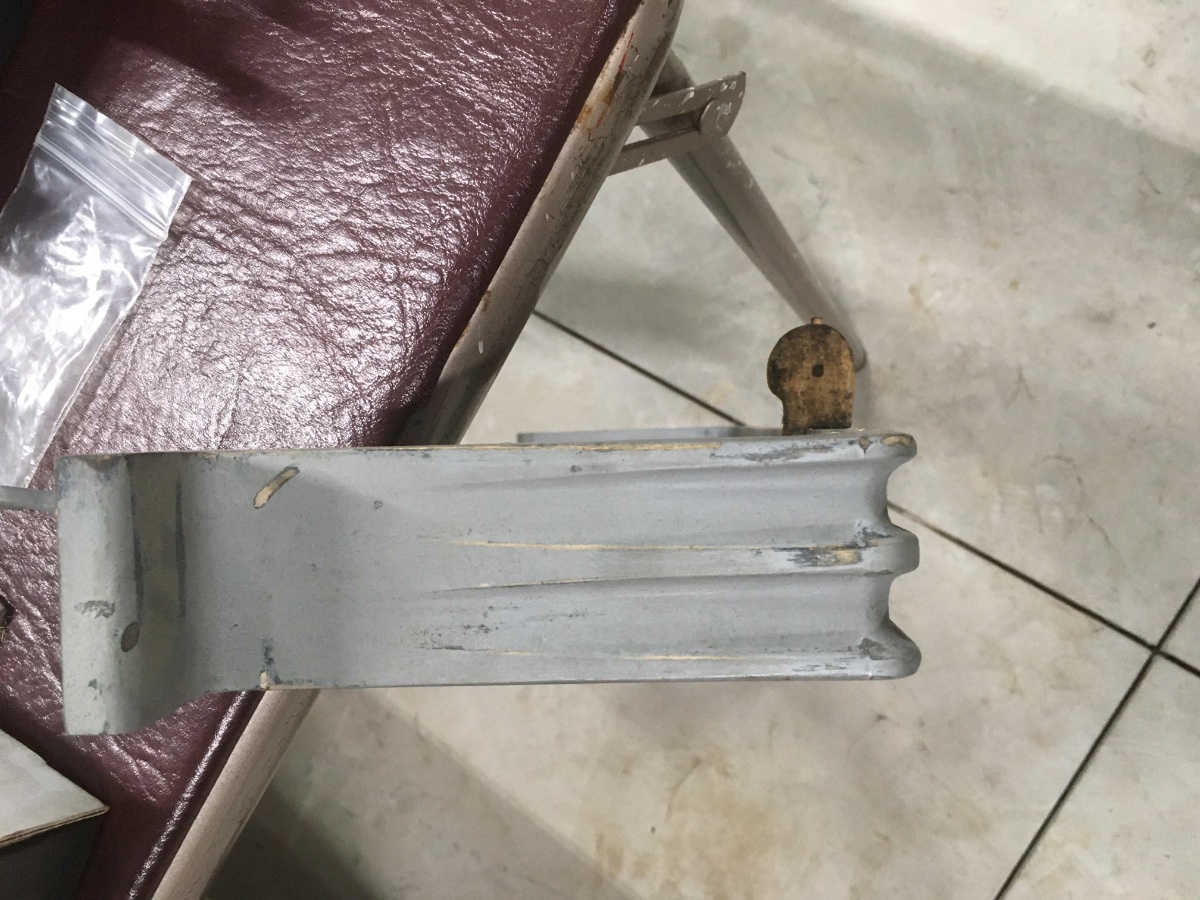

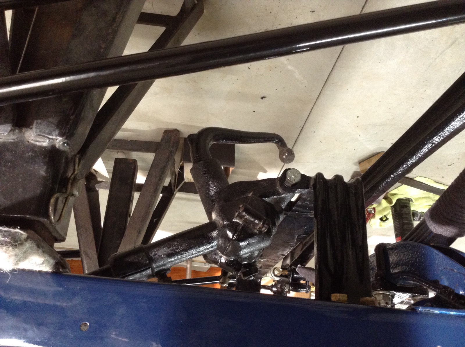

Peter, Is there any chance of getting better photos of the steering box, and any other info you may have on it? I purchased the one on ebay and it is missing the top and the input gear. Thanks in advance.

Post by Playswithbrass » Sun Nov 10, 2019 5:01 pm
John , steering box is a mid teens 490 Chev. For the crossmember I made a wood pattern ( see picture) and had one cast using ductile iron . I was able to use the T steering column jacket,which fits perfect. Notice at the top section off the box the brass collar is there to allow.for the tension springs on the gas and spark rods. I turned the gas/spark quadrant up to the top to be different and give some leg room. Hope this helps,anything else just ask. Cheers pete

Post by Playswithbrass » Sun Nov 10, 2019 5:08 pm
More steering box picture
I am glad someone here got that box. I have a 490 box also but is maybe a bit newer (not sure) and different style.

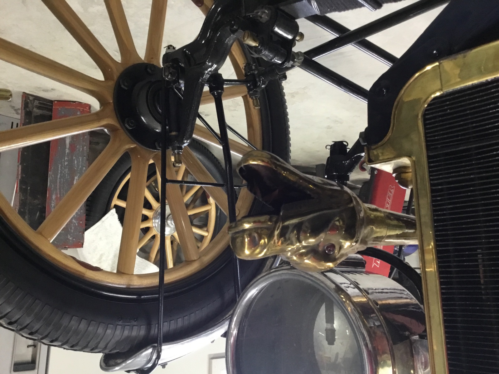

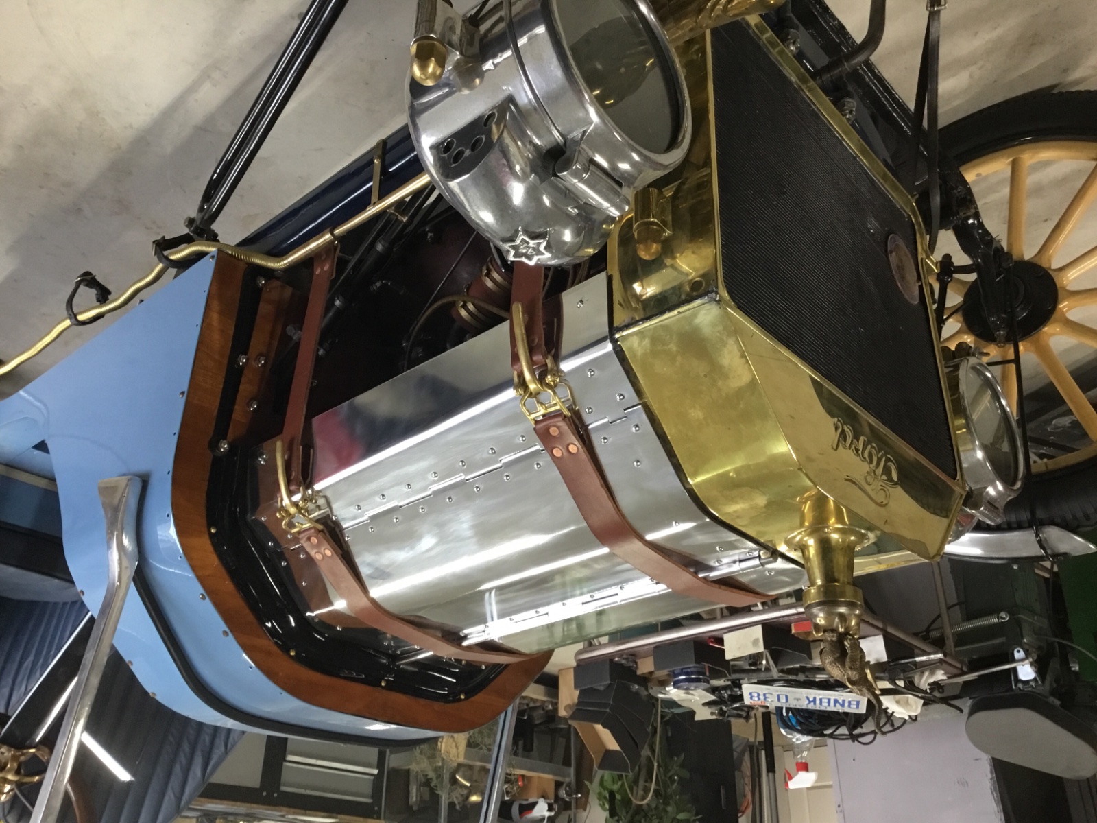

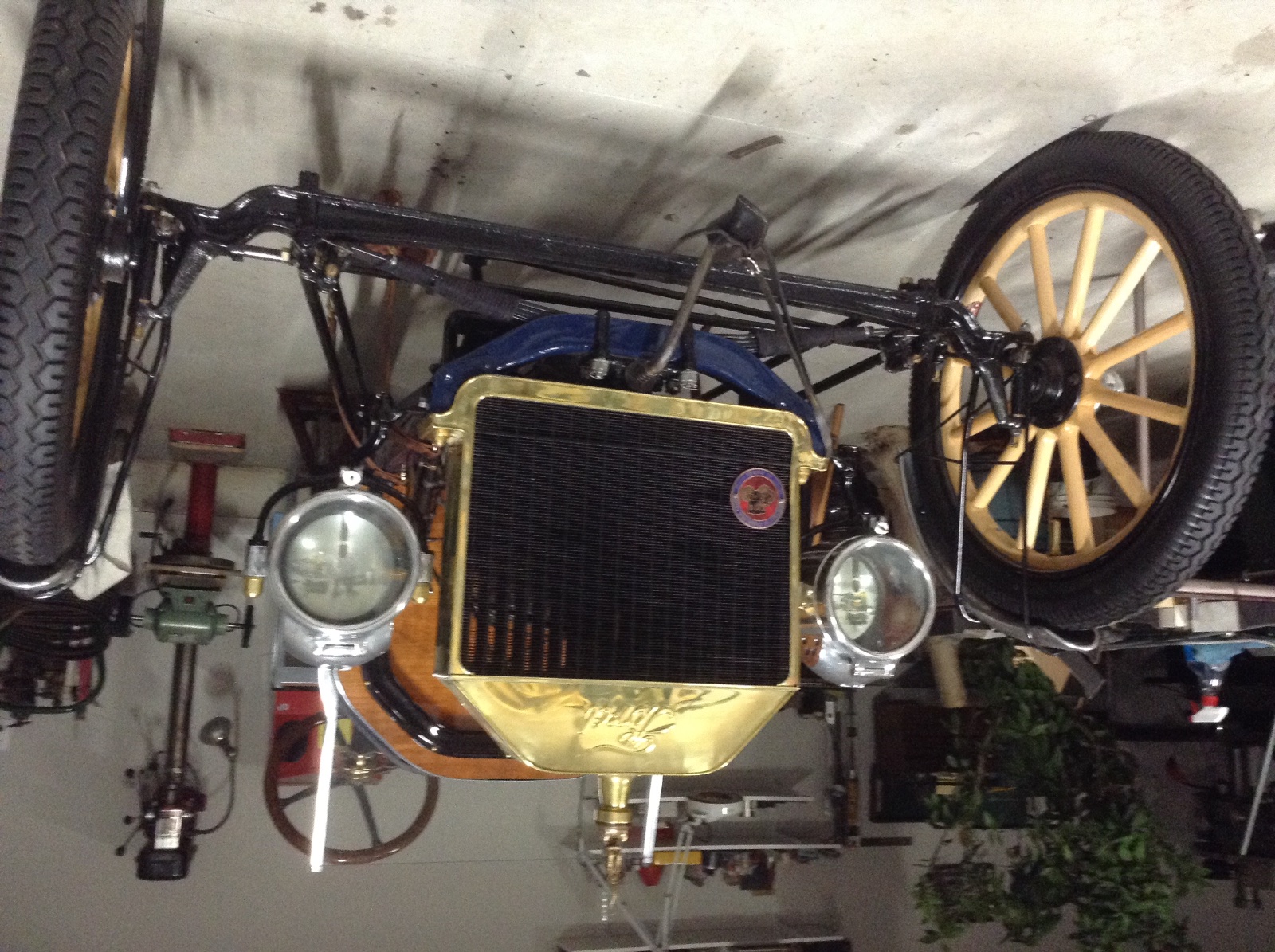

Post by Playswithbrass » Sat Nov 16, 2019 7:34 pm

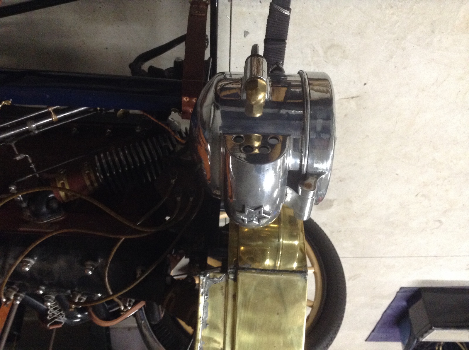

Front end coming together head lamps installed. Bought these off e bay from a vender in Quebec because they were aluminum ,which goes with the aluminum cycle fenders and hub caps etc.when they arrived there was AL cast into the top a quick Google search and these lamps are from a 1907 AL car built in France.

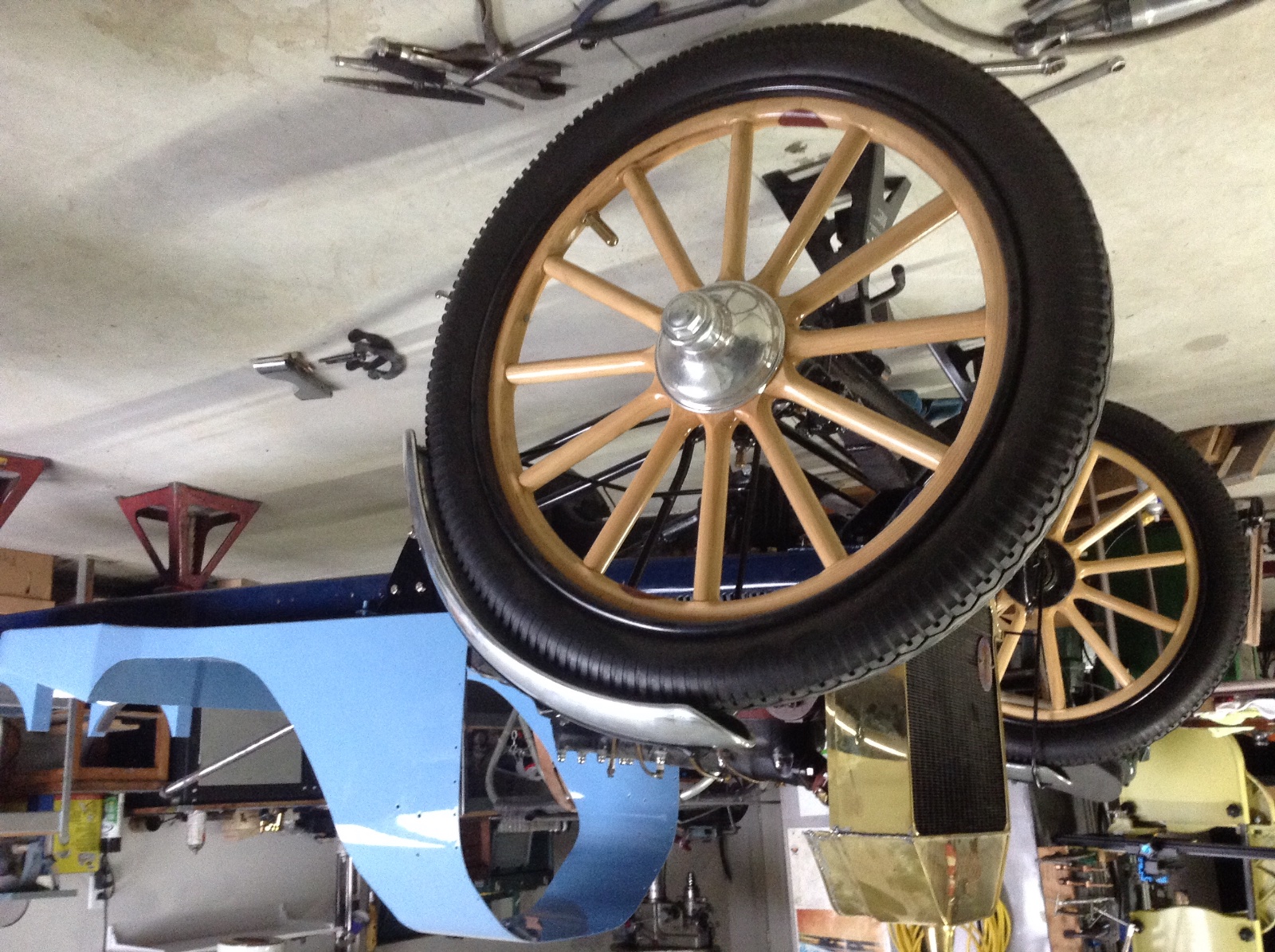

Post by Playswithbrass » Sat Nov 30, 2019 3:35 pm
Freezing rain forecast so I am allowed to work in the garage! Cut the sides of the hood and polished it.
