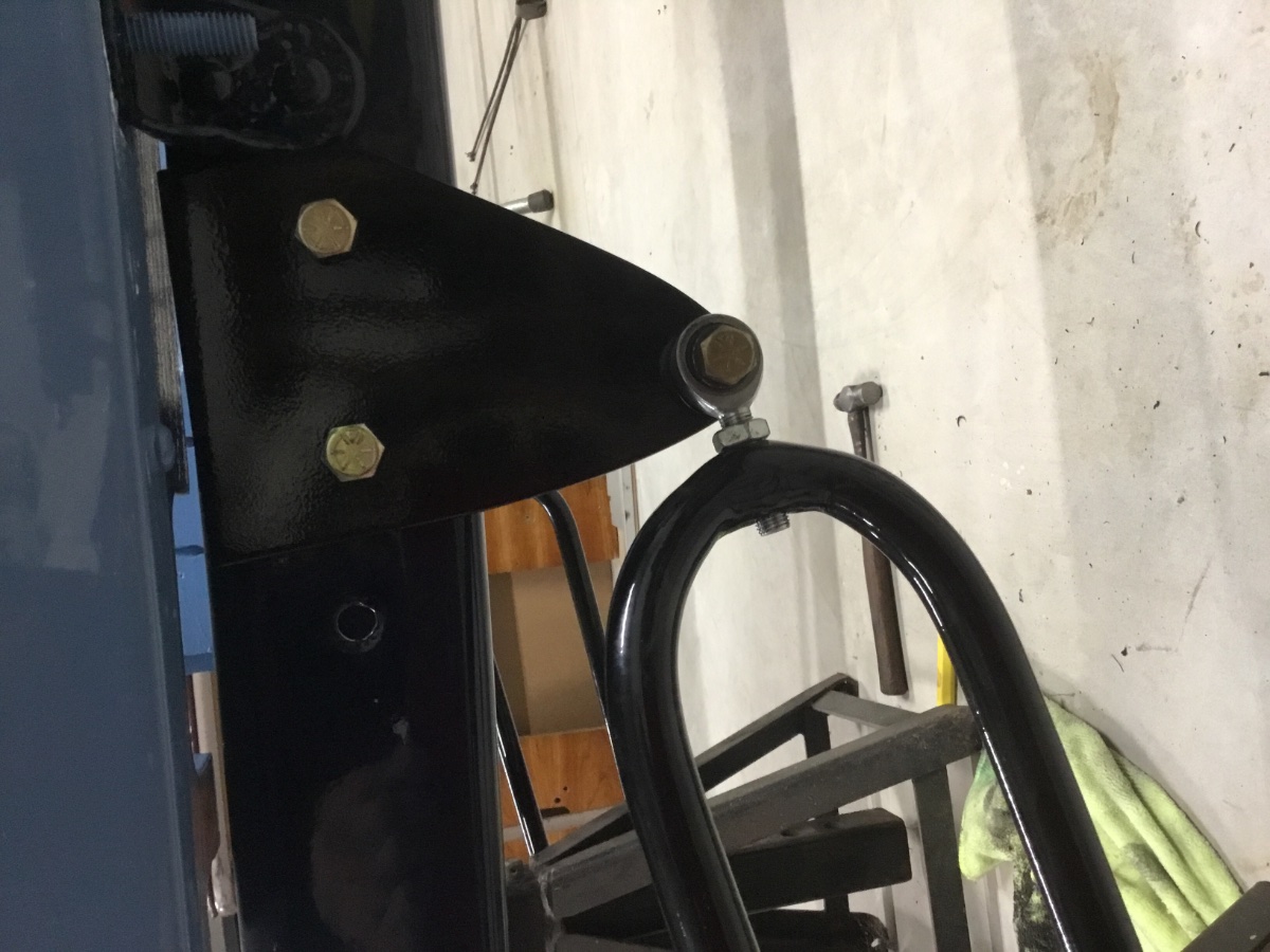

Could you add a few photos of the hairpins and brackets on the axle. Great design - I've been looking to do something like that. Thanks Frank

Peter, Thank you for adding those photos - just what I was looking for!

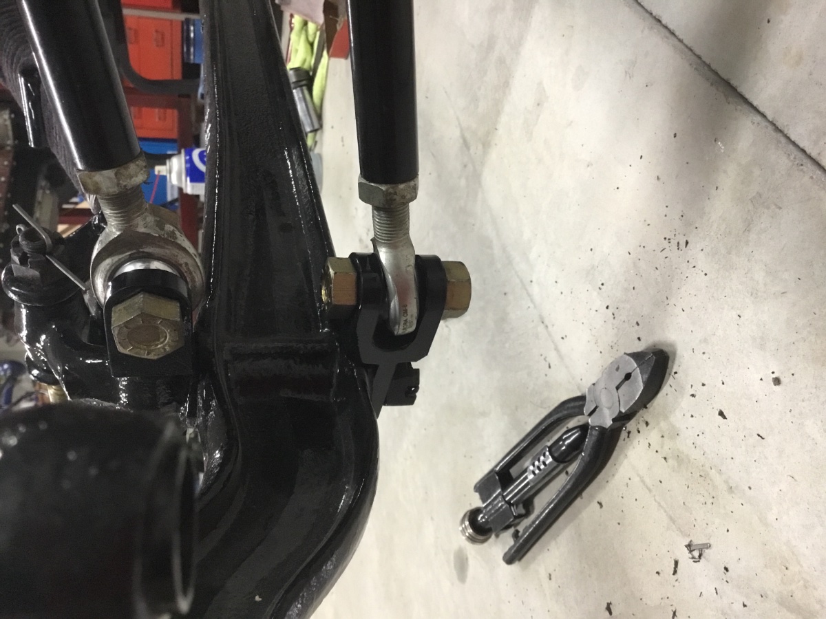

Very nice job with the car and the photos. Could you please post photos of the fender mounts and describe the source of parts?

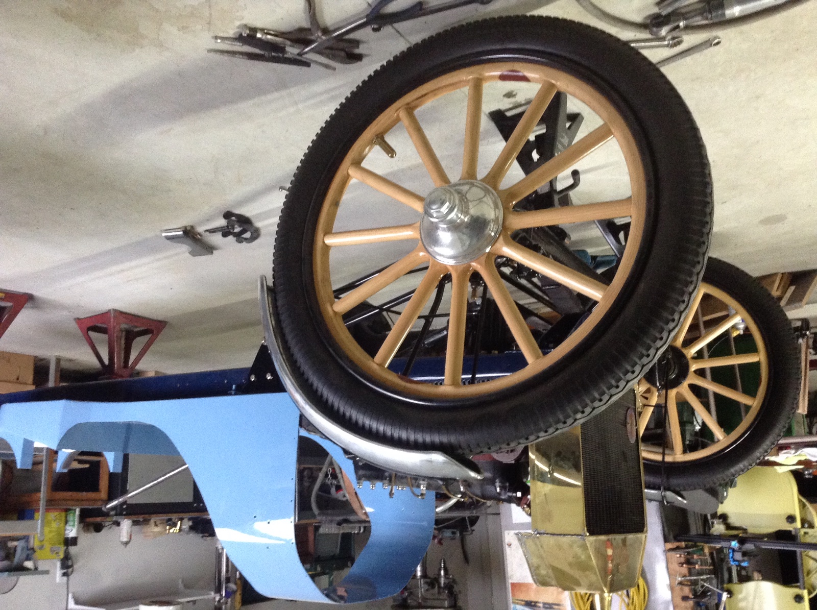

Don pic's as requested.I have used the speedo mount hole in the steering arm,for the left side I turned a right side upside down and bent to fit and used the nut at the front of the arm as well.To come up with the design of the fender bracket we started off simple took the car for a drive,it vibrated badly ,came back to the shop added another cross bracket,took for a drive and so on until the fender did not vibrate.

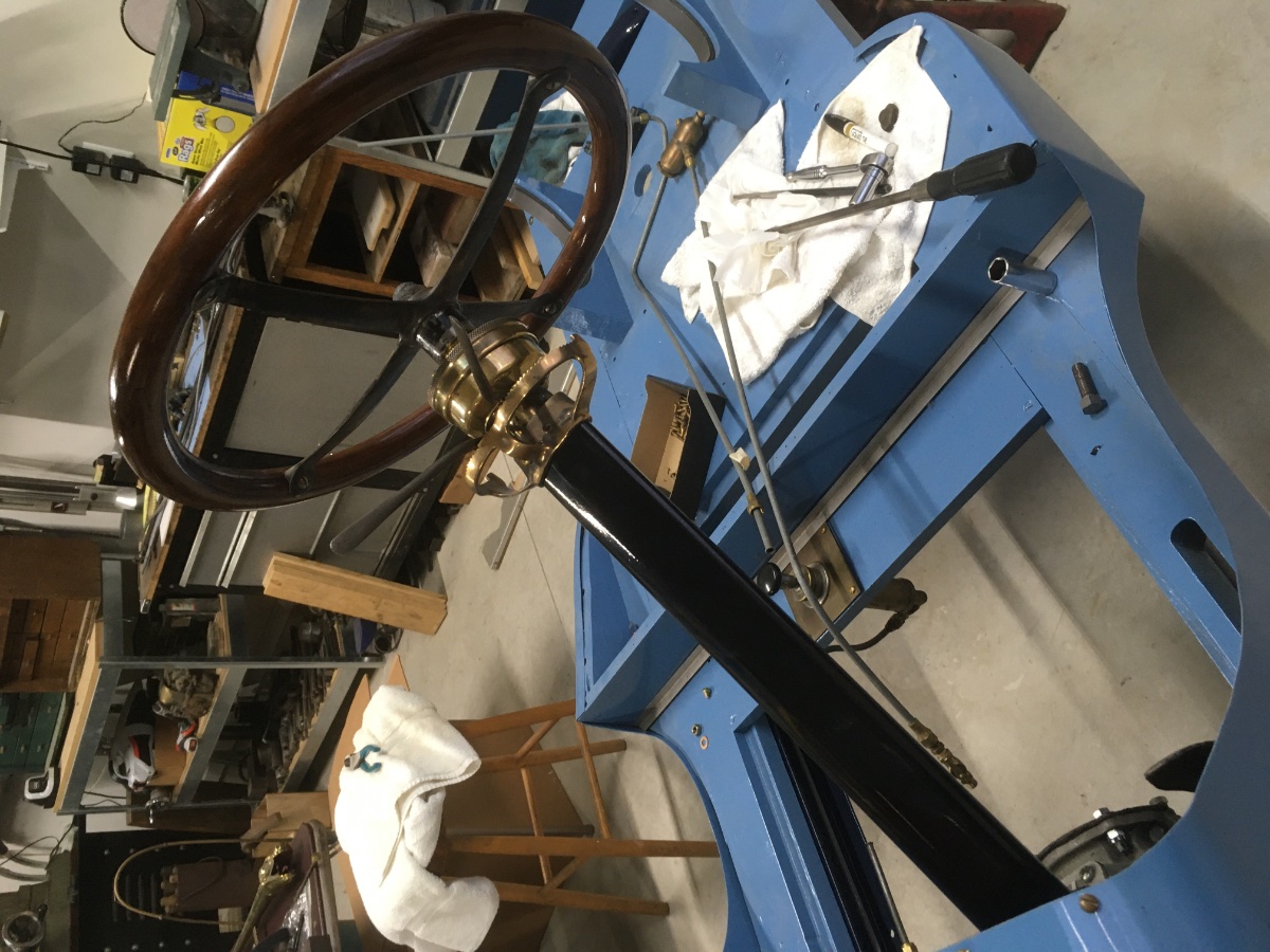

Picture of super rare steering set up. LOL. Cheers pete ps pic's go proper way up when clicked on ,don't understand this

What kind of steering box is that?

Don't know brand of steering box but there is part of one on Ebay;

The photos really show how much work you put into those fender mounts. Great job and thanks for sharing. I will have to just copy them and wait for the time I can tackle a set myself.

Shane ,steering box is from an early 490 chev. Fits right inside the T column.

Like the idea of the cross bar to mount the steering box on. I was thinking to add a mount that ran between the pan rail and frame, but I like that better.

Mark,I made a pattern from wood and had the local foundry cast it in ductile iron.Made it so it had a period correct look. Pete

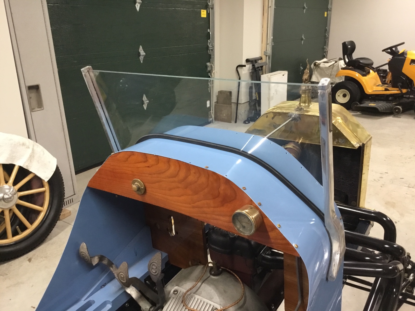

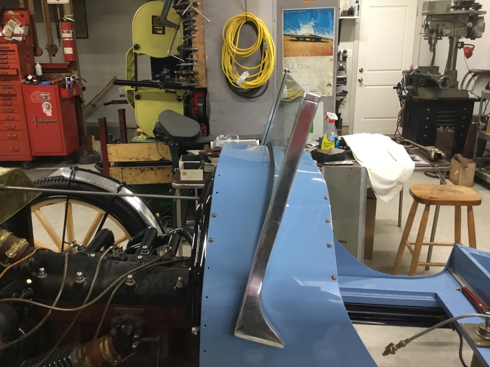

Been kinda slow,but did get the windshield installed. We made a wood pattern then had the Amish who had a aluminum foundry cast the stanchion’s. However lots of sanding and buffing required. Cheers pete

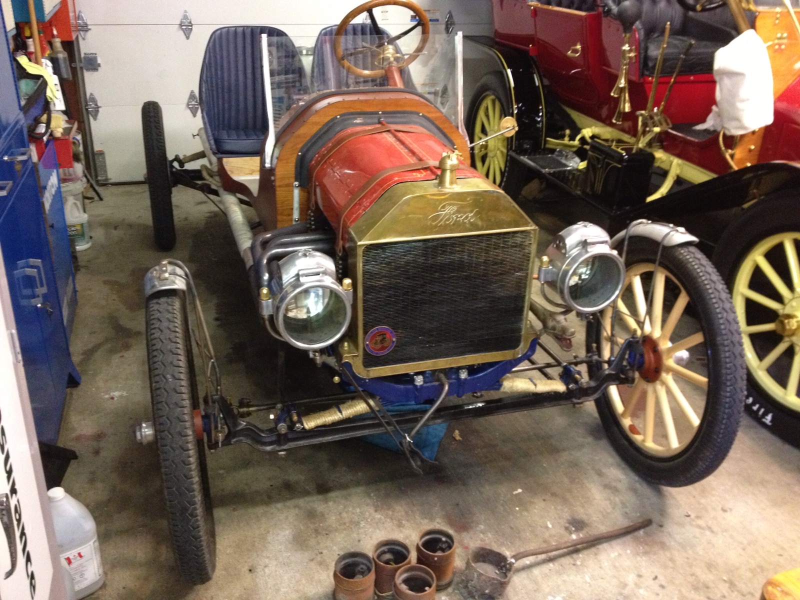

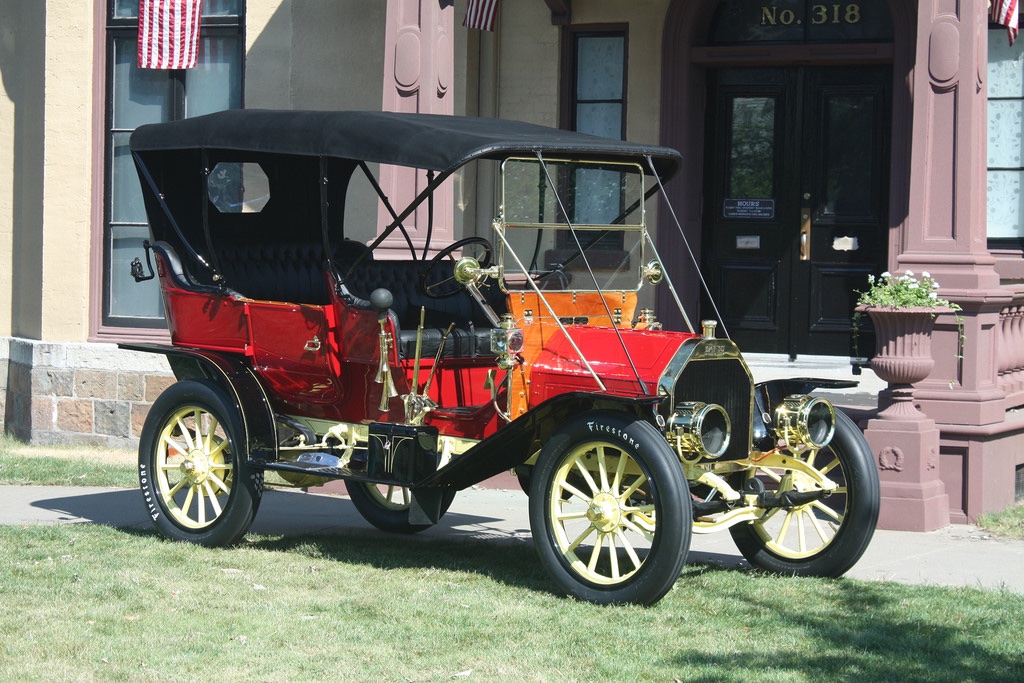

What's the equally beautiful brass car next to the speedster?
Can you post a picture of that vehicle too?

Gene picture as requested 1909 EMF an ex Pollard car. About the talent just basically like most guys here self taught by reading old books and being doggedly persistent to do the best I am capable of. Which translate into I do a lot a of stuff 3 and 4 times or more. Cheers pete

Peter, Is there any chance of getting better photos of the steering box, and any other info you may have on it? I purchased the one on ebay and it is missing the top and the input gear. Thanks in advance.

John , steering box is a mid teens 490 Chev. For the crossmember I made a wood pattern ( see picture) and had one cast using ductile iron . I was able to use the T steering column jacket,which fits perfect. Notice at the top section off the box the brass collar is there to allow.for the tension springs on the gas and spark rods. I turned the gas/spark quadrant up to the top to be different and give some leg room. Hope this helps,anything else just ask. Cheers pete

I am glad someone here got that box. I have a 490 box also but is maybe a bit newer (not sure) and different style.John Warren wrote: ↑Sun Nov 10, 2019 12:58 pmPeter, Is there any chance of getting better photos of the steering box, and any other info you may have on it? I purchased the one on ebay and it is missing the top and the input gear. Thanks in advance.

Peter, Looking great! Also thanks for the additional photos and info on the steering gear.
