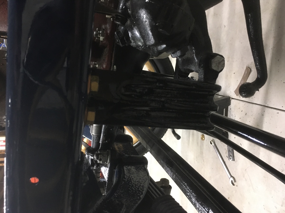

Could you add a few photos of the hairpins and brackets on the axle. Great design - I've been looking to do something like that.  Thanks Frank

Peter, Thank you for adding those photos - just what I was looking for!     Frank

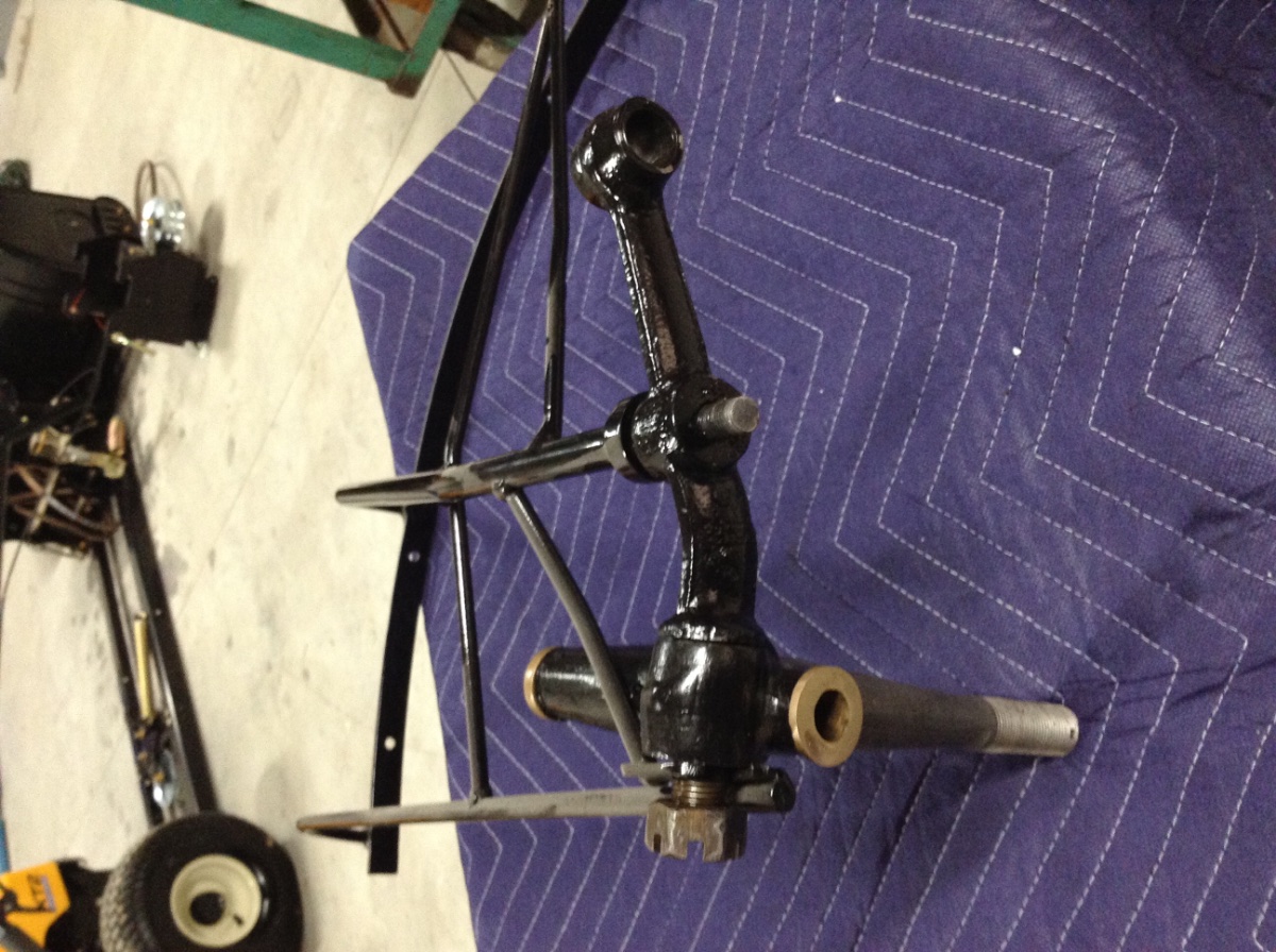

Very nice job with the car and the photos. Could you please post photos of the fender mounts and describe the source of parts?

Don pic's as requested.I have used the speedo mount hole in the steering arm,for the left side I turned a right side upside down and bent to fit and used the nut at the front of the arm as well.To come up with the design of the fender bracket we started off simple took the car for a drive,it vibrated badly ,came back to the shop added another cross bracket,took for a drive and so on until the fender did not vibrate.

The photos really show how much work you put into those fender mounts. Great job and thanks for sharing. I will have to just copy them and wait for the time I can tackle a set myself.

That's the second time in a month or two I have seen spindle arms with the speedo mount hole re-purposed for a different application. Previously they were used as one of the mountings for motorcycle disc brake calipers used on the front axle of Fronty powered T roadster. Very neatly done, and easily reversed. I really liked the brake set-up, as it was far less obvious that the rear axle set used today, even though it was on the front axle.
Clever work.

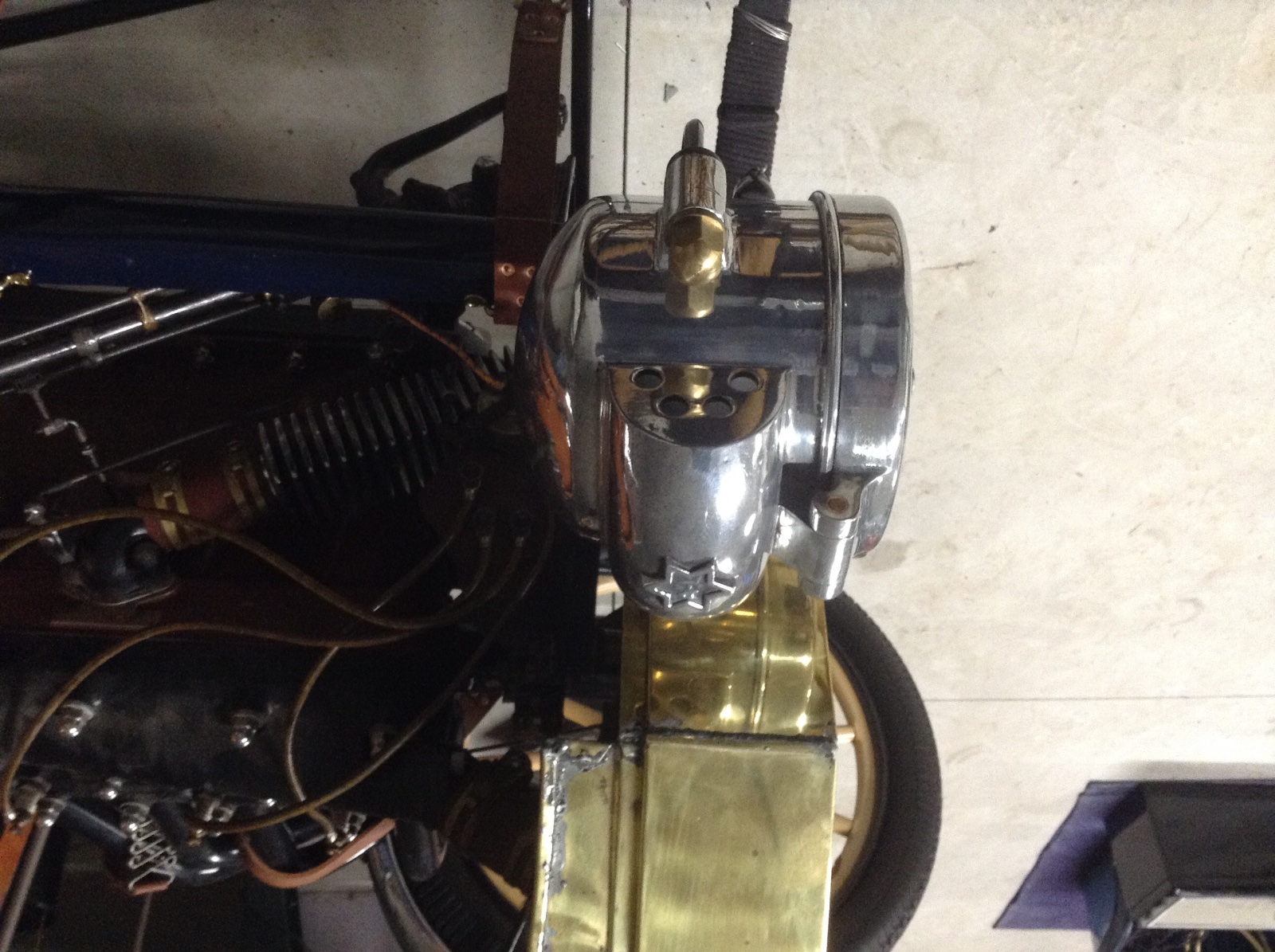

Front end coming together head lamps installed. Bought these off e bay from a vender in Quebec because they were aluminum ,which goes with the aluminum cycle fenders and hub caps etc.when they arrived there was AL cast into the top a quick Google search and these lamps are from a 1907 AL car built in France.
