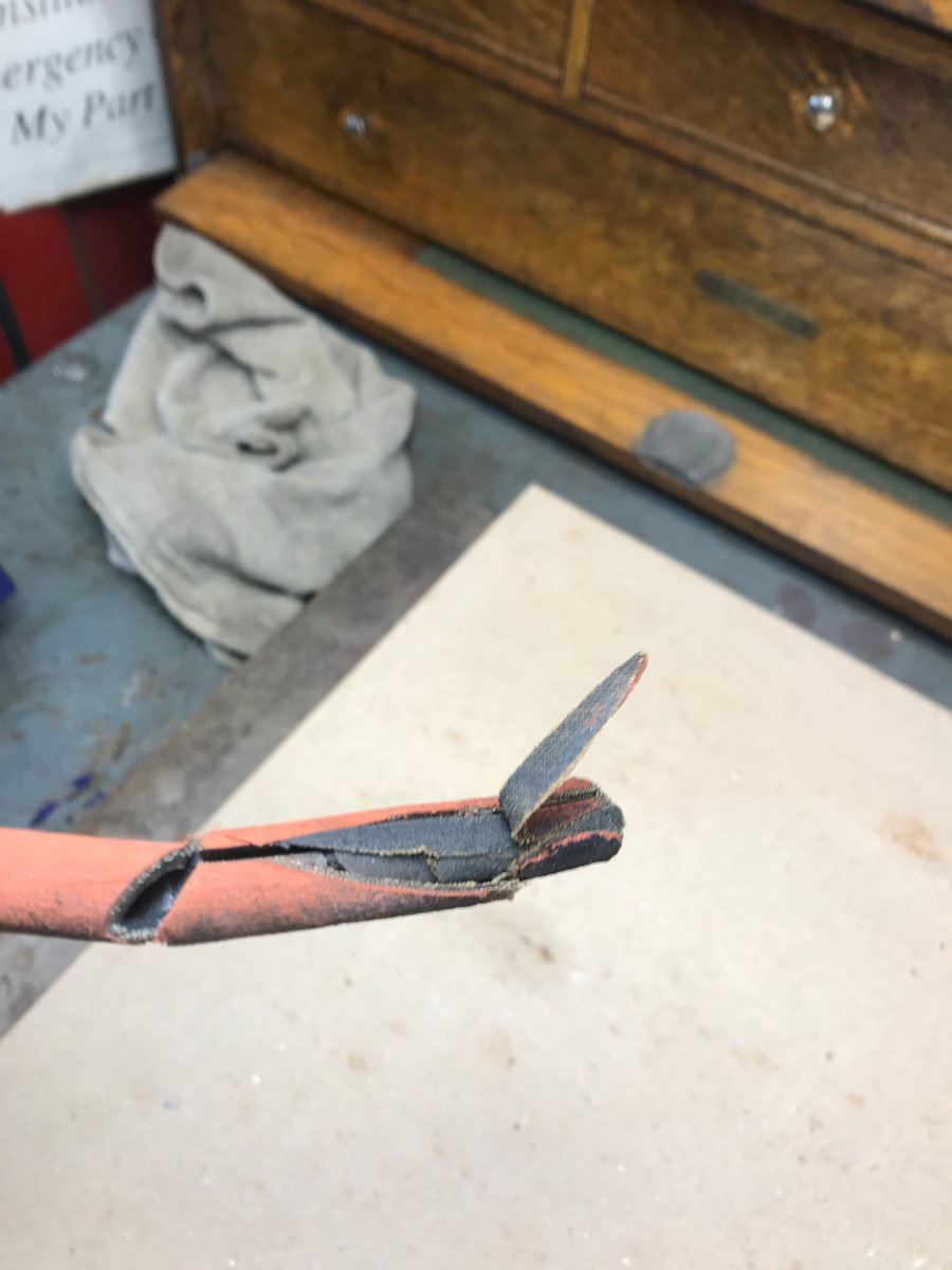

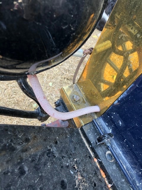

Re: 1913-14 Gaslight hose
Here's photos of my "original" hose. It is between 24 3/4" and 25" long. The outside diameter is 15/32", slightly over 7/16" as Larry pointed out for original specs. Since my car is a Canadian car, some variations may apply(?) This has been on this car since my grandfather bought it in 1956. I would imagine, it's been there all it's life. I have no way of proving it but take this info for what it's worth. Hope this is helpful. The hose is cloth wrapped.

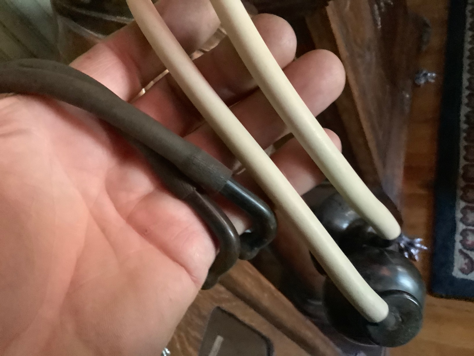

Sample 1913-14 Gaslight hose
The off white is $2.88/ft. The red is $2.80/ft. The red shown is shown for color, it’s a different size that I’m using for something else.
- Posts: 1596
- First Name: Kim
- Last Name: Dobbins
I agree with Tim on the off white hose. I have seen it still attached to old burner elbows.
