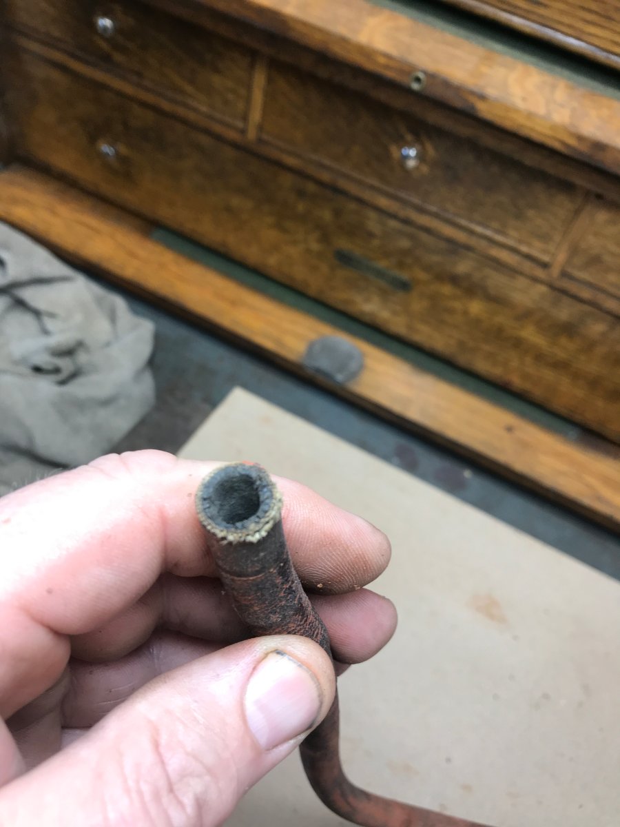

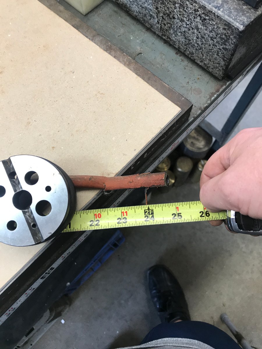

Here's photos of my "original" hose. It is between 24 3/4" and 25" long. The outside diameter is 15/32", slightly over 7/16" as Larry pointed out for original specs. Since my car is a Canadian car, some variations may apply(?) This has been on this car since my grandfather bought it in 1956. I would imagine, it's been there all it's life. I have no way of proving it but take this info for what it's worth. Hope this is helpful. The hose is cloth wrapped.

While not correct mine works perfectly and welding hose comes in more than one size.I would avoid old cracking hose but that is just me.Bud. :D
