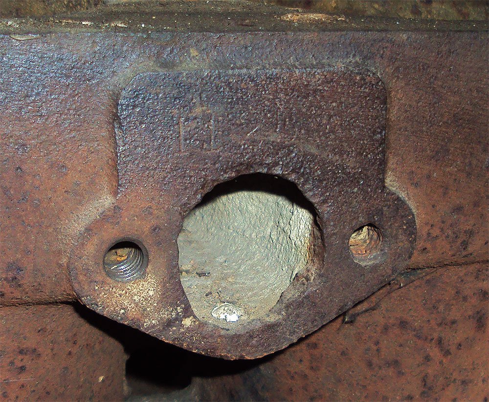

I moved stuff around and pulled the block into the light to take a picture. After 18 tries this is the best I could do. You can make out the 1125. There is no indication of any other digits. I also doesn't look as if any metal has been ground off of it. It looks like my 1925 and earlier blocks with no bosses for the hogs head.
“Curiouser and curiouser!”Rich

I would say it is a 22 late or 23 from the small hole on the valve door and the smaller area at the serial number plate.
Re: 1941 Model T motor
Thanks Joe. I guess I should show more of the block. I'm not sure what the J and X indicate.
