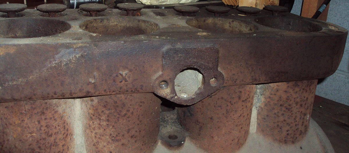

Re: 1941 Model T motor
Thanks Joe. I guess I should show more of the block. I'm not sure what the J and X indicate.
The 41 cast on side is most likely a mold number and not a date.
I would bet all engines sold after 27 were not cast just before they shipped, but were left over engines. I do not think Ford would tool up just to make one engine for some Ford dealer in who knows where. Most likely engines were just stored somewhere and when a dealer needed one they got one out and shipped it. Why do you think there were no more after 41, something happened in Dec that changed all that.
The engines were worth more as scrap iron than model T engines. Dan
