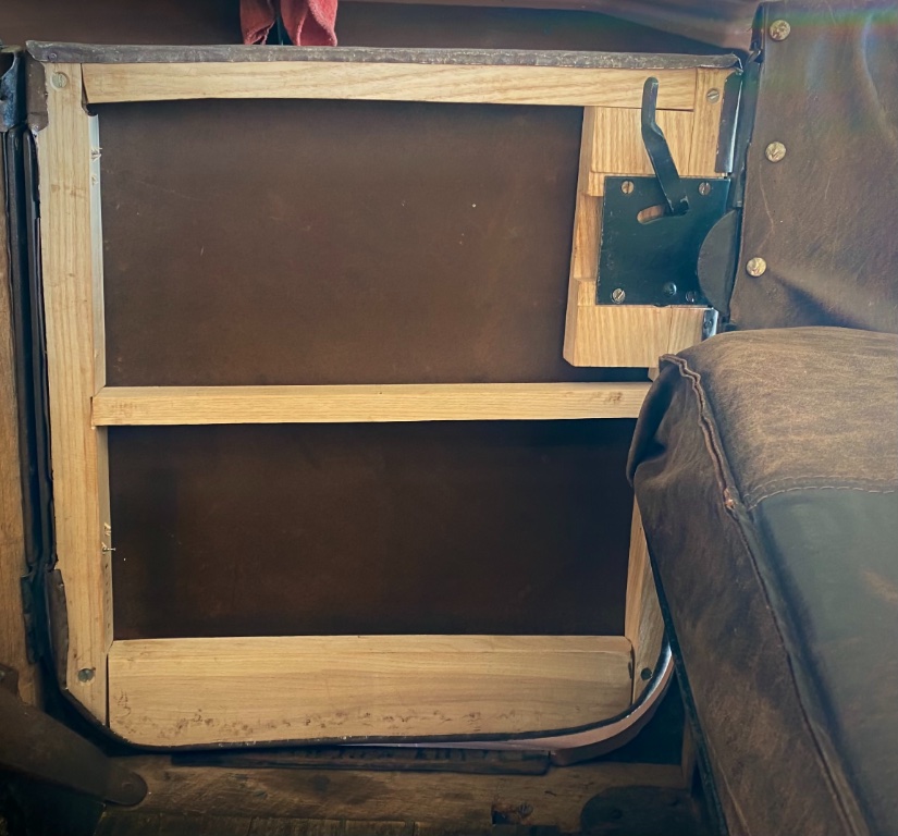

I shouldn't as it's late but holy crap! I bet it's very comfortable already!
Thanks to people like you and other good-scroungers (one of our Mark's!), I look for leather couches around here...
I'll get you my pretty! Eh hem, leather.
It is VERY cozy...so much so that I'm hesistant to mess with it much more. That old thick leather is soft like a nicely used baseball glove.
The guys over on the HAMB hotrod site are where I got the idea to scrounge a leather couch. They've been doing that for roadster upholstery for a while.
I wasn't finding a suitable donor couch laying on the curb so I went on the local online classifieds site and found a lady trying to sell her leather couch and loveseat set for $400. It was perfect...not a lot of fussiness in the design, just big flat expanses of thick high quality leather.
I know, from personal experience that used upholstered furniture is almost impossible to sell...for any amount of money. I've tried to do it and I always end up just giving it away, or worse...taking it to the dump.
So I contacted the lady and said that I hoped she got her asking price on her pretty couches but if she ever got to the point where she just needed them gone, I would come get them. I told her how I was needing the leather for my Model T project and I sent her a photo of the car. A few weeks later, she said they were in her driveway and I could come get them for free.

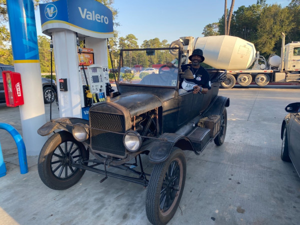

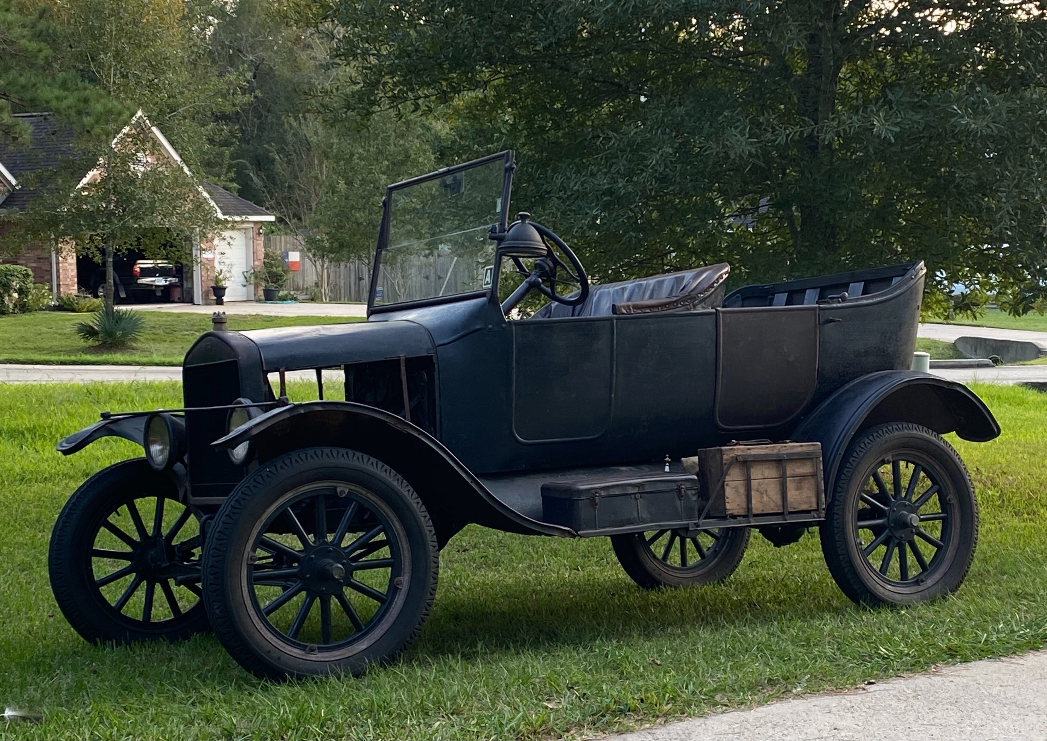

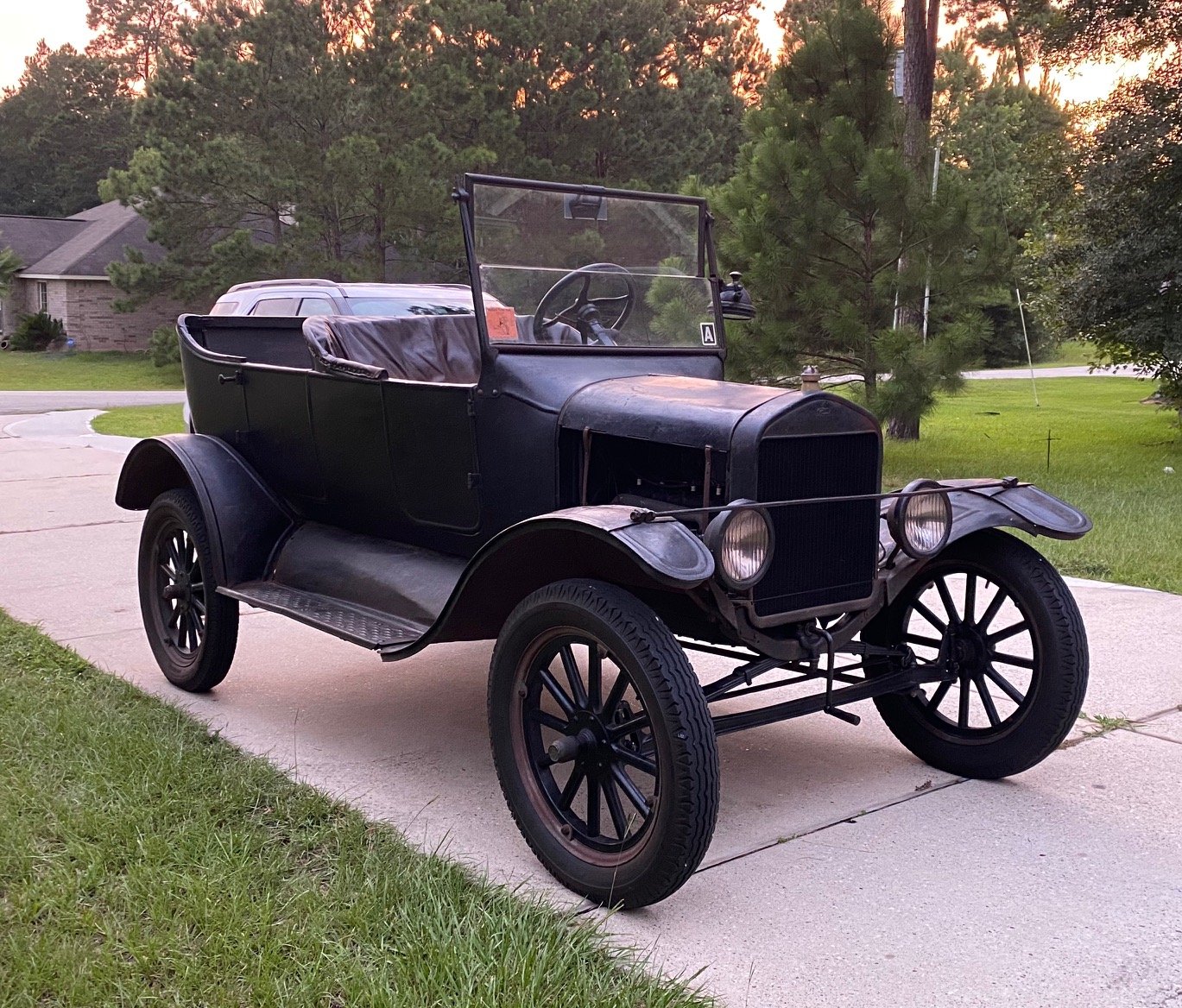

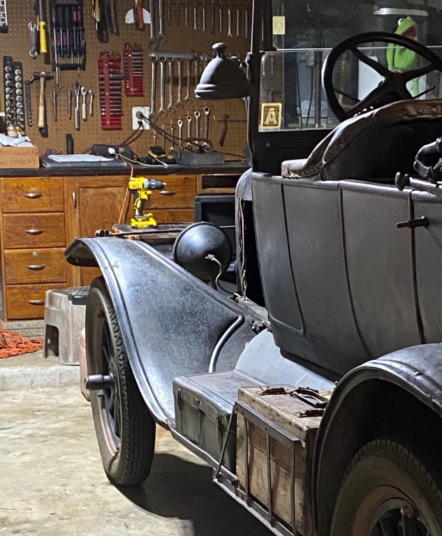

Here's a couple shots of the T's current state.
The focus right now is wood and interior coverings.
A little interesting tidbit: When I started running this freshened-up engine, I installed one of those accessory transmission screens with the little magnet. Then about a month ago, I removed it to clean it and then ran the car without it. I immediately noticed that, without it installed, the transmission was quite a bit more noisy.
Then a couple days ago, I re-installed the screen and the transmission went back to being more quiet again. I'm wondering if the screen is directing more oil to various places in the transmission and quieting it down. Just a theory.

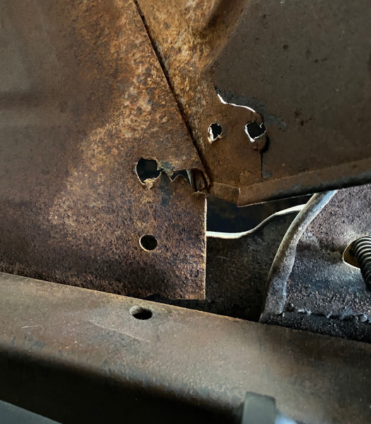

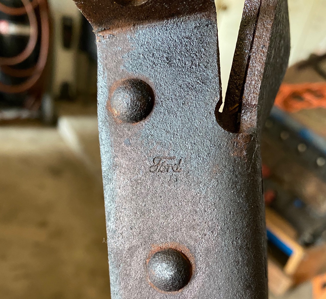

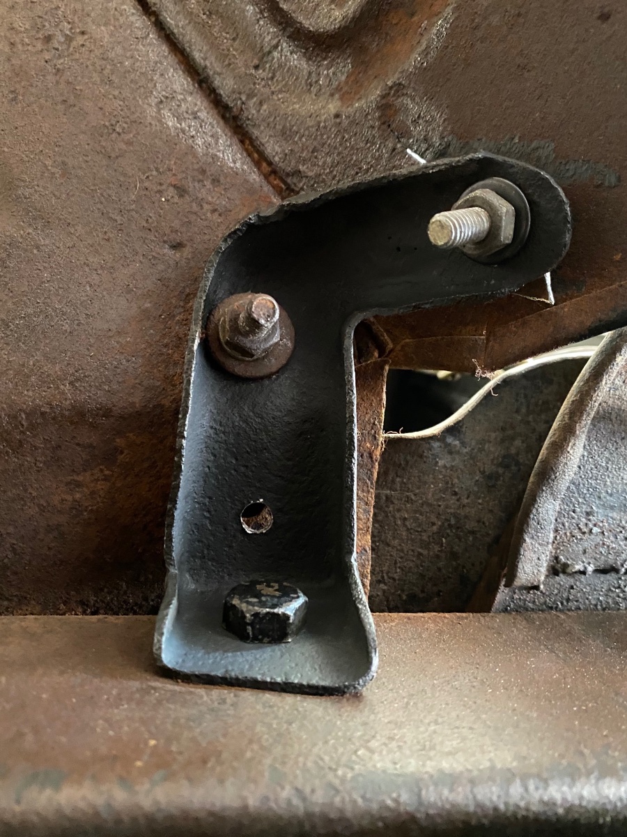

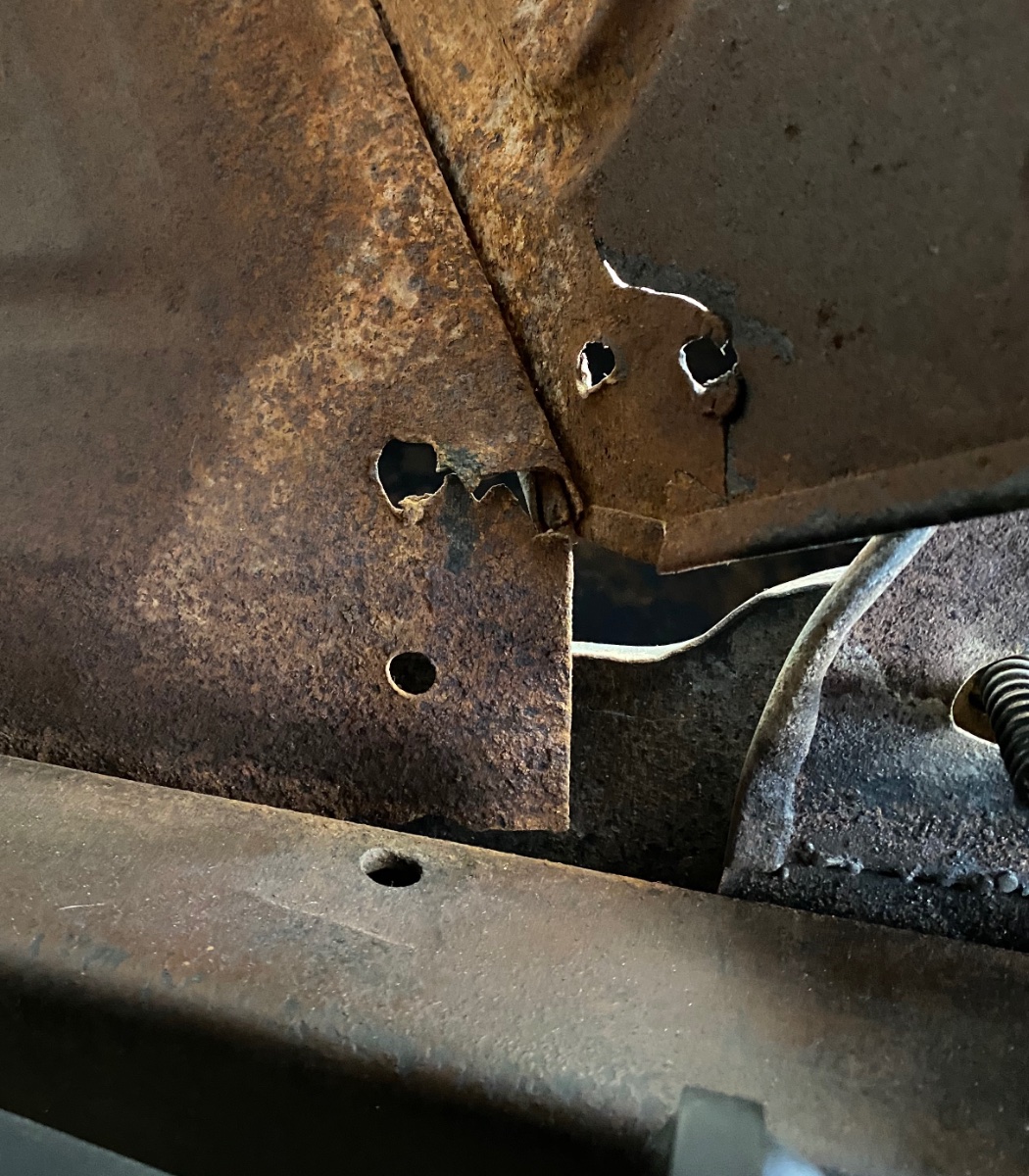

The driver’s side fender/splash apron support bracket was missing and the sheet metal in that area was beat up pretty bad.
A forum member kindly donated an OEM bracket and I installed it this morning. I’m going to come up with a support patch for the sheet metal that looks 75 years old, but for now I just installed the bracket.
I’ll ruminate on what that patch should look like.
There’s one more fastener to install but it’s under the hood shelf. I’ll wait until I have a reason to take off the shelf before I do that.
1924 Touring
Posts: 6781
Re: 24 Touring Barn Car Revival - Part 3
Post by Allan » Sun Aug 02, 2020 8:45 pm
Don, I'd drill a small hole at the end of that crack. It may well stop it getting any worse. If the crack stops there, there may be no need for any further repairs. On Henrietta, the rear mudguards were mounted under the tray with a bolt through the outside bead only. This allowed them to wobble and that resulted in a significant crack in one of them at the splash panel bracket. I took the mudguard off and oxy welded the crack. It was left like that and after two years the repair looks as old as the car. I did put a bolt through the inner bead on the mudguard to stop the wobble, so it is not likely to recur. On the other side of the car, it was the splash panel that cracked. That is too much work to get off to weld, so it has just been left. the second bolt through the mudguard hes stopped all the flexing anyway.
That’s probably the best solution Allan. I’ve welded a couple other cracks on this car and you’re right...after a few years, they are starting to look like very old repairs.

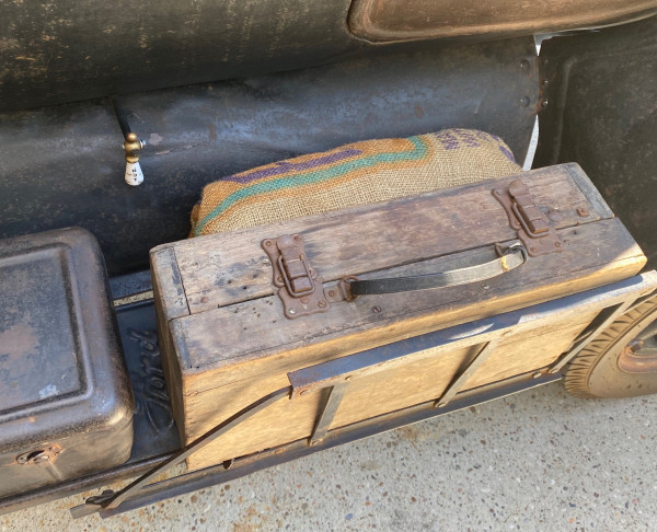

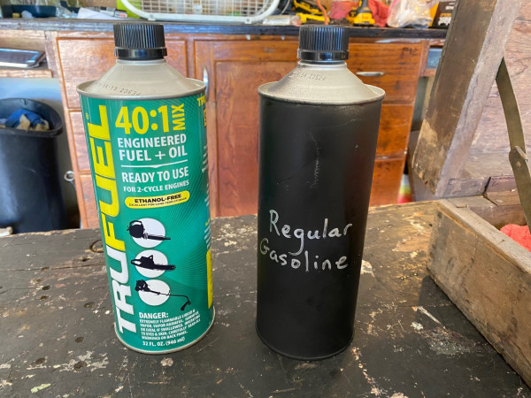

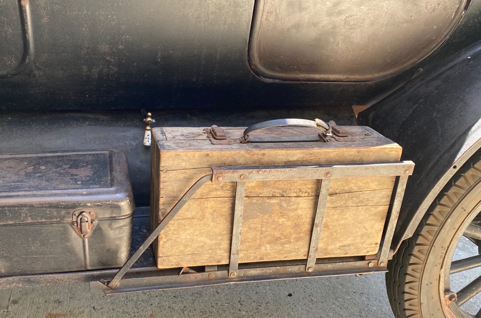

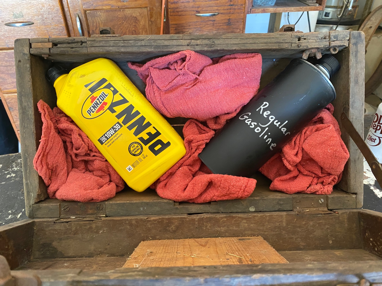

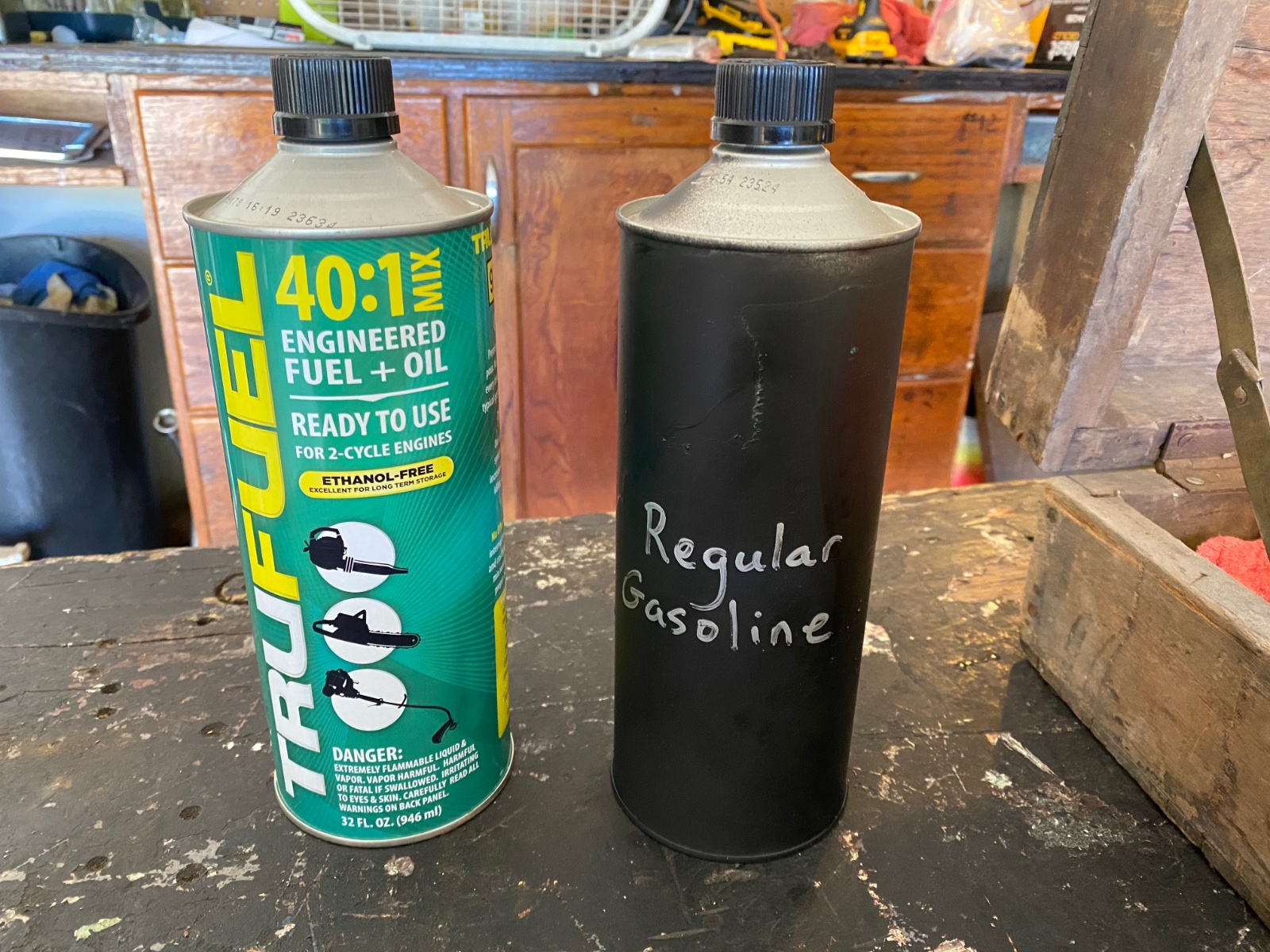

Here’s how I’m storing my emergency gasoline and oil.
John Mays gave me this gorgeous old wooden box when he sold his home. It’s being held in place by a cut-down running board rack and a bunch of rolled up burlap sacks. The rack was with the car when it was pulled from the hay shed, so I wanted to keep it with the car.
I use the pre-mix fuel for my weed-whacker and painted one of the empty cans then labeled it. It’s rated for gasoline and doesn’t leak, so it’s perfect.
Then I added a bottle of oil and stuffed the voids with clean shop rags...and viola!
It’s not a lot of gas, but it should be enough to get to the next gas station.
I tried to make all of it practical. The burlap sacks can be used as a mat to lay on the ground when doing repairs...you can’t ever have too many shop rags and the old box matches the look of the car. I probably need to lash it all down with some old twine.

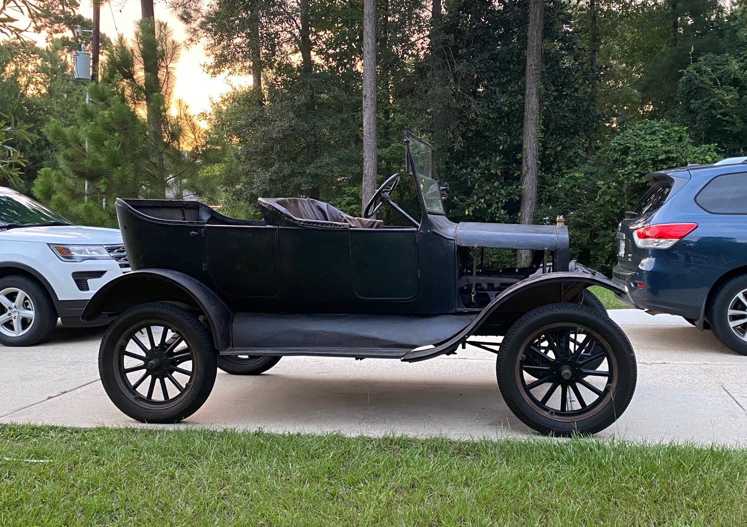

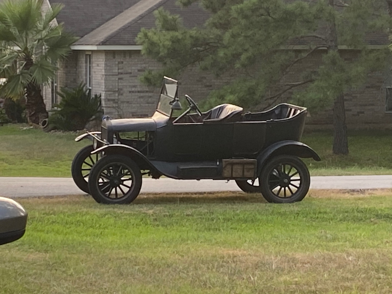

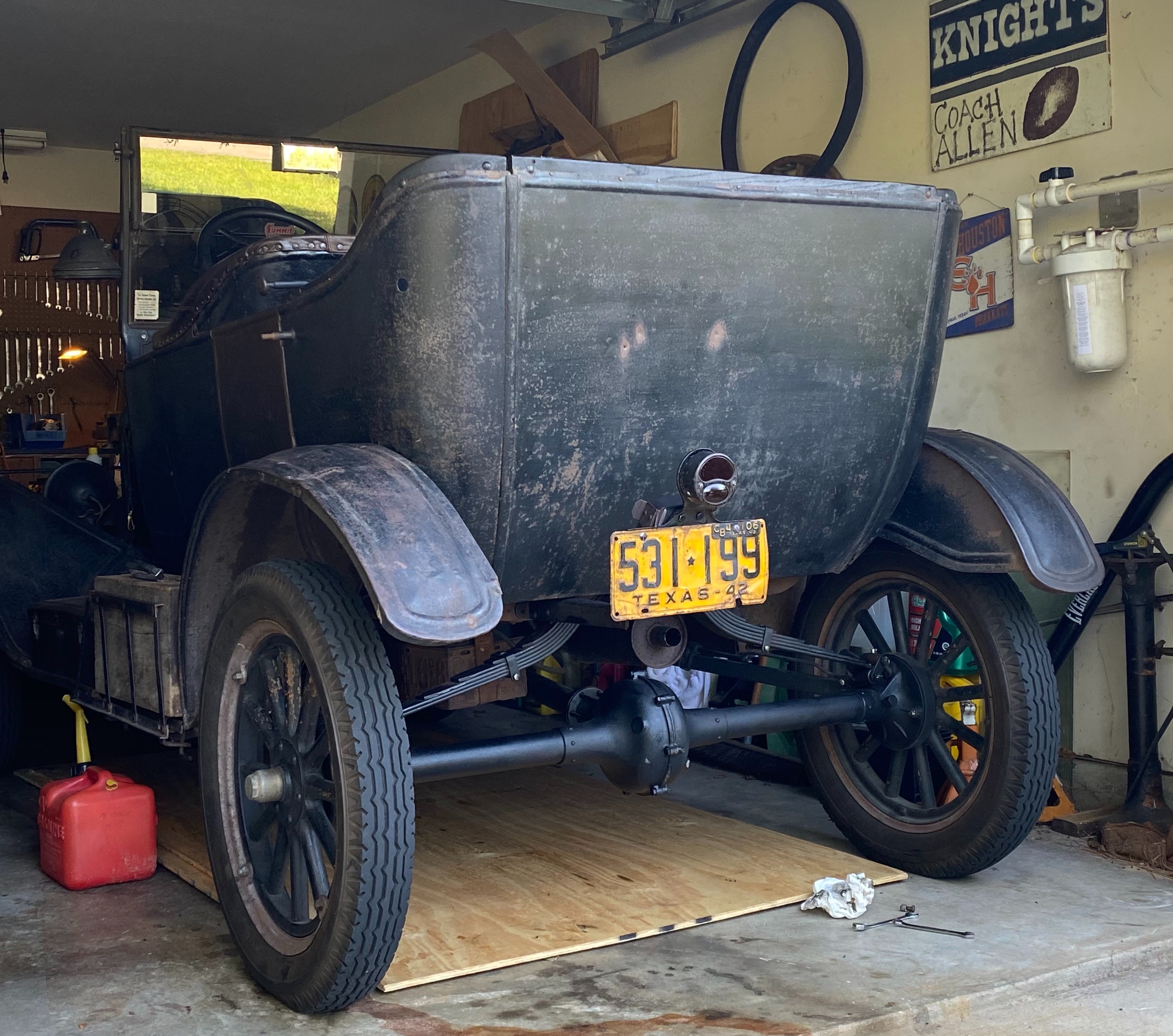

The latest side view...

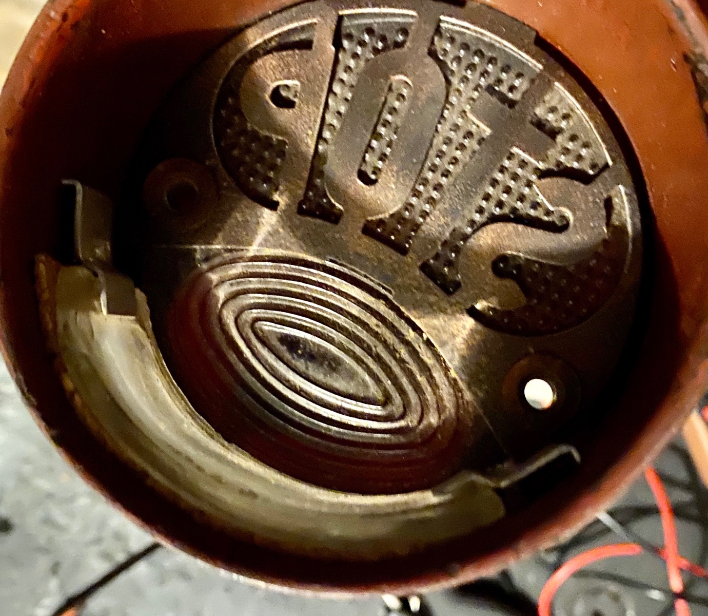

I’m working on my spare tire carrier and tail light.
I have a beautifully weathered tail light/ stop light and license plate bracket that even has a metal insert that makes it say “STOP” on the top half.
The guts of it need a full rebuild and that’s a fun little bench project.
I‘m going to buy one of the stop light switches from Lang’s and have separate taillight and stop light functionality.

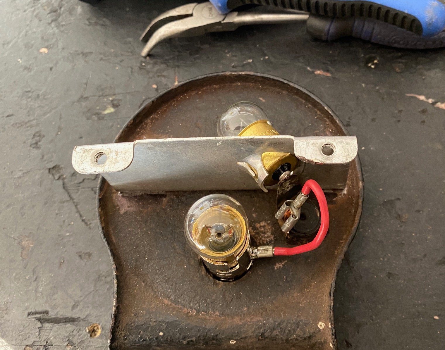

Post by RustyFords » Mon Aug 24, 2020 1:06 pm

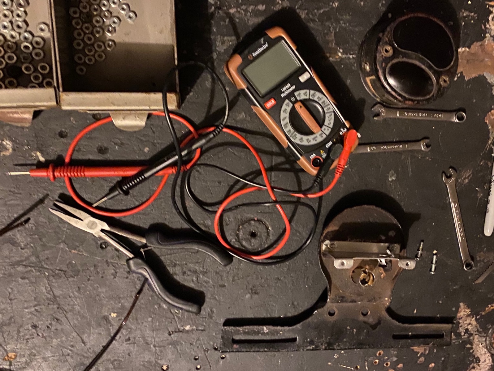

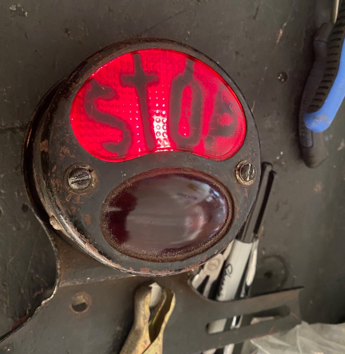

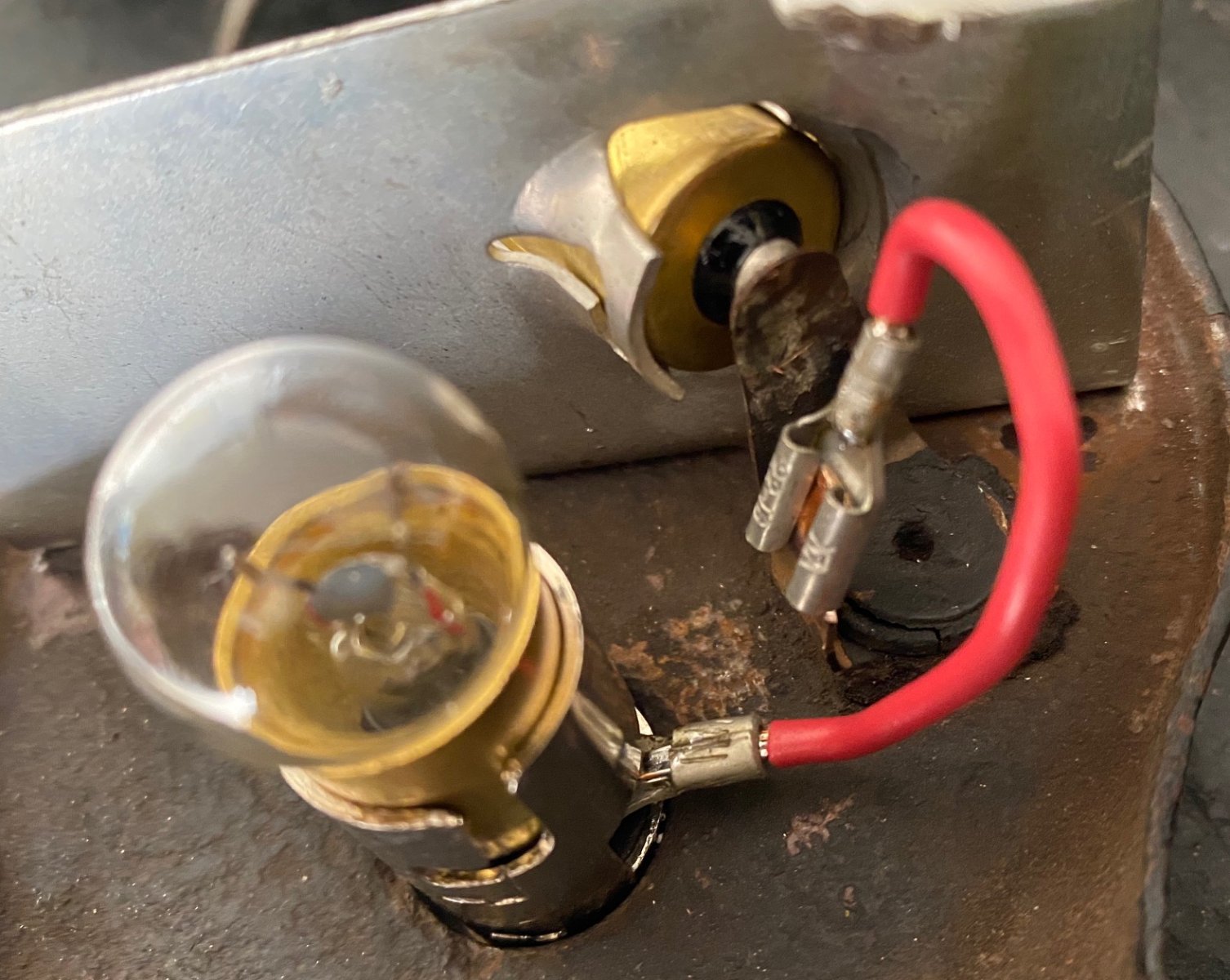

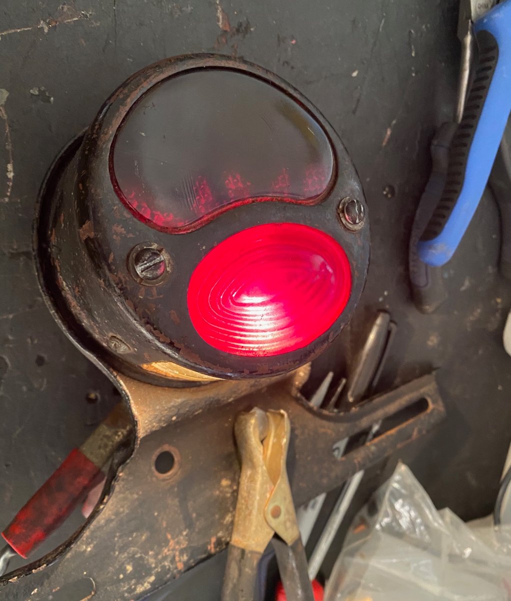

This Model A tail light is set up to have separate tail light and brake light functions....which is exactly what I'm wanting. The fact that it says "STOP" is just a cool little bonus.
However, it was setup to achieve this via a weird little jumper springy metal tab that had broken. Instead of ordering a new one, I just made a short replacement version. It works very well.
Here's the repair and a shot of the two separate lights doing their things.
Now to order a brake light switch from Langs.

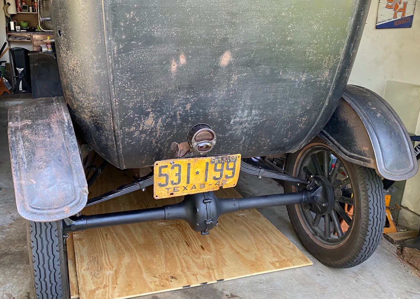

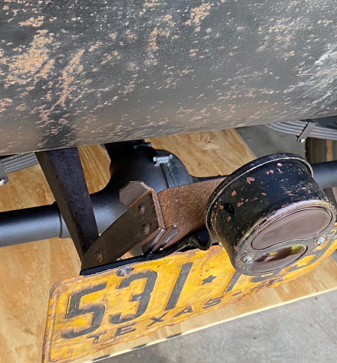

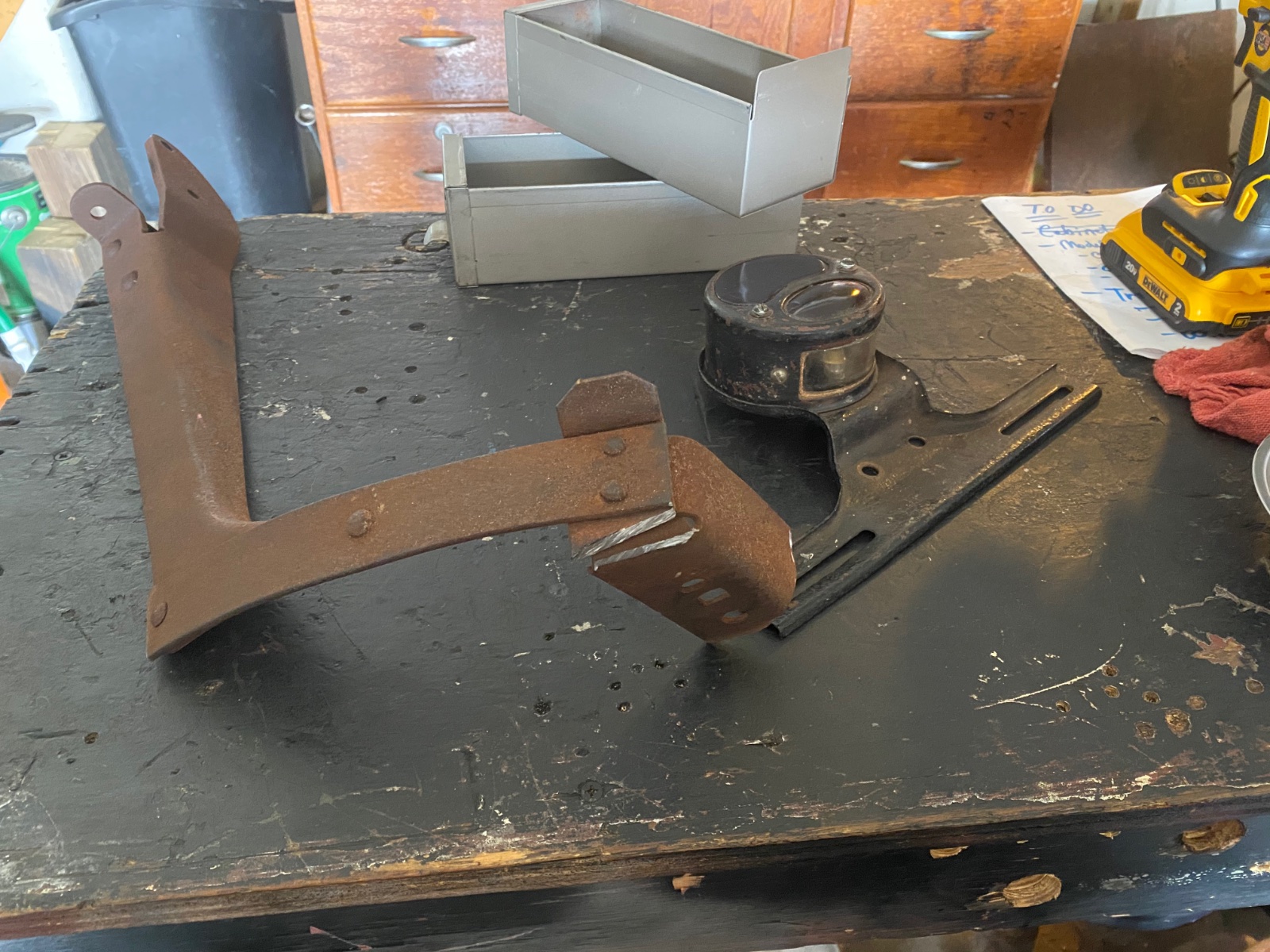

Here’s my version of a tail light bracket that’s in keeping with what a pre-1945 farmer on a very tight budget might’ve cobbled together from his Model T parts pile out behind the barn.
I have two of the spare carriers that mount on the rear crossmember, both of which are beat up and heavily repaired. So I cut one of the arms off of one of them along with enough of the horizontal piece to mount the tail light to.
It mounts to the crossmember, just like the original carrier.
It’s just mocked up in the photos. It’ll come back off and get cleaned up and wired in.
I found a 1942 Texas plate with a wartime 1943 registration tag at Chickasha.
I’m not totally sure I like how far it sticks out. I may revisit it at a later date and modify it...jury’s still out on that.

Brake/Tail light is all hooked up.
I gave the homemade/repurposed bracket my highly secret patina treatment so it matches the rest of the car.
I’m just waiting for my stop light switch from Fun Projects, then I’ll have a brake light. This will be one of the few concessions to modernity that I’ll be making (like safety glass, etc).

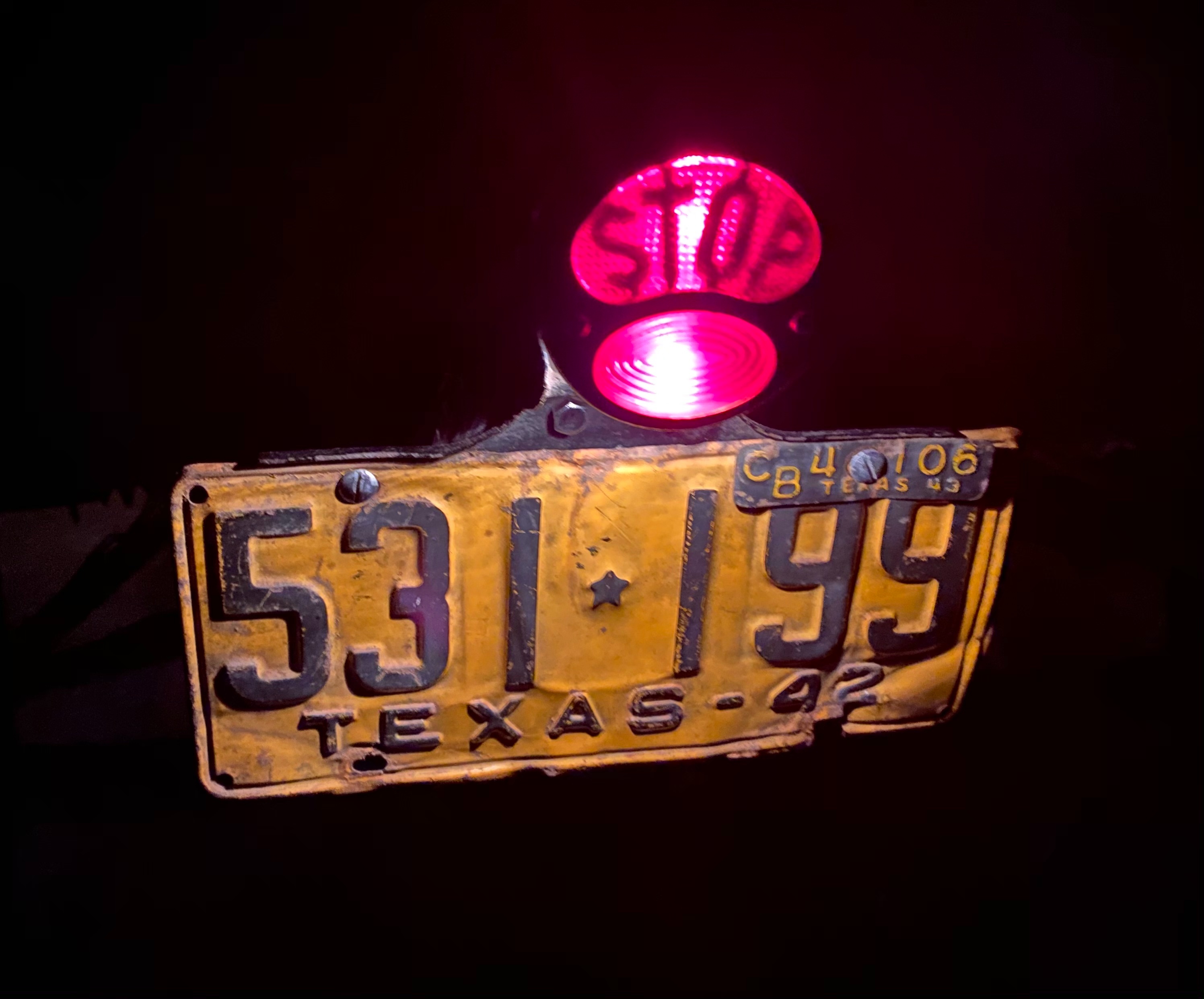

Post by RustyFords » Wed Sep 30, 2020 11:18 pm
Success with the new stoplight switch, etc.

Post by RustyFords » Thu Oct 08, 2020 7:03 pm
Nearing completion. Just need the top and a little more interior work.

Post by RustyFords » Mon Dec 07, 2020 1:07 pm
Now that I have headlights, a tail light and a stop light, I figured it was time for a night drive.
Here's a video:
https://youtu.be/5OurQZMlkHQ

I was looking at the photo you posted of the rear spring. I suggest you turn around the oiler from it's current position, or you won't be able to open it when installed. I use the factory service book for clues on that kind of stuff, to be able to get things right.
RustyFords
Posts: 1559
First Name: Don
Last Name: Allen
Location: Houston, TX
Post by RustyFords » Tue Dec 08, 2020 12:42 pm
Original Smith wrote:
Tue Dec 08, 2020 11:14 am
Thanks Larry. I found that out through trial and error! It's turned around now.

Before and after....front door wood framing.

Post by RustyFords » Mon Oct 04, 2021 2:23 pm
Sitting snug in my shop.

Post by RustyFords » Mon Oct 11, 2021 1:24 pm
This happens a lot with my T.
Random Person, “Can I take a picture of your car?”
Me, “Of course you can. But wouldn’t you rather sit in it and have me take your picture with your phone?”
Random Person, “Are you kidding!?”
Me, “Nope…hop up in there”
