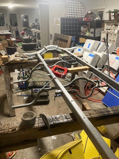

Post by ivaldes1 » Wed Sep 09, 2020 11:40 pm
My whole frame viewtopic.php?f=2&t=13134 was nearly all very old corroded bolts. Now after sandblasting and priming I am beginning to rivet which I have never done before. Unfortunately the 1/4 Lang's bucking bar https://www.modeltford.com/item/B-BAR-2.aspx is back ordered. I have the 1/4 rivet jack. See picture I put the correct per Lang's rivet through a hole and it seems like it sticks out very far (yes that is my magnificent weld job of the hairline cracked corner bracket). My understanding is the rivet is supposed to both expand in the hole and mushroom the head so probably that's why it seems long? I would like to cold set these but it seems like sources are saying heat them up. I have an oxy-acetylene torch. Do you heat them up before you put them in the hole or put them in heat and buck? Or just cold do them?
I found this general piece in the archives: http://www.mtfca.com/discus/messages/80 ... 1235094026
I am tempted to buy these air rivet hammers for my cheapo Harbor Freight air hammer tool: https://tinyurl.com/yyryogsf especially since the 1/4 hand bucking bar isn't available.

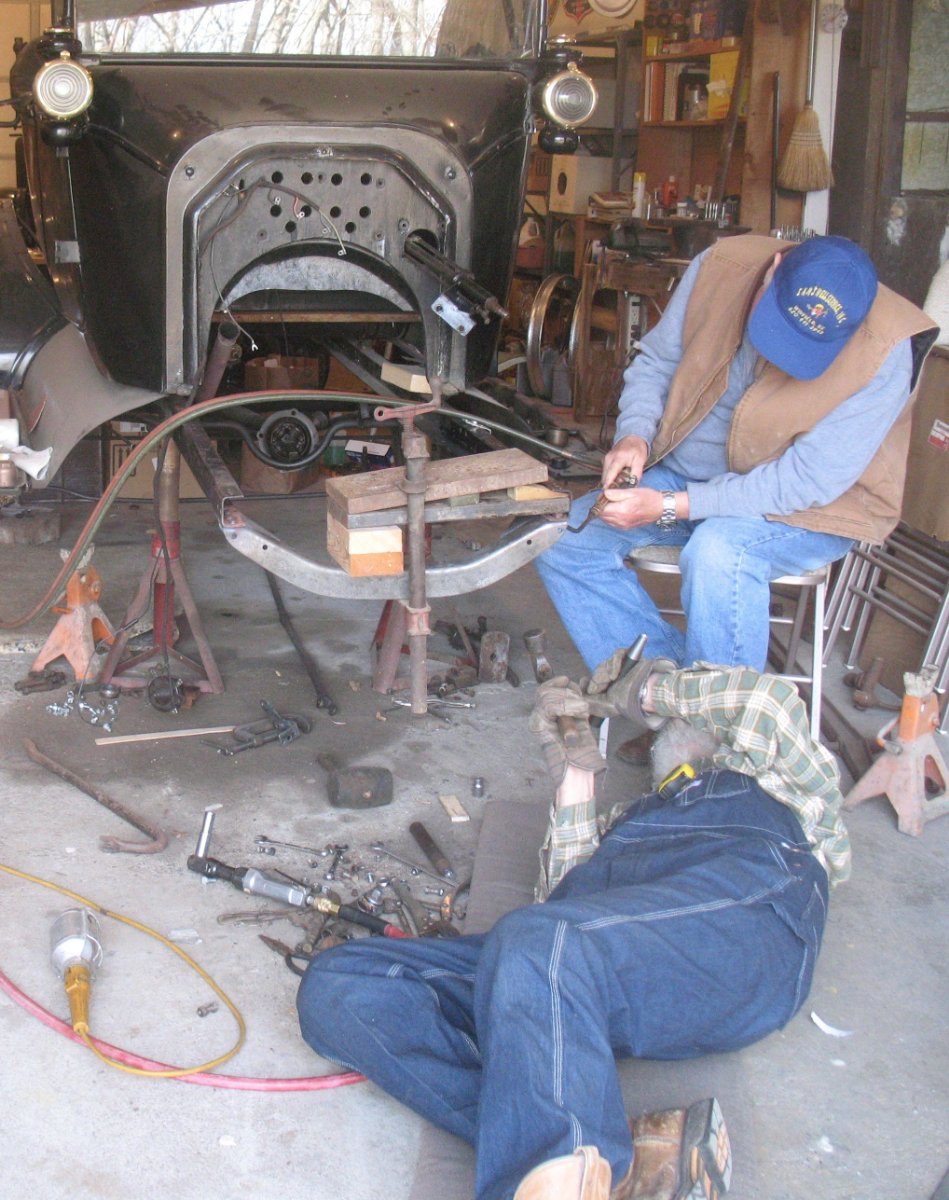

Post by Steve Jelf » Thu Sep 10, 2020 12:40 am
I got my bar from Jim Dix.
Big Flats Rivet Company
(607) 562-3501
http://bigflatsrivet.com/
Leave the pieces bolted together to keep them aligned and replace the bolts with rivets one at a time. Put the rivet in the hole, back it up, turn it yellow-orange, and mash it with the bar and a BFH. I put the rivet in with the business end out where it's easiest to reach. I recruited another pair of hands for this job. My neighbor held the torch to keep the rivet soft and I did the mashing. If I do this again I want a third person to hold the backup weight against the rivet. I did that with clamps, but it was a pretty clumsy setup.
Not the ideal backup.
If you're replacing the front cross member you can rivet the brackets to it out of the car, then install them in the frame together.

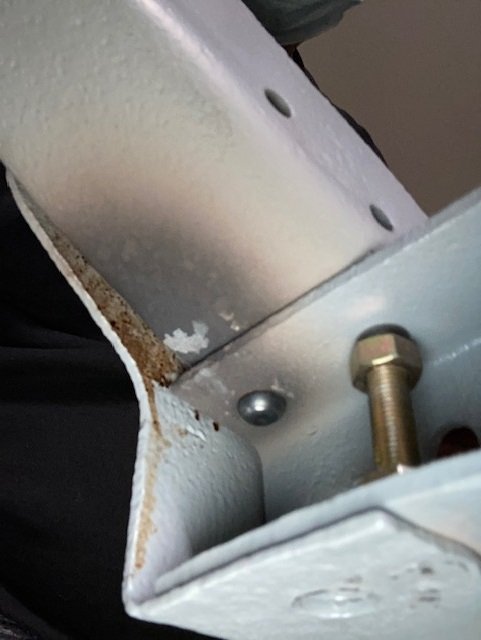

We started riveting today. It does take 3 people. Three rivets done then we ran out of acetylene. :-(
ivaldes1
Posts: 960
First Name: Ignacio
Last Name: Valdes
Location: Houston, Tx
Re: Beginner frame riveting.
Post by ivaldes1 » Sun Sep 20, 2020 12:09 am
It is a lot of hammering even when the head is red hot to get one of these done.

Post by ivaldes1 » Tue Dec 01, 2020 2:12 pm
I did not cut any of the rivets because they are supposed to expand into the hole when heated and driven. They form a nice dome when done correctly even if it sticks up a lot at first. I purchased bolts and nuts in various sizes for the spots that my jack is too big for.

Post by ivaldes1 » Thu Dec 10, 2020 1:48 am
It has been suggested to me to heat the shaft instead of the head to make the rivet expand to fill the hole but I've noticed that this makes the rivet head skew to the side because I am not perfect at making the tool go straight on. Also my $15 (not a typo) Harbor Freight medium air hammer isn't working right. It is only vibrating about every 4th pull of the trigger and often not at all. I see from reviews that this occurs often enough to other people. I am going to get another hopefully better one.

Post by dmdeaton » Thu Dec 10, 2020 6:41 pm
I had the same problem today with the rivet bending over. I called the rivet man and he told me to not use the domed air chisel until last. Heat red hot then wail with a good hammer like driving a nail. This will squeeze the rivet out and tighten it up. Heat up again. Then use the dome only to dress the head. It worked good for me earlier. I am going to finish mine Saturday

Post by ivaldes1 » Fri Dec 11, 2020 5:28 pm
I picked up this one from Northern Tool for $49.95. It looks superior in every way. It has a quick change chuck, comes with 3 end tools and actually works every time.

Post by ivaldes1 » Sat Dec 12, 2020 12:23 am
So I was almost out of oxy-acetylene so I setup four to do all at once. A problem has been that they have a tendency to lay over somewhat off center. Is that okay?
