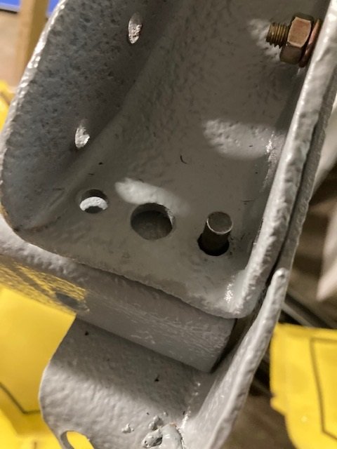

My whole frame viewtopic.php?f=2&t=13134 was nearly all very old corroded bolts. Now after sandblasting and priming I am beginning to rivet which I have never done before. Unfortunately the 1/4 Lang's bucking bar https://www.modeltford.com/item/B-BAR-2.aspx is back ordered. I have the 1/4 rivet jack. See picture I put the correct per Lang's rivet through a hole and it seems like it sticks out very far (yes that is my magnificent weld job of the hairline cracked corner bracket). My understanding is the rivet is supposed to both expand in the hole and mushroom the head so probably that's why it seems long? I would like to cold set these but it seems like sources are saying heat them up. I have an oxy-acetylene torch. Do you heat them up before you put them in the hole or put them in heat and buck? Or just cold do them?
I found this general piece in the archives: http://www.mtfca.com/discus/messages/80 ... 1235094026
I am tempted to buy these air rivet hammers for my cheapo Harbor Freight air hammer tool: https://tinyurl.com/yyryogsf especially since the 1/4 hand bucking bar isn't available.

We started riveting today. It does take 3 people. Three rivets done then we ran out of acetylene.

Okay I think I have this. The key was per suggestion you put the air hammer on the rivet so it won't eject the bucking bar. I also focused the torch on the shaft that is showing not the head to get it good and hot. The running board hangers are half on now with the top rivets in. Looks pretty good I think in picture 2. It is much faster with an air hammer bucking bar.

Re: Beginner frame riveting.
I picked up this one from Northern Tool for $49.95. It looks superior in every way. It has a quick change chuck, comes with 3 end tools and actually works every time.
So I was almost out of oxy-acetylene so I setup four to do all at once. A problem has been that they have a tendency to lay over somewhat off center. Is that okay?
