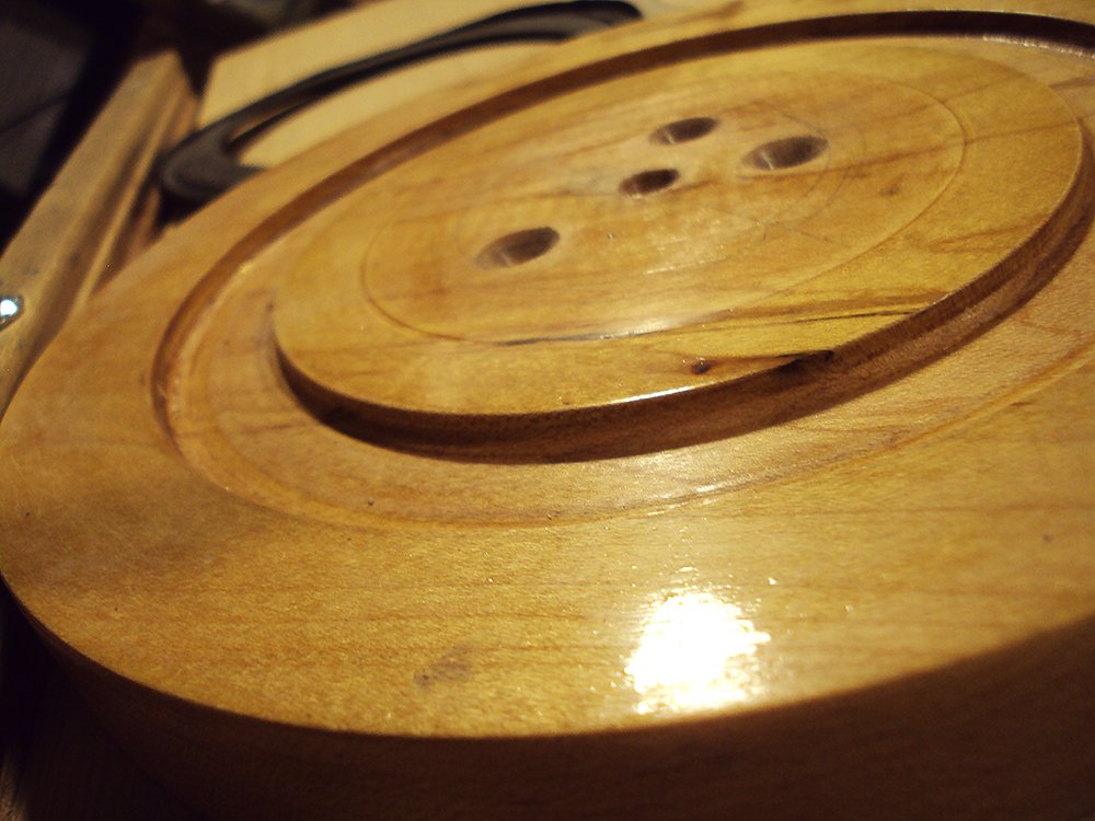

I made a mount to turn gas tanks too. Lacquer thinner and pebbles clean well. I worried some about a spark inside but it didn't happen. I used the same pulley setup to turn a gallon paint can with sand gravel and rusty bolts etc. Eventually the can sprung leaks so something more substantial would work better. I have spun parts on my craftsman lathe to clean up parts and also bought this brake drum machine. It works great on drums and hubs. Holding the sandpaper against something spinning saves much time. Higher RPMs make for dirty spray slinging. Do be careful not to get caught in the work.

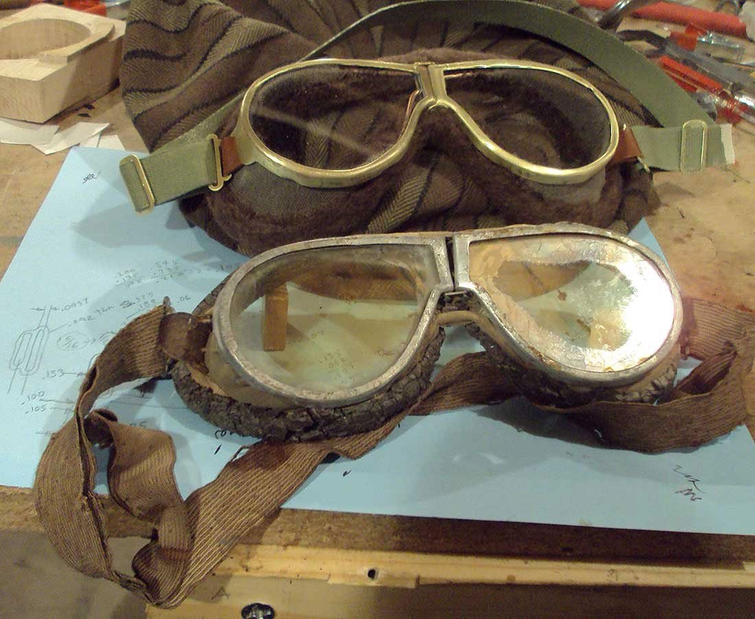

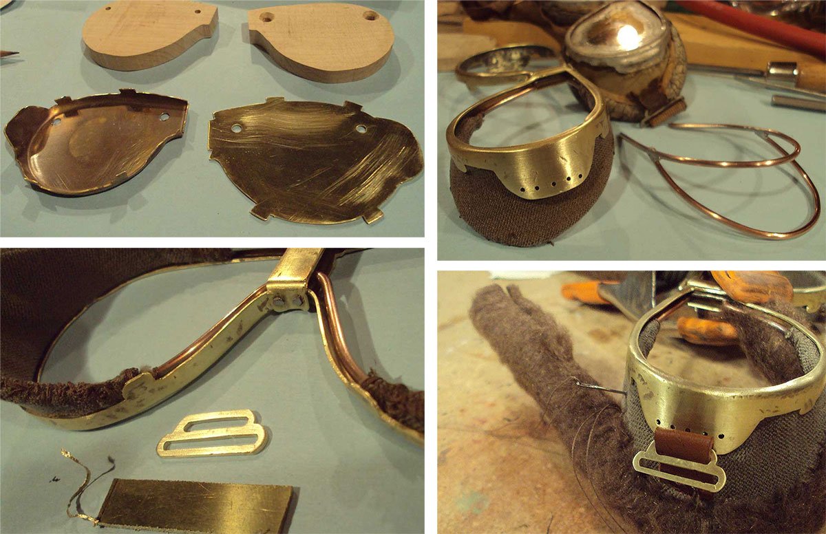

After wearing out my Fathers aviation goggles I set out to make a new pair. The rubber stuff around the outside turned to goo and then hard and crumbly.
Some brass scraps formed the lens frames built on maple forms. Then some headliner scraps were stitched to wire frames. Strap loops were made from brass also. Fake Fur was sewn around some windlace rubber. The lenses are plexiglass.
I usually wear them to hold my hat on rather than looking through them. It was a fun project in 2015.Rich

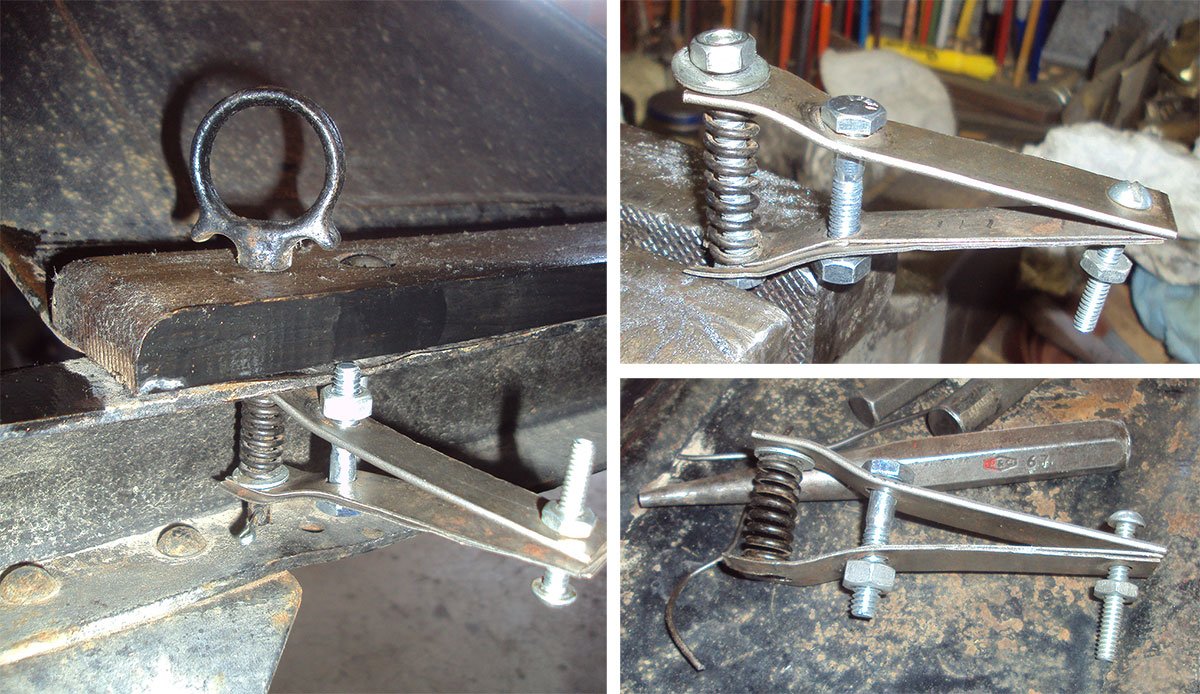

I used this tool yesterday and enjoyed how easy it makes installing the hood clamp springs. I made it from 3 folded layers of 16 gauge sheet. One layer of equivalent thickness or thicker might work well too. The 4 clamps were installed without a problem. Previous use resulted in some bending of the tool ends and springs popping out of the tool. The 2 working screws are 1/4". The #10 at the rear simply keeps things aligned. The photo doesn't fully show that the spring ends of the tools arms are slotted so the tool can be pulled free after cotter pins are installed.
In this case the radiator was removed which made visibility better.When did I do that?

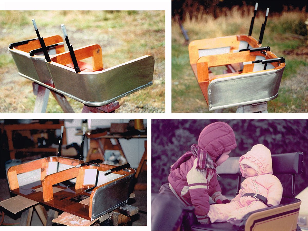

In the early 80's our Speedster was our Tour car. Our new son enjoyed tours on Joy's lap or cozy in a front pack. When our daughter arrived it was apparent we needed more seating. I fabricated a gas tank for the rear and made seats with folding back rests. I had seen a Pierce Arrow with that arrangement.
The seats with belts served us well for many tours. Since the kids are grown and we have other tour cars we have changed it back to the round tank. With the tank that low and that far back it was necessary to have it full on steep hills.Rich

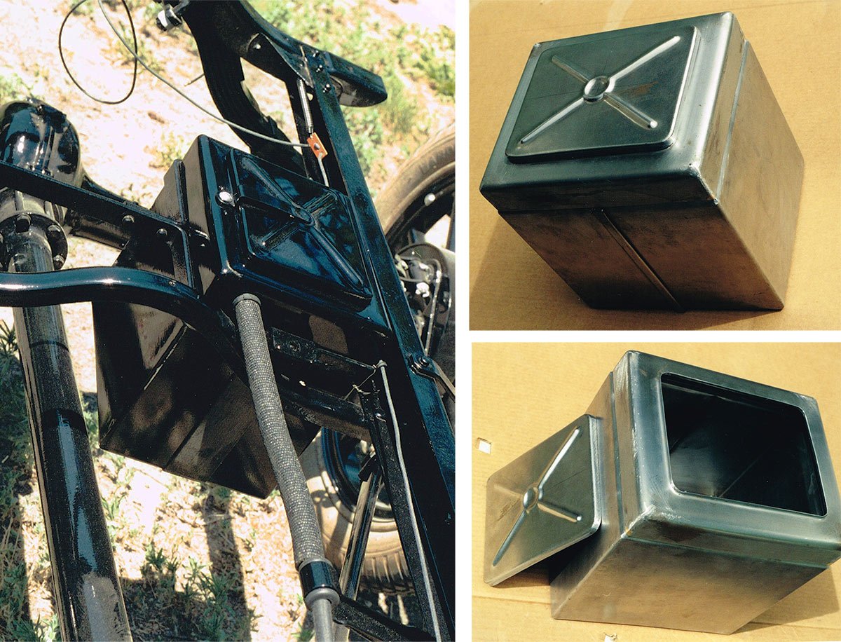

I mentioned the battery box I made in the "What did you do...." section. I found photos of it when I made it. Perhaps it will help others with ideas.
I haven't made them for the other cars as they are out of sight. The Tudor I was trying to make as correct as possible at the time.
The wooden form is maple. I only cut one slot in the steel guide plate and turned or flipped it to each of the 4 positions. Clamping the sheet between the guide and the maple forum I pressed the steel rod into the sheet.
Without good pictures of an original I just estimated what I saw in parts book photos. This was done before I joined the Forum.I haven't made them for the other cars as they are out of sight. The Tudor I was trying to make as correct as possible at the time.

Rich,
When you pressed the beads into the lid, had you already put the perimeter flange on the lid or did you do the perimeter afterward ? I have pressed beads into panels (perimeter done first) and then had trouble with the center of the panel being too "tight".
Dick
Dick
Topic author - Posts: 6895
Re: Revisiting some fabrication
I believe I did form the flange first and the lid does fit the cover a bit tight. That's a good point. I hadn't thought about it.

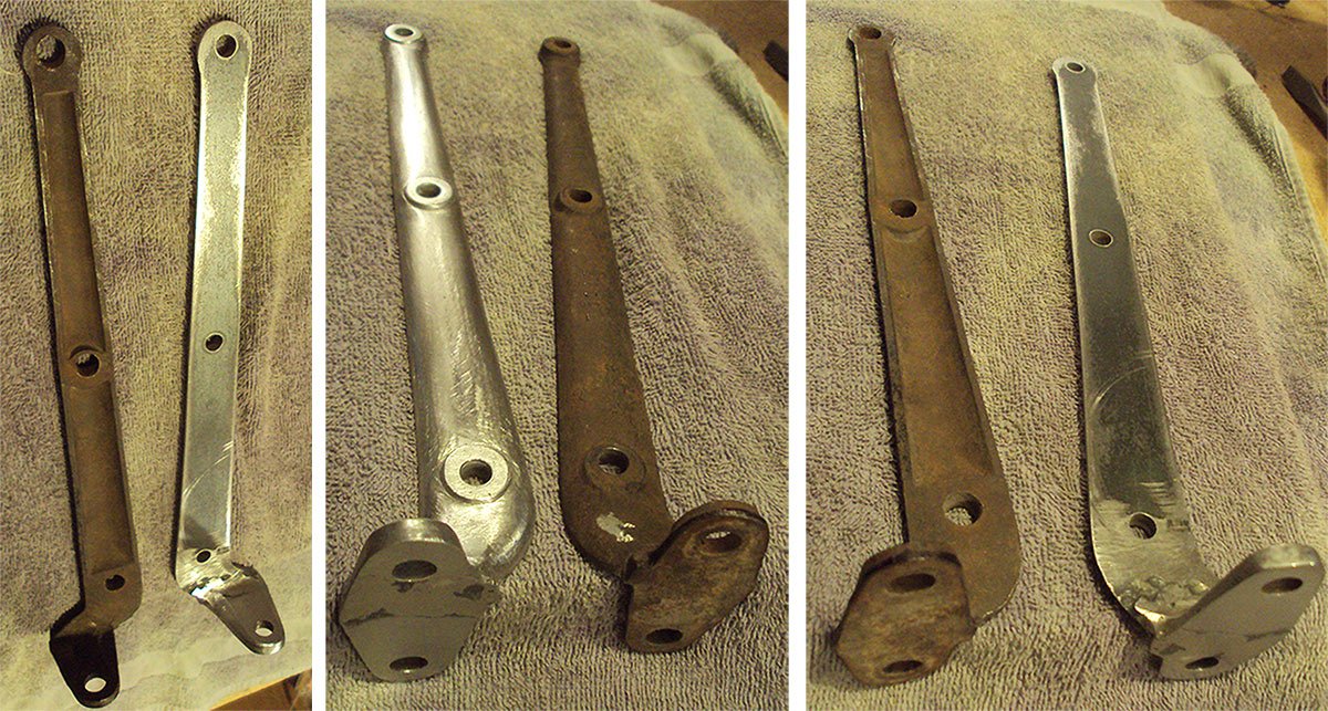

I found these photos of my hinge fabrication for my Yellowstone Bus. 6 doors = 12 hinges = 24 hinge halves. Thinking it was crucial to have precision in the slots and knuckles I made a sliding jig for my die grinder. It proved to be temperamental but it got the job done. The steel was malleable enough to just heat and bend. No annealing was done. They have worked well since 1989.
When I built similar hinges for my '22 Coupe I found it easier to just file them. Two doors required half as many pieces.Rich

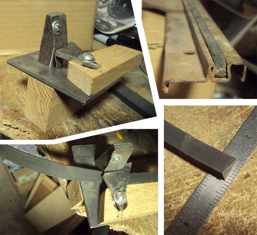

I posted this elsewhere but thought it might belong here too. The question was about a seal for '24-25 upper windshield sides. It could apply to similar seals that can't be found.
I made a jig to cut the strip to a triangular shape by pulling it past an exacto blade screwed to a chunk of steel. I made the strips 3/16" x just less than 1/2" which was the thickness of the strip I was cutting it from. It is a little tough to get started. It has to be pulled through in one long consistent draw. Any hesitation or stopping with leave an irregular mark which can be seen as a flaw in the lower photos. While perhaps not what the original was it works well.Rich

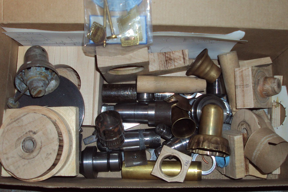

Thanks Mark. I enjoy looking back on these. Looking for the exacto jig I found these dies. I made them to form the escutcheon Plates for my '25 Tudor window regulator handles. These are steel practice ones. I made the ones I used out of brass because it plates so much nicer (Nickle).

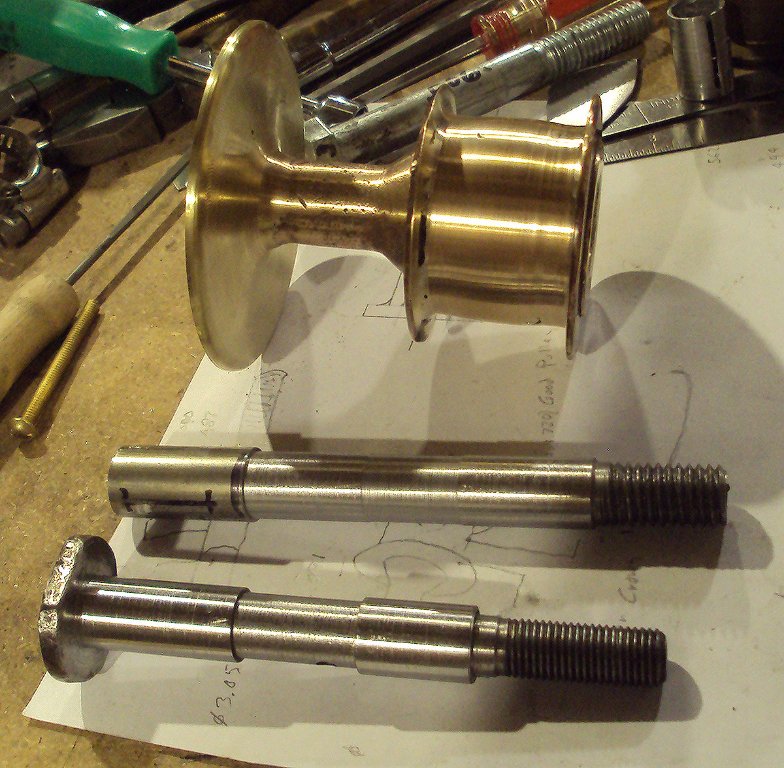

With the recent Speedster posts I though it might be good to post my version of the "Wheeler" muffler.
The ad gives the basic dimensions. I cut grooves inside the end plates for a 6" and a 4 1/2" shell. The design is like the original Ford muffler except for the open end with a butterfly.
This made a stock engine sound very powerful.Rich

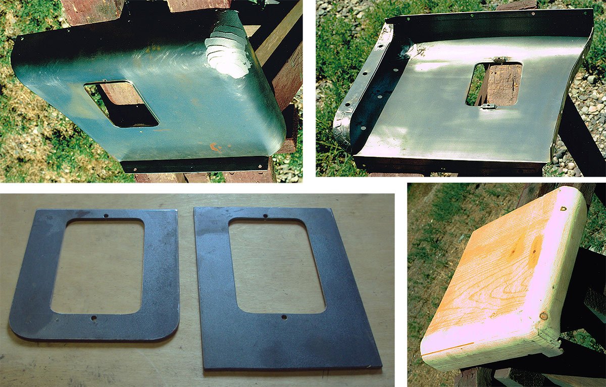

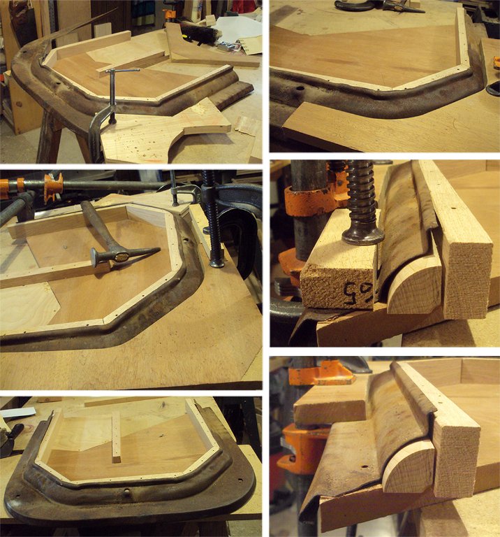

So many times one thing leads to another. Steve Jelf mentioned his hood former problems. I dug some out of the rafters and tried to sell some bad ones. This one was so bad I pondered straightening it. Could it be done?
After designing some steel forms I rethought it with Maple half-rounds on a flat base. The thought of sawing 2" dia. steel down the center gave me some pause.
The first step was to press the metal flat again onto some plywood with flat forms. This took a couple of hours and plenty of clamps. It flattened out fairly nice.
The next step was to screw some pieces in place to hold the half-rounds. Then re-clamping the piece as before pressing it into proper shape.
Over 4 days I spent about 14 hours doing the woodwork and 5 hours pressing the former back into shape. It might take 2 or 3 dozen more to really clean it up. If I come up with any interesting tooling I'll post it too.
Like so many tasks, it's hard to justify the time compared with the parts value. To ship one of these, straighten it and send it back would cost several hundred dollars at todays prices. But again, the fun of trying to save this is very satisfying. Whether it comes out nice or not I can build the right car for it.
Another couple of hours and pushing here and there returned it to it's basic shape.
I believe the 20-80 rule applies here. 80% of the job is accomplished in 20% of the time. It will require quite a lot of metal finishing to make this look respectable. However, buy careful clamping and supporting the metal while pressing minimized stretching and stressing the metal.Over 4 days I spent about 14 hours doing the woodwork and 5 hours pressing the former back into shape. It might take 2 or 3 dozen more to really clean it up. If I come up with any interesting tooling I'll post it too.

I believe this is the last tooling of any interest. The rest will be clamping between bars and boards.
Thanks for looking.
Some of the kinks in the quarter-round shape are too much for the maple forms. I happened to have a 2" bar I could use to backup a curved shoe I can clamp the sheet-metal between. 3 C-clamps give enough pressure to straighten that portion fairly well.
I put a radius on the end of the shaft to fit the 1/4 round as it turns. I pressed some flat 1/8" thick plate to the right radius using the shaft and the 4 curved pieces shown lower right in the last group of pictures. They rested in a piece of angle iron for pressing the shoe. Then they were glued to the wood pieces for final use. That is a new plywood form for holding the shaft at the right elevation and position relative to the former. I put a plywood guide in the center to hold the shaft but it turned out that it interfered with the clamp ends.I believe this is the last tooling of any interest. The rest will be clamping between bars and boards.
Thanks for looking.

Thanks Dallas. The tooling has brought this to an acceptable stage for a rusty car. It is basically straight. Many of the minor imperfections don't show because of the rust. I spent a couple days sanding one area down to show the high and low spots. I think I'll save further work for a nice sunny day outside.
Here is a review of this corner in it's ordeal to becoming straighter.
Happy metal bending. It can be done.Rich

As bad as this hood former was the hood pin hole was wallered out but the metal was all there. I needed it flat to allow other portions to fit against back up plates. By using a square end punch I could flatten it back in place. I still will add a thickness there for future durability.

I have a little trouble pushing the transmission band rivets through the lining. I made this tool from drill rod. It will be easier to hold in place while I punch the tang slots.
It was made from leftover drill rod from making the rear axle bearing rollers for my 1907 Buick. I couldn't find any that size. The plain rollers have been fine for many years and will last for as long as I am driving the Buick. I used a cobalt drill bit to drill the ends for the cage ends.
- Posts: 341
- Last Name: Bailey
- Location: Colorado
Rich Eagle wrote: ↑Thu May 07, 2020 12:39 pmI used this tool yesterday and enjoyed how easy it makes installing the hood clamp springs. I made it from 3 folded layers of 16 gauge sheet. One layer of equivalent thickness or thicker might work well too. The 4 clamps were installed without a problem. Previous use resulted in some bending of the tool ends and springs popping out of the tool. The 2 working screws are 1/4". The #10 at the rear simply keeps things aligned. The photo doesn't fully show that the spring ends of the tools arms are slotted so the tool can be pulled free after cotter pins are installed.
Wow Rich. I want one of those or at least to borrow one..
Still crankin old iron
It takes as long to build one as it does to install 4 hooks without one.

I stumbled across some of the E&J lamp parts and tooling today. I was enjoying the inside reflector panel I made from .020" thick brass shim stock and had nickel plated. I also made the open door and lens ring for the taillight in the picture.
Nickel plating is so much more expensive now days and our plater is retiring to do other things. How glad I am I did these when I did. The first offering in this thread shows how the burners were made.
viewtopic.php?f=2&t=371&hilit=revisiting#p2318
It was fun to look in the box of those items. The wrinkled burner base show some of the difficulty in spinning them. It is satisfying to look back at some of the things we do and remember.
Take a few picture of your projects to remember them and post them on the forum for the rest of us to enjoy.

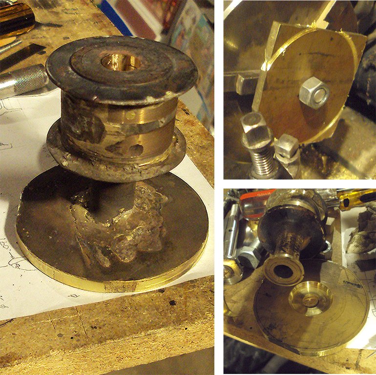

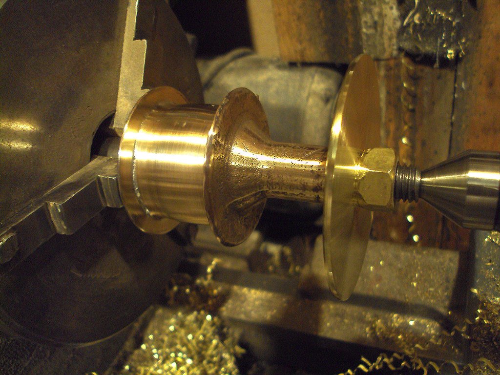

This brass fan pulley had lost its front flange and worn paper thin where the crown should be. I thought about wrapping some brass sheet around it and then found that a used slow speed trans drum bushing was nearly perfect to fit there.
By cutting the bushing in half and notching the ends, I could silver solder it in place of the missing bronze. It will wear better than yellow brass would. I added a few holes to melt solder into and tapped it for some #6 screws to help anchor it. Clamping it tight and wiring it kept it tight for soldering.
I built a little cave out of fire brick to keep it an even temperature while the solder melted.
Then I cut a brass flange for the front from brass. Bronze would have been better, but I didn't have any handy.
I reamed out the worn bore and machined it to shape adding some crown to it. I will build up the old shaft and fit it to the pulley.When did I do that?

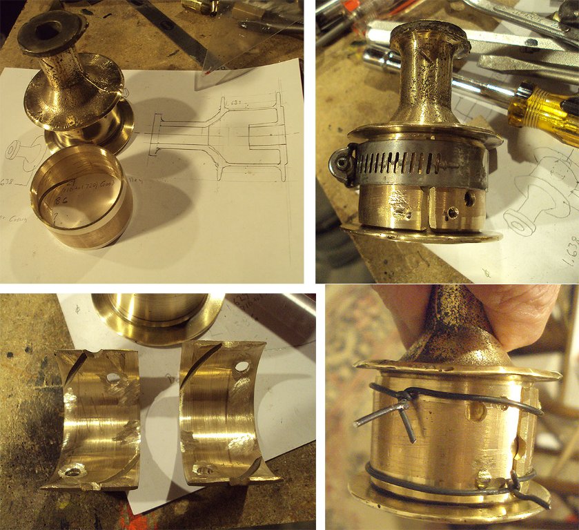

Thanks guys. I was pleased to use the low bushing to build up the fan pulley. In looking for something to make sleeves for the fan shaft, the only thing in the shop close to the right size was an old, rusty T wrist pin. It makes me chuckle to reuse Ford parts to repair things. They are good material. The pins are hardened so I heated it red hot and let it cool so I could machine it. It machined well except for some portions a few thousandths deep. I should have left it hot longer.
I made this sketch of what I believe the inside of the pulley looks like. You can see how thin it wears from the belt. It appears that the pulley should be filled with grease so that when the grease cup is turned the grease will be forced both ways. It seems like a waste of grease. Another way to save these pulleys would be to just make a new sleeve to go between the flanges. It would be tricky to keep everything aligned. I also considered just machining the fan shaft, so it was round again and making bronze sleeves to fit into the pulley bores. I don't understand why this pulley lost its front flange that the lade rivet to. But I have 2 of them that way.
Then I pressed the two machined sleeves onto the old fan shaft. I also tapped the assembly for #6 screws to insure it would not turn. The other shaft between the pulley and the fan shaft is a mandrel I made to fit the rebored pulley before final shaping. This made the work concentric with the shaft when running.
I have new fan blades and rivets on the way.I made this sketch of what I believe the inside of the pulley looks like. You can see how thin it wears from the belt. It appears that the pulley should be filled with grease so that when the grease cup is turned the grease will be forced both ways. It seems like a waste of grease. Another way to save these pulleys would be to just make a new sleeve to go between the flanges. It would be tricky to keep everything aligned. I also considered just machining the fan shaft, so it was round again and making bronze sleeves to fit into the pulley bores. I don't understand why this pulley lost its front flange that the lade rivet to. But I have 2 of them that way.
