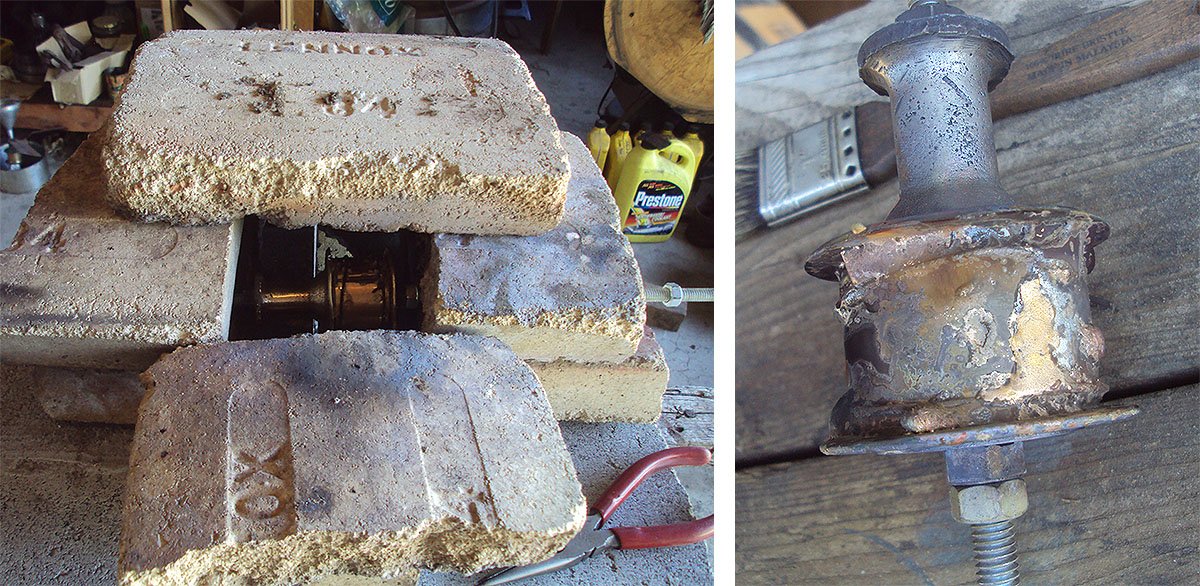

I made a mount to turn gas tanks too. Lacquer thinner and pebbles clean well. I worried some about a spark inside but it didn't happen. I used the same pulley setup to turn a gallon paint can with sand gravel and rusty bolts etc. Eventually the can sprung leaks so something more substantial would work better. I have spun parts on my craftsman lathe to clean up parts and also bought this brake drum machine. It works great on drums and hubs. Holding the sandpaper against something spinning saves much time. Higher RPMs make for dirty spray slinging. Do be careful not to get caught in the work.

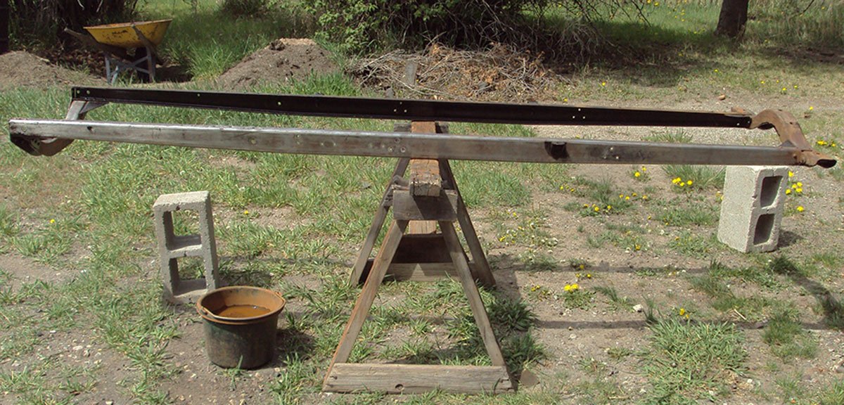

I ran across these photos today. I had some steel and built the hood for my '09? touring. Their was no reason not to buy an aluminum one but I enjoy making things. It was good practice and I always learn from doing. I have 3 other cars I keep as correct as possible and 3 that are for fun and to enjoy as they are.

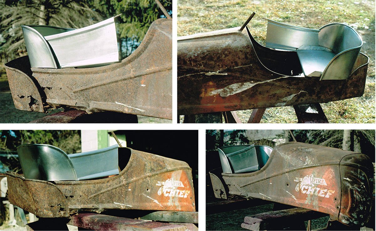

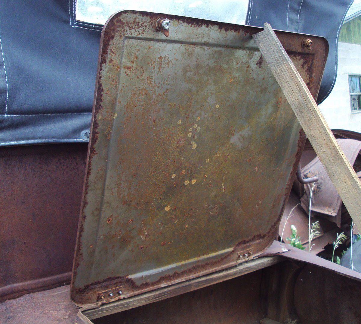

This turtle deck lid I made for a deck that was torn and flattened. It was for my first "Rusty" build and didn't have to be perfect. I bent the edge around a piece of particleboard. It took the outside some time to match the rest of the car but the inside has only rusted as shown in 20 some years and sitting outdoors. (Idaho) The handle was a flattened bolt shank and still has some zinc on it. What reminded me of this was remembering a ruined, rusty splash apron I sacrificed to make the missing piece in the deck. It is shown at top of the first photo with a new bead rolled into it. Then it was simply screwed into place.

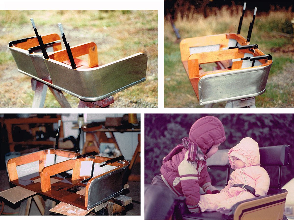

In the early 80's our Speedster was our Tour car. Our new son enjoyed tours on Joy's lap or cozy in a front pack. When our daughter arrived it was apparent we needed more seating. I fabricated a gas tank for the rear and made seats with folding back rests. I had seen a Pierce Arrow with that arrangement.
The seats with belts served us well for many tours. Since the kids are grown and we have other tour cars we have changed it back to the round tank. With the tank that low and that far back it was necessary to have it full on steep hills.

Post by Nathan Pederson » Mon Sep 21, 2020 2:11 pm
One of a kind car. A real beauty, and I bet it's fun to drive.
The seats you had added on were perfect for those cute kids.
Rich, it is always interesting to see the work you are doing!
Re: Revisiting some fabrication
Post by Rich Eagle » Mon Sep 21, 2020 6:50 pm
Thanks Nathan. I ran some errands in it today. You know what fun that is. Almost time to put it at the back of the shop in favor of warmer cars.

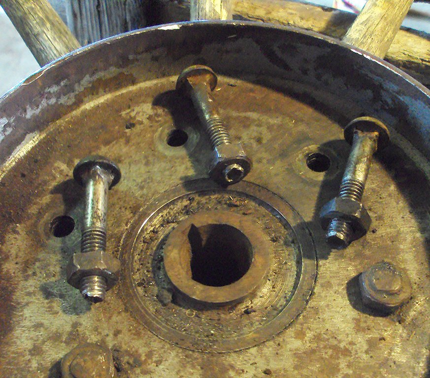

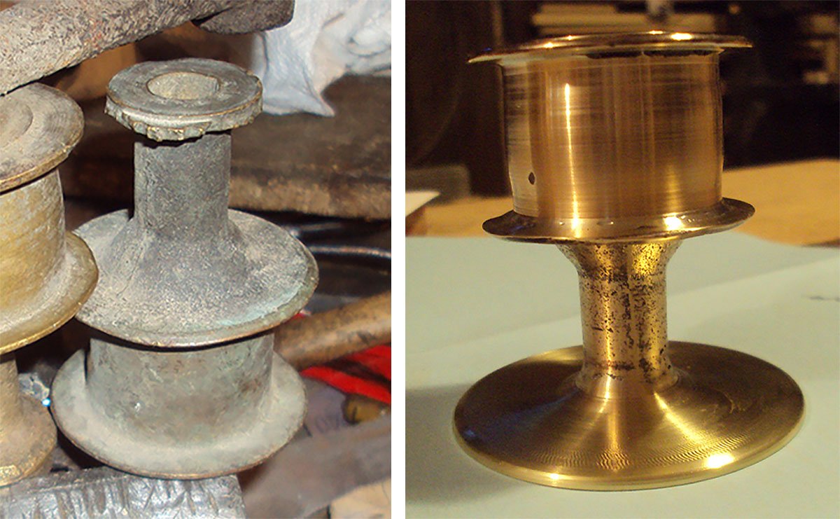

Post by Rich Eagle » Wed Feb 17, 2021 12:57 pm
With the recent Speedster posts I though it might be good to post my version of the "Wheeler" muffler.
The ad gives the basic dimensions. I cut grooves inside the end plates for a 6" and a 4 1/2" shell. The design is like the original Ford muffler except for the open end with a butterfly.
This made a stock engine sound very powerful.

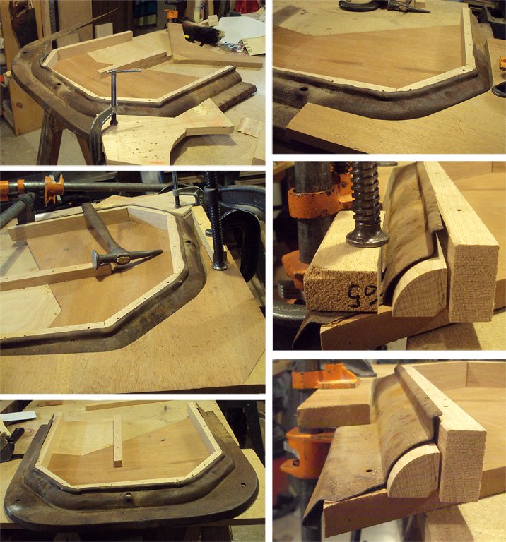

So many times one thing leads to another. Steve Jelf mentioned his hood former problems. I dug some out of the rafters and tried to sell some bad ones. This one was so bad I pondered straightening it. Could it be done?
After designing some steel forms I rethought it with Maple half-rounds on a flat base. The thought of sawing 2" dia. steel down the center gave me some pause.
The first step was to press the metal flat again onto some plywood with flat forms. This took a couple of hours and plenty of clamps. It flattened out fairly nice.

Post by Rich Eagle » Sun Jan 16, 2022 6:24 pm
The next step was to screw some pieces in place to hold the half-rounds. Then re-clamping the piece as before pressing it into proper shape.
Another couple of hours and pushing here and there returned it to it's basic shape.
I believe the 20-80 rule applies here. 80% of the job is accomplished in 20% of the time. It will require quite a lot of metal finishing to make this look respectable. However, buy careful clamping and supporting the metal while pressing minimized stretching and stressing the metal.
Over 4 days I spent about 14 hours doing the woodwork and 5 hours pressing the former back into shape. It might take 2 or 3 dozen more to really clean it up. If I come up with any interesting tooling I'll post it too.
Like so many tasks, it's hard to justify the time compared with the parts value. To ship one of these, straighten it and send it back would cost several hundred dollars at todays prices. But again, the fun of trying to save this is very satisfying. Whether it comes out nice or not I can build the right car for it.
Post by Rich Eagle » Wed Jan 19, 2022 6:45 pm
Here is bar bent to fit the inside radius of each corner of the inside lip. I made a narrower one to fit the outside. They allow knocking down some kinks while keeping the shape. Vise grips are good for holding the former to the bar and also work good for pushing some distortions back into place. The leverage they have is wonderful.
Some of the kinks in the quarter-round shape are too much for the maple forms. I happened to have a 2" bar I could use to backup a curved shoe I can clamp the sheet-metal between. 3 C-clamps give enough pressure to straighten that portion fairly well.
I put a radius on the end of the shaft to fit the 1/4 round as it turns. I pressed some flat 1/8" thick plate to the right radius using the shaft and the 4 curved pieces shown lower right in the last group of pictures. They rested in a piece of angle iron for pressing the shoe. Then they were glued to the wood pieces for final use. That is a new plywood form for holding the shaft at the right elevation and position relative to the former. I put a plywood guide in the center to hold the shaft but it turned out that it interfered with the clamp ends.
I believe this is the last tooling of any interest. The rest will be clamping between bars and boards.
Thanks for looking.

Thanks Rich. This shows that a little thinking and creativity can overcome most problems. Saved another piece from the scrap pile. You have a talent for that also. I remember the flat touring car.
Post by Rich Eagle » Sun Jan 23, 2022 6:01 pm
Thanks Dallas. The tooling has brought this to an acceptable stage for a rusty car. It is basically straight. Many of the minor imperfections don't show because of the rust. I spent a couple days sanding one area down to show the high and low spots. I think I'll save further work for a nice sunny day outside.
Here is a review of this corner in it's ordeal to becoming straighter.
Happy metal bending. It can be done.

As bad as this hood former was the hood pin hole was wallered out but the metal was all there. I needed it flat to allow other portions to fit against back up plates. By using a square end punch I could flatten it back in place. I still will add a thickness there for future durability.

Post by Rich Eagle » Tue Jul 05, 2022 2:54 pm
I stumbled across some of the E&J lamp parts and tooling today. I was enjoying the inside reflector panel I made from .020" thick brass shim stock and had nickel plated. I also made the open door and lens ring for the taillight in the picture.
Nickel plating is so much more expensive now days and our plater is retiring to do other things. How glad I am I did these when I did.
The first offering in this thread shows how the burners were made.
viewtopic.php?f=2&t=371&hilit=revisiting#p2318
It was fun to look in the box of those items. The wrinkled burner base show some of the difficulty in spinning them.
It is satisfying to look back at some of the things we do and remember.

Post by Rich Eagle » Sat Aug 27, 2022 6:38 pm
I was removing and saving some hub bolts today and thought I would show some pictures of how I'm doing it to save the bolts and nuts. Of course new ones are available but I like to save the old stuff if possible. A true purist might number, catalog and reuse them in the original holes but I'm just doing this for fun. :D
Since these are peened over I need to get the mushroomed metal back to a smaller diameter to keep from loosing the nut threads. Tightening the nut will expose more of the bolt thread. Starting with a chisel I lift the edge up. Then I can pinch it with vise grips. Heat could be used to anneal the end of the bolt. A little grinding can also help. Sadly you can't get down far enough to remove all of the compressed metal and the nut will suffer some thread damage. I turn the nut back and forth a lot as I remove the nut. Penetrating oil helps too.
I have split a die in two by grinding it on two sides partway through and then cracking it in two and leaving a broken edge that keeps it in alignment. Cleaning grease or wood remnants out of the threads I can then put the two die pieces around the bolt threads and assemble them into the die holder. Then turning the assembly up the bolt renews the threads over the peened potion of the bolt. I don't tighten the die holder set screw as that would put too much pressure on things. Shavings appear as the bolt has likely stretched some and can be bent too.
The original nut can be tapped to restore the threads. Enough metal has been removed from both that the fit between the two is looser than when new. The threads may be good enough to tighten them without stripping. After all they will be re-peened or riveted when the wheel is reassembled. A better alternative would be to buy new nuts. A Heavy hex nut is the right hex size and can be turned or ground to the right thickness. A new nut on the restored bolt would be tighter and less likely to strip out. Another approach would be to crack the old nut in two to remove it. That would result in less damage to the bolt threads.
These techniques might be useful elsewhere to save part which can't be replaced. The price of new hub bolts and nuts make this kind of work questionable but for the satisfaction in rescuing original parts.
I always recommend that in the interest of safety that any wheels to be used on any antique car should be rebuilt by a competent wheel expert. I have bought re-wooded wheels for most of the cars I tour with.
Have fun and be safe.
Post by Jerry VanOoteghem » Sun Aug 28, 2022 7:29 am
Rich,
I've seen very few hub bolts that haven't been stretched and necked down to the point of making them junk. Apparently, the ones you're working with are in better condition than that.
I like your split die technique.
Post by Rich Eagle » Tue Aug 30, 2022 6:36 pm
Thanks Jerry. The wheels I have been taking apart have exceedingly good wood. That may be why the metal parts are better than some. The last 3 bolts and nuts came apart easier than the first 3 and threaded better. It may be I'm getting better at it. :D
Wheels in worse shape might have been tightened more and therefor stretched more. I have seen many of them too.

This brass fan pulley had lost its front flange and worn paper thin where the crown should be. I thought about wrapping some brass sheet around it and then found that a used slow speed trans drum bushing was nearly perfect to fit there.
By cutting the bushing in half and notching the ends, I could silver solder it in place of the missing bronze. It will wear better than yellow brass would. I added a few holes to melt solder into and tapped it for some #6 screws to help anchor it. Clamping it tight and wiring it kept it tight for soldering.
I built a little cave out of fire brick to keep it an even temperature while the solder melted.
Then I cut a brass flange for the front from brass. Bronze would have been better, but I didn't have any handy.
I reamed out the worn bore and machined it to shape adding some crown to it. I will build up the old shaft and fit it to the pulley.
