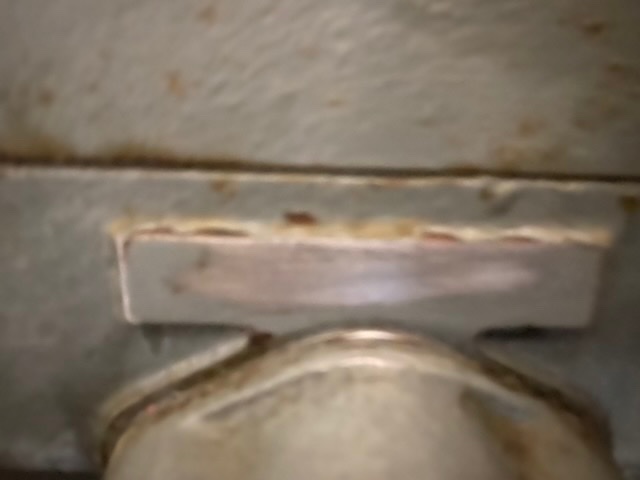

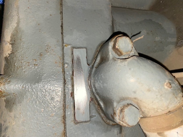

Eric. More pictures please of the engine (both sides), the interior and instruments, the underside, if possible, and the body and woodwork. What is the engine number (driver’s side of the engine above the water inlet). Jim Patrick

I see more hints at 1914 or earlier.
The engine serial number should be here. The other photo suggests it may be filled with paint. Maybe some coarse sandpaper will make it readable.

I knew there should be a number on that motor somewhere! I’ll try and bring it out a little tomorrow when I get home. I have one more picture to show. Not sure if this number is accurate? But it’s a nice piece of history to go with it. An old registration card!

Eric, Looking at your photos you have one showing the manifold side of the engine, near the timing cover there is a 3017D generator block off plate in view indicating the block is a later than 1919 production. Look on the block below the manifolds & see if there is a single long valve chamber door with the throttle rod coming thru a hole in the cover or 2 shorter ones with the throttle rod coming thru between the 2 covers? One cover would mean you have a block from mid 1922 or later, two doors would be a block from 1919 to mid '22 production. Service engine blocks were outfitted to be able to accept a generator or the 3017D was available to use with an original pre starter timing cover for early cars not having a generator. This may explain the blank serial number boss. George

I missed that detail of the post-1919 generator spot. Obviously a later engine, and one of those unnumbered replacement blocks.
