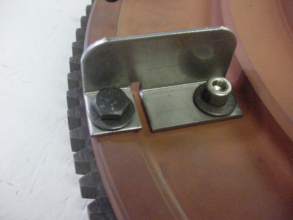

Here is what Dan is referring to. Also a different version of oil slingers that work quite well.
Been using these for years and I moved away from simply using spools and bolts to insure good oil circulation for both the engine and transmission. The ring might be a belt and suspenders approach for the triple gear pins, but its hardly worth the risk anymore in my opinion. From other postings regarding flywheel balancing, this is a pretty typical balance correction, and this is on a later fully machined style flywheel.

Nice! While I was reading this I was wondering who came up with only 4 paddles, thinking it would throw things off, then Dan shows the above. (I am not talking about a balancing the flywheel)

Post by Dan Hatch » Fri Jan 08, 2021 6:25 pm
That is what I am talking about.
