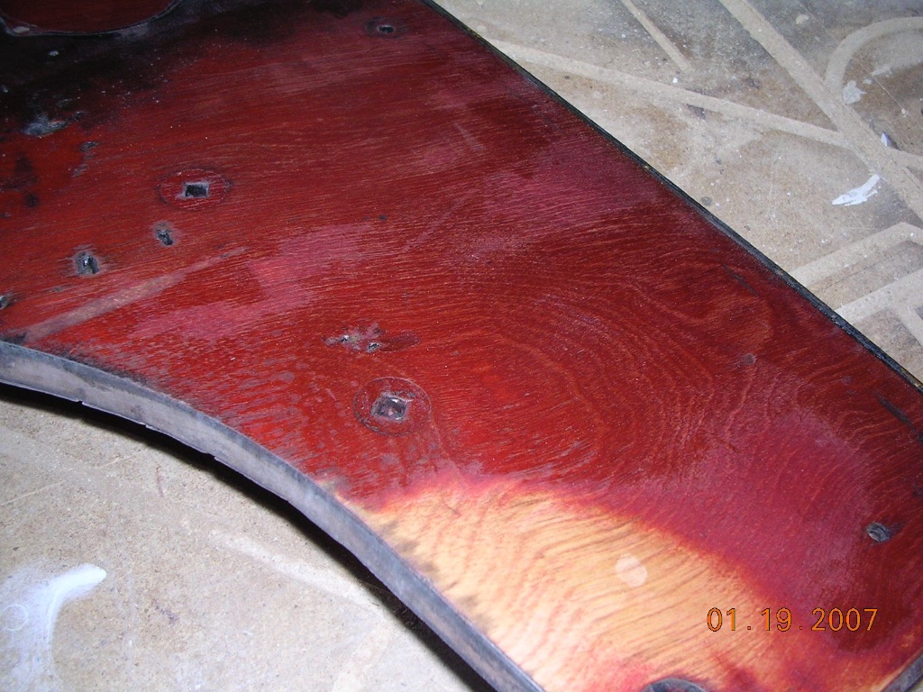

			I truly think that the cherry firewalls were hosed down with a heavily pigmented stain,  almost like a paint, then brushed and let dry before they were coated with shellac. It would have been an easy way to get consistent looking finishes on the. firewalls. I have this original 1913 firewall that I rubbed the finish off using denatured alcohol.

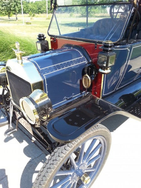

			I'll play salesman here for Laurel Mountain Forge's cherry stain...here's my '13 after I replaced her firewall and stained it with the L.M. stain.  Like Larry said, it's about as close to the real thing as it gets. And yep, the pin stripes are "One-Shot" medium grey which from tons of research are also about as close as it gets. It mostly looks white in a lot of light, in the barn the grey comes through.
 Larry

			Larry...ha ha, yeh our two firewalls look remarkably similar in color!

			Ray S.
When you did the denatured alcohol on the original finish...did it lift immediately to bare wood?  Or did you have to do it over and over and scrub thru a sticky mess?
If it simply lifted to bare wood almost immediately...then the original firewall you have was never stained, but rather a shellac wash with red pigment suspended in it. The actual first coat may have been a spit shellac also.  Not to take away from what others have done on their own restoration...but for a future purist, knowing that it was a surface finish and not a penetrating finish might help with a material decision?
