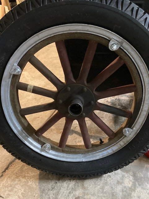

Post by ivaldes1 » Thu Jan 28, 2021 12:07 am
And the wheels are finally painted. Wow that was a lot of work. I will let them sit for a week to cure.

Post by ivaldes1 » Tue Mar 30, 2021 3:02 am
One wheel completed I think. See attached.

Post by ivaldes1 » Sun Apr 04, 2021 4:41 pm
Three wheels are on. Back to the drawing board on one front wheel because the 'Bimel' does not look like it fits. First fender test fit.

Post by ivaldes1 » Wed Apr 14, 2021 10:47 pm
The new unfinished 21 inch wheel is here to replace the Bimel wheel that just barely did not fit. This wheel fits but I am going to have to wait to clean, strip and paint it until I get more parts to do that need finishing. I will probably put it on for now to get the chassis completely rolling. The side and rear lamps arrived in the mail and I received more small parts and fittings from Lang's. I have one side brake rod installed and working, my other side brake rod may not fit and is missing a clevis so I will have to wait for that to arrive to complete the brake rods. I found out from John Tannehill that shoes are insufficient for 26-27, that I need to buy and rivet on brake linings. Doh! Another Lang's order.

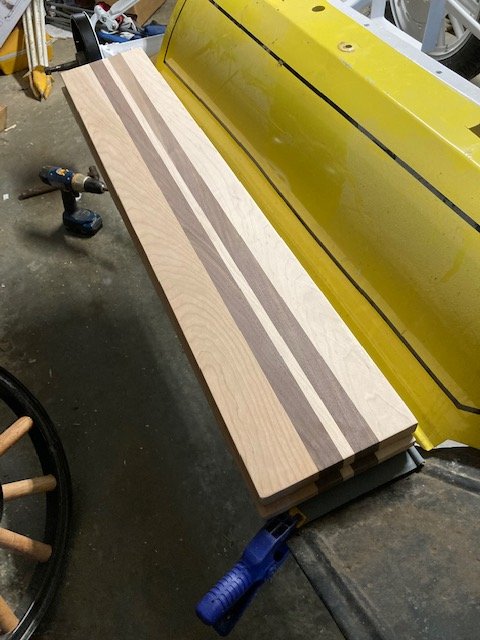

Post by ivaldes1 » Sun Aug 08, 2021 2:18 am
The seat looks like porcupine quills. Those are toothpicks dipped in wood glue and pushed into the old tack holes so that the new tacks will stay firm. They will be clipped off when dry then sanded down. I didn't want to wreck the 1912 body I have by modifying it as a Speedster body. It also has some delamination issues to repair and paint to strip so I am just building a new body which so far isn't too difficult.

Post by Jerry VanOoteghem » Sun Aug 08, 2021 8:43 am
ivaldes1 wrote:
Sun Jul 25, 2021 12:38 am
She rolls! Got past the Bimel wheel saga. Did the bearing grease ziploc bag of iniquity on the front two wheels so we now roll! Also worked on the seat. Stripped the Bondo, relminated the pieces that were coming apart. Pulled tacks and nails. Filled the holes with wood filler. I pondered the threaded sockets no doubt for a top but what plugs into the sockets and what kind of top? on the Mystery seat.
The sockets on your seat are indeed for top bows. Have a look at photos of Buicks from the 1910ish era. They used these sockets. Maybe your seat is from a Buick?

After cutting the odd non-original gadget off, the spare tire carrier went on which really makes the car. Lots and lots of holes drilled today to get the body, fenders and floor boards fitted and bolted on. These are must get right the first time holes too which made me anxious. The rear fender hangers took a lot of thinking and drilling to get on. One looks bent and is making the fender tilt. I destroyed 2 $14 Milwaukee and Dewalt cobalt bits fabricating the two steel body supports that hold the rear fender hangers on good. I could get about 6 holes bored in the steel before they quit. They over-heated in the drill press despite keeping oil on them and trying to go slow. Only 2 mistakes drilling I think/hope which I will be filling and painting over. Oops! Otherwise it is really coming along. The gas tank mounts do not fit. I will probably need to make my own mounts. I will be taking the whole thing to Ross Lilleker on Friday to get an engine put on.

Rear deck lid is on. I used a brass piano hinge pretty much perfect size as purchased. I will put in a floor later for storage. Spring loaded eye hook will hold the front down.

I built a bracket out of angle iron. I shortened a rim bolt for a good tight fit in the ear on the spare. Cut the bolt, put a washer on then welded all around the junction of the washer and the bolt. Then I cut a piece of angle iron and drilled it to match the holes on the license bracket. The prototype looked good enough so the paint is drying now. The bolt is lying on a cardboard box, the other carriage bolts in the background were poked through holes in the box to stand them up and not paint the threads. They have just been painted and are drying. The license holder is going to be at a bit of an angle towards the front of the car. I can put some washers on the back side of the tip side mount to make the license plate look straight.
