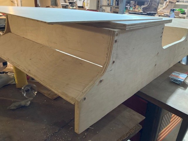

The fenders running board, firewall, steering wheel, steering column, hood former, headlight buckets and gas tank are back from the body shop.
A lot of the details of the body are ready, holes are filled, ready to prime.
Paint stripped. Reusing old-growth wood trim from a discarded door frame found in the neighbors trash pile.

Body is wood primered and sealed now. I turned it upside down to paint which was probably a good idea.

Re: Hay wagon to Speedster Project.
Body is back from the painter. Still test fitting...
