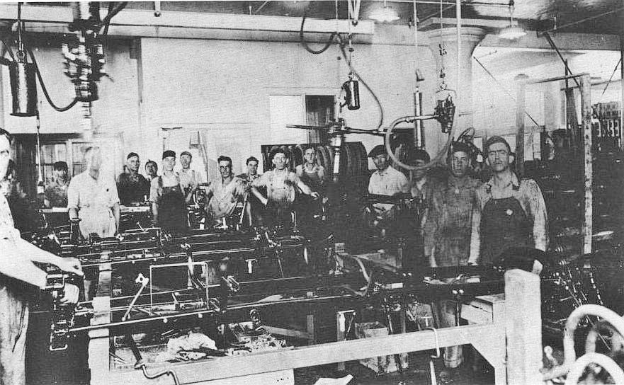

If your desire is to 'factory' type restoration, the frame and chassis parts, rear axle, front axle, etc. were done in shiny gloss black, oven dried paint, similar in gloss sheen to today's enamel, acrylic enamel, or epoxies. Better results for me has been with sandblast metal, then spray gun applications of dark primer, and finish of black acrylic enamel, with gloss hardener catalyst added for toughness and quick dry.
Rear axles after leaving oven baking of finish. Shiny gloss black frames. Really your choice on how to finish. Current project is to replicate a 'barn type' or aged T, so this 1914 frame was just wire brushed to remove minor surface rust, and then spray rattle can painted with Rustoleum Rust Reformer, a satin black primer that bonds to rust and converts it to inert state, yet has good hardness too. Can be covered with a finish coat if desired, but in this project will leave it flat/satin.
