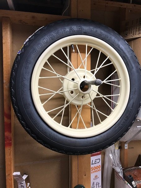

There have been several discussion about the pro's and con's of doing them. No question about appearance and the flow filling in pit marks. Just a few links ID the "cautions". To each his own
Wheels Google powder coating wire wheels MTFCA
chipping and matching the paint viewtopic.php?t=1969
Hub fitting http://www.mtfca.com/discus/messages/82 ... 1533439296
tire slipping http://www.mtfca.com/discus/messages/59 ... 1475454899
Pro'&Con's for each https://mtfca.com/phpBB3/viewtopic.php?f=2&t=14001
Leaf Springs Google powder coat springs MTFCA
I question the expense vs benefit .
Minimal exposed area, thicker surface/spring clamp fit,are slippery but if applying slip paint then why needed.
There was one caution on heat treating but that was dismissed just check it out with the painter http://www.mtfca.com/discus/messages/80 ... 1250956867
I painted these with Rustoleum Farm & Implement International Harvester White Enamel Paint - It has cured very hard and looks good and I enjoyed doing it - this is the extra spare tire. I am not wanting my project car to have an over-the-top finish, just one that looks like it might have been.
