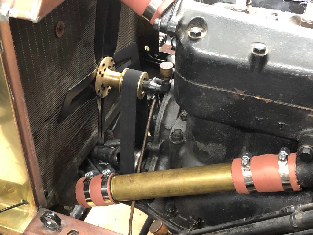

Post by Hudson29 » Mon Jul 12, 2021 7:37 pm
The fan that is on it now is a good looking one. I'm not sure if it is from the '14, the '19 or something else. This is the best picture I could find of it.

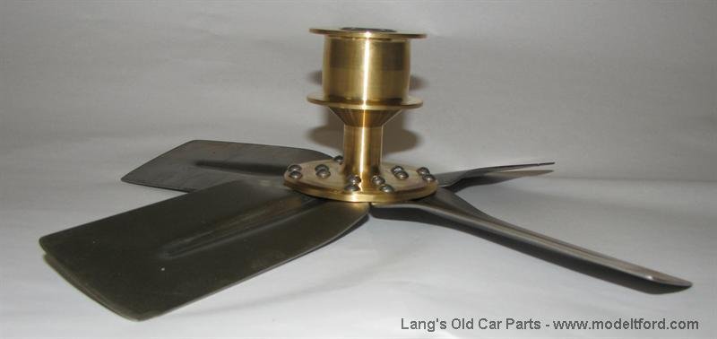

The ball bearing brass hub fan is $$$, and a little different from the original design, but I have one on my '11 and am pleased with it.

Well, it appears that you’re running one of the fans with 4 rivets per blade. Grab each blade and shake it watching its 4 rivets. If none are loose, you’ll might be OK.

KW, I see the brass one online. It looks like an older style fan has to be riveted to it?

No, you don't need paper gaskets with a new brass ball bearing fan hub
Now, I'll pontificate some too...they are very nice, but you will have to make a custom spacer to keep it in one place on the fan shaft. I installed one about a year ago (had to buy the blades separate as the full assembly was not in stock) and I vaguely remember that something about the length wasn't quite right. The instructions don't mention it and apparently neither will the forum. The gauge of the blades is slightly heavier than original as previously mentioned, and importantly, seem to have less pitch to them and definitely draw less air when sitting. Once all installed it worked just fine.

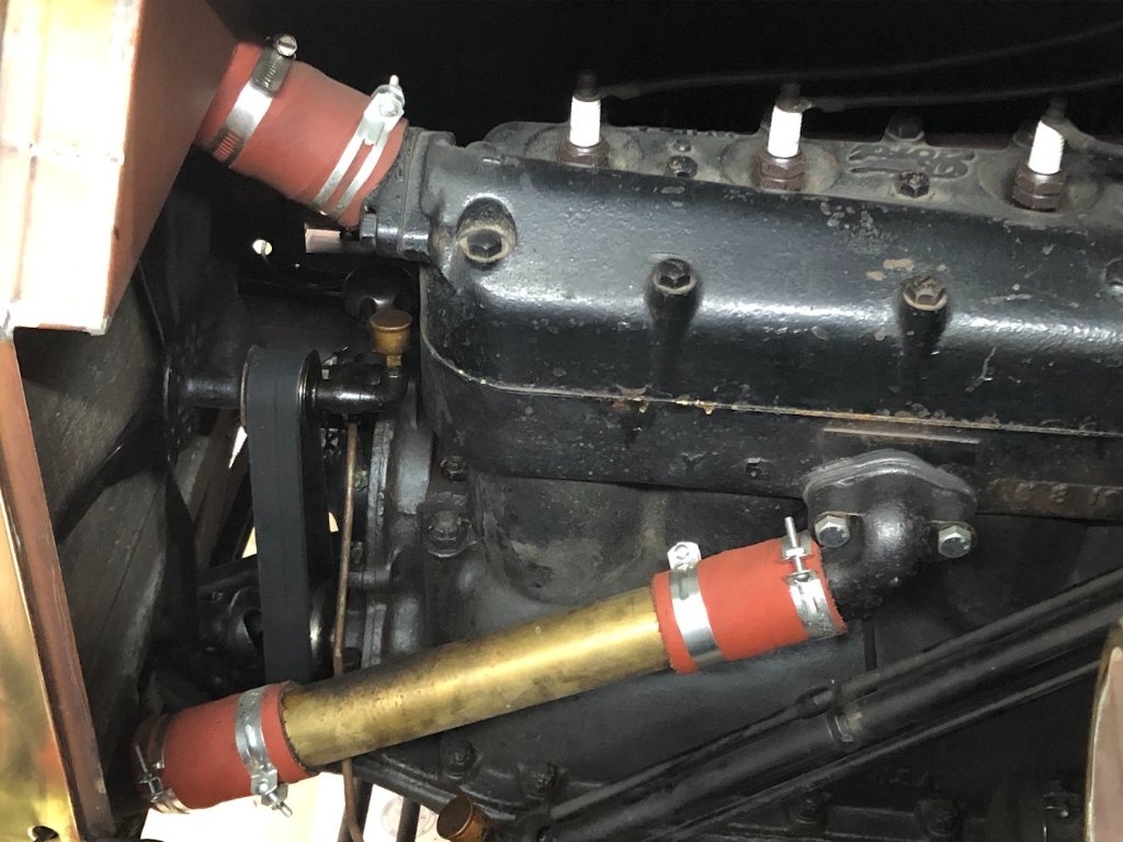

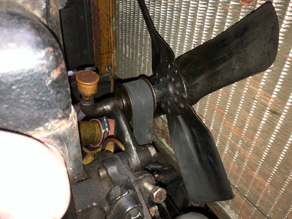

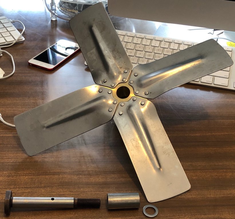

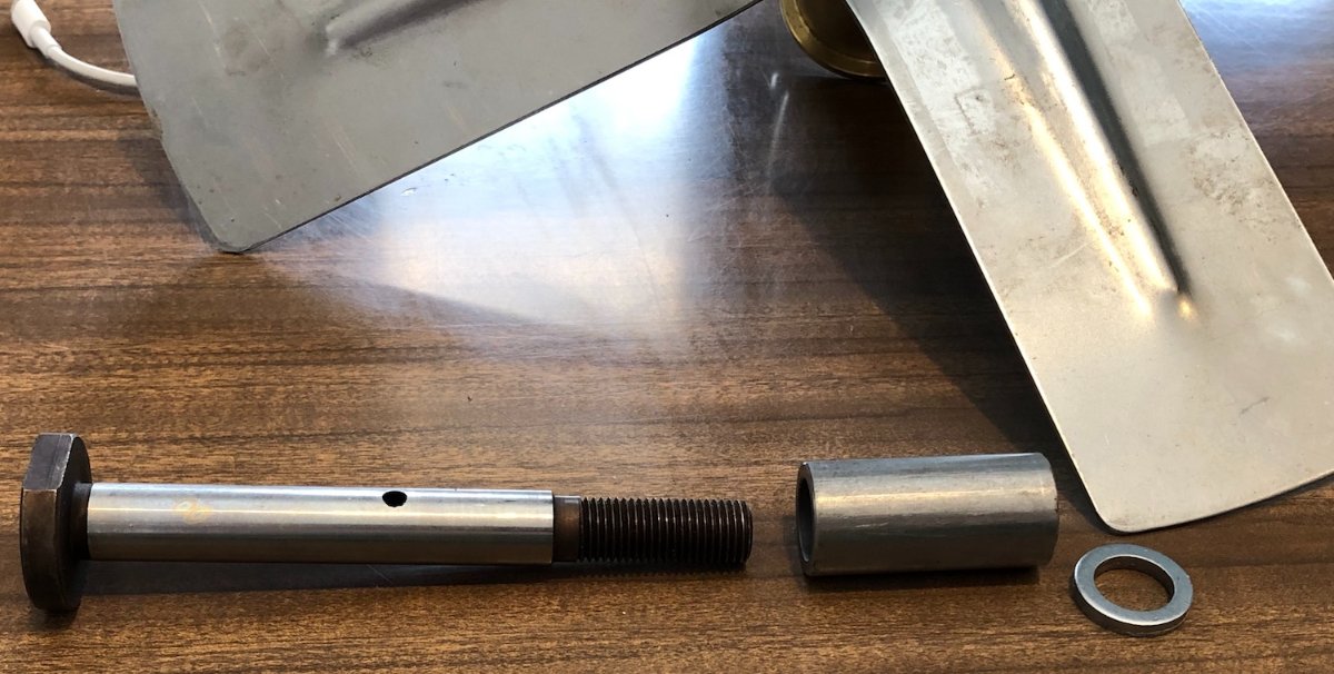

I'm not sure how to tell early from late crank pulleys. This motor could have anything. It is a '19 but has a 4 dip pan. As I understand it, it was built by a good Model T mechanic in the 1960s with the best "stuff" available at the time.
I had another look at the fan & shot a few pics. It has a T number on the shaft and looks to be steel rather than brass. From what I can see on the car, everything looks solid. It will have to come off for closer inspection.
Earlier in this thread a complete new assembled ball bearing hub with the new blades already riveted on was mentioned. Lang's lists it on the website. This would seem to solve all problems, it needs only paint. A new shaft would eliminate fitting worries also. All this is all great but it is very spendy.
I can see how to get the fan/hub assembly off by removing the adjusting bolt. How does the fan/hub assembly itself come apart? I do not see anything to take it all loose. Its been almost 2 decades since I did the '23 & I do not recall much about the process.
Paul

The crank pulley on your 23 is the large style. Your pix doesnt show it. Compare them. The early version is at least 1" smaller in diameter.Your fan hub is later 17 ish. The grease fitting on the inboard side of the fan acts as a lock nut. When you remove the fan assembly, you will see a disk in front with 2 flats to unscrew it from the arm.
Posts: 6612
Re: Ball Bearing Fan Hub & New Fan for '19?
Post by Scott_Conger » Thu Jul 15, 2021 8:21 pm
As an FYI, your fan bracket arm is the earlier "bent" style. You may wish to change it out to the longer, straight version which would be correct for your car. It will require purchasing a longer fan belt but will bring the fan up a bit to where it belongs.

Hudson29 wrote:
Thu Jul 15, 2021 6:55 pm
Paul
BTW, I just noticed, your fan arm pivot bolt doesnt have a cotter pin. Having seen one back out & bite the radiator, consider installing one soon.

I just ordered one already riveted from Lang's. I have a lot of work to do on this car (I'm working on it today) to bring it up to speed and this seemed the best way to get the project moving along. You are right about the cotter pin. I will fit one and check the '23 to make sure I didn't forget it there.
Its a pretty car and a nice driving car. I anticipate many years of pleasant touring in the future.
Paul
Hudson29
Posts: 506
First Name: Paul
Last Name: O'Neil
Location: Klamath Falls, OR
Post by Hudson29 » Mon Jul 19, 2021 6:28 pm
Much to my surprise, a package from Lang's arrived today in the mail. I just ordered the fan/ball bearing hub assembly late last week, possibly Thursday and it has come all the way across the country in two working days plus the weekend. They had to do the riveting job too. That's service!
The fan & hub look great, no looseness in the blades. I also ordered the shaft to fit and with the spacers installed the fan whirls merrily. I'll bet I'll save a 1/4 horsepower to help get up those hills . . .
Next will be to degrease & paint it semi gloss black. A co-worker saw it while I was looking for fixtures to paint it and objected to my painting the brass hub. What material was the hub of a 1914 made from? Was it steel or brass?
Paul

What is that sleeve and washer for in the pics above? Do you need those with the ball bearing fan? I just ordered one from Lang’s and I don’t see any references to those two parts.
Hudson29
Posts: 506
First Name: Paul
Last Name: O'Neil
Post by Hudson29 » Mon Jul 19, 2021 7:11 pm
OK, I may leave it unpainted. I will need to hand paint the rivet heads if I leave it brass . . .
Paul
Hudson29
Posts: 506
First Name: Paul
Last Name: O'Neil
Post by Hudson29 » Mon Jul 19, 2021 7:14 pm
Darren J Wallace wrote:
Mon Jul 19, 2021 7:04 pm
The two spacers came with the hub/fan assembly. The shaft was separate. Putting all together it makes a nice tight unit. Assuming your hub was the brass one, possibly it came with different bearings that did not need the spacers? How does the assembly work?

My original fan is really worn out and someone cut the corners of each blade a long time ago. Until I decide a course of action with it, I’ve installed the modern ball bearing version. I had to rivet it together myself but that’s no problem in my own machine shop. I installed it today and have to say it’s not a bad repro. It’s not exactly like the original but it’s good and it works. I chose to paint the entire assembly as my original was that way. I must say the brass and black does look nice in the above pics!
Hudson29
Posts: 506
First Name: Paul
Last Name: O'Neil
Post by Hudson29 » Mon Jul 26, 2021 1:32 pm
I wonder why they cut your fan that way? Is it well balanced?
I'm far from sure if the fan & hub should have been painted. I have seen plenty of photos that seem to indicate that motors in the later cars like my '23 should be painted black. Other photos seem to indicated that possibly the earlier cars like the '14 might not have been. I decided to split the difference and paint the steel parts leaving the brass as it was. After a few years it will hardly matter as the brass will tarnish and get coated with oily grime.
I see your grease cup is in a different place than mine is. Is that an earlier or later version?
Paul

I got the fan installed Sunday. The old one did not have any loose rivets or cracks that I could see but there was some wear in the shaft or bushings so that a fair amount of slop was present.
The new assembly went together well and spins freely with just a bit of end float. I found it easier to get the fan belt back on by removing the crank. An oddity here, the ratchet part would not allow the in to go through until I tried it 180° out from the first attempt.
Overall it looks good & I expect the new fan and ball bearing hub will give good service.

Post by speedytinc » Mon Jul 26, 2021 1:53 pm

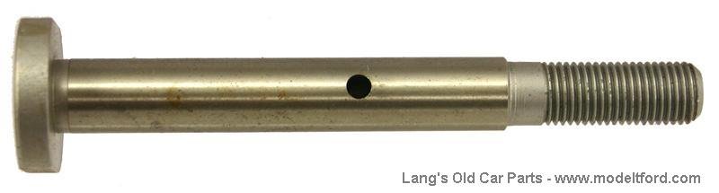

Since you asked. Your grease elbow is not correct. The fan bolt takes a special grease cup. The base acts as a jamb nut for the fan shaft.(like your elbow) Imagine that dope cup base with the 1/8 pipe threads cut off & hexed area with an internal thread. Your setup is easier on the fingers to lube.
Woodie C. was about driving & function over originality.

I've assembled and installed one for a friend and was very pleased with it
Some unsolicited advice:
The small amount of axial movement on my friends was in the range of 3/64" and I made a custom spacer for it. Now, you don't want to load the bearing, but you do want to bring axial movement to a very minimum to the extent that you can. I checked my work a couple of times at different operating temperatures so as to be certain that no material movement occured sufficiently to load the bearings. When I was done, there was just barely perceptible movement along the shaft. Ideally, you want the proper designed preload on them, but I do not know the kind of bearings used and do not want to risk damage by excessive preload, and neither do you. You want this so that the balls are not subjected to banging on the races axially. Folks don't realize it, but automobiles shipped by rail used to have wheel bearing failures due to brinelling that occured during transportation. A version of that failure is possible with bearings in this sort of use as well, though in this case it would be fretting, not brinelling. I had to modify my '23 ball bearing hub similarly.
Note: this zero-slack or minimal preload is for precision caged ball bearings. You do NOT want a preload on your front wheels (for anyone else reading this) as they are an entirely different ball bearing design. Just barely slack is ideal (and don't try to load one extra ball into the mix in an effort to fill that gap!)
You can effect this reduction in slop by selecting and purchasing the correct combination of shims here, and avoid any custom machining: https://www.mcmaster.com/shims/shape~ring/ring-shims-7/
Finally, the bearings are considered permanently lubricated (decide for yourself if this is true) and with shields in place, cannot be lubricated externally, so you might want to take off the elbow contraption and reinstall the grease cup as the locknut that it is intended to be. Since it is no longer functional, the extra plumbing is unnecessary.
Don't throw the old fan away!! Someone wants it and will rebuild it if it's surplus to your needs.
Glad you're making progress

Post by Hudson29 » Tue Jul 27, 2021 4:59 pm
Thanks guys, I'll order the proper grease cup and switch it out. The elbow will go in the spare parts box with the fan and the old shaft. The old assembly looked pretty good except it was worn and a bit loose. I'll bet a new set of bushings and a new shaft would set it right. I'm still not sure about cracks and feel happier with the new one.
Thanks Scott for the McMaster page. I have an account there for my business and would not mind ordering a selection of shims to fit the fan shaft. What size would I need to order to fit that shaft?
That sort of shim also look like they would work for the rear axle. I have always heard that these axle nuts should be tightened as far as possible & then backed out to the next section of the nut so as to be able to fit the split pin. I tighten them pretty tight with a 3/4 drive socket & breaker bar but had to back the nut off to get the pin in. Now its snug but not really tight. I read somewhere here on the forum that the bottom of the nut should be filed to allow it to go to the next position. I tried this and could hear the nut laughing at me. It hurt my pride to be laughed at by a nut but then so many things on the Model T seem to have the same sense of humor that I have just gotten used to it.
OK, I can't file it but a circular shim ought to do just as well. What size would be needed to fit on the axle? I might as well order a selection of them for both applications.
Paul

No axle nut shim. Tighten with your breaker bar, then use your weight to the next hole or 2. Has to be real tight. 90#? If your pin hole is outside the castle, add a grade 8 washer. If you had a wheel off, tighten & recheck torque after a drive.

I am not holding a shaft in my hand right now, but the answer is to buy whatever ID shim(s) it is that is a dead slip-fit over the shaft, in the thickness an indicator would dictate is prudent. This will get clamped between the very short spacer and the bearing nearest the engine and remove the excessive fore/aft play. "Excessive" children's play is measured in decibels, "excessive" fan play is measured in thousandths. Reducing either when it is necessary, is beneficial.
