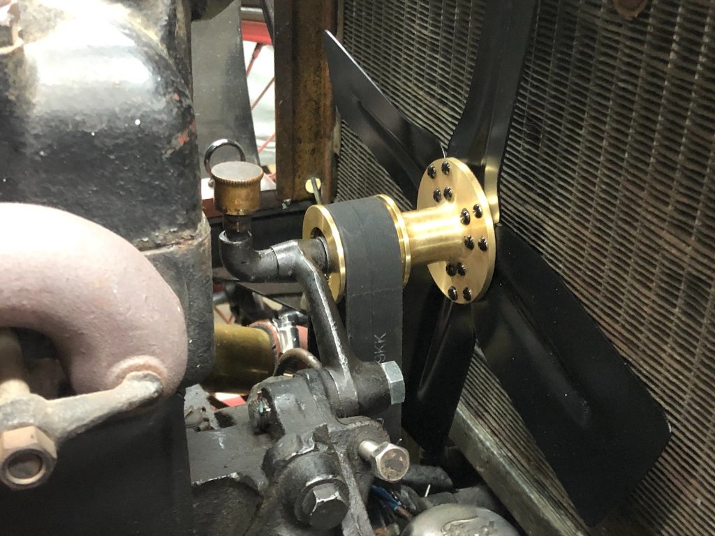

The ball bearing brass hub fan is $$$, and a little different from the original design, but I have one on my '11 and am pleased with it.

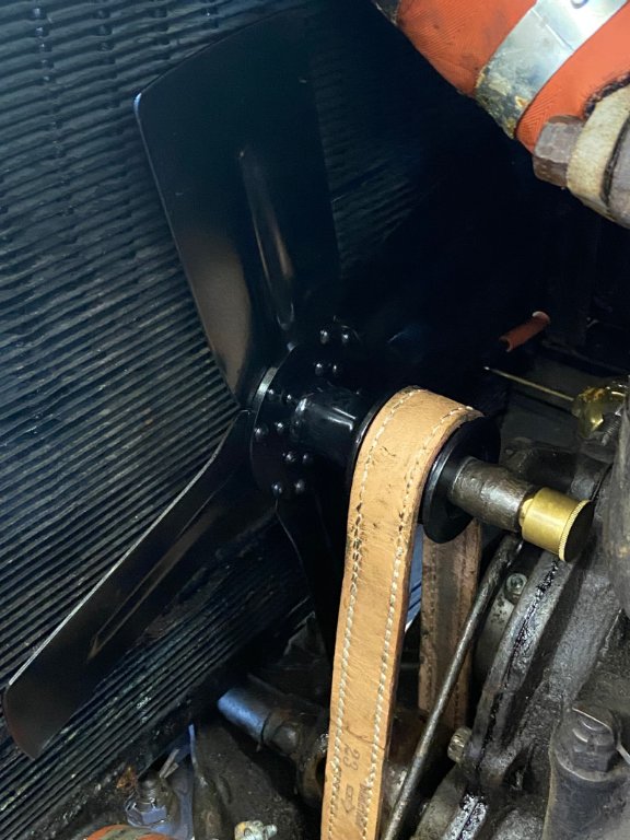

The later aluminum pulley with sealed bearings and the accompanying fan blade will not fit with a brass 14 radiator without trimming the fan blades down. I have a ball bearing brass fan pulley with riveted blades on my 15 and am very happy with it. I would go that route over trimming the blades, but either way will work.

No, you don't need paper gaskets with a new brass ball bearing fan hub
Now, I'll pontificate some too...they are very nice, but you will have to make a custom spacer to keep it in one place on the fan shaft. I installed one about a year ago (had to buy the blades separate as the full assembly was not in stock) and I vaguely remember that something about the length wasn't quite right. The instructions don't mention it and apparently neither will the forum. The gauge of the blades is slightly heavier than original as previously mentioned, and importantly, seem to have less pitch to them and definitely draw less air when sitting. Once all installed it worked just fine.

I like the sturdiness & added peace of mind of the late repo type fan blades. I am thinking my answer is a late ball bearing hub (might as well do the upgrade to bearings if I am going non stock anyway) & late fan trimmed to fit a brass car. Your thoughts?

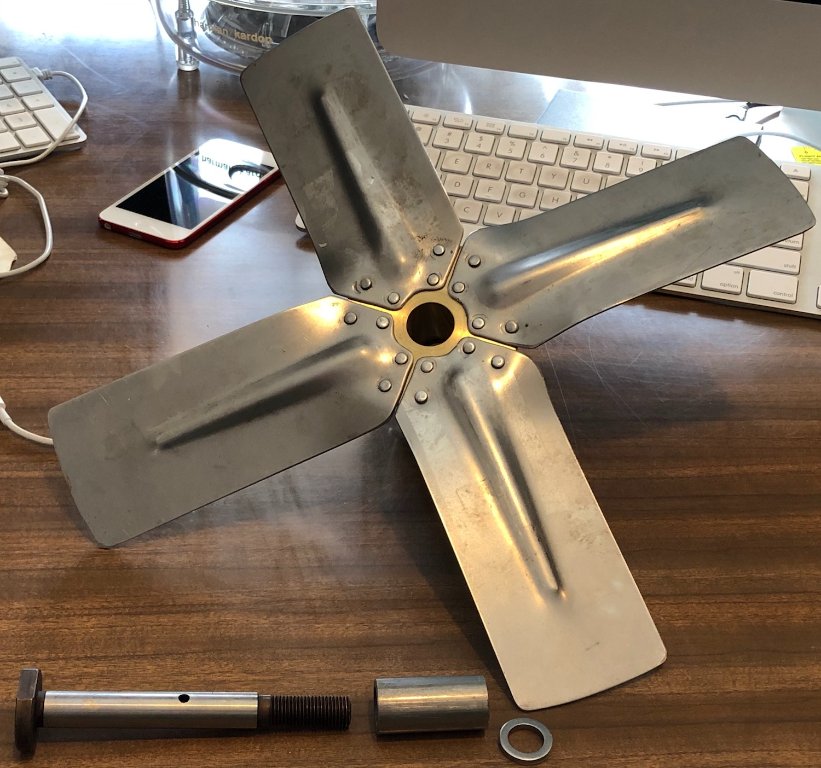

I'm not sure how to tell early from late crank pulleys. This motor could have anything. It is a '19 but has a 4 dip pan. As I understand it, it was built by a good Model T mechanic in the 1960s with the best "stuff" available at the time.
I had another look at the fan & shot a few pics. It has a T number on the shaft and looks to be steel rather than brass. From what I can see on the car, everything looks solid. It will have to come off for closer inspection.
Earlier in this thread a complete new assembled ball bearing hub with the new blades already riveted on was mentioned. Lang's lists it on the website. This would seem to solve all problems, it needs only paint. A new shaft would eliminate fitting worries also. All this is all great but it is very spendy.
I can see how to get the fan/hub assembly off by removing the adjusting bolt. How does the fan/hub assembly itself come apart? I do not see anything to take it all loose. Its been almost 2 decades since I did the '23 & I do not recall much about the process.
Paul

Much to my surprise, a package from Lang's arrived today in the mail. I just ordered the fan/ball bearing hub assembly late last week, possibly Thursday and it has come all the way across the country in two working days plus the weekend. They had to do the riveting job too. That's service!
The fan & hub look great, no looseness in the blades. I also ordered the shaft to fit and with the spacers installed the fan whirls merrily. I'll bet I'll save a 1/4 horsepower to help get up those hills . . .

What is that sleeve and washer for in the pics above? Do you need those with the ball bearing fan? I just ordered one from Lang’s and I don’t see any references to those two parts.

The two spacers came with the hub/fan assembly. The shaft was separate. Putting all together it makes a nice tight unit. Assuming your hub was the brass one, possibly it came with different bearings that did not need the spacers? How does the assembly work?Darren J Wallace wrote: ↑Mon Jul 19, 2021 7:04 pmWhat is that sleeve and washer for in the pics above? Do you need those with the ball bearing fan? I just ordered one from Lang’s and I don’t see any references to those two parts.

The fan is out of the paint shop & ready to install. Its out baking in the sun right now to get that modern paint as hard as it can be to resist scratches while being installed.

My original fan is really worn out and someone cut the corners of each blade a long time ago. Until I decide a course of action with it, I’ve installed the modern ball bearing version. I had to rivet it together myself but that’s no problem in my own machine shop. I installed it today and have to say it’s not a bad repro. It’s not exactly like the original but it’s good and it works. I chose to paint the entire assembly as my original was that way. I must say the brass and black does look nice in the above pics!

I wonder why they cut your fan that way? Is it well balanced?
I'm far from sure if the fan & hub should have been painted. I have seen plenty of photos that seem to indicate that motors in the later cars like my '23 should be painted black. Other photos seem to indicated that possibly the earlier cars like the '14 might not have been. I decided to split the difference and paint the steel parts leaving the brass as it was. After a few years it will hardly matter as the brass will tarnish and get coated with oily grime.
I see your grease cup is in a different place than mine is. Is that an earlier or later version?

I got the fan installed Sunday. The old one did not have any loose rivets or cracks that I could see but there was some wear in the shaft or bushings so that a fair amount of slop was present.
The new assembly went together well and spins freely with just a bit of end float. I found it easier to get the fan belt back on by removing the crank. An oddity here, the ratchet part would not allow the in to go through until I tried it 180° out from the first attempt.
Overall it looks good & I expect the new fan and ball bearing hub will give good service.

Since you asked. Your grease elbow is not correct. The fan bolt takes a special grease cup. The base acts as a jamb nut for the fan shaft.(like your elbow) Imagine that dope cup base with the 1/8 pipe threads cut off & hexed area with an internal thread. Your setup is easier on the fingers to lube.
Woodie C. was about driving & function over originality.

I've assembled and installed one for a friend and was very pleased with it
Some unsolicited advice:
The small amount of axial movement on my friends was in the range of 3/64" and I made a custom spacer for it. Now, you don't want to load the bearing, but you do want to bring axial movement to a very minimum to the extent that you can. I checked my work a couple of times at different operating temperatures so as to be certain that no material movement occured sufficiently to load the bearings. When I was done, there was just barely perceptible movement along the shaft. Ideally, you want the proper designed preload on them, but I do not know the kind of bearings used and do not want to risk damage by excessive preload, and neither do you. You want this so that the balls are not subjected to banging on the races axially. Folks don't realize it, but automobiles shipped by rail used to have wheel bearing failures due to brinelling that occured during transportation. A version of that failure is possible with bearings in this sort of use as well, though in this case it would be fretting, not brinelling. I had to modify my '23 ball bearing hub similarly.
Note: this zero-slack or minimal preload is for precision caged ball bearings. You do NOT want a preload on your front wheels (for anyone else reading this) as they are an entirely different ball bearing design. Just barely slack is ideal (and don't try to load one extra ball into the mix in an effort to fill that gap!)
You can effect this reduction in slop by selecting and purchasing the correct combination of shims here, and avoid any custom machining: https://www.mcmaster.com/shims/shape~ring/ring-shims-7/
Finally, the bearings are considered permanently lubricated (decide for yourself if this is true) and with shields in place, cannot be lubricated externally, so you might want to take off the elbow contraption and reinstall the grease cup as the locknut that it is intended to be. Since it is no longer functional, the extra plumbing is unnecessary.
Don't throw the old fan away!! Someone wants it and will rebuild it if it's surplus to your needs.
