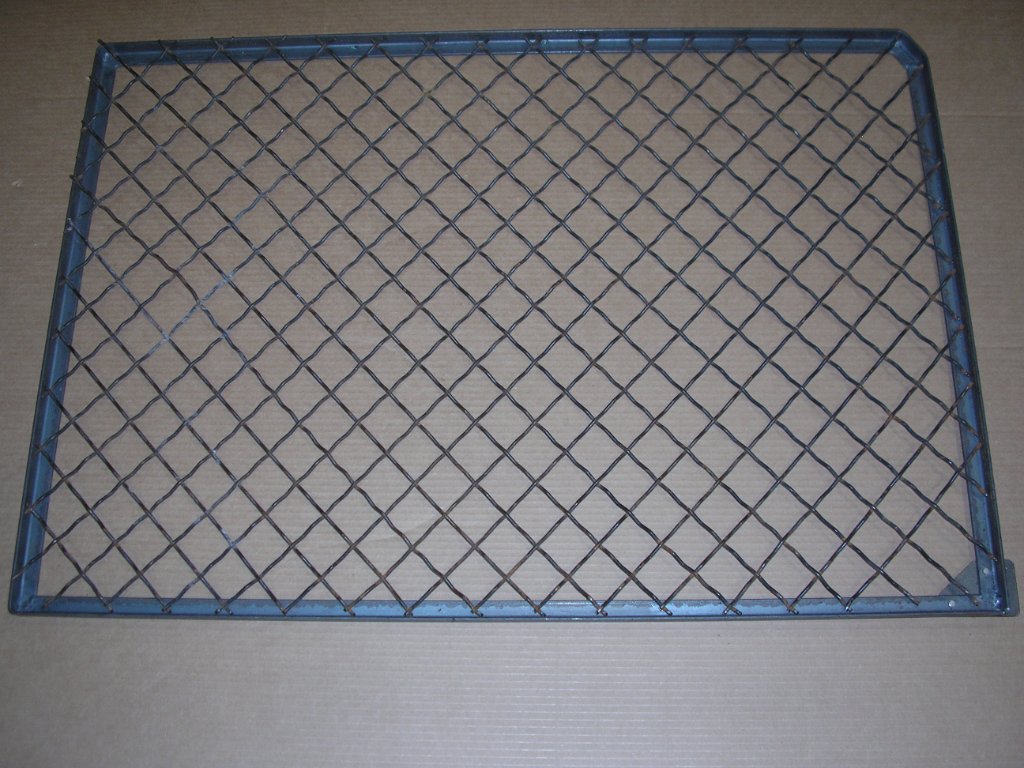

I obtained two incomplete sets of screen sides a number of years ago, the only part missing was the handle for the doors and the rest of the wood.My intention was to restore a set, until....
I came across a storage bin in a warehouse that was being demolished and had the same screen. As rare as these are, I decided to reproduce a couple sets.
I started buy reproducing the hardware including the top corner braces.
I laid out the screen on a table and secured it in place with wooden blocks to hold it in place on the correct bias.
The screen wires must cross each other as they pass thru the holes in the frame. The clips also keep the frame from warping when the wires are crimped.

Wow!!! Nice save on the "wavy" cyclone material (which is becoming, if not unobtanium, Hardtofindium, in its own right) and REALLY cool on the repop sides.

It's really interesting to hear of the other uses of this screen as others have commented on. What is still puzzling to me is that big hole in one of the side panels,.....who or what, why and that was not easy to do.

Haven't posted lately, but I have got 2 sides done and all the door frames done, wire fitted to all the doors and wire retainers drilled for install.
Also trial fitting door latches.

Finally finished securing the screens to the door frames and installed the rest of the door latch hardware.
The fit up is complete, one set done, the second set is in work.
