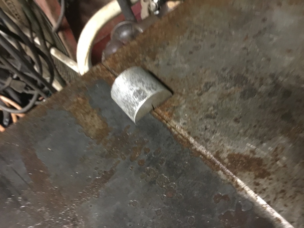

Post by Drew Wommack » Mon Jul 22, 2024 3:27 pm
Bryant,
See below some additional photos of the pan alignment table. It's hard to see since the table is dirty, but on the rear adjustment plate (2nd photo)there is a small indexing mark for alignment with the centerline cut into the table. The plate is 42" in length and extends 2 1/4" past the rear of the pan.

Posts: 1963
Last Name: Tannehill
Location: Hot Coffee, MS
Board Member Since: 2002
Re: Pan Jig Layout Dimensions
Post by JTT3 » Mon Jul 22, 2024 3:51 pm
Drew, so happy you are using the pan table Bob built. The actual last thing Bob did T related was straighten an early pan for a friend in northeast Mississippi after no one else would do it, he charged him $0.00 !
When the pan arrived back after completion it slid in perfectly aligned to the straightened frame. Bob said the pan was so crooked that it must have been owned by a politician. I miss Bob, one of the good guys. RIP.
