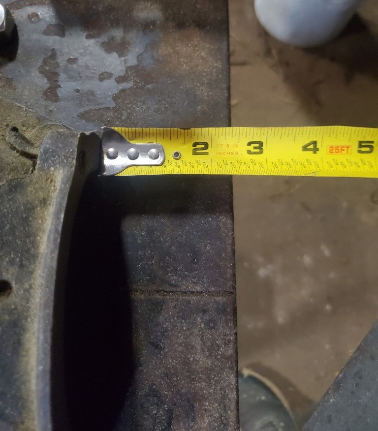

Bob how much overhang did you leave for the straightening jig at the back of the pan? I see the pan is 40-15/32. What ended up being the total length of the plate?

I now own the Bob Shirley table. It's at my warehouse/shop but I will be up there tomorrow and can give you the dimension for the rear extension.

Re: Pan Jig Layout Dimensions
Bryant,
See below some additional photos of the pan alignment table. It's hard to see since the table is dirty, but on the rear adjustment plate (2nd photo)there is a small indexing mark for alignment with the centerline cut into the table. The plate is 42" in length and extends 2 1/4" past the rear of the pan.
